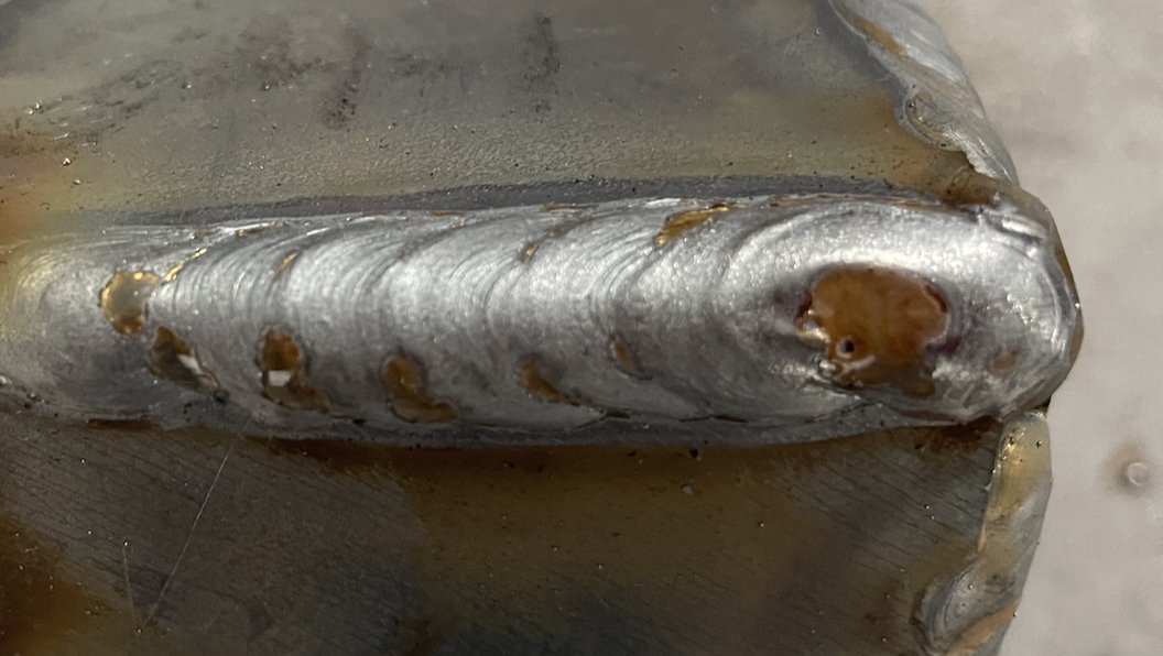

    continuing the basics ... practice practice practice. I got lazy on the prep since I'm just trying to get the flow down and I'm not using this for anything -- but I'm finally drawing some straight(er) lines.

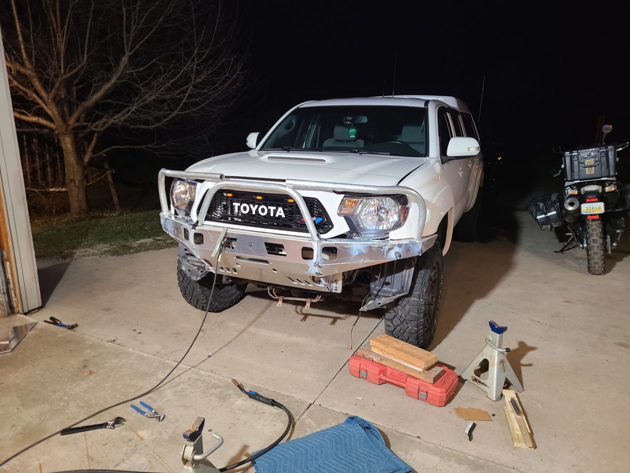

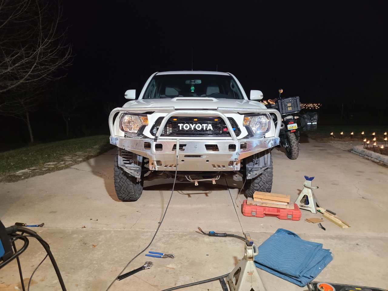

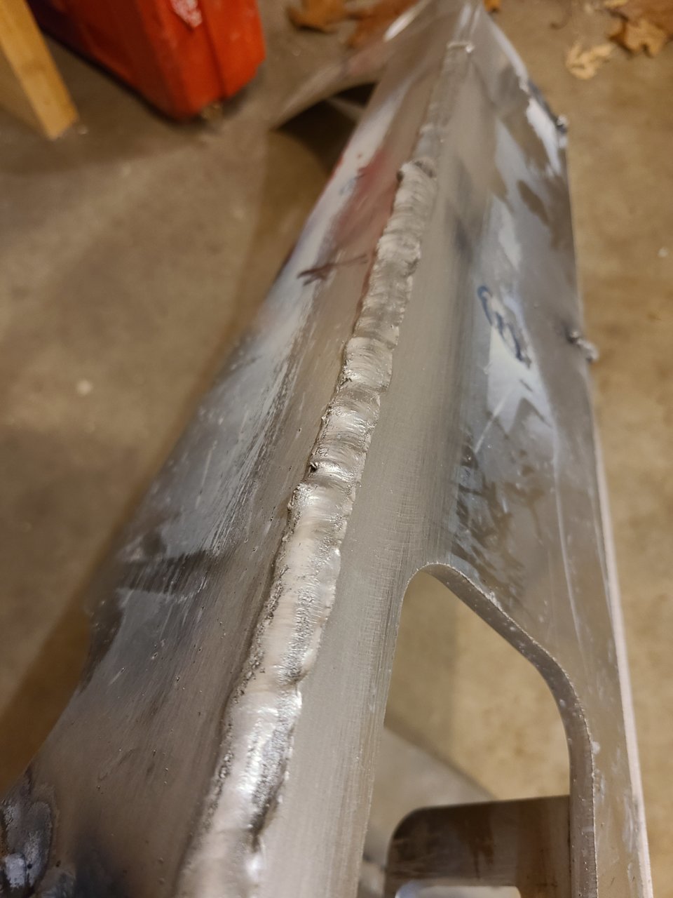

    Was told to post this here. Semi-custom bumper build. Bought a weld together kit from Coastal Offroad in the aluminum flavor and extreme clearance kit (you cut off the factory sub frame and weld in a new one that's much higher up). Also going to change up some of the tubing layout and adding some miscellaneous brackets here and there.
    I have a Miller 215, great machine but it can't do AC TIG. So I was limited to either a spoolgun or a trying MIG setup.
    I borrowed a neighbors spoolgun on a Miller 211 to try but I actually ended up liking the results with my traditional MIG 215 for most of the project (not done yet).
    The material is 1/4" 5052. I used a 3/64" 5356 filler with 100% argon, DCEP process and fed directly through my Miller 215 gun with .047" contact tips. Generally needed 25-27V (upper limit on this machine) to get good penetration through the oxidation layer, 450-550 ipm. I even used the stock .030/.035" drive roller...only a handful of feed issues if the torch cable was too far bent. I was surprised by how well it worked honestly. The weld quality was decent, I checked penetration on a couple joints, breaking them apart and cutting cross sections until I got the settings dialed in. Really seemed to only be limited by my own lack of experience/skill in aluminum welding. I had done some TIG aluminum welding in the past, but never MIG.
    Don't get me wrong, I'm certainly not stacking dimes...but for the purposes of this project, it will certainly work (and because i'm cheap)
    The most time-consuming part is prepping the aluminum. Lots of brushing with a stainless wire brush, then clean the joint with acetone...every time. Also getting real intimate with a flap disk.
    A grinder and some paint makes a welder what he aint!
    I haven't finished up the tubes yet because I decided I didn't really like how the center tube framed the grill (just spent a bunch of time building the custom grill). Waiting on some material so I can extend the center hoop so that its approximately the length of the grill.

    Since you're learning (as well as me), I'll say your wirespeed and voltage look good, but practice in being consistent when laying your bead.
    I like to watch the wire and follow the seam when doing T's to ensure I have equal amounts of weld on both pieces being welded together.
    Otherwise, keep up the good work!
    And like someone here told me, ABC's!
    Always Be Comfortable.

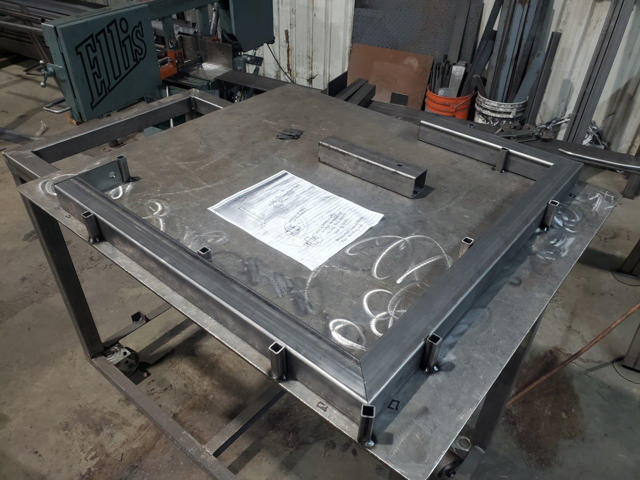

    But it wasn't without cutting, welding, drilling, and grinding a bunch of legs we were short on -
    Making a jig for the main table support, thanks to tips I took from @GHOST SHIP
    To welding misc stuff for the boss -

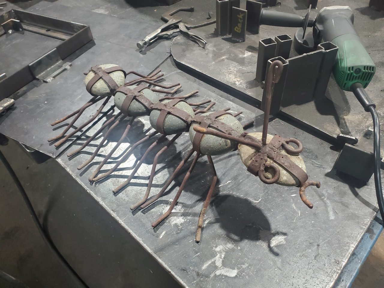

    Oh yeah! Should have stated that haha.
    My Pops has a stone and brick fire pit in his back yard he uses religiously. Like rain, snow, whatever, it’s fire night.
    The metal grate in it is melted and busted and gross.
    This will be a replacement (for as long as 3/16” will last with his constant use).
    It coincides with his 60th birthday present we got him in November:

    It's nice to see others have no issue welding their jigs directly to the fabrication table. It's the only way I know.

    Welding to the table works for short runs!
    I made jigs over the years for those jobs that you get like every 3 months for 50 pieces that just clamped to the table or tack welded that could be moved to different locations as needed without starting from scratch.
    It would never fail a Super Hot rush job comes along and the table needs cleaned off in the middle of the 50 piece fill in job.

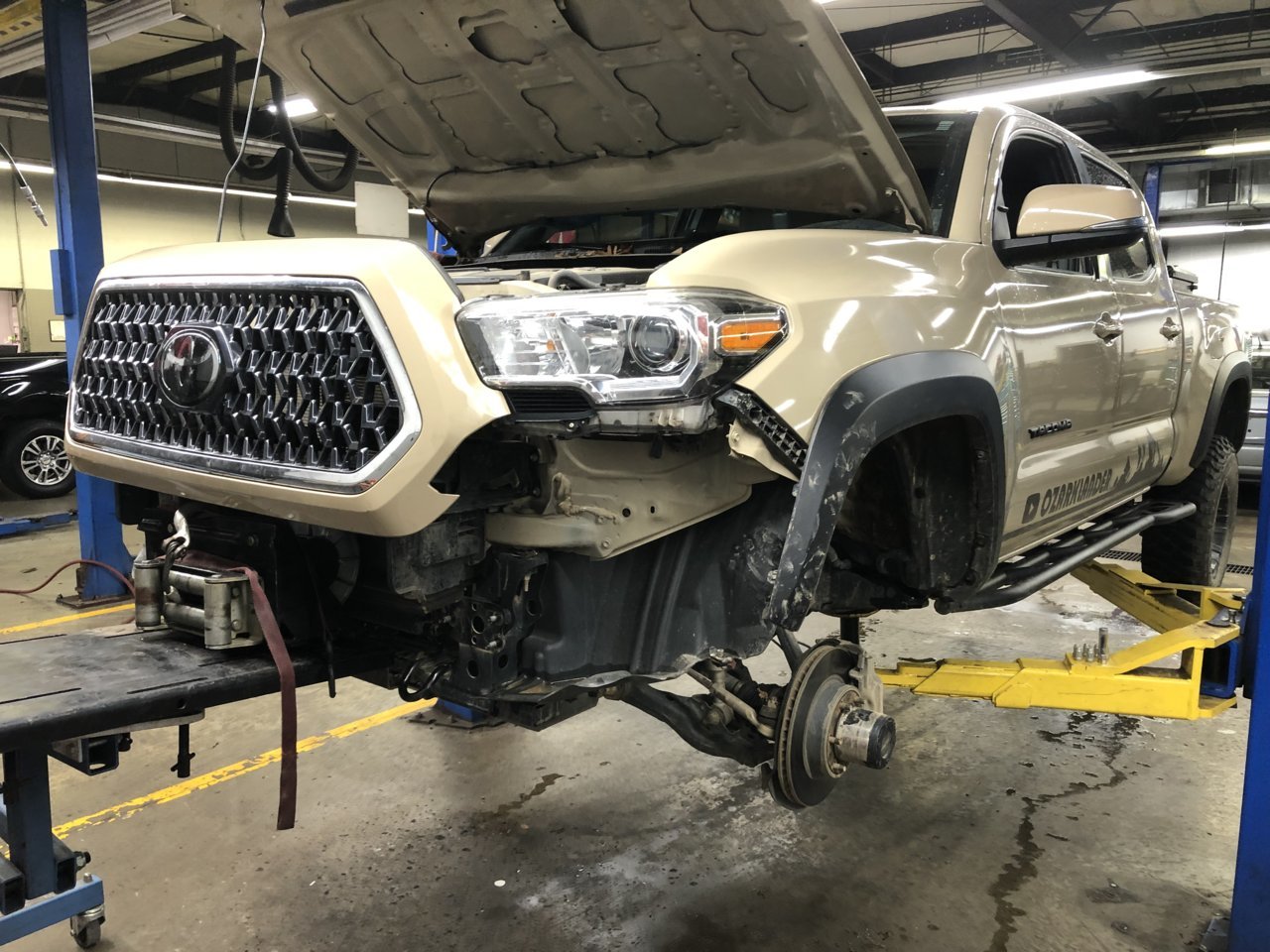

    58895A83-935E-46A3-99A8-0B13F87AB013.jpg 0A890A33-ED03-484F-A295-79FABA0FF0D2.jpg

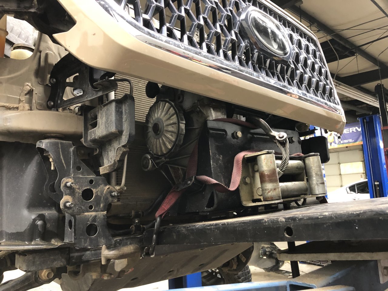

    Got started today. The winch is going to fit up behind the grill very nicely. Super excited how this is going to turn out.

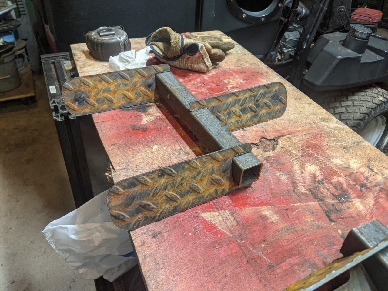

    Decided to start on a boat step stand for getting into my fishing boat when it's still on the trailer.PXL_20211219_145408999.jpg PXL_20211219_200735585.jpg PXL_20211219_200751991.jpg PXL_20211219_202002709.jpg PXL_20211219_202010940.jpg

    The real challenge would be to build a step to get in the boat in the middle of the pond!!
    I did find Cat fishing in the back yard was Fun till Mom asked what I was up to.
