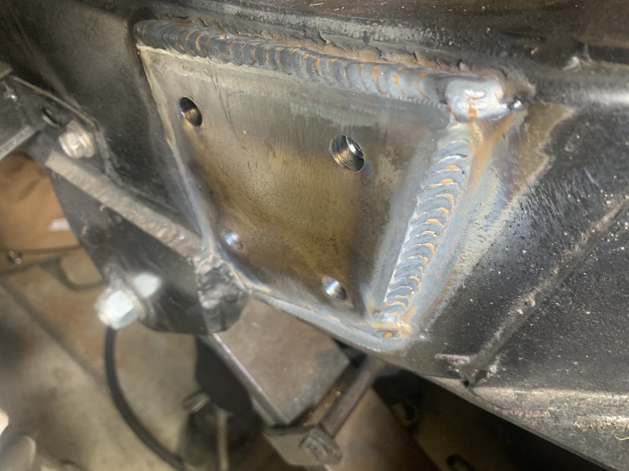

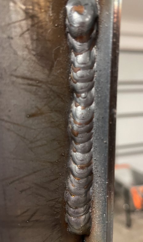

    Practicing vertical welds last night ... I went from bottom up. This is definitely tougher than my more comfortable left to right. I have many more practice sessions to go for this one haha.
    I did have a really hard time seeing last night. QUESTIONS: how many hours behind the helmet until you replace the lenses? Is poor visibility a tell-tell sign to swap? I have some replacements that came with mine but haven't changed anything yet. I kept moving around trying to get better / different light and I just couldn't get a good look last night. I am using this yes welder helmet: https://www.amazon.com/gp/product/B07PLZ8M33
    and I managed to weld the seams of some frame outriggers that will be used for a 63 swap hopefully in Q1 2022:

    I've honestly never welded a single joint uphill aside from a couple practice runs. Realized how terrible it was to fight gravity and just run them downhill. From what I understand, you get more heat and better penetration going uphill because you're going slower but that's more applicable to welding dump trucks together, not anything as thin as 1/4" and thinner which is most of what these trucks see.
    As far as the hood, I just go off of how dirty the lens is. If I notice it's dirty and scratched and I'm also having a harder time seeing, I'll replace it. Good lighting is key too, some people even throw a small light on their hood itself.

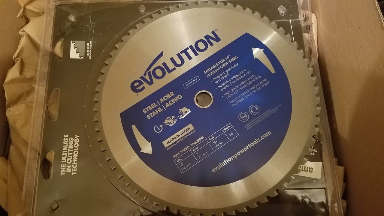

    At the risk of getting banned, I'm gonna post a porn pic:
    Amazon Warehouse score for $64. Plastic sleeve had been cut but there were no witness marks indicating it had been mounted or used.
    Edit: and, I had a $40 Christmas gift card from work. So, $24 dollar blade.

    Yeah, it's what I have on my saw now. Of course, they never last as long as I'd like, but I'm gonna mount this and maybe see if I can sharpen the old one. I figure if I ruin it, at least I tried. I might try a chain saw file on it unless someone on here chimes in with another method.

    I wonder if there is any where to send them out for sharpening, I thinks its cost effective for the good quality, high tooth blades

    Keep welding up rather than down. It’s good practice and gives better penetration/strength. Especially with stick welding it’ll help to keep out slag inclusions, but with all processes you’ll move slower fighting gravity than welding down with it and end up with a better weld in most cases. It’s not too hard after a day or two of it and it’s nice to know how rather than not.

    Assuming those are carbide teeth on the blade, you need to be very careful sharpening it. Carbide is very brittle, and can chip. Also, IIRC, the dust/filings are poisonous.
    I send my woodworking blades to Forrest for sharpening. I don't know if they do metal blades, but you could check. Otherwise, I'm sure you could find a shop to sharpen your blade. Although, at $24 replacement, it might not be worth it.

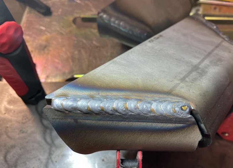

    You’re spending too much time in the middle and not enough on the sides (or going far enough in most cases). You’ll find a nice example on Jody’s mig series for vertical up, down, and overhead.
    Listen to the guys who mentioned Jody at welding tips and tricks. Watch his whole mig series.
    https://www.weldingtipsandtricks.com/mig-welding-videos.html
    Another trick I picked up from him is using this or any other plastic polish and polishing up the outer lens on the outside (obviously) but the inside of the outer lens too if you’ve got grinding dust etc. in there. Just dab some on a microfiber rag and hand polish / buff. Makes a huge difference.
    https://www.amazon.com/Meguiars-Cle...t=&hvlocphy=9031006&hvtargid=pla-521422142786
    I use a cheap-o HF hood and while I’d like a nicer one and believe that it would help in certain out of position welds, I’ve just found the lighting that works for me and used a mechanic magnet light and made sure I could always see the puddle and never guess until absolutely necessary. It takes a couple tries to figure out where that is going to be or how you need to move your body to keep sight of the puddle the whole time or as long as possible. Do a couple dry runs before sparking the electrode complete with manipulating the imaginary puddle so you know for sure that you have line of sight. And get you’re head close to the puddle. Some guys can weld at arm’s length but I believe they started out being close to the puddle and just got muscle memory over time allowing them to move further away from the puddle.
    It’s good to practice up and down as there are times where either is going to suit your application. Welding up is good of course, but where you’re doing both sides of a gusset you don’t need that much penetration as much as one side of a more critical joint that is only held on one side, down is fine.
    Think I went down on the other vertical side and up on the closest side (HF hood used here with a nicely polished lens). You can see I should have turned the wire feed speed down on the top after keeping it where it was for the bottom and sides as it looks like I rushed getting done and had excess weld. Machine Hobart 140, full power, 55 wfs.

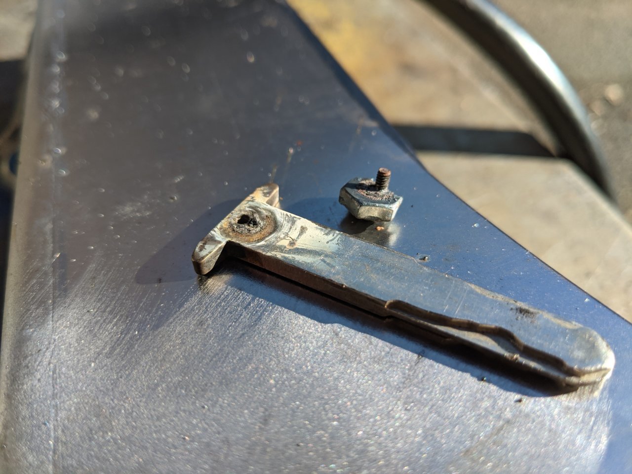

    Welding came in clutch today. The my sisters car key/fob thing fell apart and we got a new case for it, but the little screw that holds the key in was seized into it's threads. Tried vice grips on it, and it sheared off. Welded a little nut on there and it came right out!
    Gonna clean it up a bit, and it should be good as new
