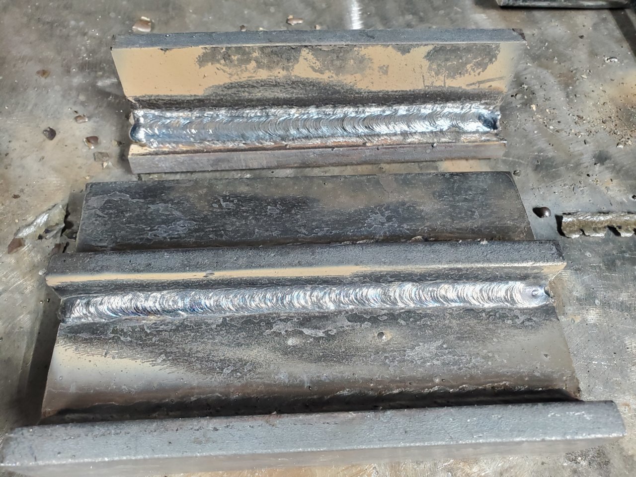

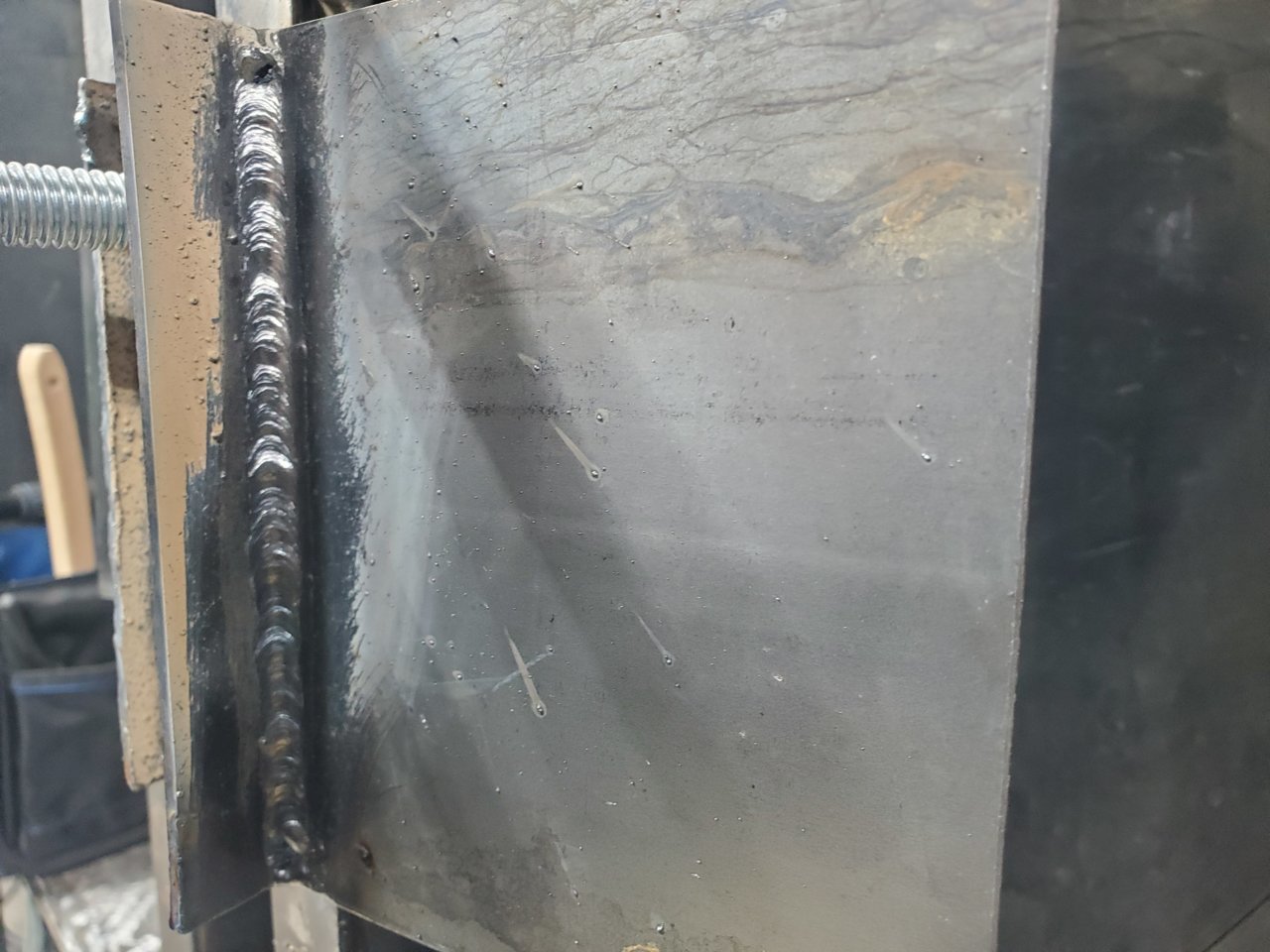

    4 run, 2 don't
    Down for thin, up for thick.
    Least that's the way I was taught.
    Vertical down, 6013, and very fast since its 3/32" rod and burns really fast
    At 80amps on 1/8" steel I'm surprised how flat this laid down.
    No undercut whatsoever.
    Camera doesn't capture just how concave and flat the weld is inside the seam. It doesn't bulge and the image above gives it the illusion that it does.

    Yup, we’ll do a 6010 down to fill a thin gap, then 7018 up in stringers, then vertical up weaves to cap it.

    7018 is so fun

    Odd.
    6010 is usually what one learns with at first, especially since it's dirty and doesn't lay down as easily when running stringers.
    7018 makes everyone look like a pro when you pull a stringer.

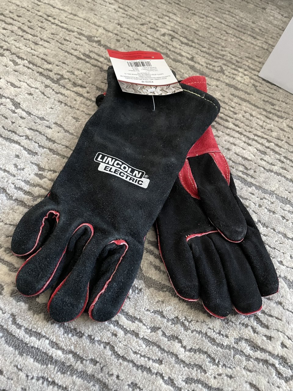

    Thanks all for the vertical up/down tips the last few days. I wanted to post this pic of kids gloves. I’m most excited about giving these to my 11 yr old tomorrow - should fit perfect !!! Happy holidays!

    While good for protection you lose all tactile feeling in the hands from the gloves being so thick.
    when your so young
