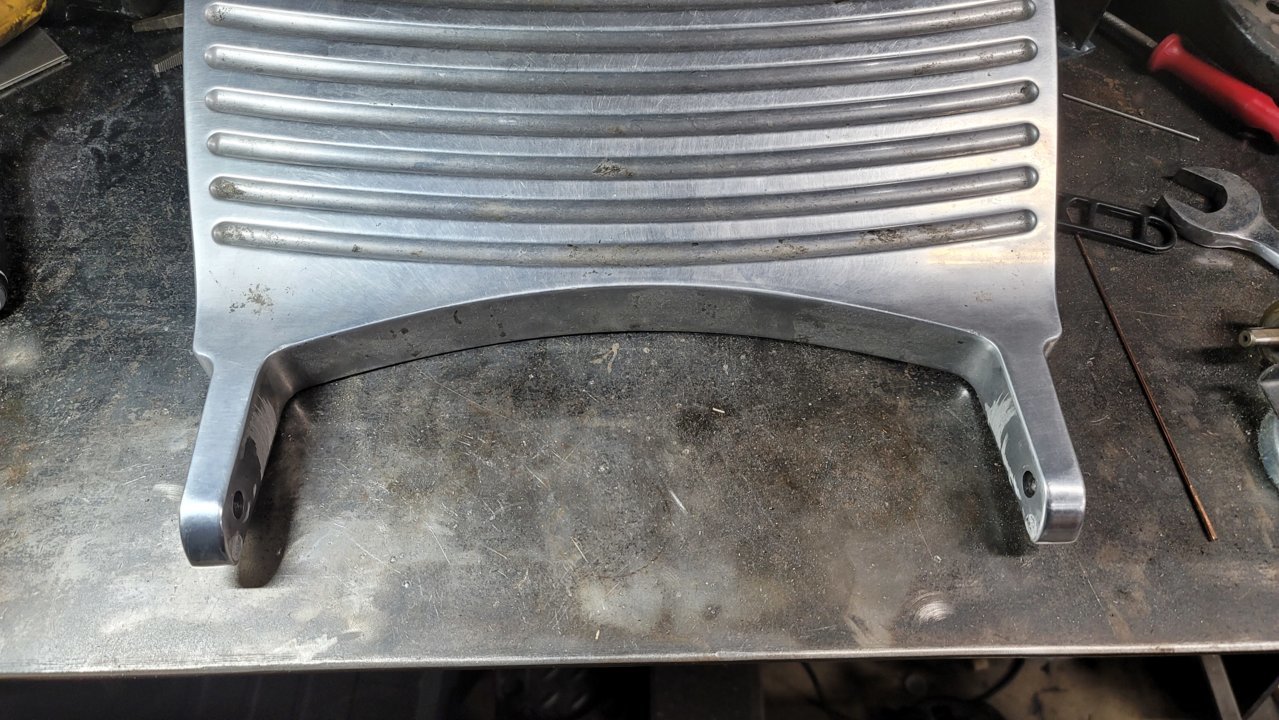

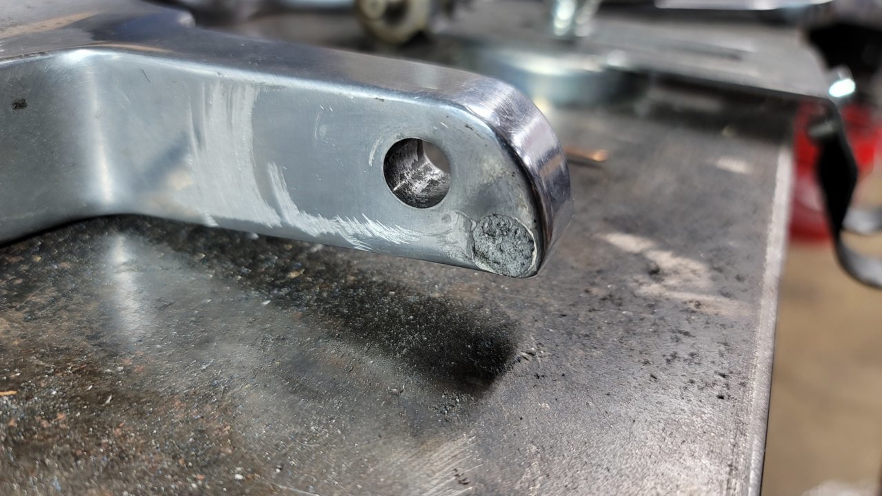

    Barber chair repair in progress. Some stops for the foot rest were broken off. I filled the holes and I'm going to drill and tap and use cap head bolts as the stops.

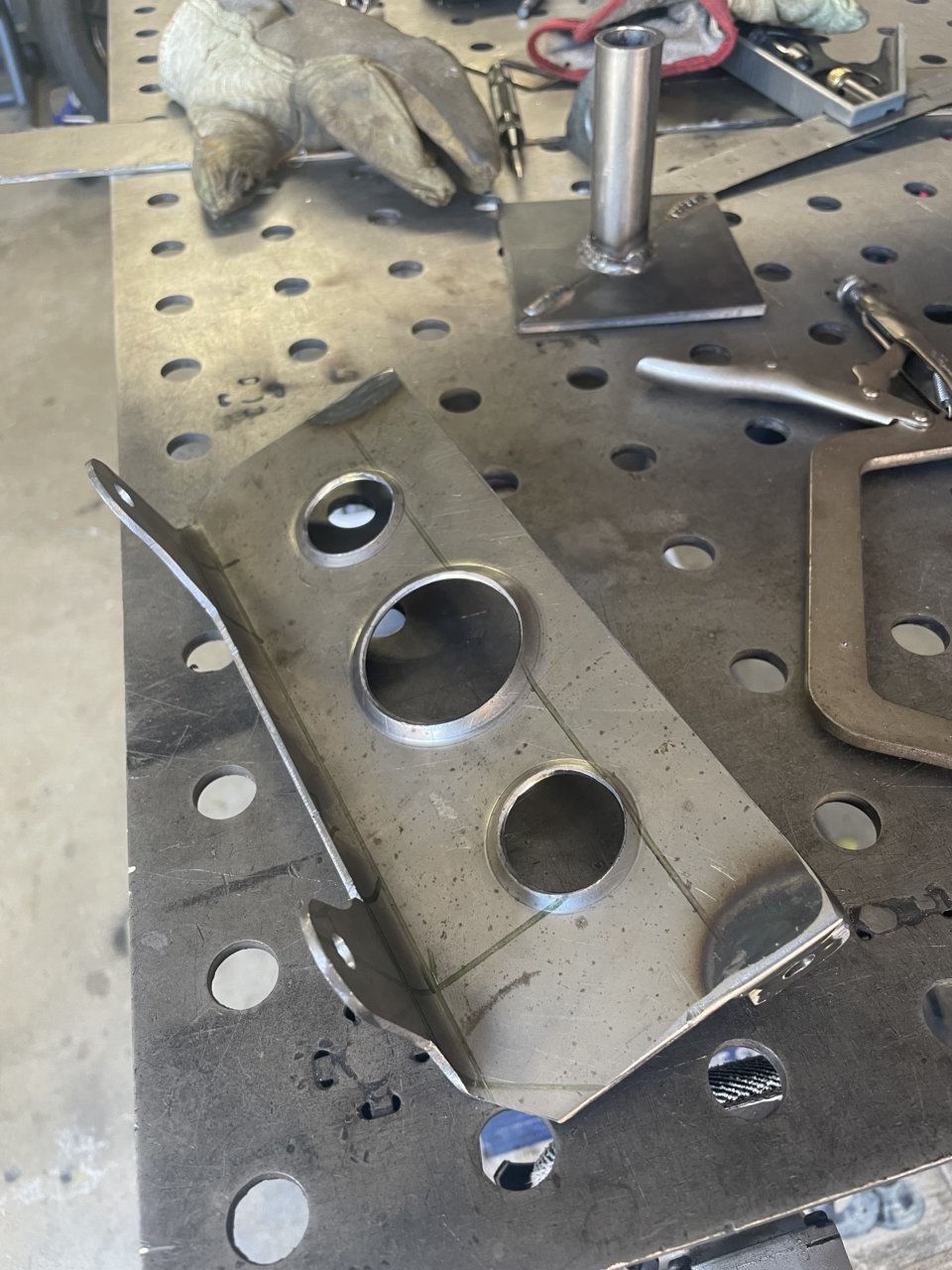

    Got some brackets tacked up. Now for some gussets then on to building the actual bumper.

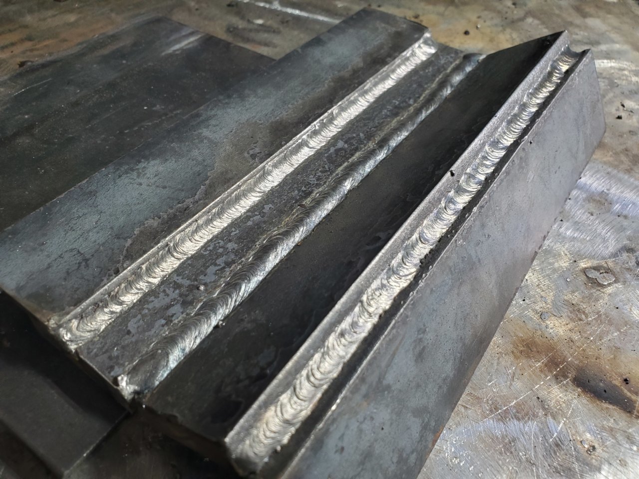

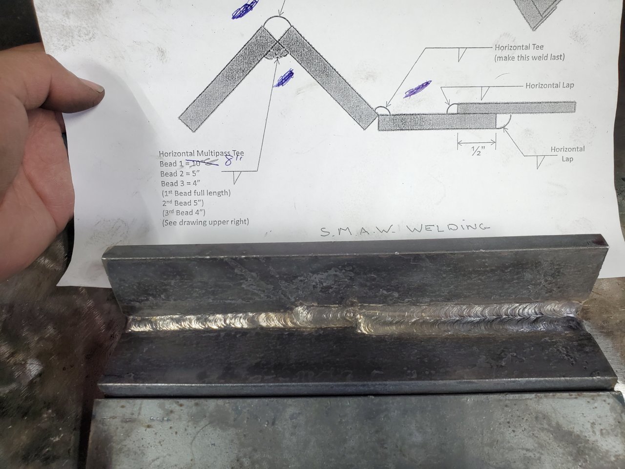

    So I passed my stick welding practical application test :welder:
    Bare with me as I'm not a stick welder and only do MIG at work.

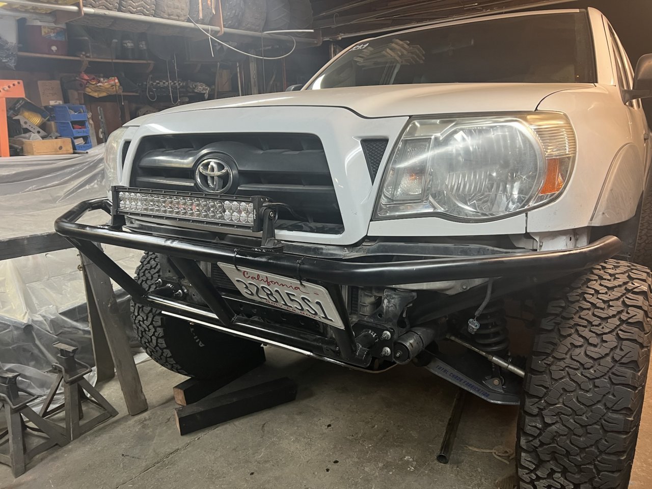

    Made a bumper for a buddy of mine. I’m a better thinker than welder than fabricator. I can sure fill gaps.

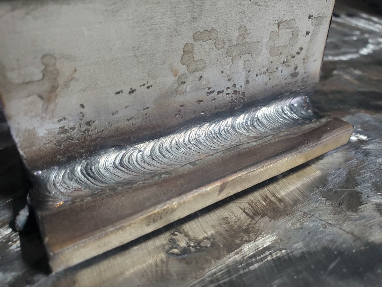

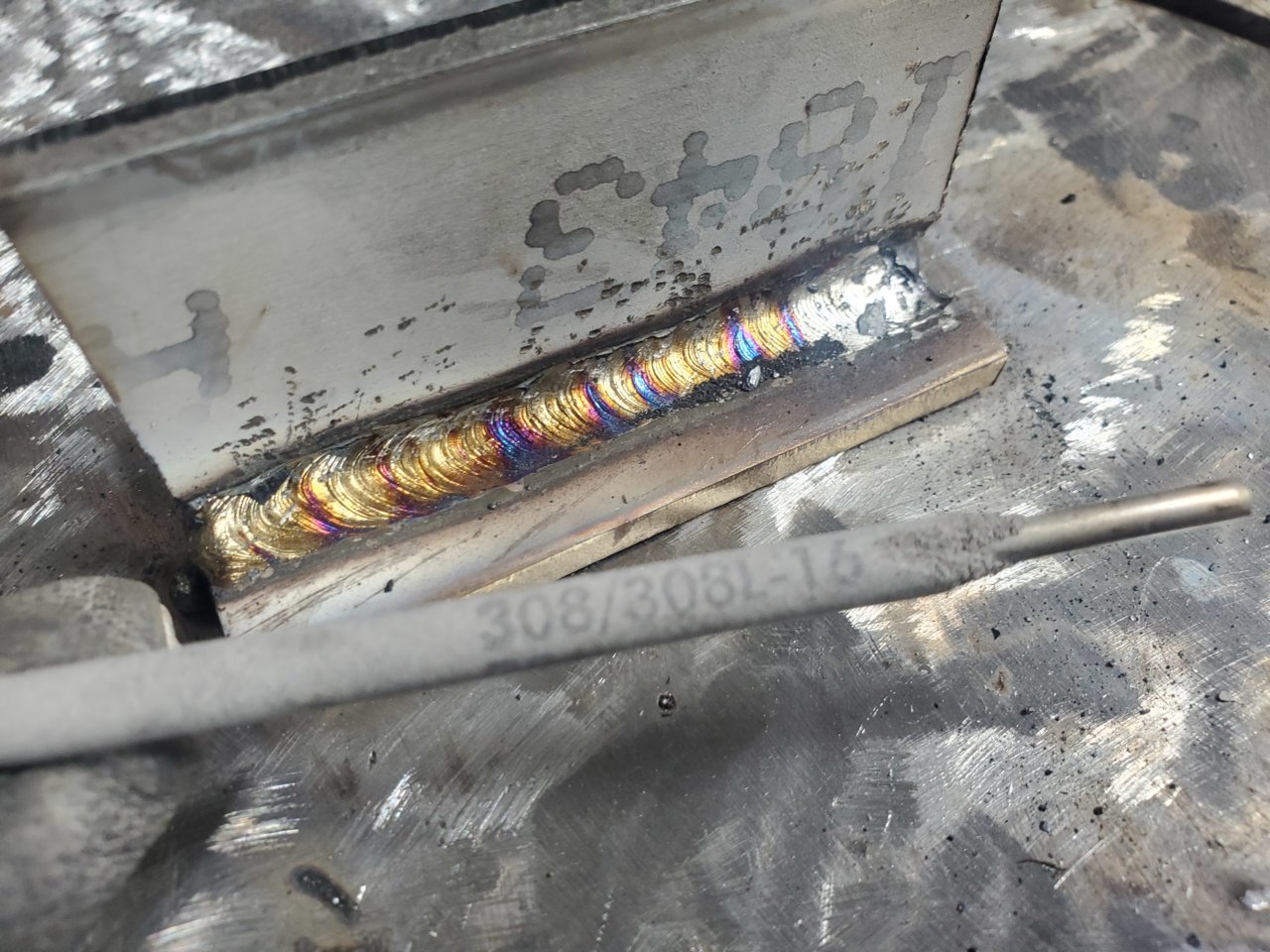

    Stick welding on stainless steel :drool:
    Once the remaining slag is brushed off

    I meant to take a pic after my slag peeled off!
    But I wasn't happy with it and decided to run some beads on it while flat.
    So the trick to doing stick, vertical uphill on stainless, is to weave left to right, pausing 2 quick seconds on each side.
    My issue was, my side to side movement was a bit narrow.
    Was told to ignore the slag puddle, which is absolutely 1000% true. The bead lays way different than the slag would imply. But still, I had a narrow bead that didn't quite connect both sides as much as one would like. The very top is indicator of that as you can see how the bead laid.
