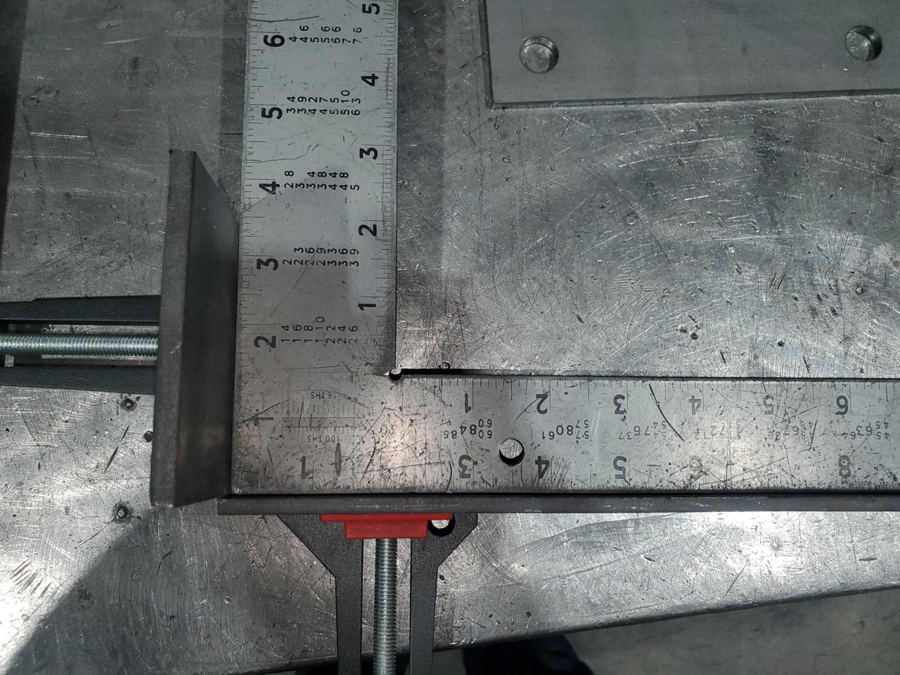

    At work at the moment but here I clamp 2 random pieces of flat bar
    Perfect 90 degree as shown on my 16" x 24" square

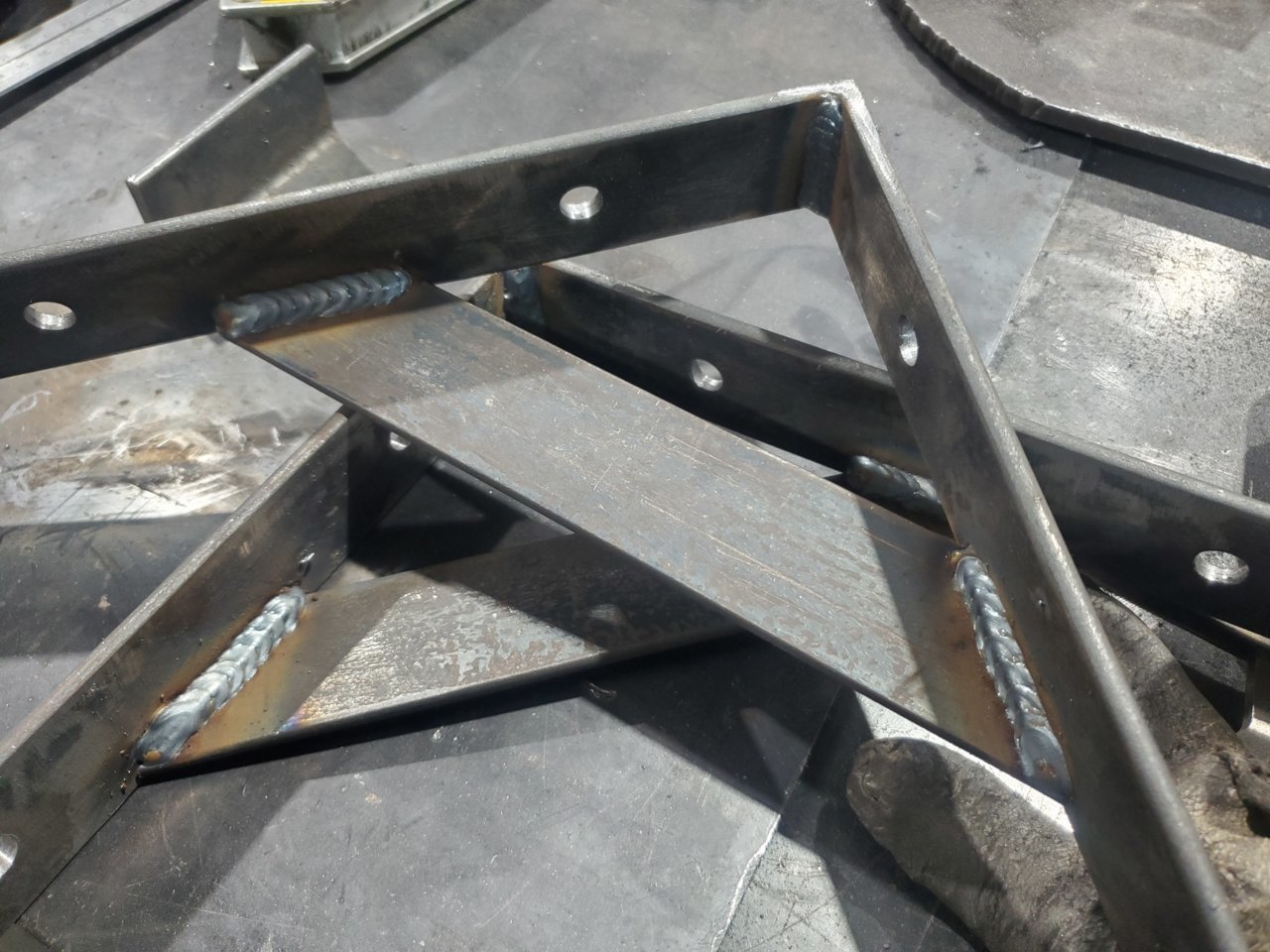

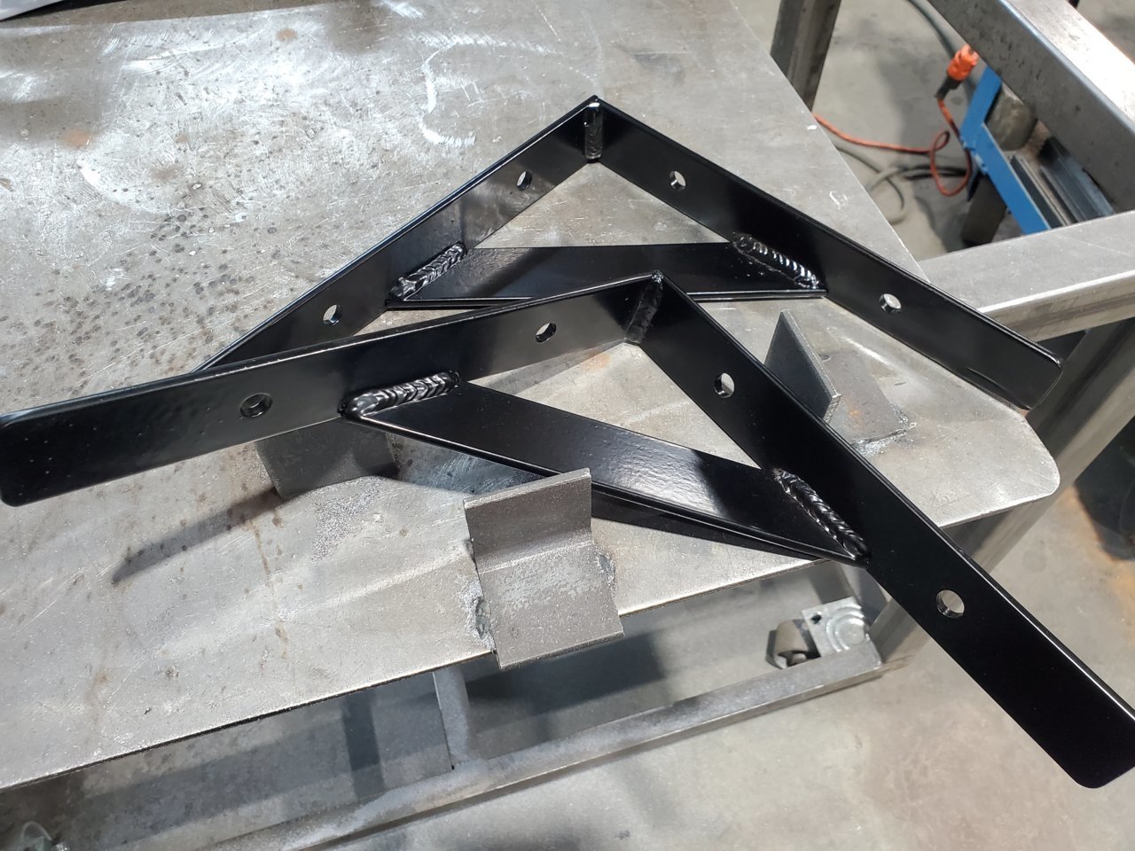

    I kept forgetting these bed stiffeners at home that I made for a member some weeks back.
    Brought them to work cause you know, free powder coating.
    Love how they came out.

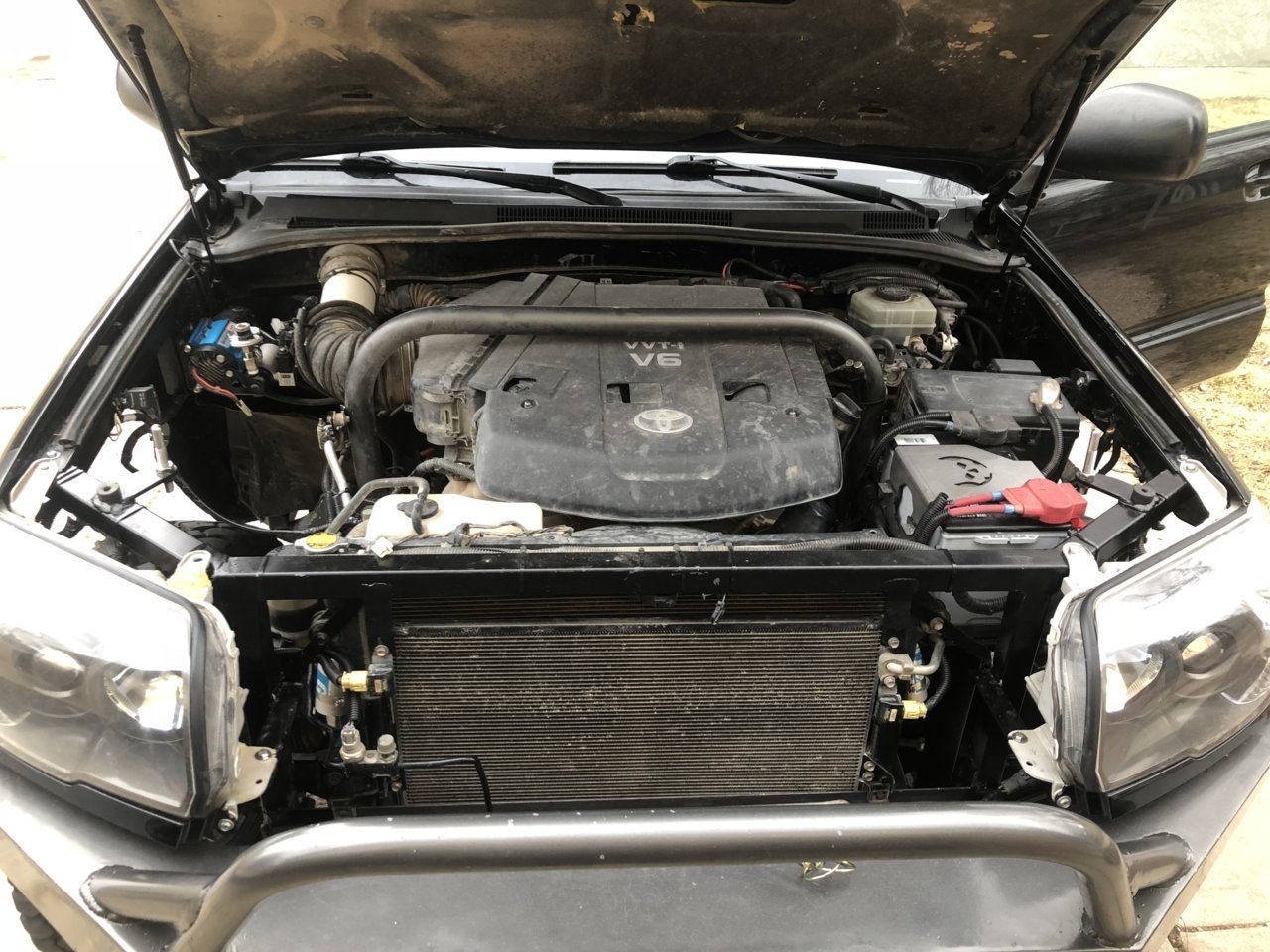

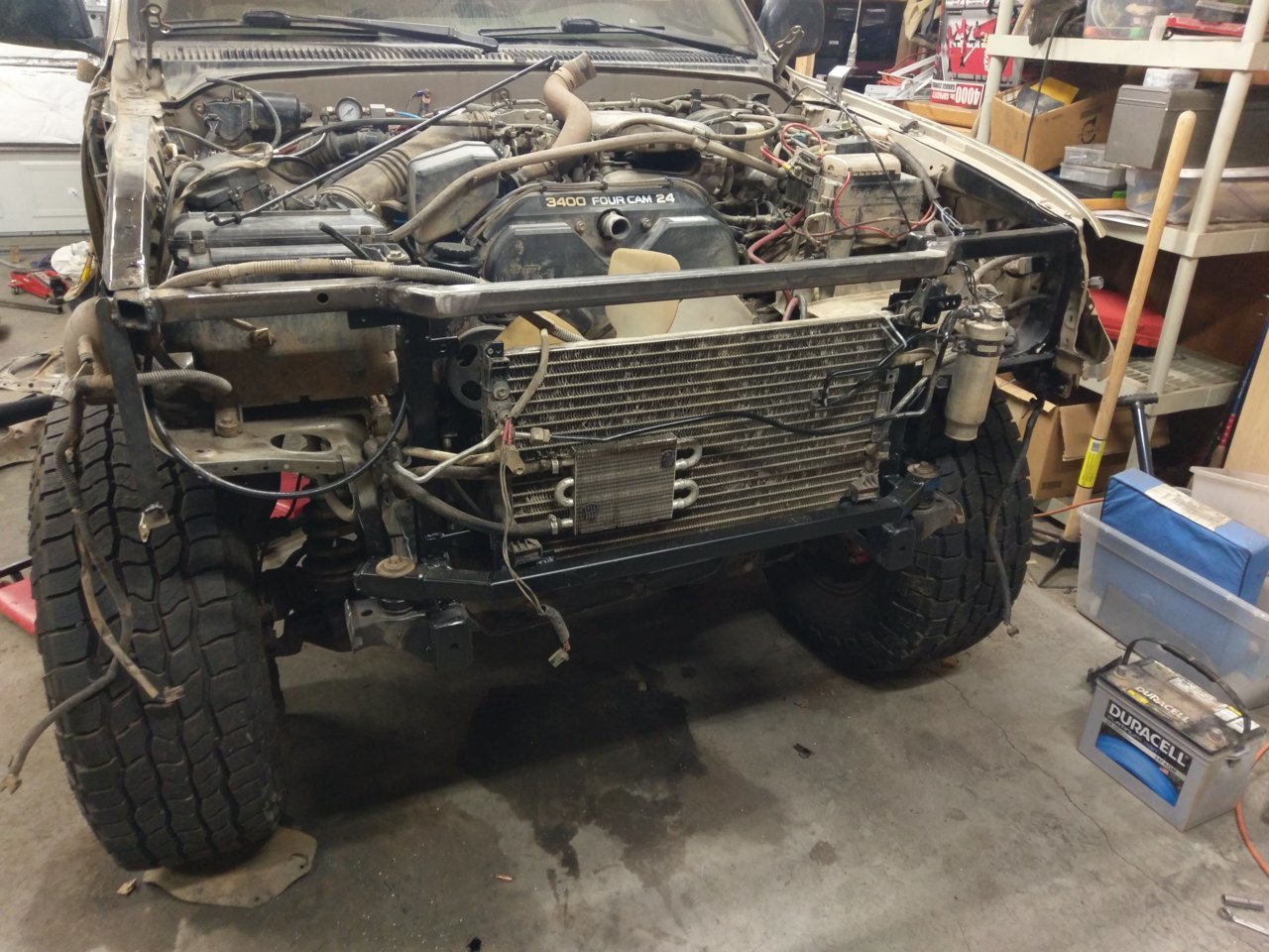

    That's @Wishbone Runner 's rig. Think he has more details in his build. I also made a similar core support on my 1st gen as well. You could build the whole thing with a 120v MIG welder and an angle grinder. Cost is not the problem, it's time. I don't recommend it for an early fab project, probably best to have a few smaller projects under your belt first. It's a huge PITA to get everything remounted in the right location, and don't even bother if you care about any body lines ever lining up again.
    That being said, if you're patient, OK with your truck being down for a while, and learning as you go, there's nothing prohibitively difficult about it. Just one of the more tedious projects I've done.

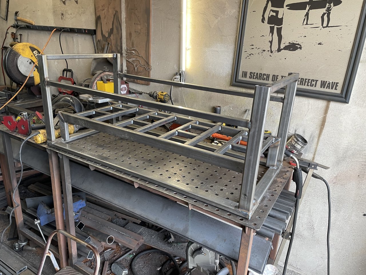

    Bunch of stuff

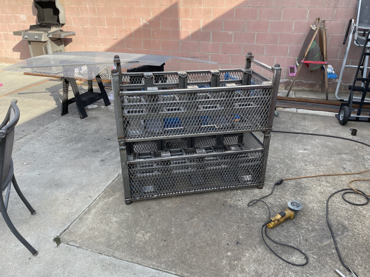

    2 out 4 motor bins complete

    Yep, more of a tedious project than a welding project. Havent had any issues with the support since doing this 4? years ago.

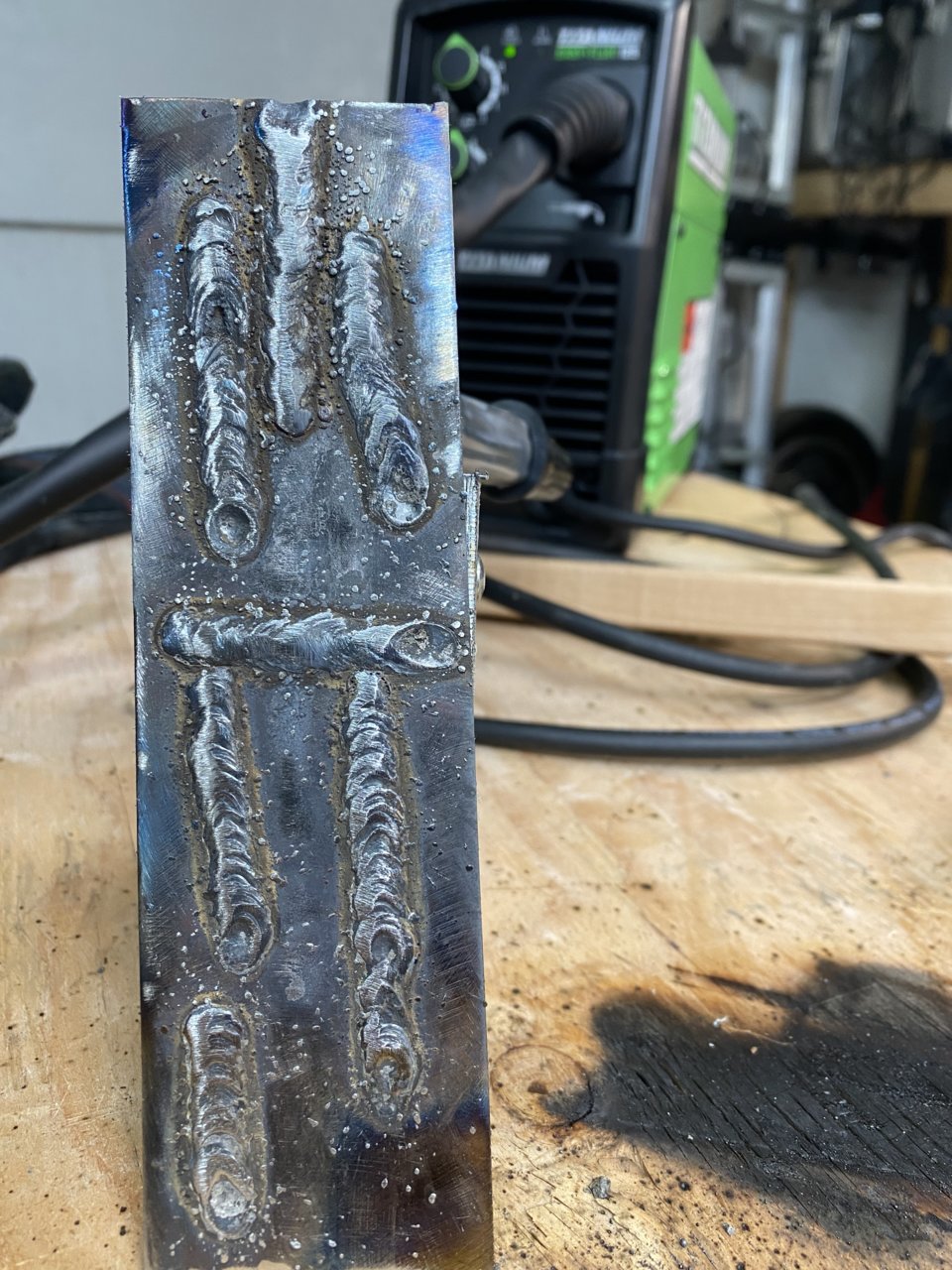

    I finally got around to trying out the titanium 125 I got for christmas. I’m slightly less terrified of it than I was a couple hours ago haha
    I have a dumb question though: can I leave the wire fed through it or do I need to remove it each time?
    Second question: recommendations for a cost effective fold up welding table? I had a piece of ply on sawhorses today and definitely caught it on fire a couple times.
    Pic of boogs:

    You can pave the wire in. The HF folding welding table is fairly inexpensive but there was talk a few pages back about one from tractor supply I think. Don’t recall the model exactly. If you can scrounge around for some scrap steel all you really need is a metal base to use as a welding table at least 3/16” thick. That’ll be more resistant to warping as you weld.

    Like others said, the HF table is good.
    Some other tips that helped me:
    I almost exclusively use this wire in that machine, the wire it comes with is kinda trash: https://www.amazon.com/dp/B00F429SZM?ref=ppx_pop_mob_ap_share. I will also use the Vulcan wire from HF, but the blue demon stuff seems to work better for me. In both those wires, you'll find significantly less spatter than the little wire roll that the 125 comes with
    The Lincoln electric tips from home Depot also fit this machine if you want to have some backups of those
