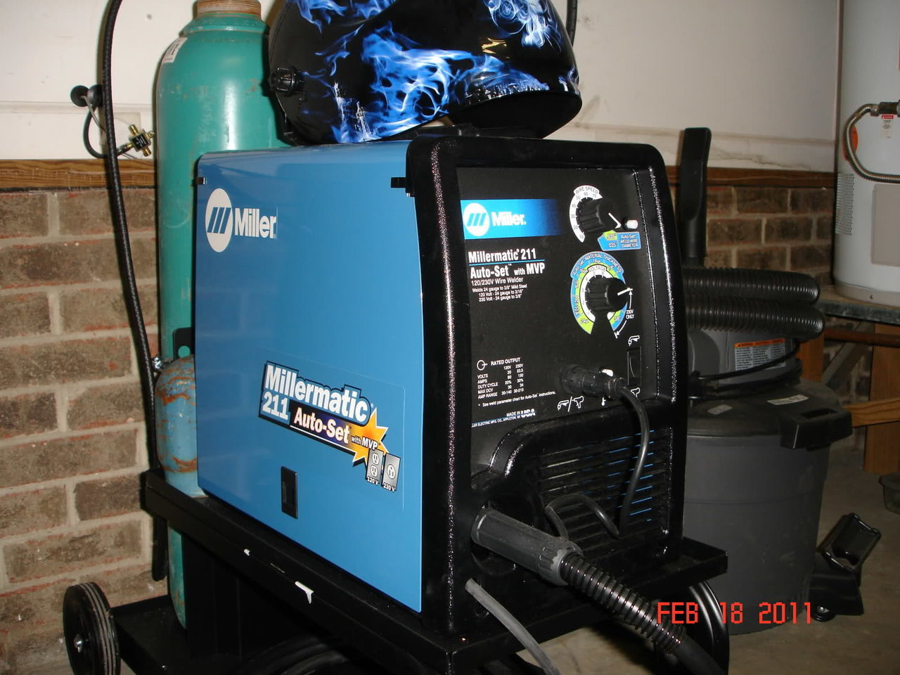

    I picked up a millermatic 211 mvp with autoset about 2 weeks ago. Your cycle time is also going to be dependant on your voltage and wattage. I ran both the 115 and 230 and not had a problem with any cycle time issues.
    granted, i'm doing small piece work presently. Also the miller dealer informed that the welders that you purchase in a welding shop run way longer cycle times than that of those which you find at lowes, harbour frieght etc. Even though they are labeled the same.
    So far my 211 and purchased bottle of mix along with some wire brushes, welding mask and other goodies is the best investment I have made in a long time. This thing welds 3/8 like it was nothing.

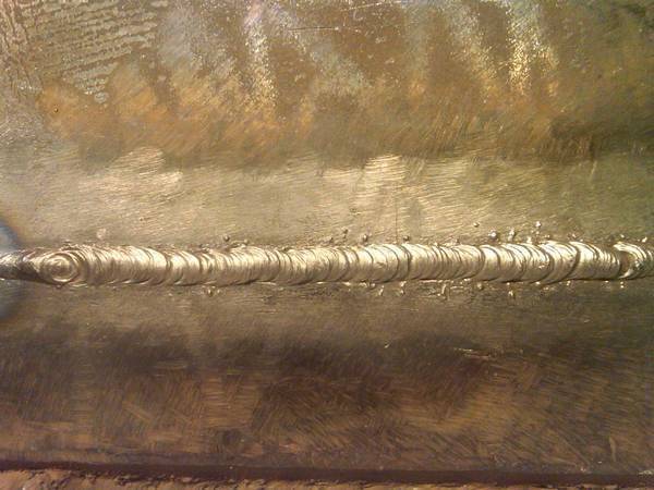

    And here is one of my very first welds ever. I welded some aluminum awnings back in like "91" for a couple days at the shop I used to work at. Other than that, I am a complete noob.

    Nice job Matic, you can definitely see it was a bit cold right where you struck the arc but heated up nice near the end. Not sure how to fix that, maybe a tiny bit more heat and slower wire speed, then just move a bit slower?

    Yea. I'm using the autoset feature for the time being so it sets the wattage and wire speed. The 211 is supposed to eliminate the cold start. I will try some more this weekend. Really lookin forward to getting my welding table built. It's small but should do me for the time being.
    I guess is simply no more than a piece of 3/8 piece of steel welded to some 3 inch square 3/16 square tubing.

    Nice beads man :thumbsup:

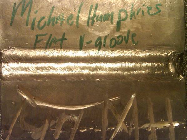

    I'm in field as we speak and your stringers look great maybe a little cold in some spots on root like said or could be rod angle and penetration needed. Don't know if you plan on doing pipe like me but wait till you get sone 6g welds. If you get those down you'll be alright

    Thanks, my instructor won't let me turn shit in unless its pretty much perfect.
    I'll be learning that in the fall, and doing destructive testing.

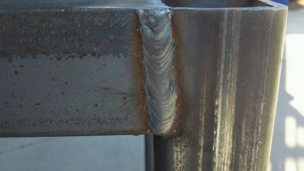

    fabbed up the frame to my welding table today!
    how are my welds looking?
