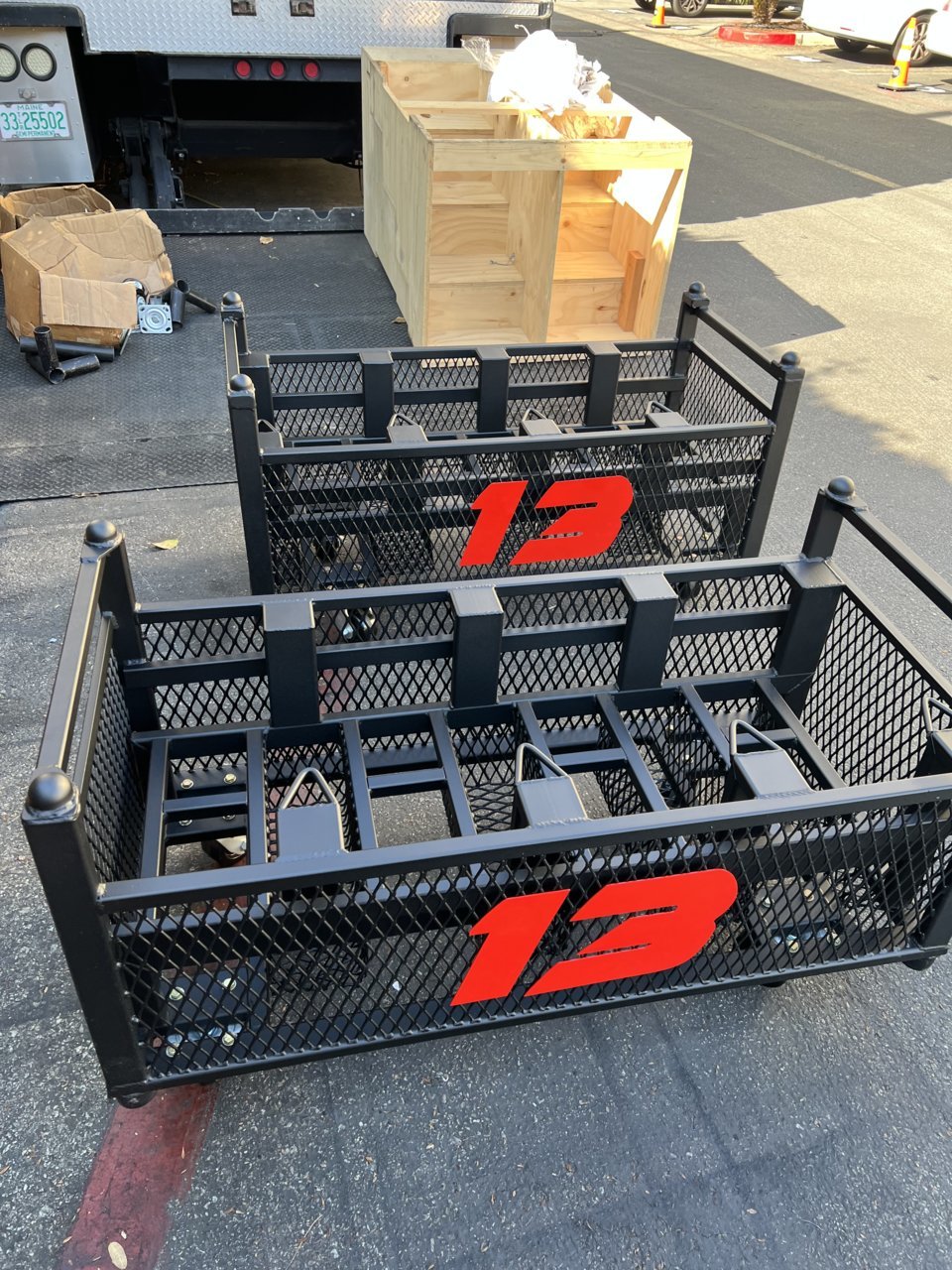

    Bins done. Then my boss told me he wants 8-10 more!! Ahhhhh :annoyed:

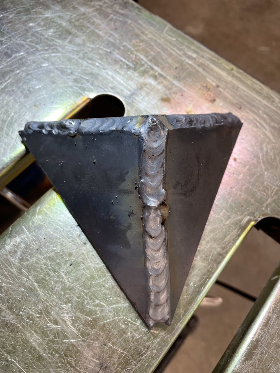

    More practice time last night. Pretty cool when your 12 year old says ‘hey dad can we weld?’. Me - ‘hell yeah!’

    One thing I suggest, run stringers before running a stitch or pattern. You'll get a good idea on the changes you need to make regarding heat, wire speed, and even movement speed.
    Yes it's boring, but you learn to read your welds better. Especially when you're running a T or something, you can tell by the convexity of your weld, how well you're penetrating.
    For the meantime, keep up the good work! That's awesome.

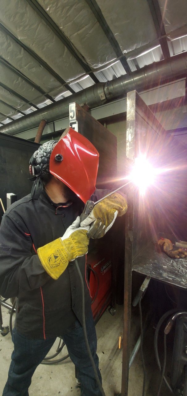

    A lot of us post our work; this is one a classmate of mine snapped of me last week performing said work :laughing:
    Didn't even know until today; vertical up on stainless steel. Need that 30 degree angle for sure -

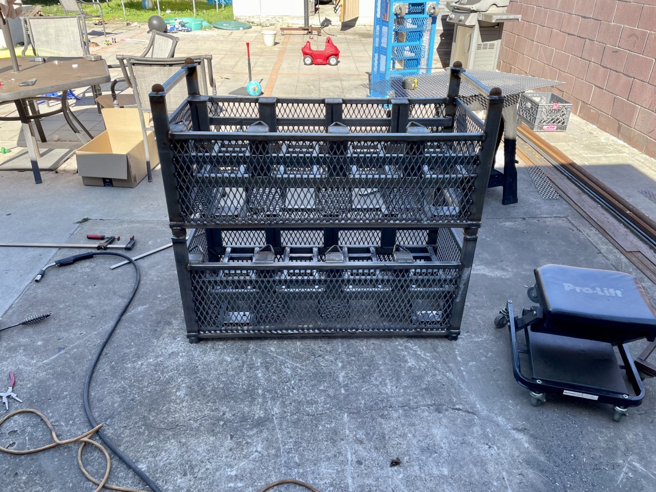

    Couple bins back from powdercoat. Very happy with the way they turned out

    That's some pretty quick turn around on the PC. Most coaters are a couple weeks back.
    The bins look great!

    Your cheating get that left hand out of there! Or put the stinger in your left hand
    The teacher should have smacked you with the ruler
    That was a big NO NO when I was in school before the Ark was built
