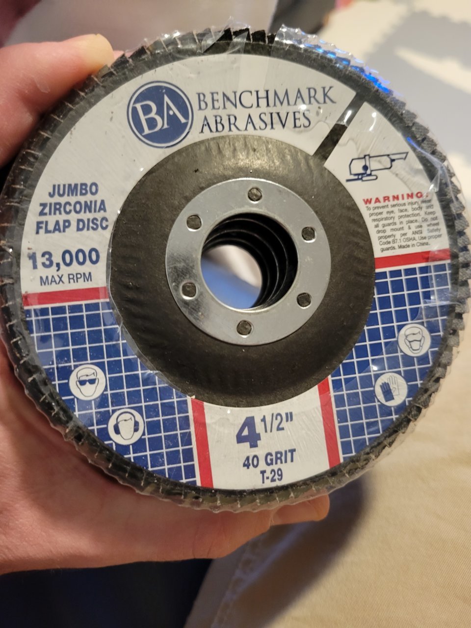

    agreed - I have these as well (40 grit) based on prior recommendations probably way up in this thread. They've been great for me. They're too thick when new for my HF angle grinder if I use the guard so my dewalt covers double duty until the flap wears down a tad.

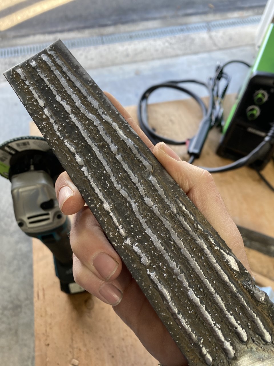

    So day 2 of dicking around on the little flux core guy, I think I did a lot better than day 1! Just spent an hour or so laying down stringers on a 10” or so piece of 1/8” x 2” bar stock.
    I read somewhere that it’s basically just making a puddle, then moving while trying to keep it the same size and that clicked so much more than everything else Id read. Slag was coming off easier (so satisfying when it just peels off in one smack), I wasn’t blowing through, etc.
    I’m a happy camper. And yes, probably not great by any means, or even good, and I can’t do straight lines to save my life but I’m still stoked on the progress vs day 1. Also ground off more than I wanted to while cleaning the whole piece. Whoops.

    Wire wheel is your friend :thumbsup:

    tee joints are the way to go ! weld one side Then break then to check your penetration though on 1/8" penetration is so good it will bend before breaking
    Crank the output up or travel slower !

    Practicing by welding joints is infinitely better than laying a bead on a flat piece of metal in my experience when I was starting out. You should try that next if you can.

    The peeps I've taught always respond well to the concept of leading the puddle, painting the puddle, keeping consistent width on the puddle, etc. rather than focusing on where they're pointing with the tungsten/stick/wire.

    My best welding instructor Used to say" make the puddle stand up and dance to your tune"

    Thanks for all the feedback everyone!
    Yeahhh, I have a wire wheel and a wire cup, but already had the flap disc on the grinder from when I cleaned the piece initially.. laziness won on that one haha I need to get a cheap second grinder and just leave a wire wheel on that
    I think I was getting pretty decent penetration, at least judging by the heat marks on the back. Definitely had the output lower than day 1 though. I was blowing through it then and definitely needed to bring it down some, I think I went too far down though.
    I tried a T on day one and think that was just too much to take in at once. Keeping it straight, where to put it, angle of the torch, tip to surface distance, etc etc etc. After today and having more practice like, actually focusing on what the puddle is doing, distance, angle, and just being more comfortable instead of being overwhelmed by everything I think I'm in good shape to try more T stuff tomorrow or next weekend. I still have a couple feet of this bar stock left I can chop down into whatever size coupons to monkey around with.
