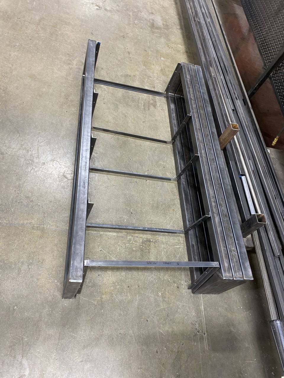

    Fabbing up the bi fold tail gate frame for the trailer. My joints will be seen so I mitered them.
    Boxed in the tail lights as well.PXL_20220219_182656342.jpg PXL_20220219_192224786.jpg PXL_20220219_193109206.jpg PXL_20220219_182648869.jpg

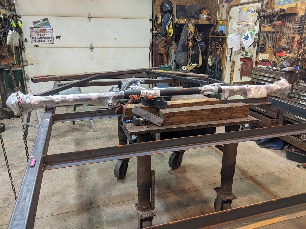

    Axle showed up. Only a small amount af shipping damage. It's not worth compaining about. I've repaired lots of these dust covers.

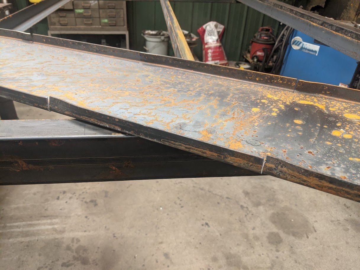

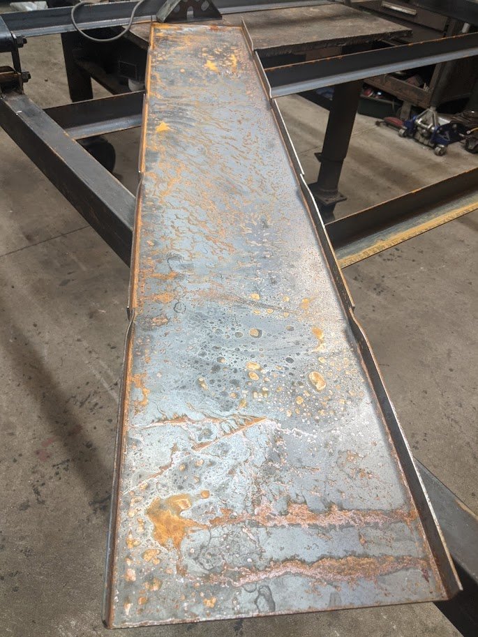

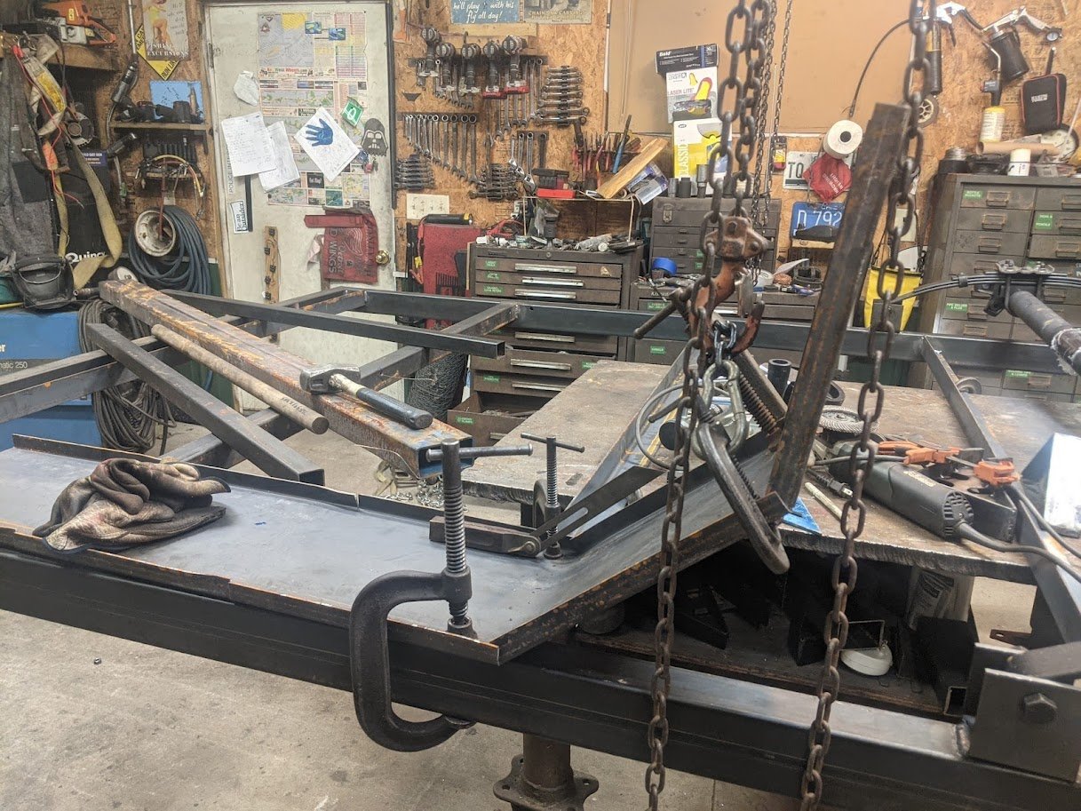

    fabbing up some 11 gauge sheet steel into fenders. I messed up and ordered the wrong thickness. I usually use 16 gauge. I can bend that by hand. I had to use the chain falls for assistance.
    DdrAsTbRPLYJ0B05ShasFtTShtxC4hi9Ohp8O67L_dd8a1d206748cdfbc173d65b0a68aa8441534ce8.jpg
    pLeglBw2bXCV7qWUCVf5_HIDA-UyCOsbdWPY0T8v_4cba81996c2141804c2fb1f0191dc2a0ed620b6b.jpg
    nLDXGBMkrDvGlMQ3AgDURY3-n-xUhwYJg9iqHQcD_709c6f20d4f9db26184558bd26b95424fefe3c56.jpg
    m2BaTCeH5uyLk1Yj3MEBFycjMGclEH50PvN_fAaU_285c894784a7686235a0969e9f332da8d5ce40e7.jpg
    BvrkE-JjIa2YCGLSF_88LaMnLL1qXatFFheTVIiC_fc858a958ece691b53c28f5a867e50489fe48a56.jpg
    The last pick is just checking to make sure they were fairly square.
    I welded up all my relife cuts. I'll knock the welds down after I get them mounted to the trailer.

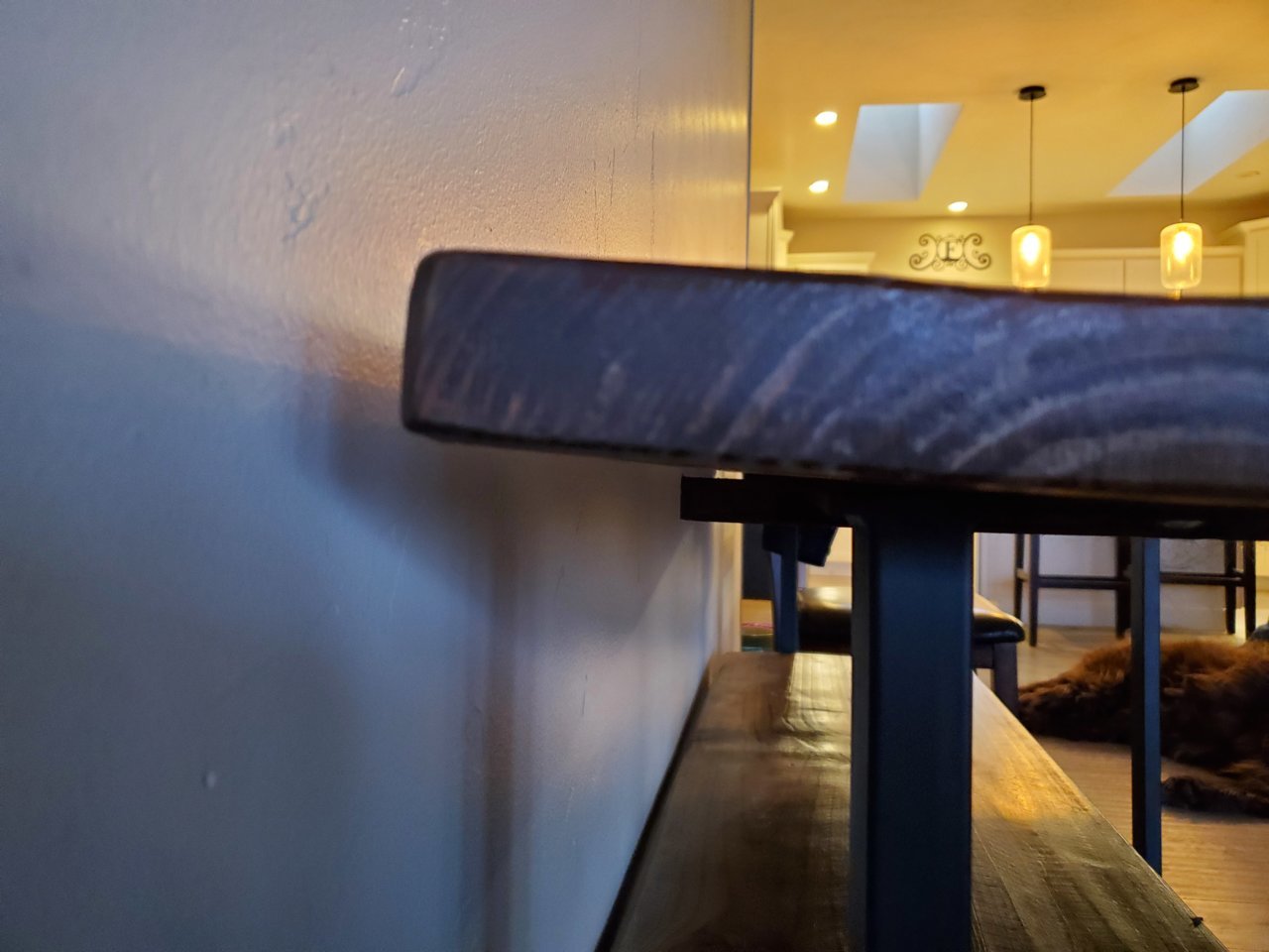

    I'm planning to do something very similar with our washer/dryer. On your current dining table, how are the legs mounted to the wood tabletop? Is there a piece of flatbar that spans between the leg uprights?

    In general, flat stock is often used.
    In my opinion, angle iron would be a better choice. You can use thinner wood for the top and not have to worry about the wood warping if using angle.
    I can only assume the original pic showed flat steel is for cost. It's half the cost using flat. Pennies make dollars.

    Cool thanks! I wouldn’t have thought of angle there. But makes great sense to do so!

    Angle is also nice because it’s easy to quickly notch and bend. Just needs a quick weld where the corners meet since it didn’t have to be cut all the way. :)

    Like @koditten said, it's flat stock under there. Angle probably would've helped with this "reclaimed barn wood" if it were long enough and secured properly. You can see how much the table top warped after a few years...
