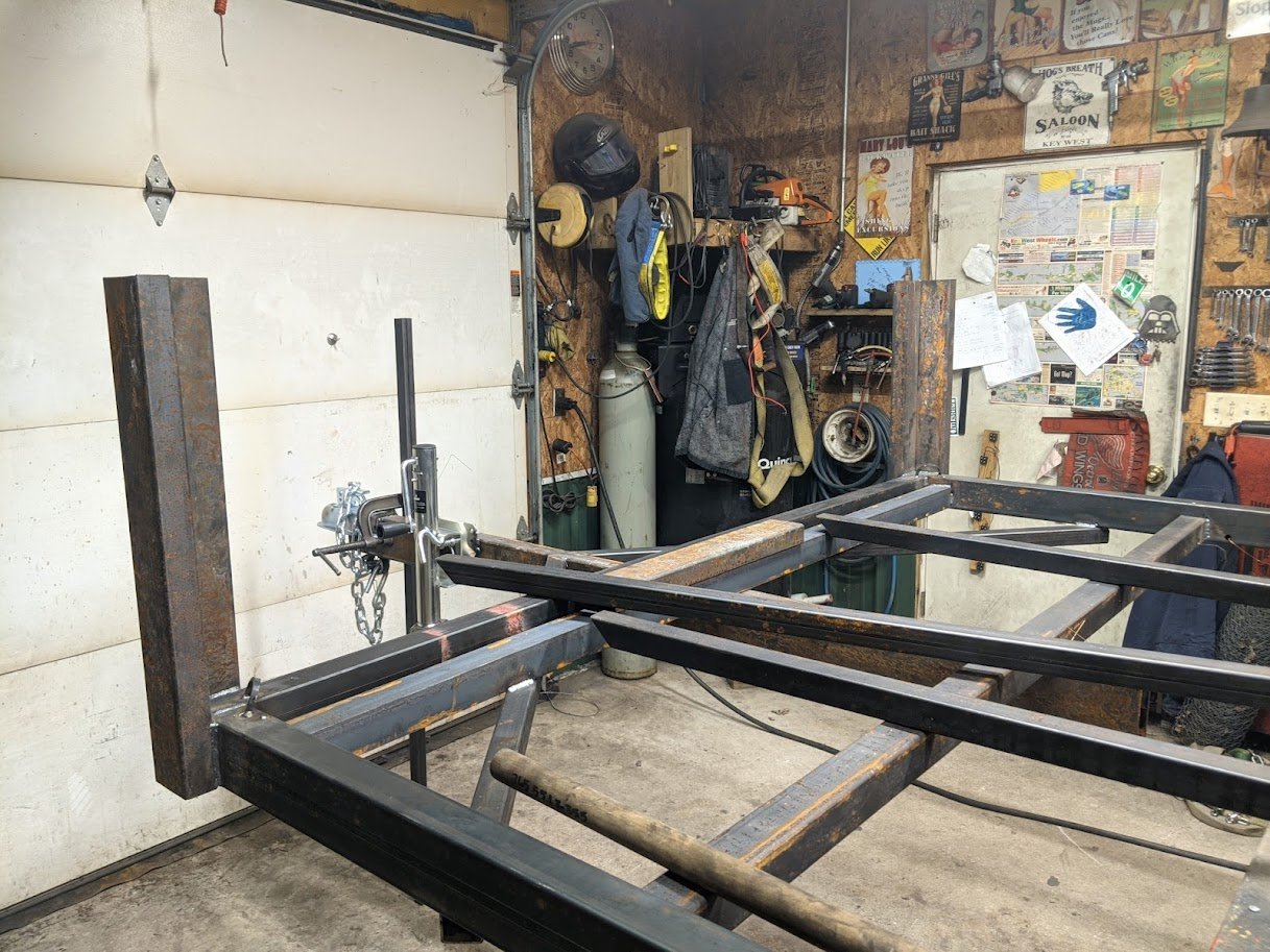

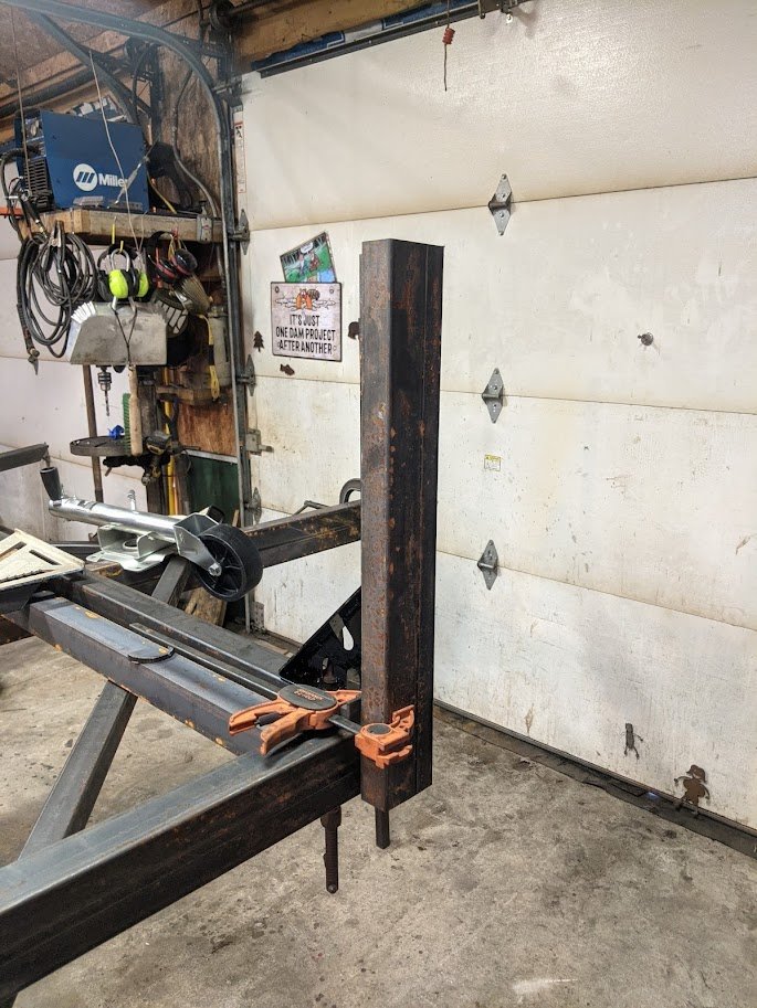

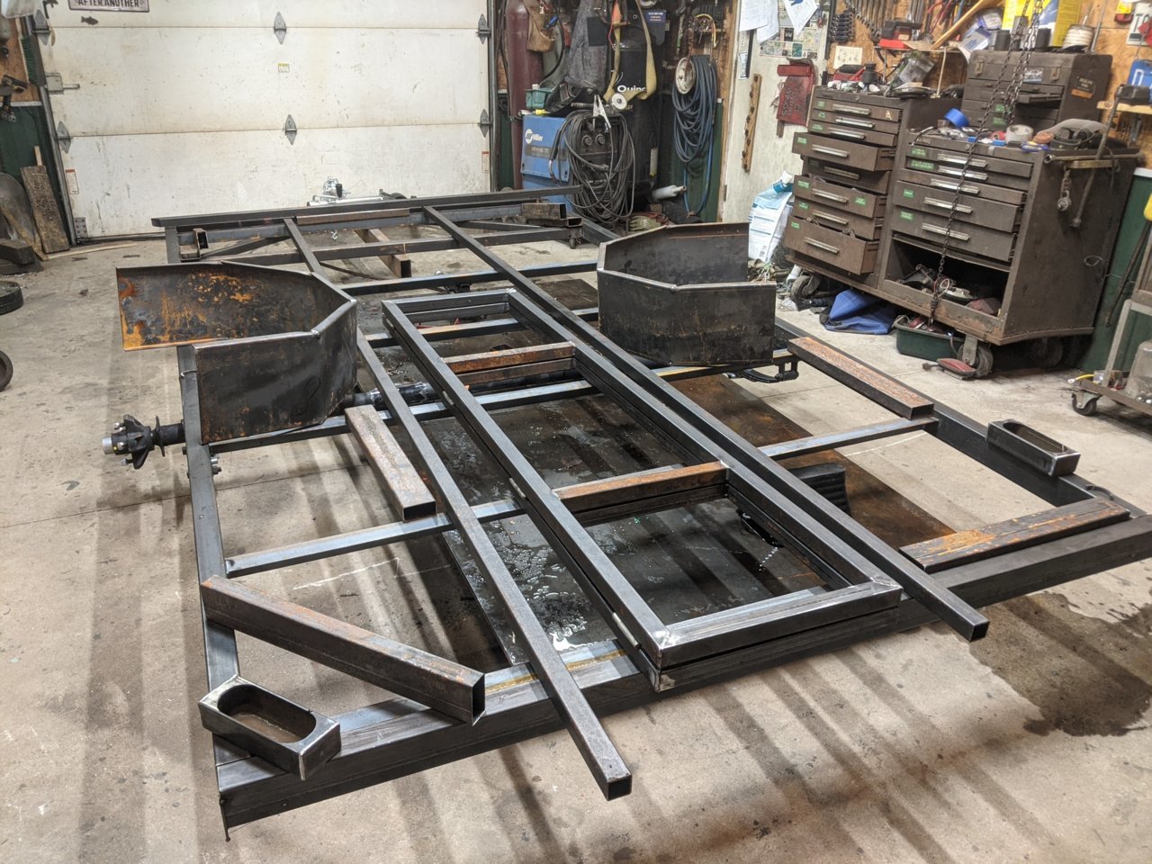

    Got the tongue welded on and the trailer flipped.

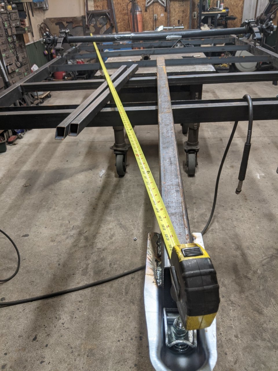

    I tack weld 16 penny nails to assist checking for square and tongue allignment.PXL_20220222_195219414.jpg PXL_20220222_195234948.jpg PXL_20220222_201005024.jpg PXL_20220222_204610101.jpg

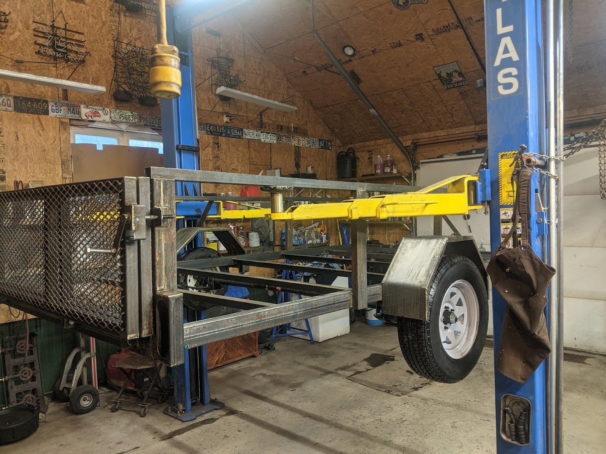

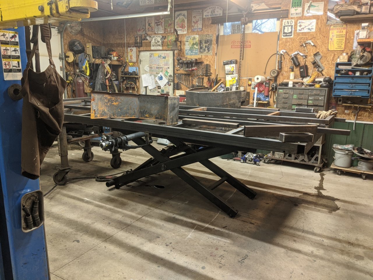

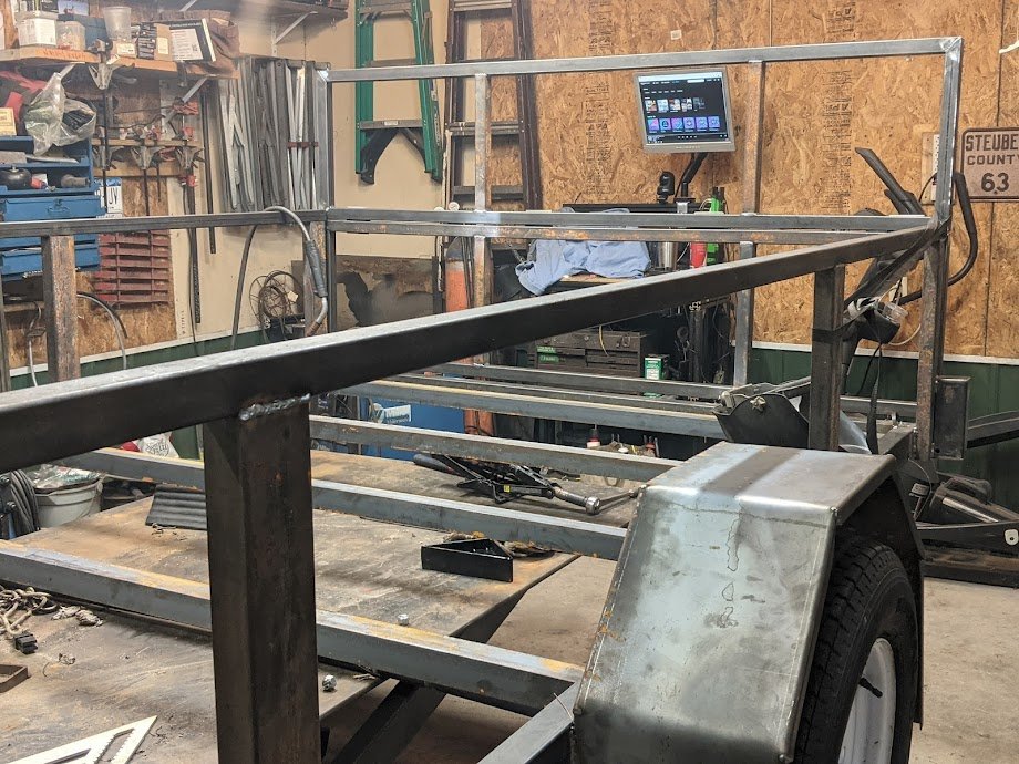

    Trailer up on the lift table. All the upright parts are staged and ready for welding in place. This is when the thing starts to take shape!
    These lift tables should be a requirement for any fabber or wrench bender!
    What a back saver!

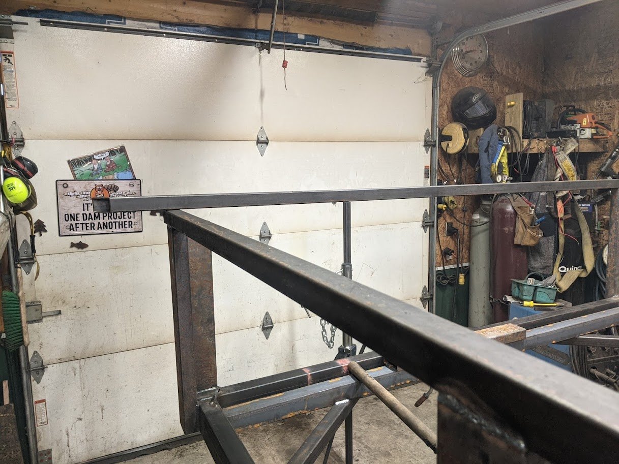

    Tacking in the corner uprights.

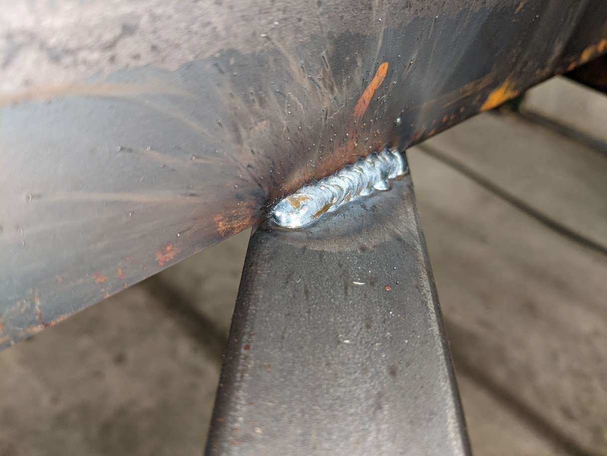

    Showing my weld style. I'm a production welder. Good penetration and move on.

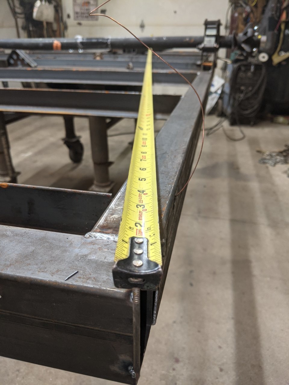

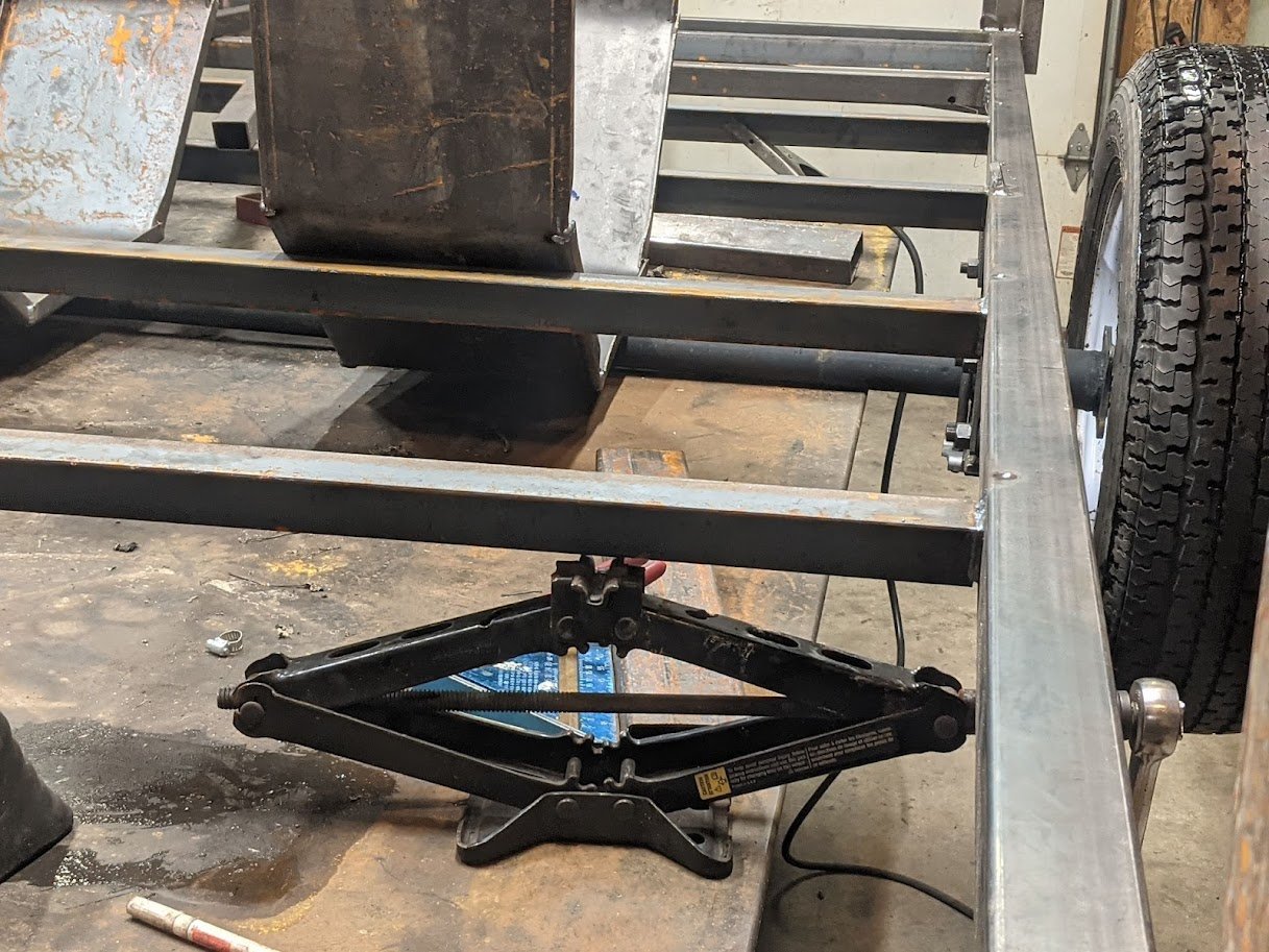

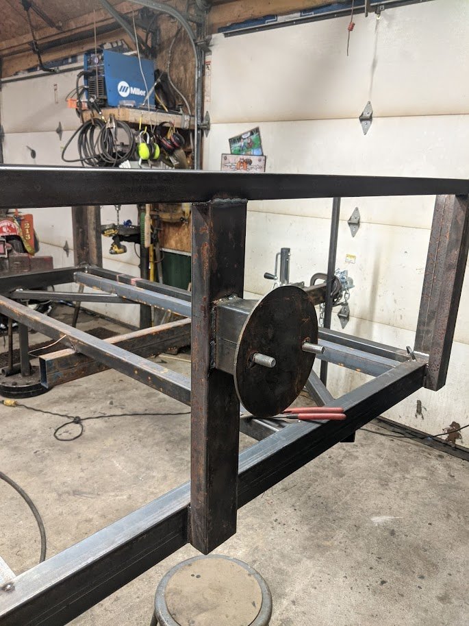

    Because the trailer is so long, it tends to bow down on both ends. I place the jack under the back and prop the front to take the bow out. The bow is mostly caused by the shackle and spring hanger where the welds shrank the bottom of the tube.
    I didn't think the camera would pick up the bow, but I can see it with the eye.

    FoWdKL8vWzlxv4CI_3QD2eBXJkdHeRSd6AaIVaSB_5f23f4b812cbe67d009862712de1b3974e44875f.jpg

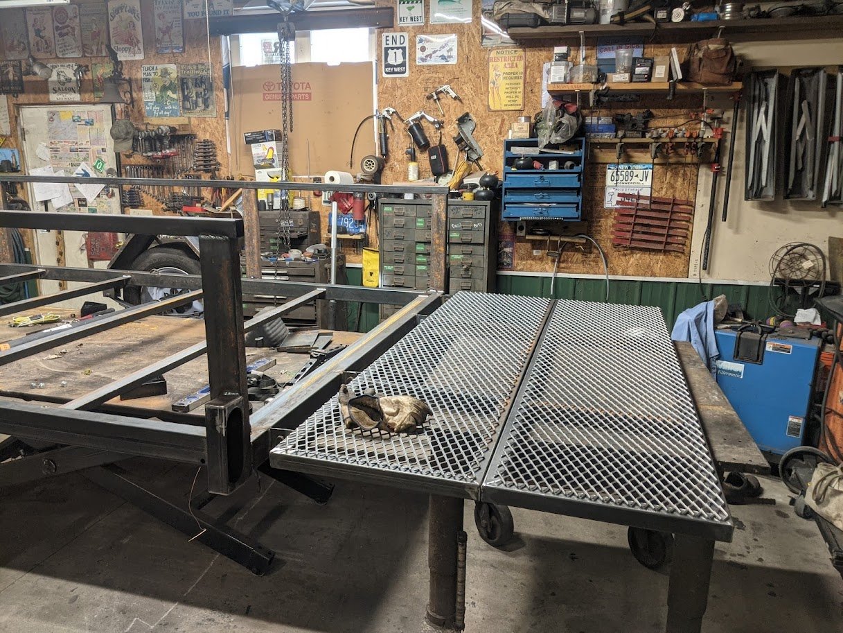

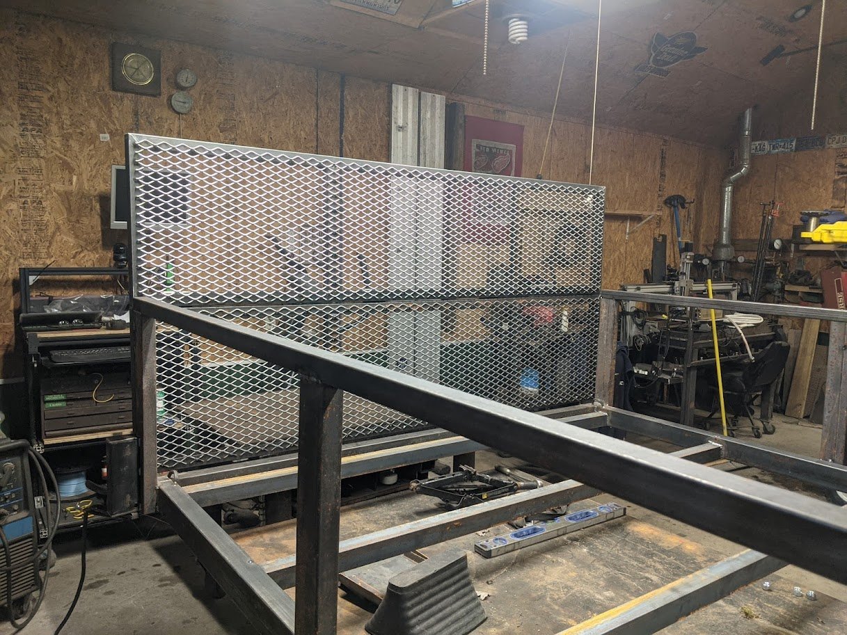

    Top rail welded in...mostly. Still need to do the inside welds. Fenders are about 80% welded in.
    Bi-fold tail gate welded in place. Still need to do latches and attach the expanded steel.

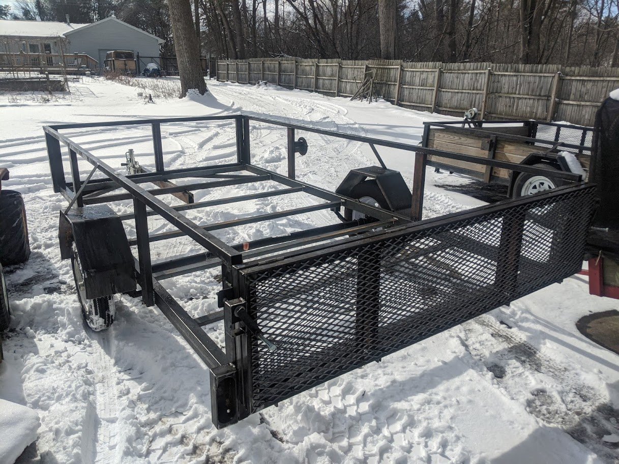

    Dun weldiong the trailer.

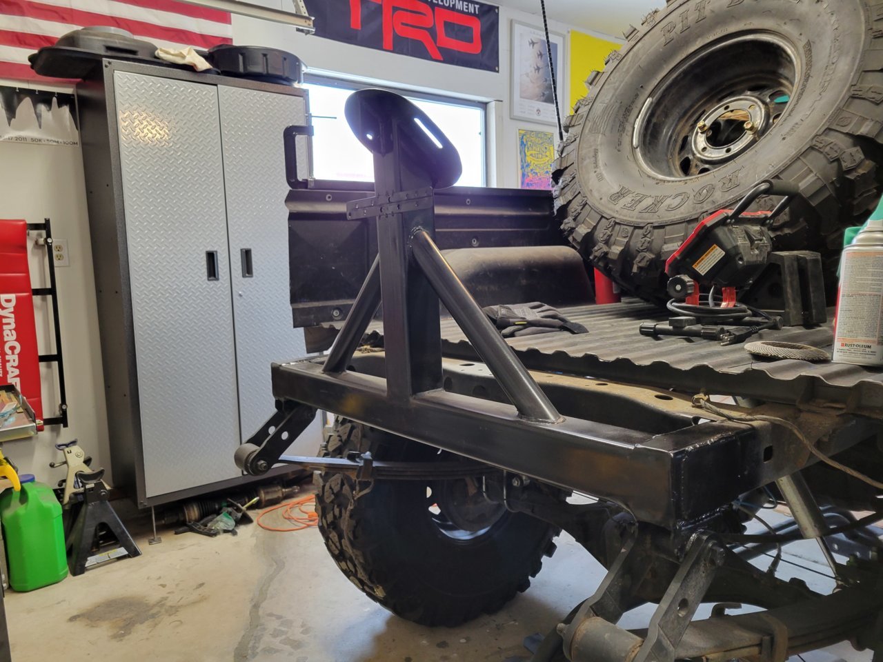

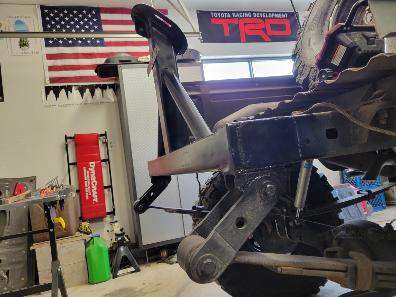

    Foldable tail gate with crank bolts to prevent rattling. Spare tire bracket installed.
    Acid washed and up on the hoist drying in prep for paint. Hopefully tomorrow.

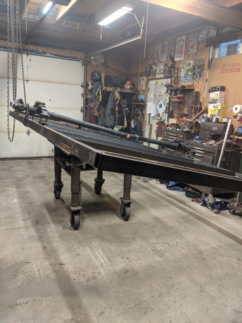

    Moving from one side of the shop to the other.
    OrZBHOuWl81LTYE0-mVebfrpgxSQA7Zm2chl153r_f9db178d928aa009c1e71873cde3a34d0b4f778f.jpg
    Drip drying on the hoist.
