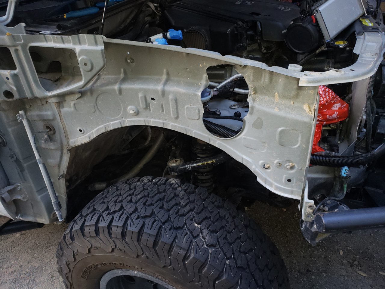

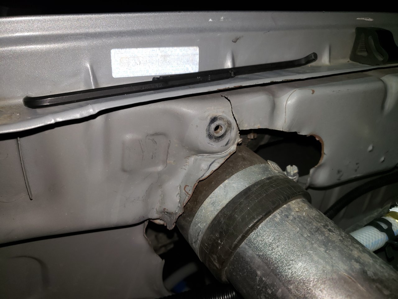

    Looking for suggestions here:
    This is by the windshield reservoir in a 2nd gen. The prior owner punched through a snorkel here, and I've since beat the shit out of the truck on washboard roads. Its not clear in the photo but the top of the crack is totally unaccessable from above--it's under the hood flange.
    My plan is to see if I can drill out the end of the crack from below, then weld the accessible part of the crack shut. Then maybe clean up some of the mayhem around the snorkel cutout, and if possible, weld a 1/16" doubler piece over the crack.
    I know this is a stupid question, but... any suggestions for welder settings for repairing the crack? I'm quite inexperienced at welding but have so far been successful in a handful of projects. I don't have a scrap truck body to tune it in and practice though.
    Edit: this would be with mig, .035, and whatever the standard gas mixture is... I'm using a green harbor freight setup, sorry, it's what I could afford.

    If you remove the fender, you will have access to the top of the crack.
    Kinda hard to give setting suggestions. All welders weld different.
    Whatever you do, you will be basically tack welding. Welding vehicle sheet metal is easy to burn thru.
    I have a piece of flat bar copper that I use as a heat sink and backer when welding sheet metal.

    Better safe then sorry disconnect the negative battery cables.
    For all the welding on lighter gauge metal I only use .023 wire it gives much better control.
    Like Kirk said setting is all so very different so many things effect it.
    Source some scrap metal even if you use steel cans cut apart trial and error.
    A vertical butt joint is going to be difficult for a novice welder without some practice .
    This is one of those things being up close and in person gives one better ideas of how to just do this fix.
    Perhaps a piece made to fit on the outside of the inner fender that way a heat sink can be placed on the inside.
    Good Luck!!

    Well I'll be damned, the fender does come off!
    Thanks for the suggestion. I can now see that the whole panel is fucked, there are like 6 cracks radiating from that cutout. Perhaps not surprising, this is a huge opening that appears to have been cut using a pair of pliers and a hammer, not a saw.
    None of the surfaces are flat here, I'm definitely in over my head. Hopefully I can cut, bend, and weld something to fix it. Presently at a loss.

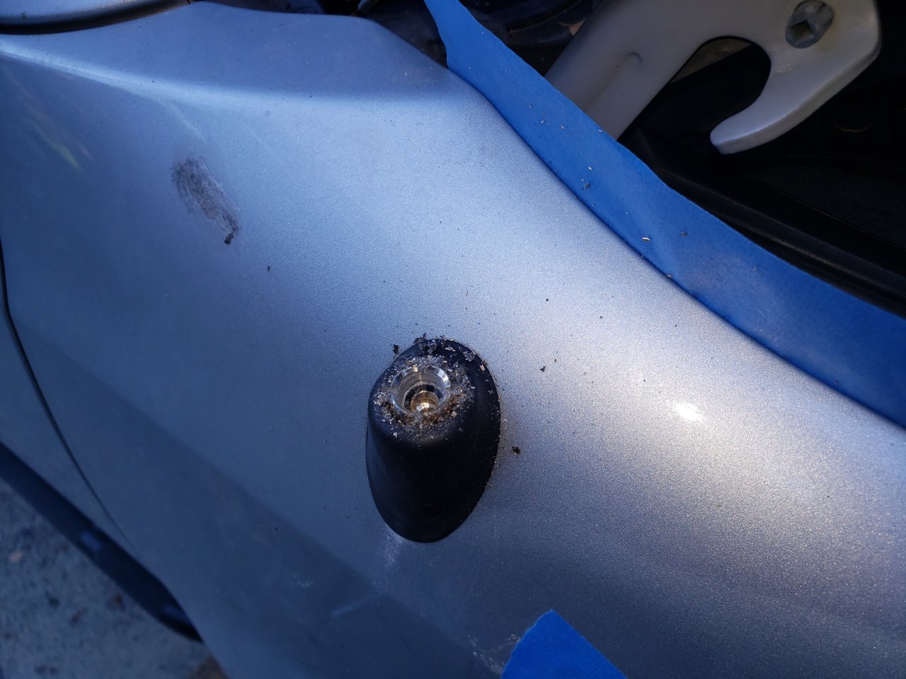

    Also, the antenna mounts on these trucks suck. I had to drill mine out. Now I'll have to buy a new one and pull the dash to wire it to my radio.
    Just wanted to complain.
    Thanks! I might have a spool and a tip for .023 somewhere, if so I'll swap it in.
    I'm thinking I might do some practice welds on my commuter car, maybe inside the trunk? Just to get a feel for welding on body sheet metal. Zero experience there.

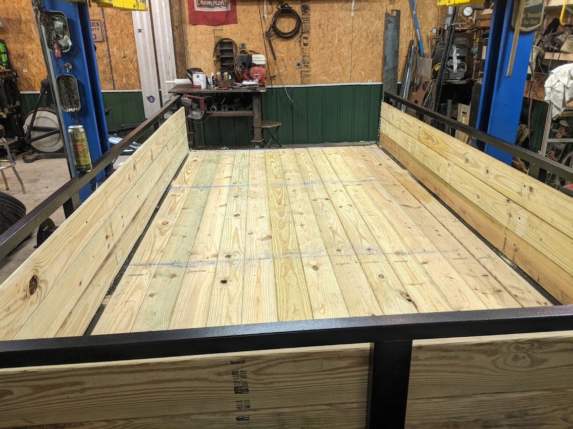

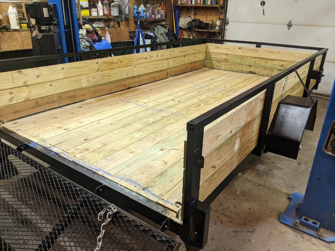

    I finished up the trailer. I was wonhdering how long it took me working 3 hours a day on the thing.

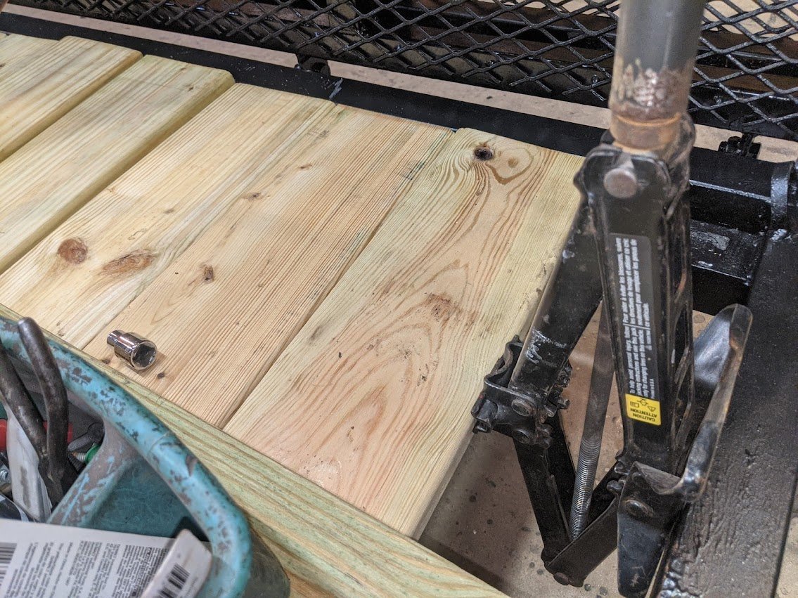

    A person can find a use for damn near anything these days.
    An old scissor jack with a shitty socket welded to it makes a great board compressor. as most know, the lumber these days is only less crooked that a polatition.
