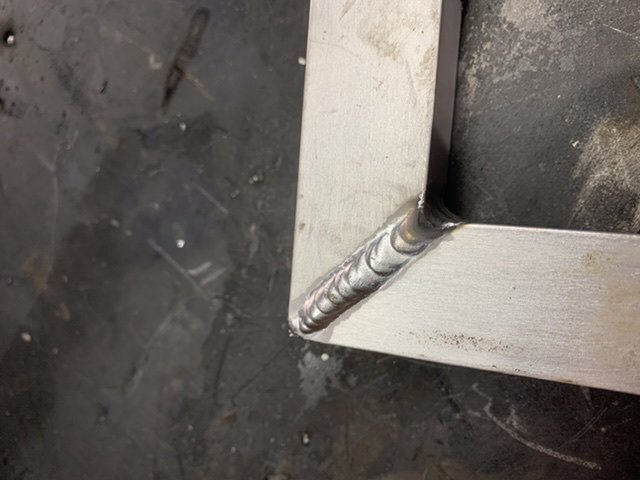

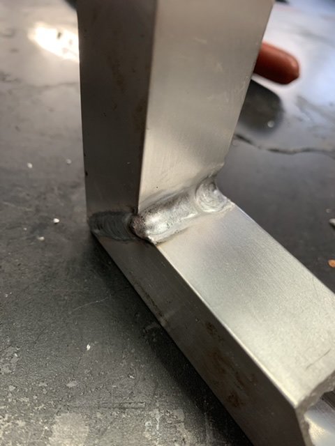

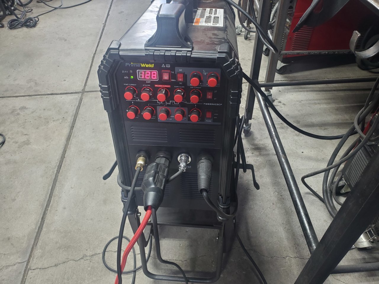

    I just got the Prime Wled 225X setup. First time running a TIG machine. First time welding aluminum. Welds aren’t great yet, but it’s pretty fun. Need more practice so I’ll be ready for my project.
    1” AL sq. tubing x 0.065” Wall
    Settings:
    120Hz
    40% balance
    90A
    3/32” tungsten
    3/32” 4043 filler

    Awesome. Any advice? I think I need smaller filler rod for this thin gauge tubing. Outside miter joints are pretty hard ☹️

    Run hotter than you think you have to; worst you can do is run cold only to stay on the metal longer hoping for it to puddle.
    I haven't done aluminum yet on TIG, but can say the balance is supposed to help out a ton since the surface layer has a higher melting point than below it.

    Breaking through the oxide layer takes a lot more heat than the base material.

    I noticed that. If I tried to slowly wait for a puddle, once it started I would immediately blow through the material even though I was only at 1/2 pedal. It seemed better to start hot and fast then throttle back once the puddle was started.

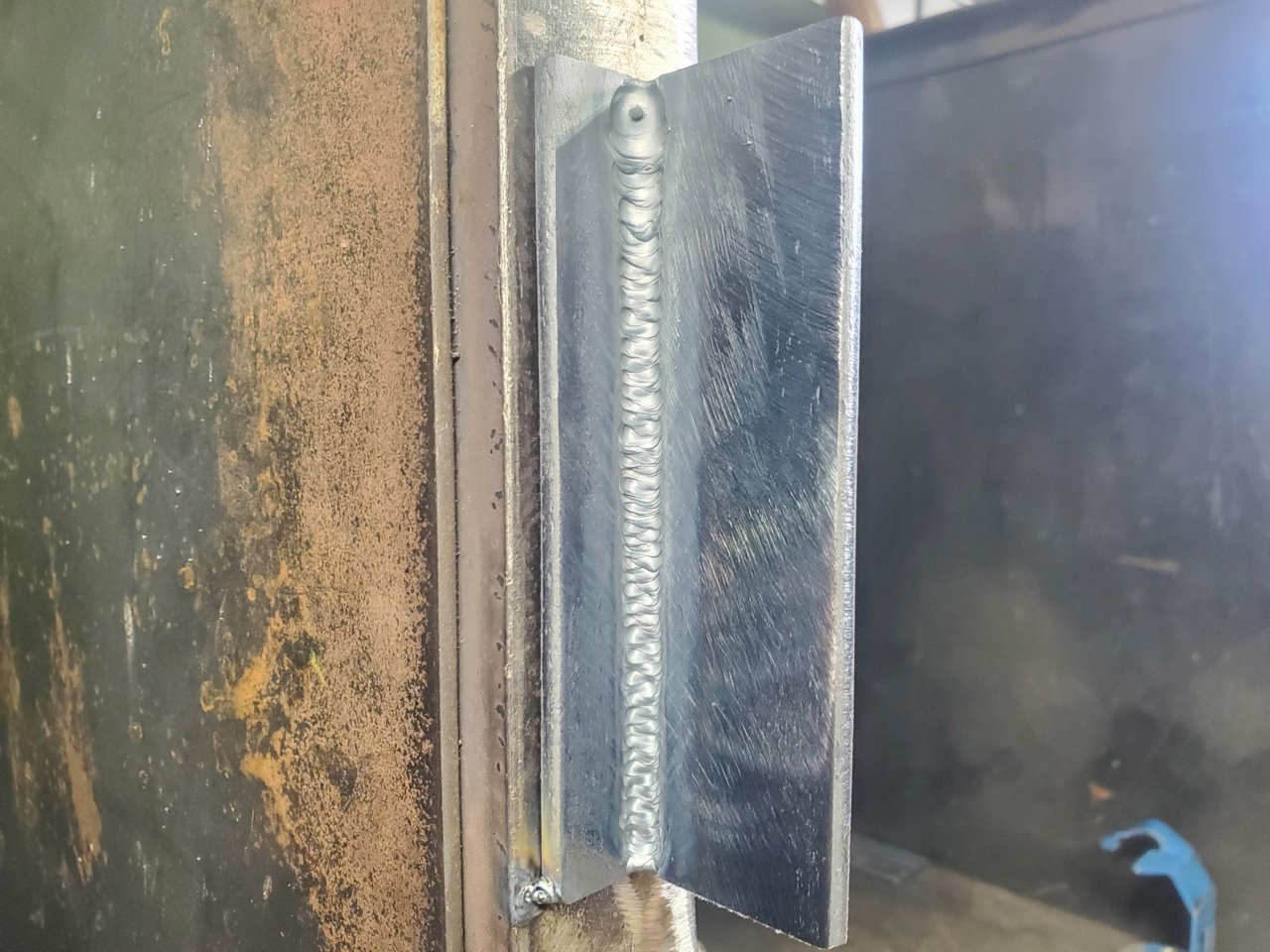

    Second try at vertical up on TIG
