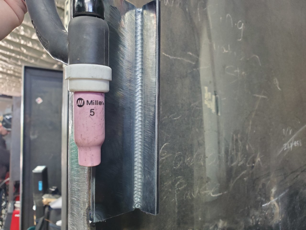

    Decided to try a smaller cup, because in theory it should work better in a joint right?

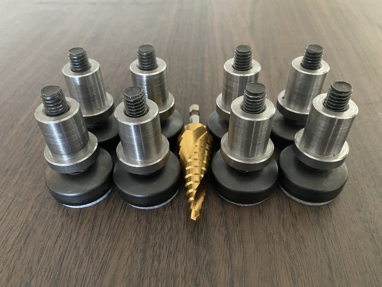

    I just weld on nuts to the ends of ours; keeps costs down but it does add a bit more work :bananadead:

    Once you use Weld on Nuts you get spoiled !!
    Then the weld on Female pipe nuts make building manifolds much easier.

    Yesterday, different cup size and today, a different electrode.
    Left half is with 2% lanthanated (blue), and right half is 2% thoriated (red).

    If possible try some of the clear cups it makes seeing in tight corners easier
    Kwikvette[QUOTED] likes this.

    I may just have to buy some.
    We only have cups 4 through 7, and none clear.
    Bivouac[QUOTED] likes this.

    I use basically everything and the kitchen sink. Usually an angle grinder with a wire brush on it is my go to. I have 4.5" all the way up to 7" on the 4.5" grinder (those get sketchy lol). For super tight spaces I have an assorted wire brush set for my cordless drill. It can get messy but for heavy strip jobs I have used chemicals to strip the paint too.
    I have never tried to burn through paint, but I assume if he wanted to try this he would still need a bare metal spot to start no?
    Beautiful!

    Thanks!
    Just a newbie starting TIG.
