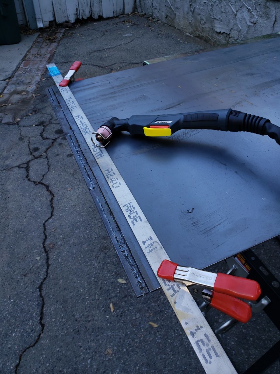

    Back to working on my truck this weekend. Fixing tears in the bodywork around the engine.
    Turned out my plasma cutter wasn't working right, it was always stuck on minimum power, but PrimeWeld stepped up and is shipping me a replacement unit!
    Struggled to cut 1/8" plate, hmmm....
    Anyway, I can use the plasma cutter on body panels, right? I plan to grind an area for the return clamp and to start the cut, then hand trace over the paint. Is that dumb?
    I'm going to try cutting and bending some 1/16" stainless panels, then weld it over the body sheet metal after cutting out the cracked/fatigued areas. Going to see if I can tig it in place, but might fall back on mig. It is in a corrosion prone place, so trying to minimize rust, but obviously the base metal is steel bodywork.

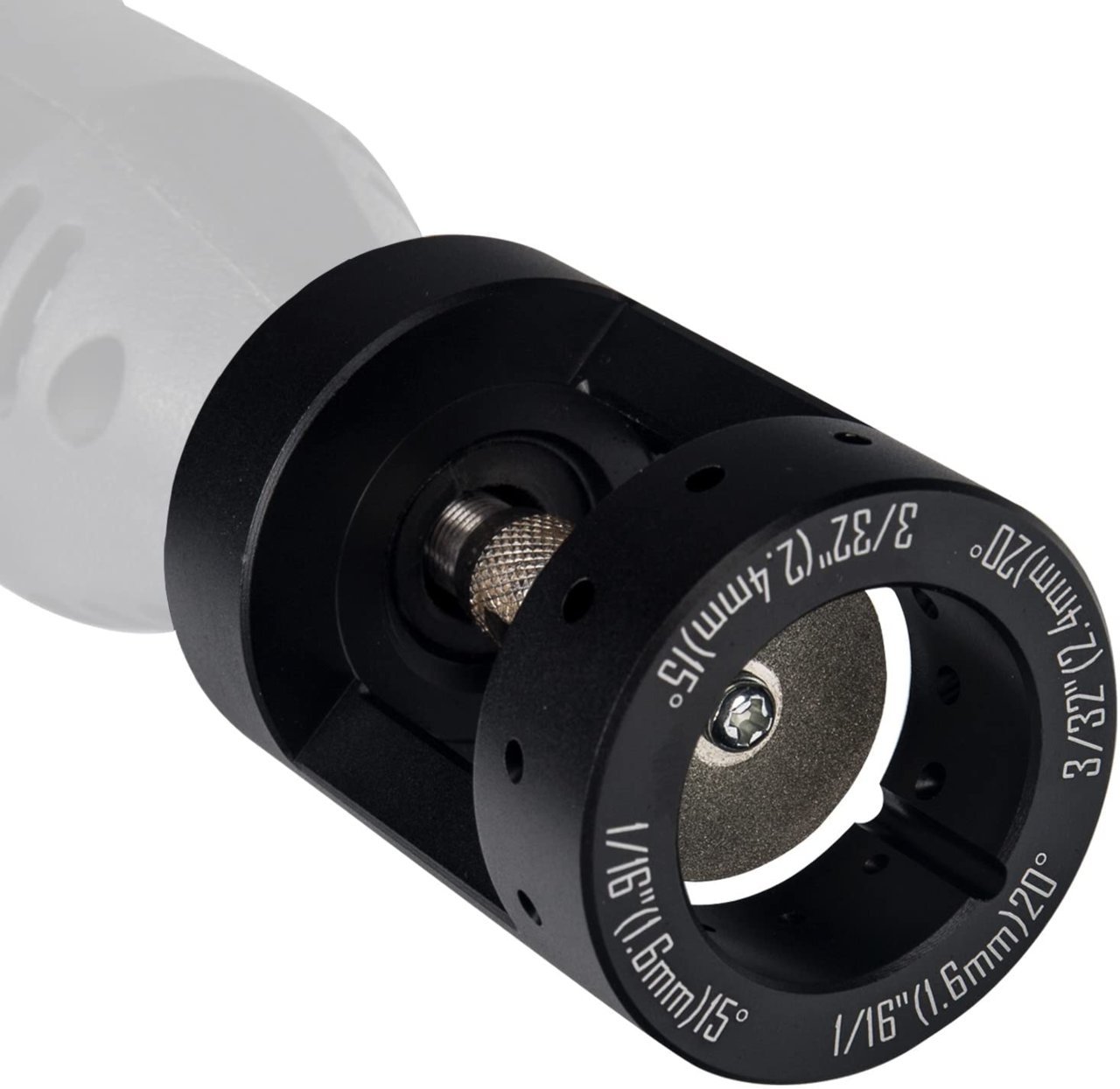

    Oh and another question, can anyone recommend for or against this item for grinding tig electrodes? So far I've been doing it by hand on a bench grinder with inconsistent results.

    I do. I have it on my milwuakee rotary tool with the provided wheels. I'm not the greatest tig welder but I've seen some good results with it. They come out up to my (low) standards lol

    To grind your tungsten you are doing it on a new wheel just for grinding tungsten ??
    Any other wheel will contaminate your tungsten. Causing issues.
    You do sharpen it the correct way with the tip pointing in the upward direction to the wheel and not across the wheel .
    There are a few of these devices to sharpen Tungsten some good some better.

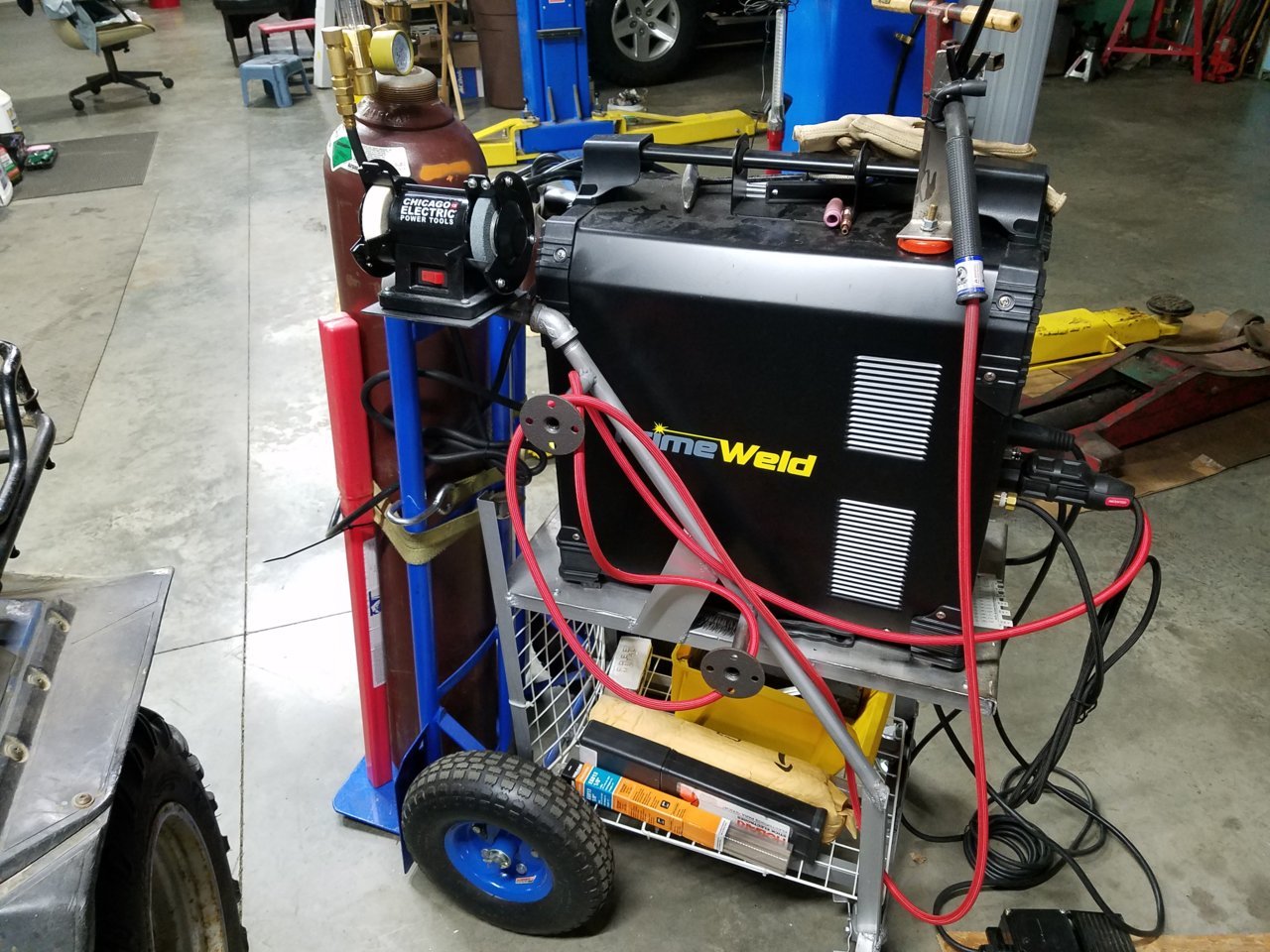

    I agree with your points (not across), and use only for tungsten).
    But, I was using the "tip updward" method when my fingers got injured as shown in the post a few days ago. Not 100% sure what happened, but the tip may have dug into the wheel and pulled me in.
    You can get the same point with the tip facing downward. Takes a little more practice, but safer. For me, I can go across to make the point, then just briefly grind vertical to finish with the grooves going vertical and it's easier to get a good point. Seems to work fine.
    I mounted a small grinder on my TIG cart and use it only for my electrodes.
    mk5, Kwikvette and koditten like this.

    I think I saw you already use one at school, but if not, I know you'll enjoy it. I like the SMAW too. It's super smooth and easy to start an arc.

    BTW, I tapped the extension cord for the outlet for the grinder. Somebody on here called me out on it saying I was pulling from the same voltage supply as if I had just tapped the welder plug cable or internal.
    I only tapped the extension cord in case I had to send it back for warranty work. I didn't want to give any reason for them to reject my warrantly claim.

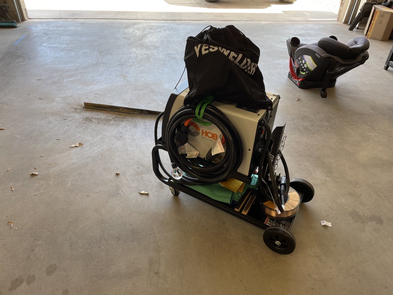

    After a couple of years of telling myself I’m gonna buy a welder I finally did it. Got a Hobart 210. Still waiting on a bottle since apparently there’s a shortage, but I’m still having fun with the shielded wire. Still adjusting to it since it’s been 10 years since I’ve consistently welded and I’ve never used shielded wire before, so don’t judge me too much… :oops:
