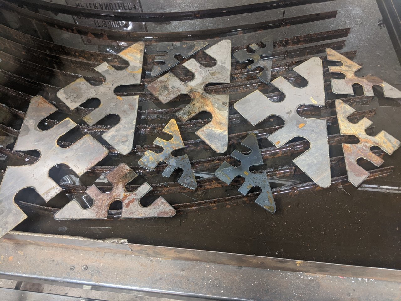

  14. Mar 6, 2022 at 1:50 PM
    koditten
    koditten Well-Known Member
    Sep 8, 2013
    #112077
    19,765
    Kirk
    Central Michigan
    04 trd x-cab 4 x 4 3.4l
    Reserected from the dead.
    I played around with various shipping scarnarios.
    It looks like I can ship the smaller webs for around $8. I can get up to 8 webs in one box and have room for packing.
    I'm still trying to figure out what is best for the large webs.
    I think I would like to ask for $30/ pair for the smaller ones. This includes the shipping. Obviously if you order 4 we can drop the price to $25/pair.PXL_20220306_195054807.jpg
    These will be rough webs. I won't be hitting them with flap wheel to clean up the dross.
    I ran these off this morning after I wrote the G code for filleted corners. I wanted them to not be as likely to rip thru the box during shipping knife someone by accident.
    All the ones in the picture are available at this moment.
