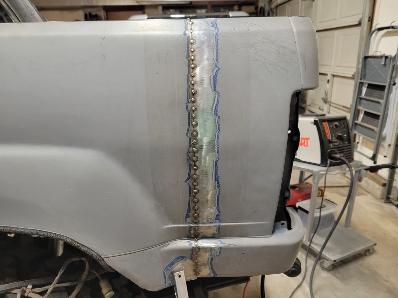

    Confirmed, 18g.

    Aka straight doody to weld

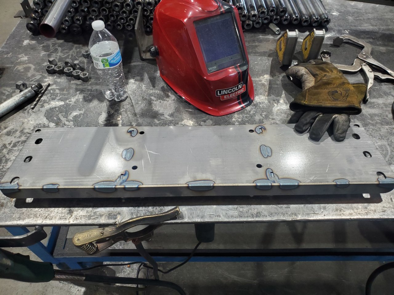

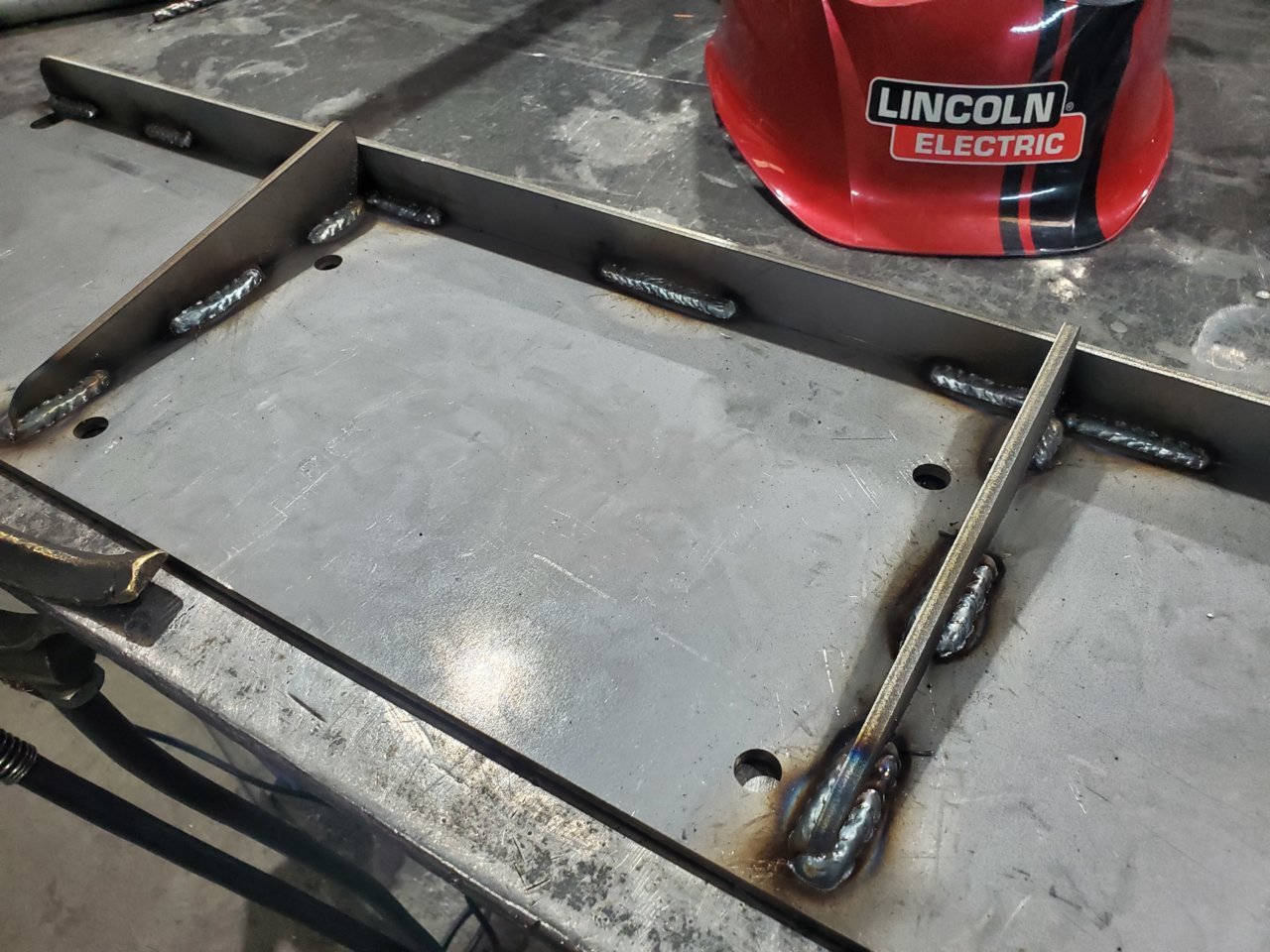

    At work welding but I got done early so I thought I would get a start on my bumper.
    Just need to add those small vertical welds on the gussets.

    Word. I just cut some thin backing plates to help with blow through. I ordered some 3M seam sealer which I'll run around the border and hopefully call it good.

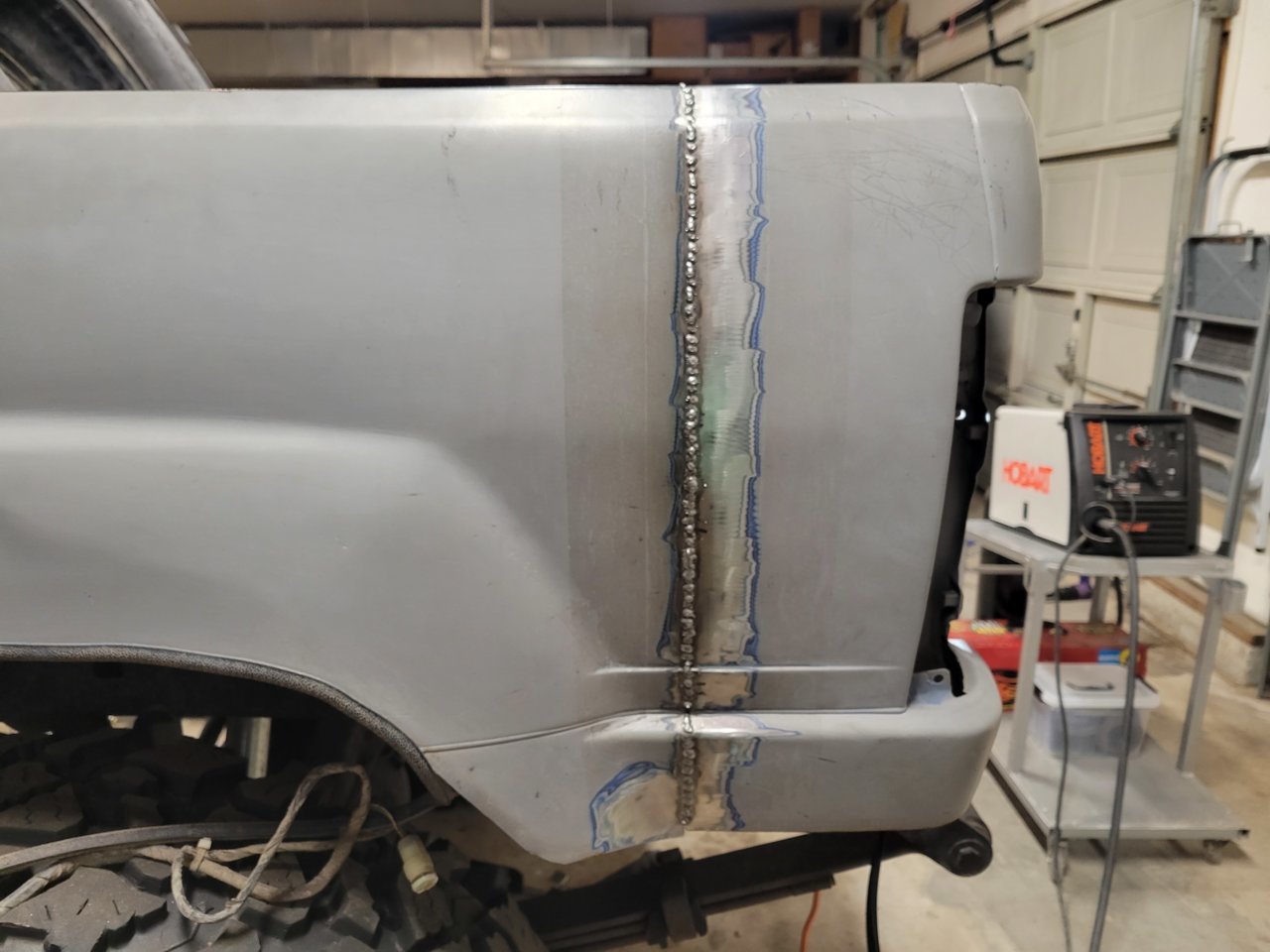

    Progress. Passed the light test on the drivers side.

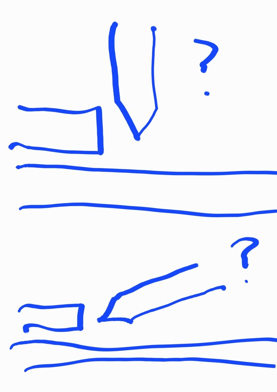

    Thanks! Could you clarify "almost straight down?"

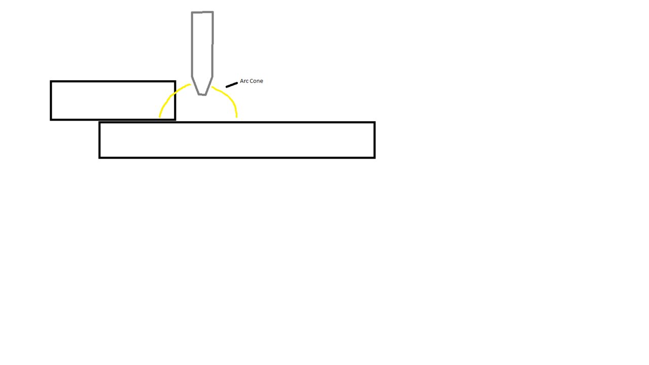

    the first one. the arc cone will barely overlap the top plate.
    use a super sharp grind with a blunted tip. this will give you ability to get in tighter with the tungsten but not dip the tungsten in the weld puddle when you are welding at lower amps. speaking of amps, i didnt catch what you were welding at?
