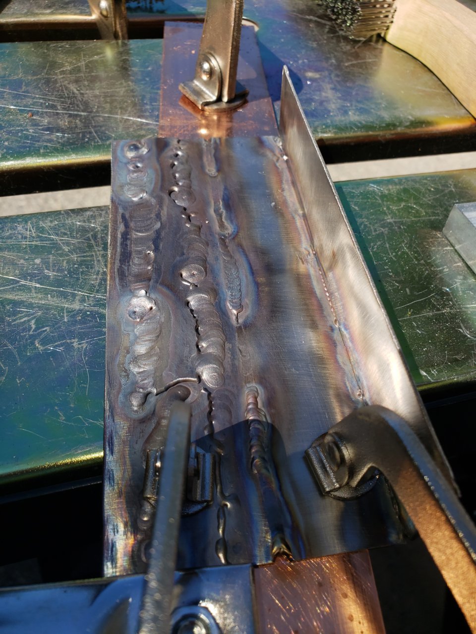

    Despite my tig-learning woes above, for what it's worth, I'm quite happy with the new-to-me PrimeWeld 520DP machine that I'm using for plasma cutting and DC tig. The original unit was damaged in shipment, but customer service was snappy and totally supportive in replacing it, and has been responsive in answering my follow-up questions. I'm obviously not an expert, but in my novice opinion, this is an excellent machine for its price point. It is a solid plasma cutter out the box--HF start with pilot arc, couldn't be easier. Plus it is super smooth with DC tig--but for this, although it comes with a torch (w/ collets, cups, etc.), you will need to buy the tungsten, argon regulator, and foot pedal separately. I am also glad I got a dedicated tip grinder thingy for my dremel, makes it super easy to consistently (and frequently lol) regrind while learning. And am eagerly awaiting a parts kit for the torch to get a larger cup and a gas lens, I am having to run it at 50 CFH to keep my stainless welds from getting charred (although this is likely user error).
    I read that it struggles on 110V FYI. I only use 220 and it is awesome.
    I'm sure any of those machines are very similar and a good value. But PrimeWeld warranty and support is excellent.
    ANYWAY
    Thought I'd post something that isn't just me complaining about how hard it is to learn tig on thin stainless... an actual repair.
    One of my front skid mounting points came loose. Nearly stripped the nut trying to back the screw out, but it survived. The nut is welded to a small piece of sheet steel within the frame. The spot welds holding that piece to the frame failed on one side. I could wiggle that bolt up and down a few mm by hand.
    But, there's no way to access the failed weld inside the frame, at least not on my back in my driveway with a cheap mig welder.
    So, I decided to drill out a bit of the frame so I could access some of the loose metal behind it. That was easy, but sanding down the mating surfaces was quite tedious!.
    With everything clean and shiny, I pooped in some hot metal, then ground the area flat again.
    Then I scoured the trauma from the nut threads. Bolts thread freely now, and I tested it to 60 ft lbs (2x spec) to make sure they wouldn't immediately strip. They're not perfect but I suspect will hold out just fine, given that the primary stresses to this joint are compression and shear.
    I also dremeled out the holes in my skid a little bit, in hopes that screw bind won't pop my shitty weld loose next time. Hope it holds!
    Curious if you more-experienced folks would do it differently, or if I made an obvious mistake here. Paint is drying for now!

    Nope you did just fine, better that you could save it. The only other option is if it completely broke off you could drill a bigger hole, weld a nut to a big washer, pop that in and weld the washer to the frame.

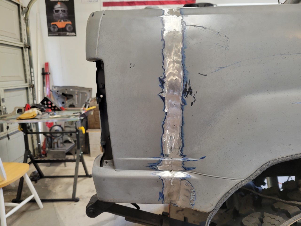

    Passenger side is now ready for a little body filler. The heat definitely sucked the metal in some but nothing a dolly and a few whacks of a hammer couldn't remedy. I went slower on the drivers side so there is less warping on that side. My daughter was pissed about the sound of the compressor and die grinder so I had to call it for the day. Tomorrow I should be able to buff the DS and seam seal everything up. Then body filler, sand, body filler, sand, and paint.

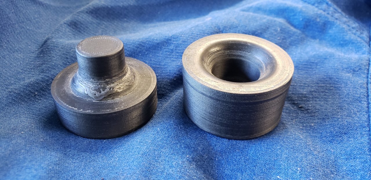

    curious to see what you do with the dimple die... while it will do 16g mild steel I doubt it will hold up long term with quality dimples. in lighter gauge steel or aluminum, I am certain they will hold up much better.
    you can see the wear it is starting to take on the male die after 7 uses on 16g mild steel.
    My test pieces for reference... not bad for a 3d printed tool

    Curious, how much filament does it take to make the dies?

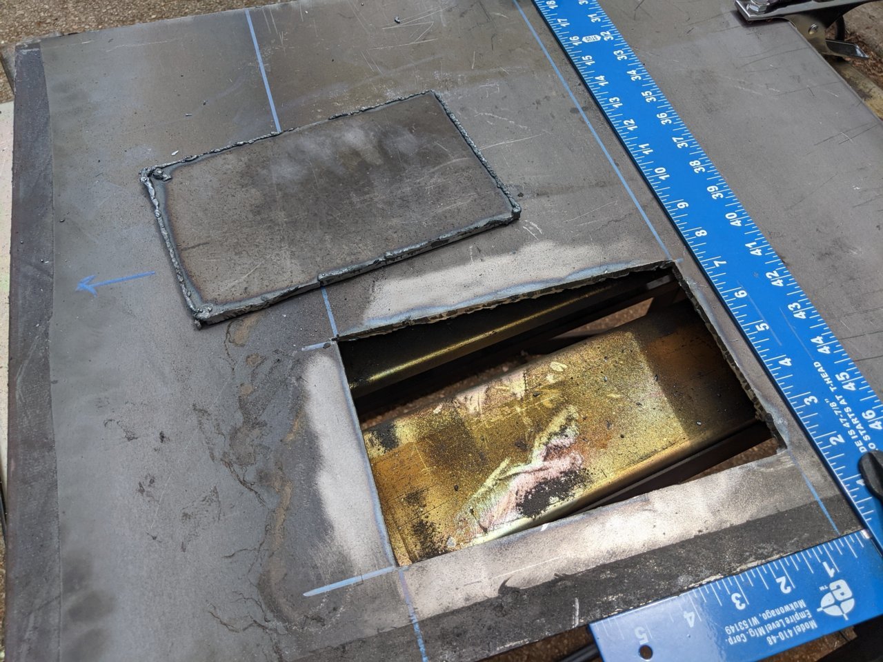

    I am making a roof over my new wood rack placed on exterior wall of the garage. I needed to cut some corrugated siding down from a single 14' piece into 38" sections. I thought I'd challenge the torch height controller (THC) on the CNC table. The THC measures the current between the work piece and the cutting tip. As the gap changes, so does the current (greater distance, higher amperage to jump the gap). Sensing a current change, it SHOULD raise or lower the cutting tip to maintain consistent gap. Fail!
    The THC was detecting the current change and moving up/down slightly, so I likely had the travel speed to high, even though I was well below the recommended speed for the thickness of metal being cut. Tried several speeds but none completely solved the problem. Never lost the circuit(arc) though, so that was good.
    Anyway, it cut 90% so cutting the rest with angle grinder was no problem.
    The trough is about 1" deep x about 1.5" wide.

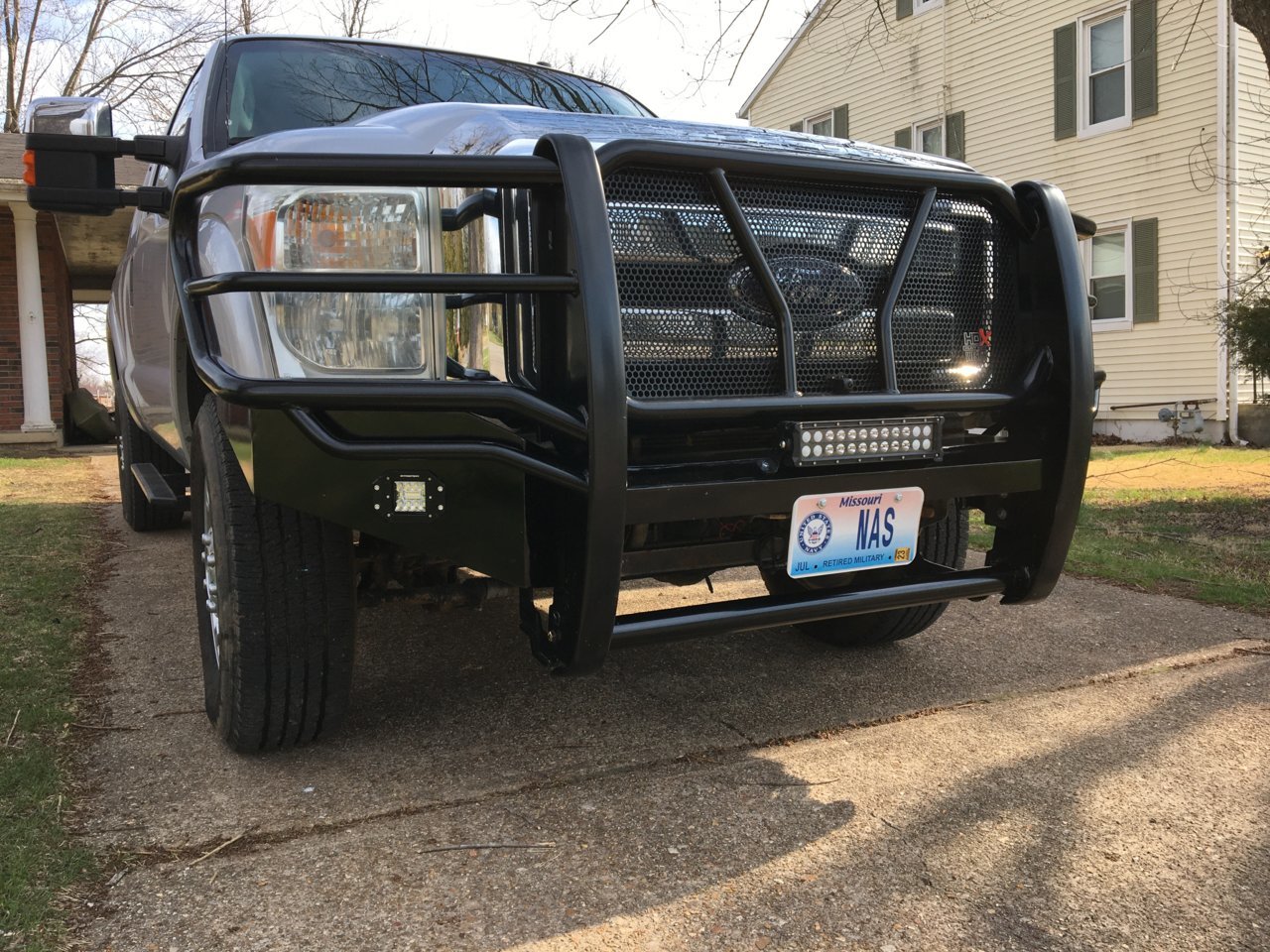

    Bumper is finished, just the bumper in 3 pcs in eighth hot. (I did not make the brush guard)
    Headache rack next.
