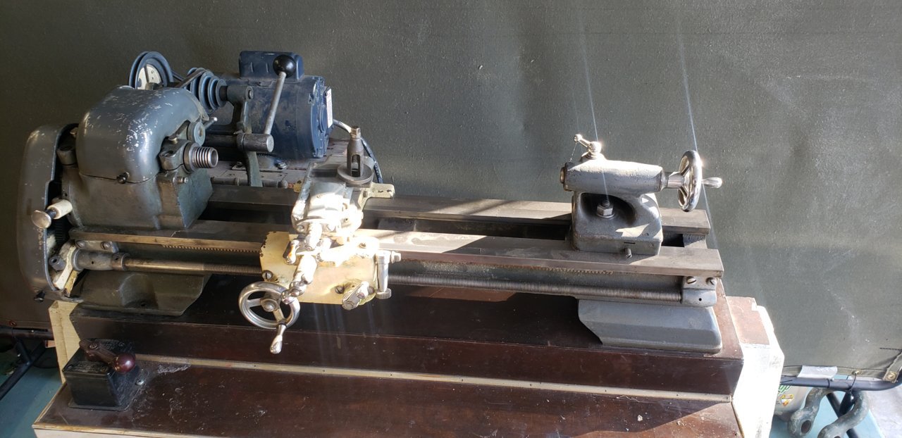

    The 3/4" like I sent you takes 77g of carbon fiber nylon. this is with a .12mm layer height and 100 % infill.
    this is the stuff I use, https://www.amazon.com/gp/product/B01KWVOFD4?ie=UTF8
    which at $24.99 / 1000g spool makes the 3d printed dies for light occasional use extremely cost effective.
    and if I start to need them more often, well, I just pick this old girl up..
    and I am in process of building a small heat treating oven to go along side the 2x72 belt grinder.

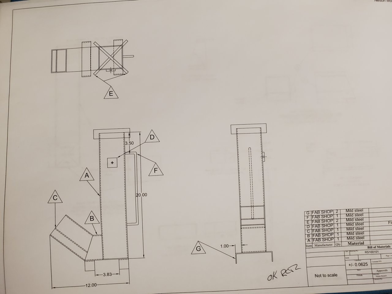

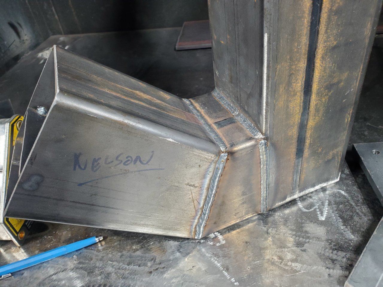

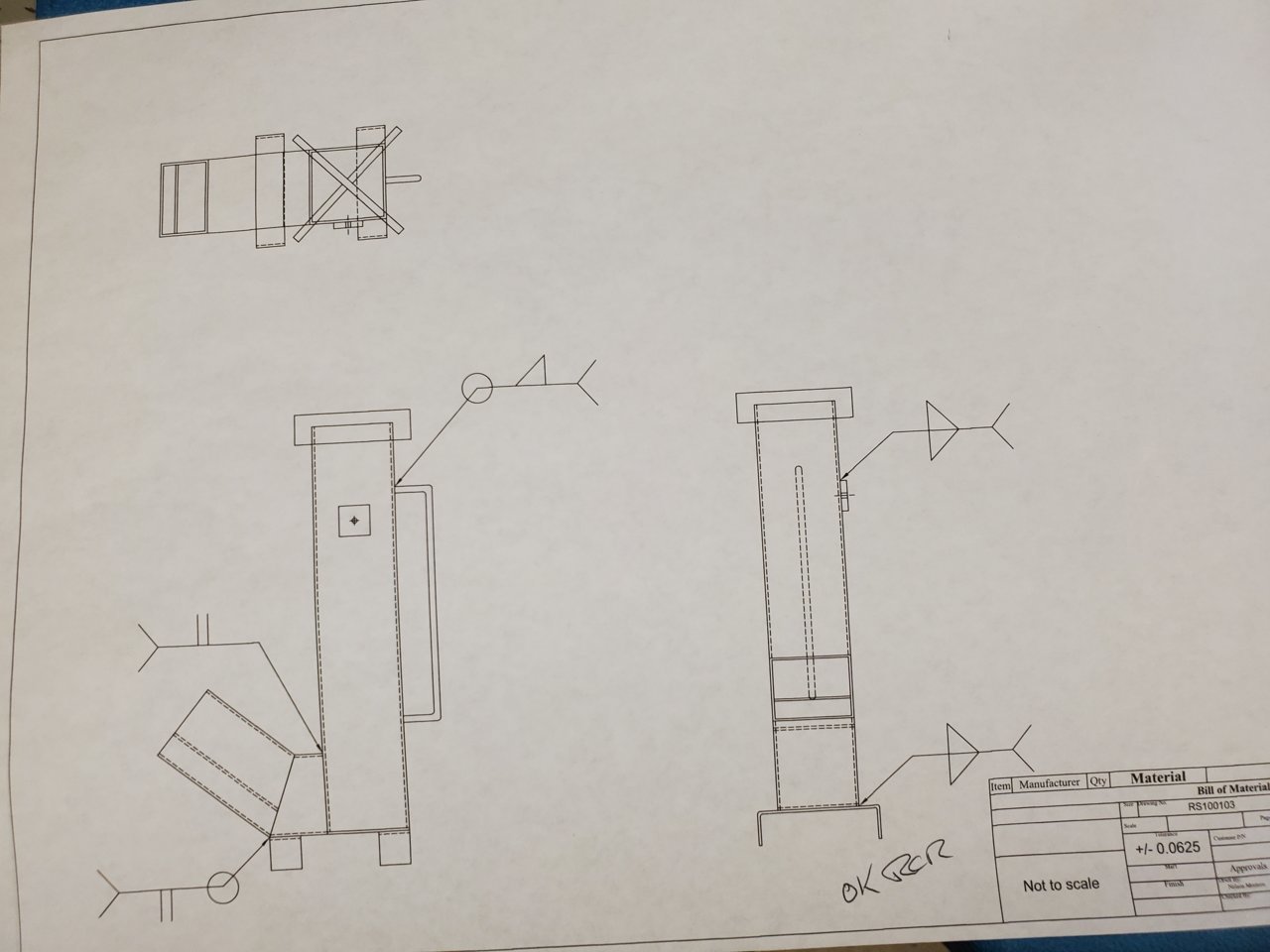

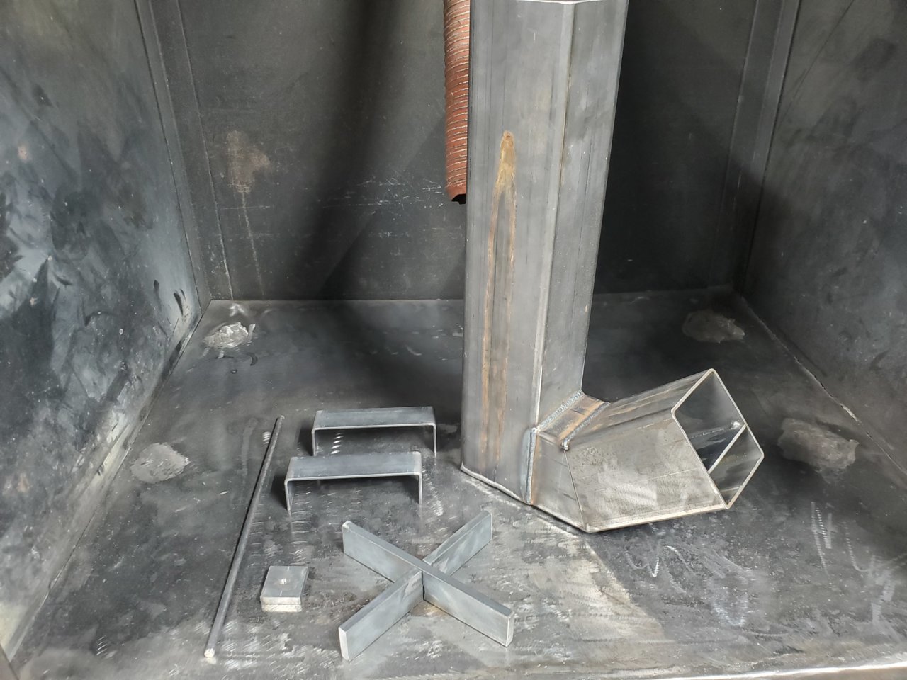

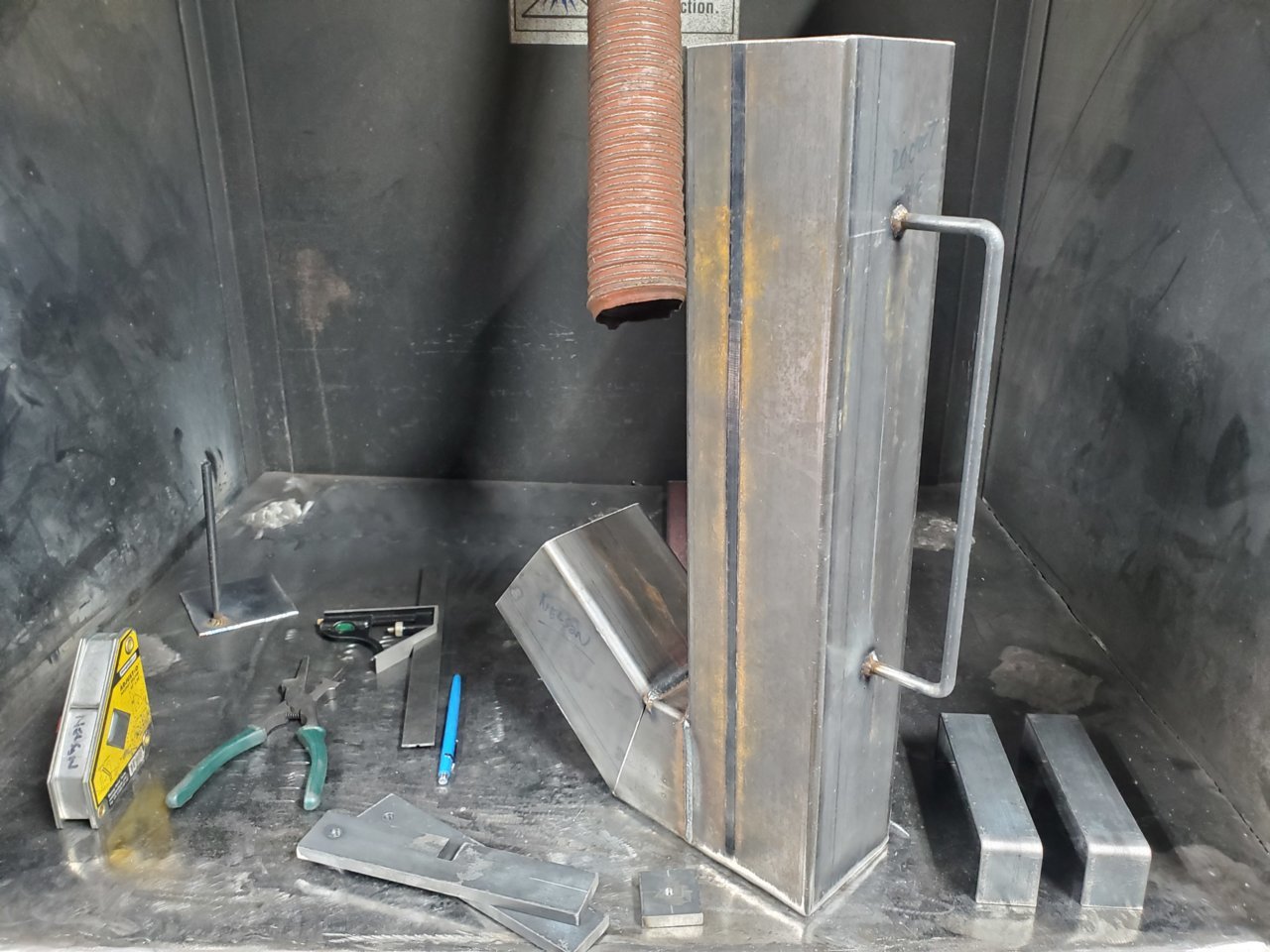

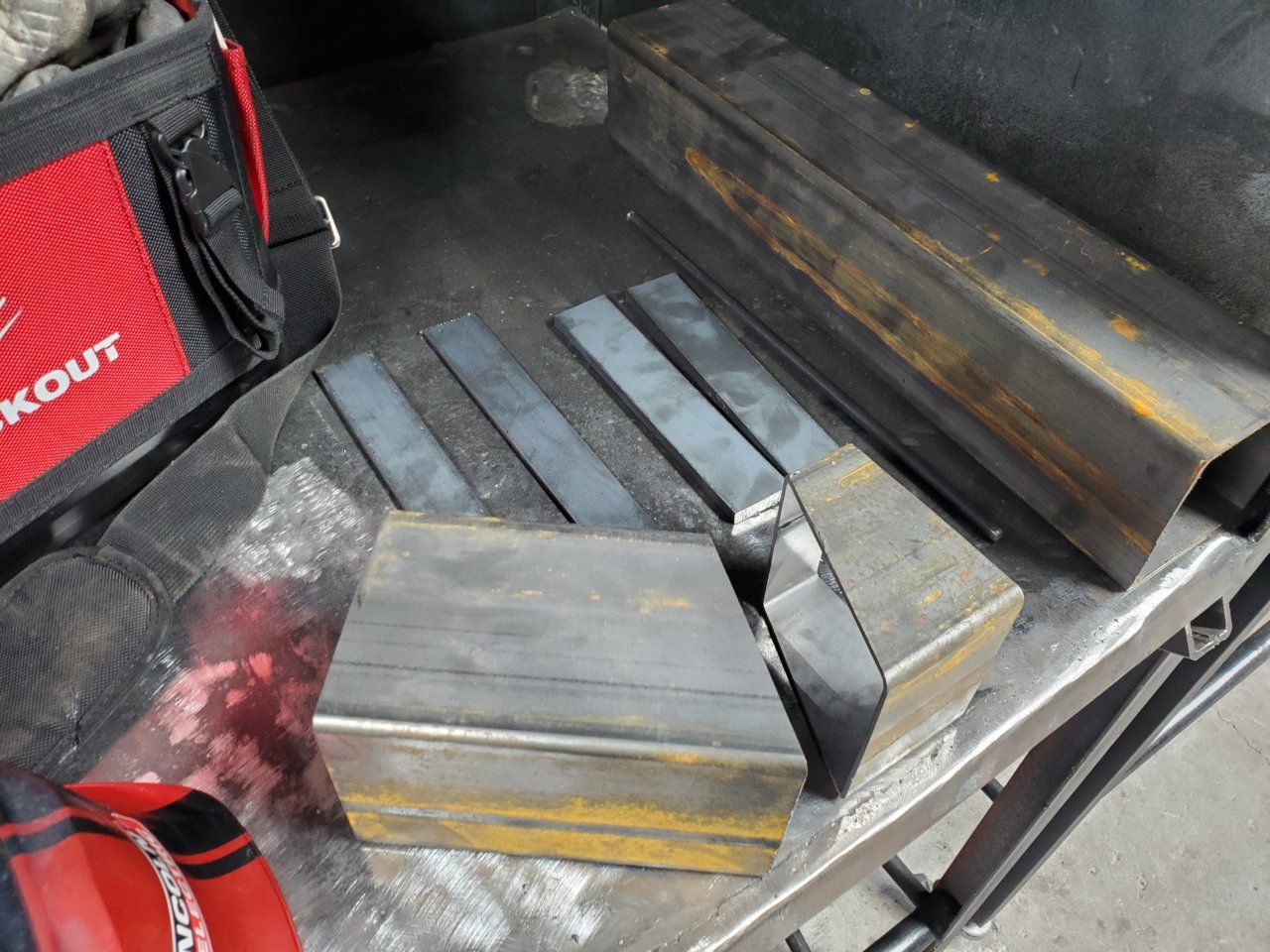

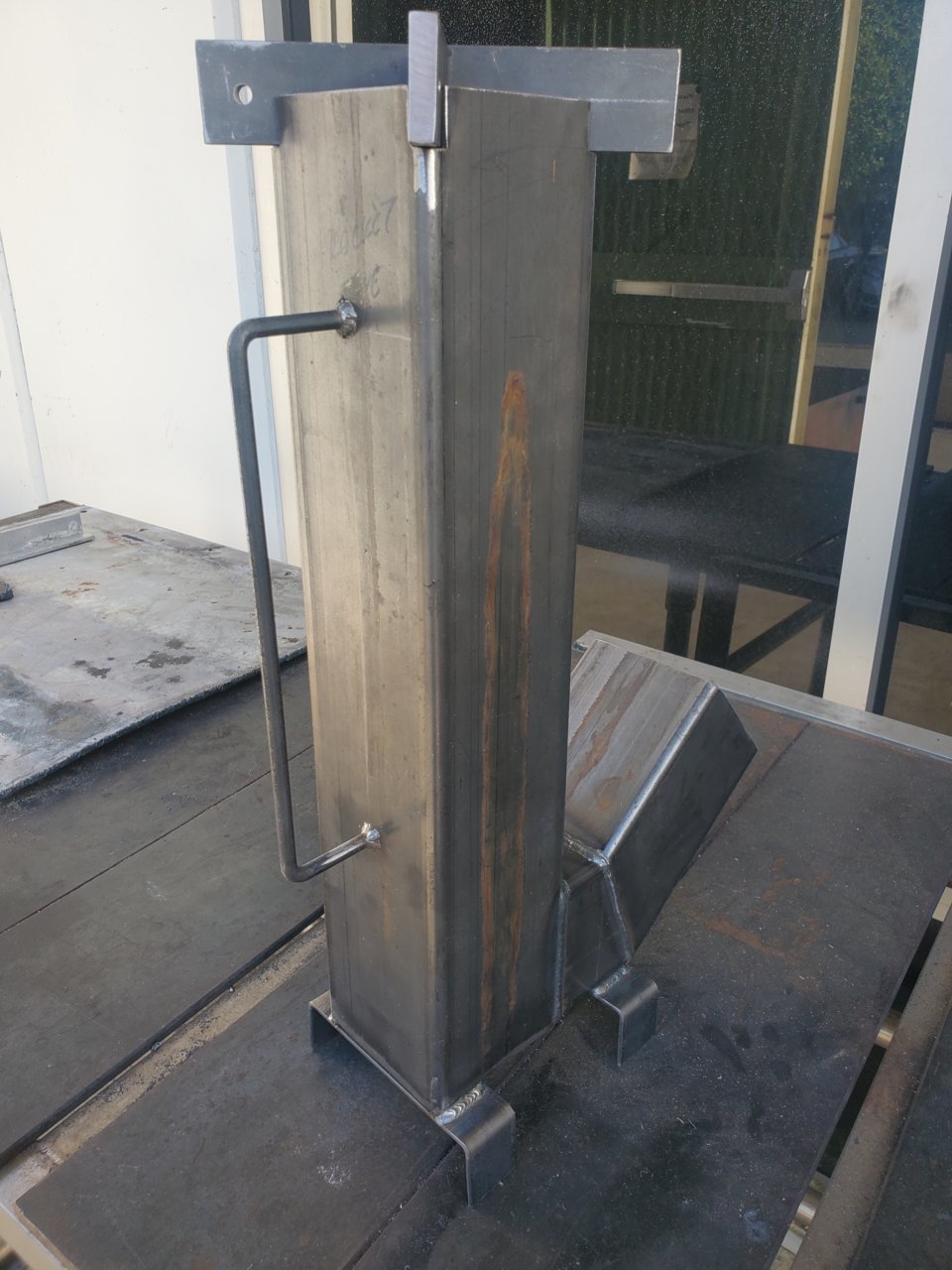

    School Project - Rocket Stove
    We learn how to use Draftsight, and learn about creating orthographic drawings.
    Everything always drawn to scale, we run through multiple drawings of items we physically measure and create plans for.
    So from a blank sheet, we're given a few "must haves" and go from there.
    First things first, assembly -

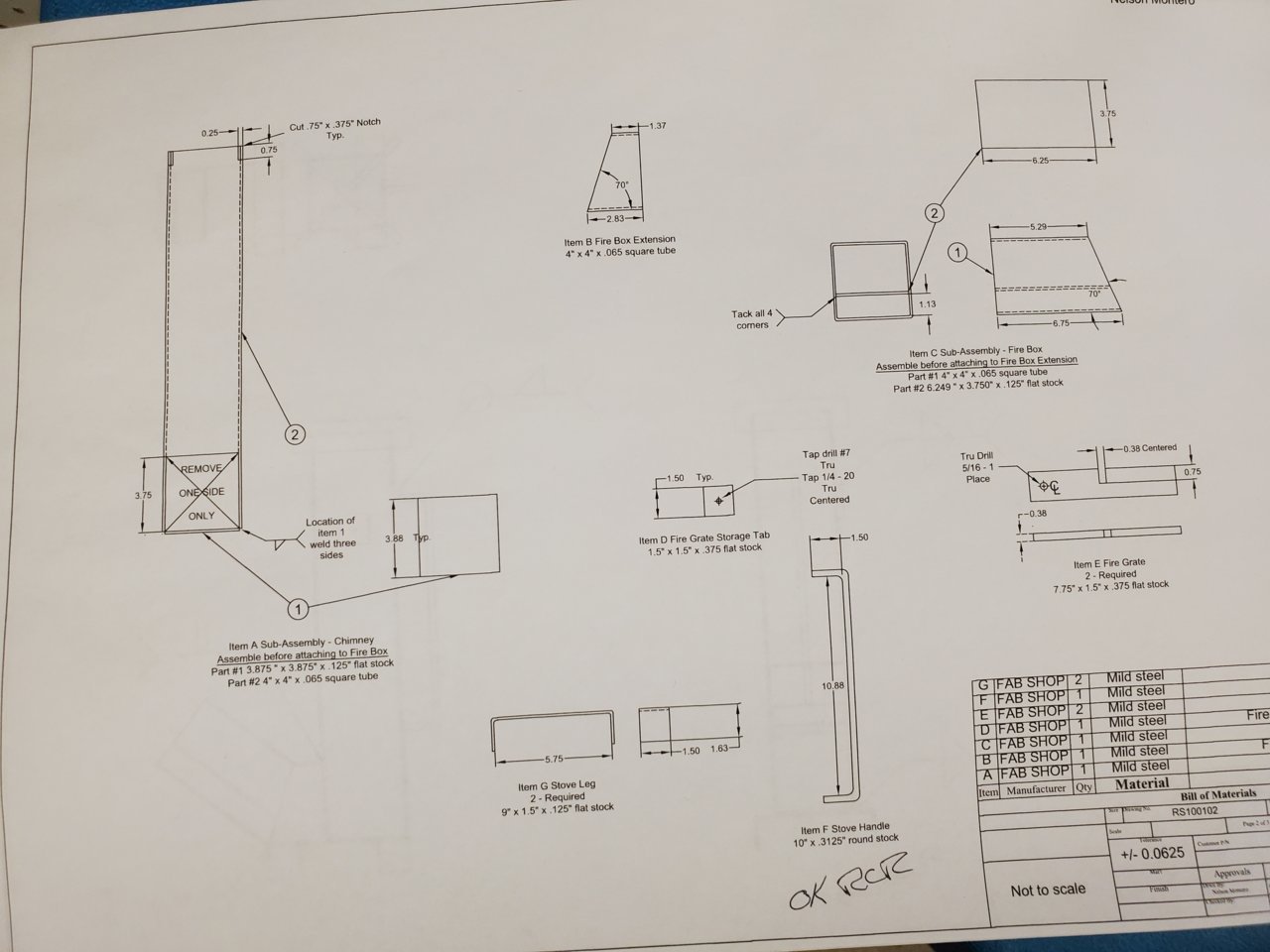

    Followed by Details -
    Followed by Welding Symbols -

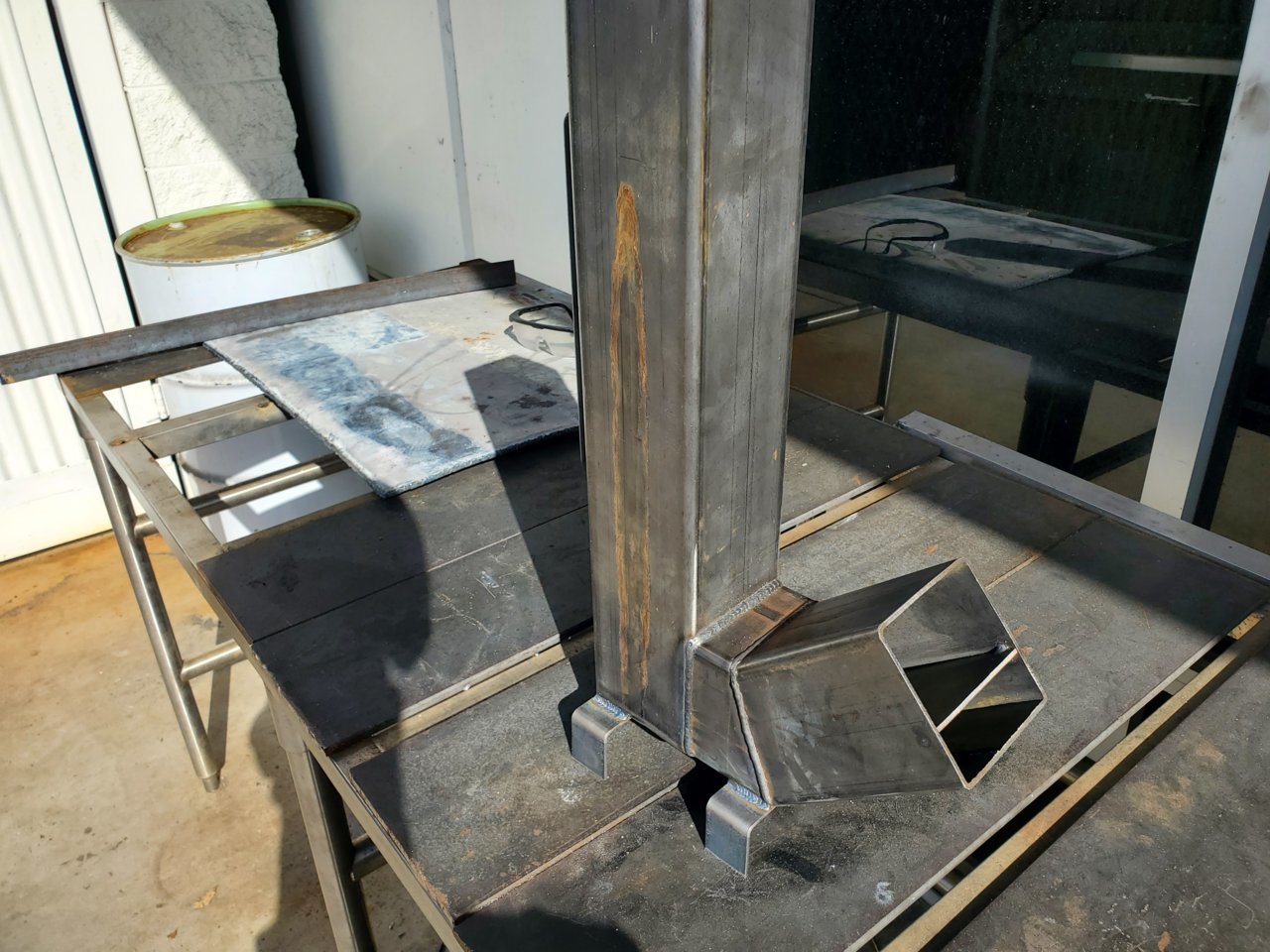

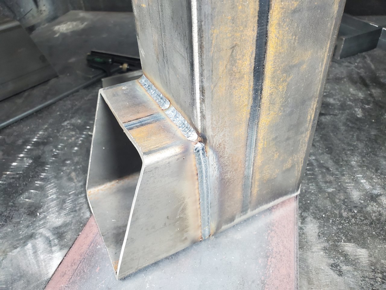

    Afterward, cutting the pieces as needed per our own drawings. Not everyone's is the same as a few things are left to us, the designer.
    Bend some flat bar, round stock, drill and tap a fitting, and more.
    Just need to finish by cutting the notches into the chimney otherwise it's all done!

    paint with hi temp bbq paint?
  8. Apr 6, 2022 at 1:39 PM
    Kwikvette
    Feb 27, 2019
    #284735
    82,898
    Fresno County
    4 run, 2 don't
    Of course!
    I'll need to hit it with a wire wheel tomorrow, and finish the notches.
    Leave it at school to get graded, but yeah I'll be heading to a local store and get some paint.
    I could do the usual black, or go with a different color :playball:

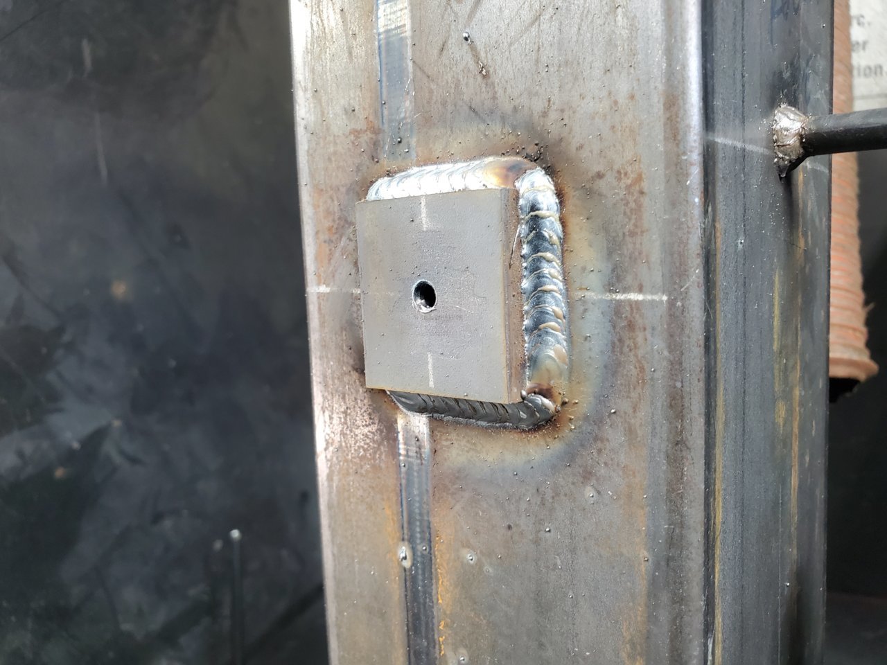

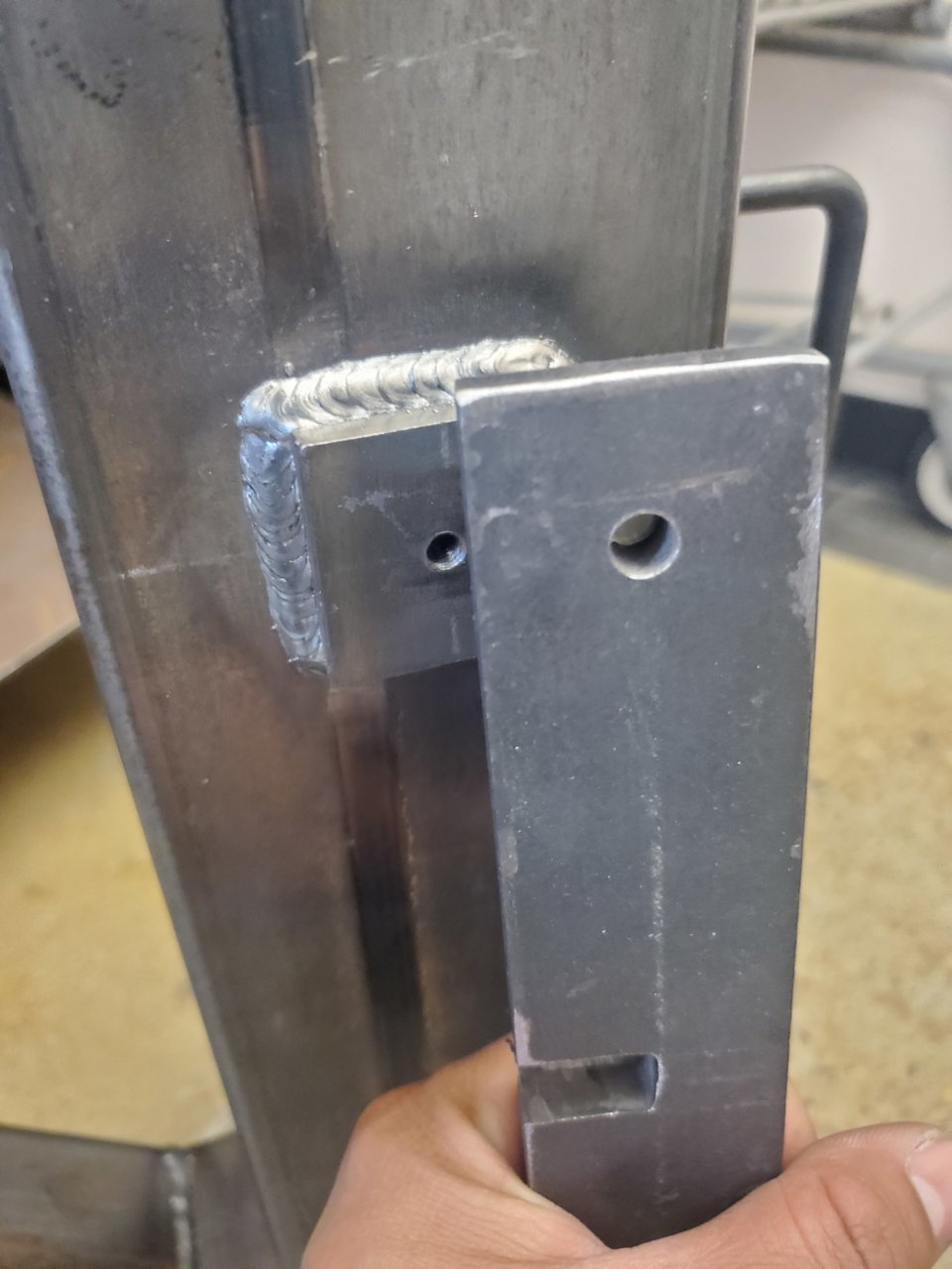

    What’s the purpose of the bump out with the hole?
  10. Apr 6, 2022 at 8:24 PM
    Kwikvette
    Feb 27, 2019
    #284735
    82,898
    Fresno County
    4 run, 2 don't
    If you check out the Details page (2), you'll notice Item E which are the Fire Grates that sit on top in the notches of the Chimney.
    A hole gets drilled through each one.
    A bolt goes into that 1.5 " x 1.5" block on the side to keep the Fire Grates together with the stove when not in use.

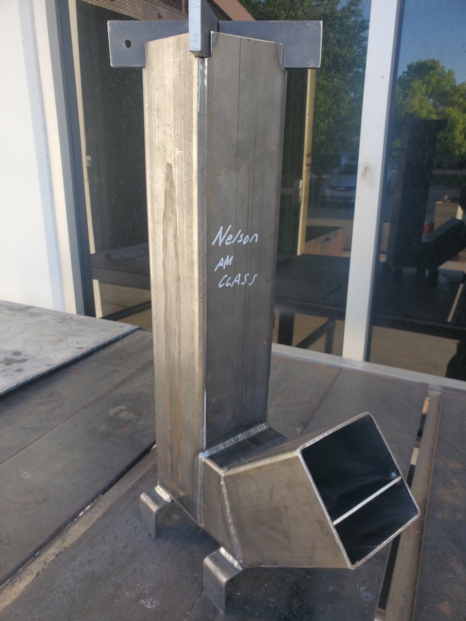

    @cynicalrider
    The holes in the Fire Grates -

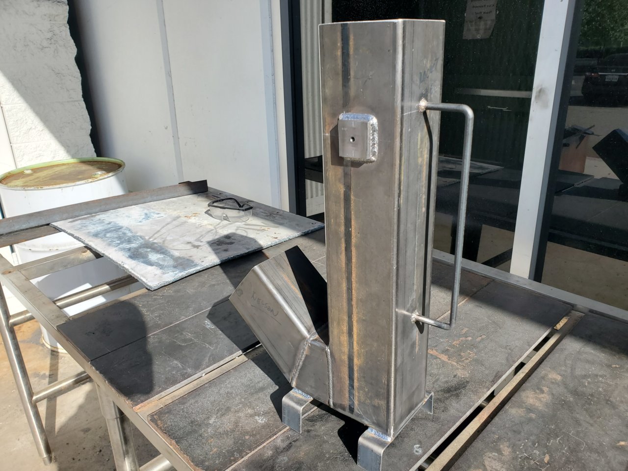

    And done with the notching up top -

    Very clean. I dig it.
