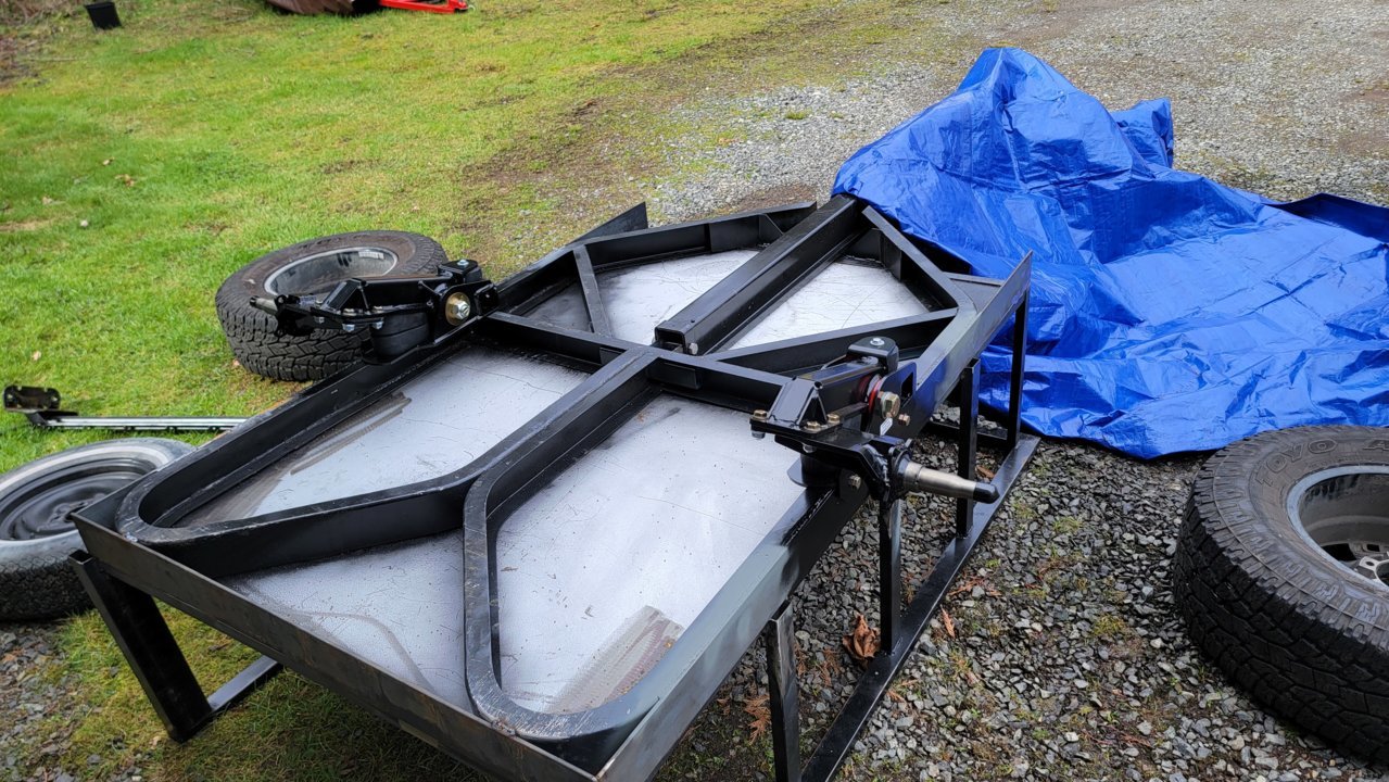

    It's on Timbrens, and they are where they have to be, I can't add height with them. If I stack the tongue I only gain 2.5", I want to gain 5.5" at least, if I could get the whole 8" I'd prefer that.
    That tongue has been removed and I got some 2.5" x .325" to weld in

    That's a lot of unnecessary work imo. I don't want the trailer to be higher as well, at that rate it'll be even with my tailgate by the time I'm finished. I can't even image how expensive all that tube would be either.

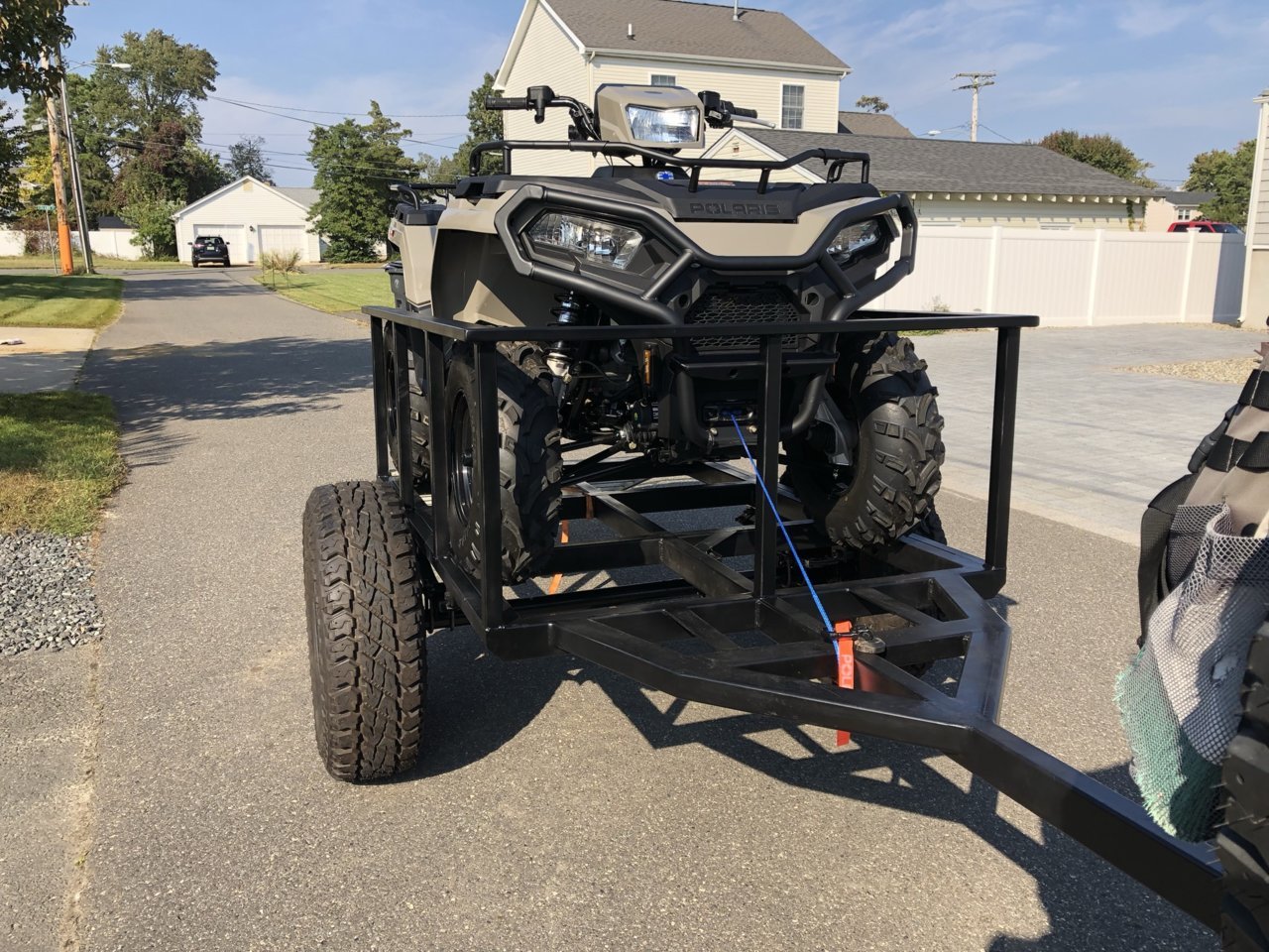

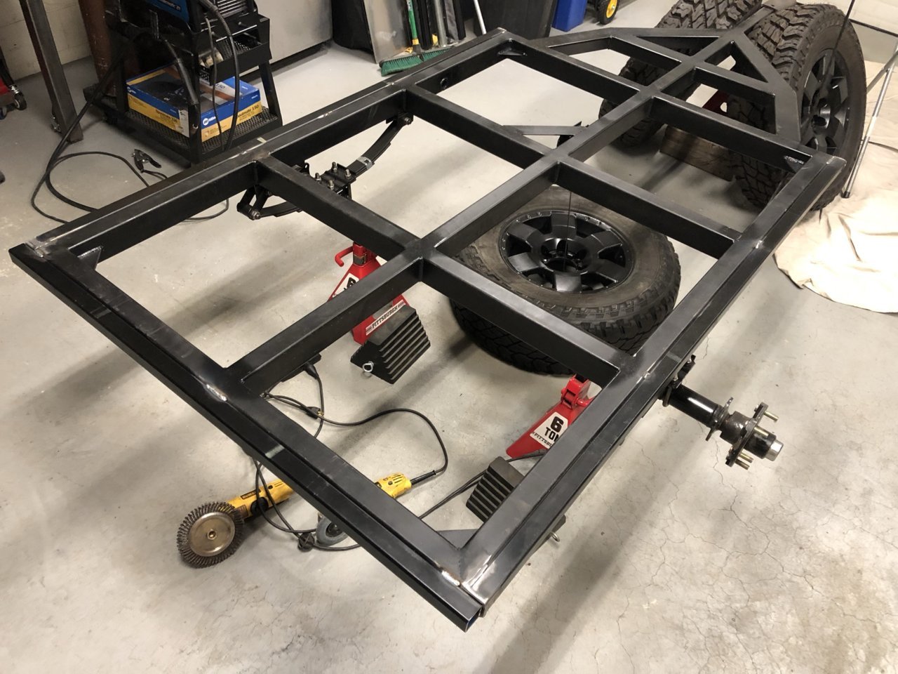

    I’m all about unnecessary work but I want the best results.
    I’m building a camp trailer now and made the “bed” 4’x6’ exactly. Ended up buying a quad after building the frame and found the quad to be 48” wide exactly. I want the option to to camp with it but with 1.5” sidewall framing I was 3” short on fitting it in the trailer. Best I could think to resolve the issue was sub frame 1.5” square toob on both sides of the trailer to get that 3” back and frame the sidewalls on the subframe. It worked. Alot of extra work and a little more material (bout $50) but it solved my problem. And I’m going for the “bulletproof build” as well. Imo strength of the trailer tongue should be solid and run throughout the trailer. Fucking with the tongue is getting away from the bullet proof build.
    AB7F9C96-9B88-4A3B-85E1-DE5AB2376F3B.jpg DDFC96B7-78C2-4663-B60D-28C253F58C50.jpg FE067040-4FBA-471F-926C-8FF919576211.jpg

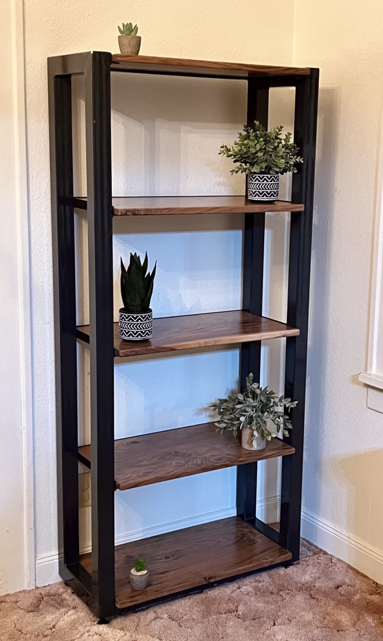

    The madre was pretty happy with her birthday shelves.
    dk_crew, HappyGilmore, ndmak and 11 others like this.

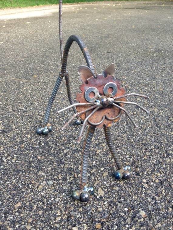

    DIY Fabricobbler.

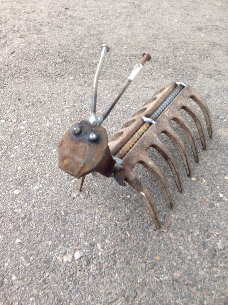

    Probably too late for the birthday, but for other times when you want to make something gardeny for grammy, you could make some garden animals from old yard tools and such.
    Ideas like these.

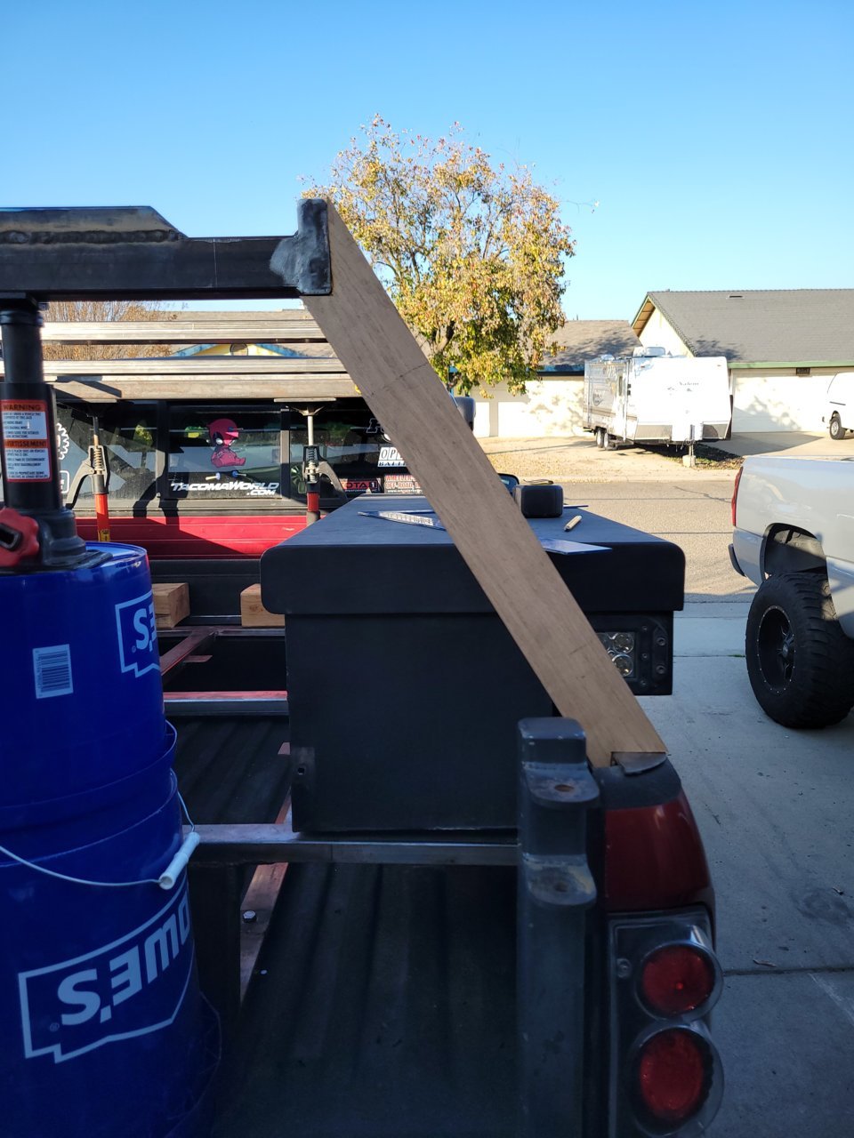

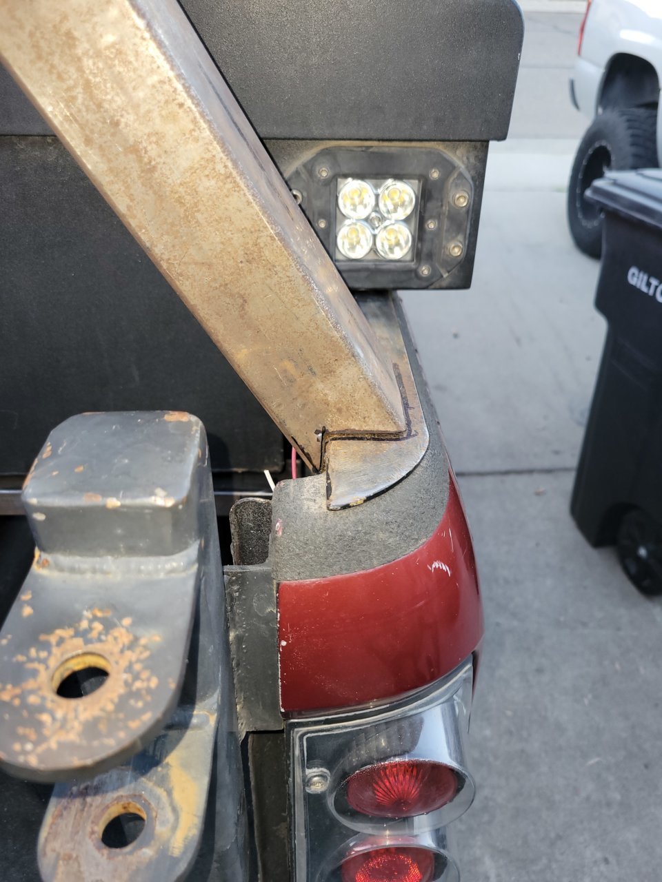

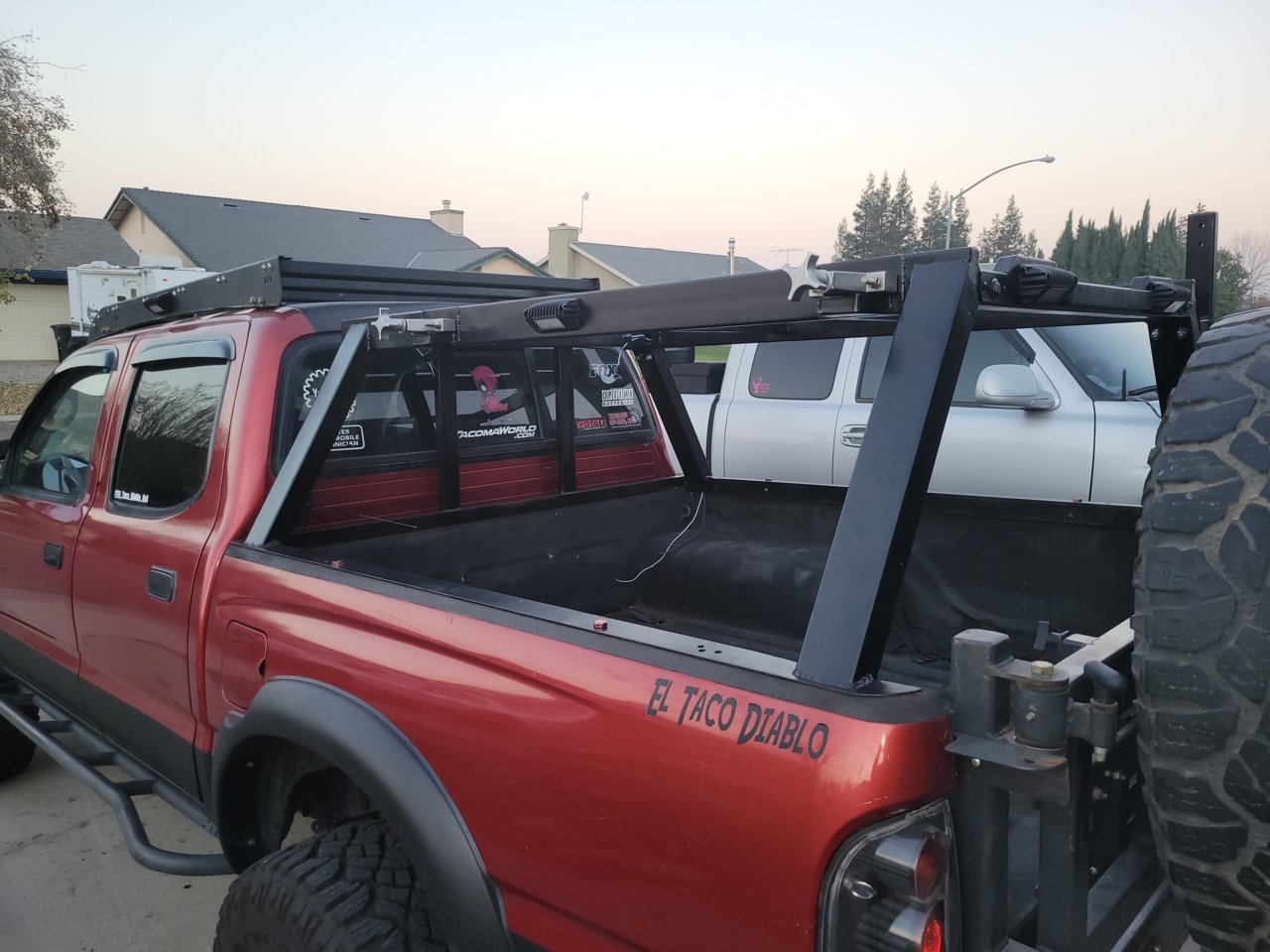

    Rebuilt the Roof top tent rack, and added some features.
    20211120_195711.jpg 20211125_210428.jpg 20211125_210502.jpg 20211127_144008.jpg 20211127_145546.jpg 20211127_151511.jpg 20211128_163202.jpg 20211128_163213.jpg 20211203_164235.jpg 20211203_164207.jpg 20211204_165425.jpg
    koditten, Vmax88, GHOST SHIP and 3 others like this.

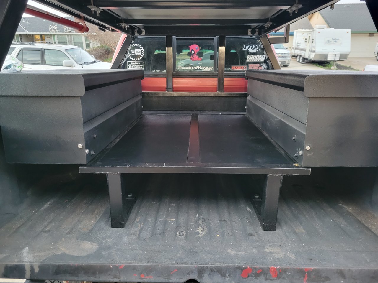

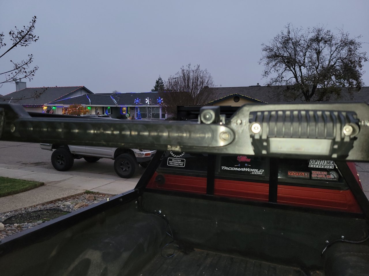

    Finished the bed platform.

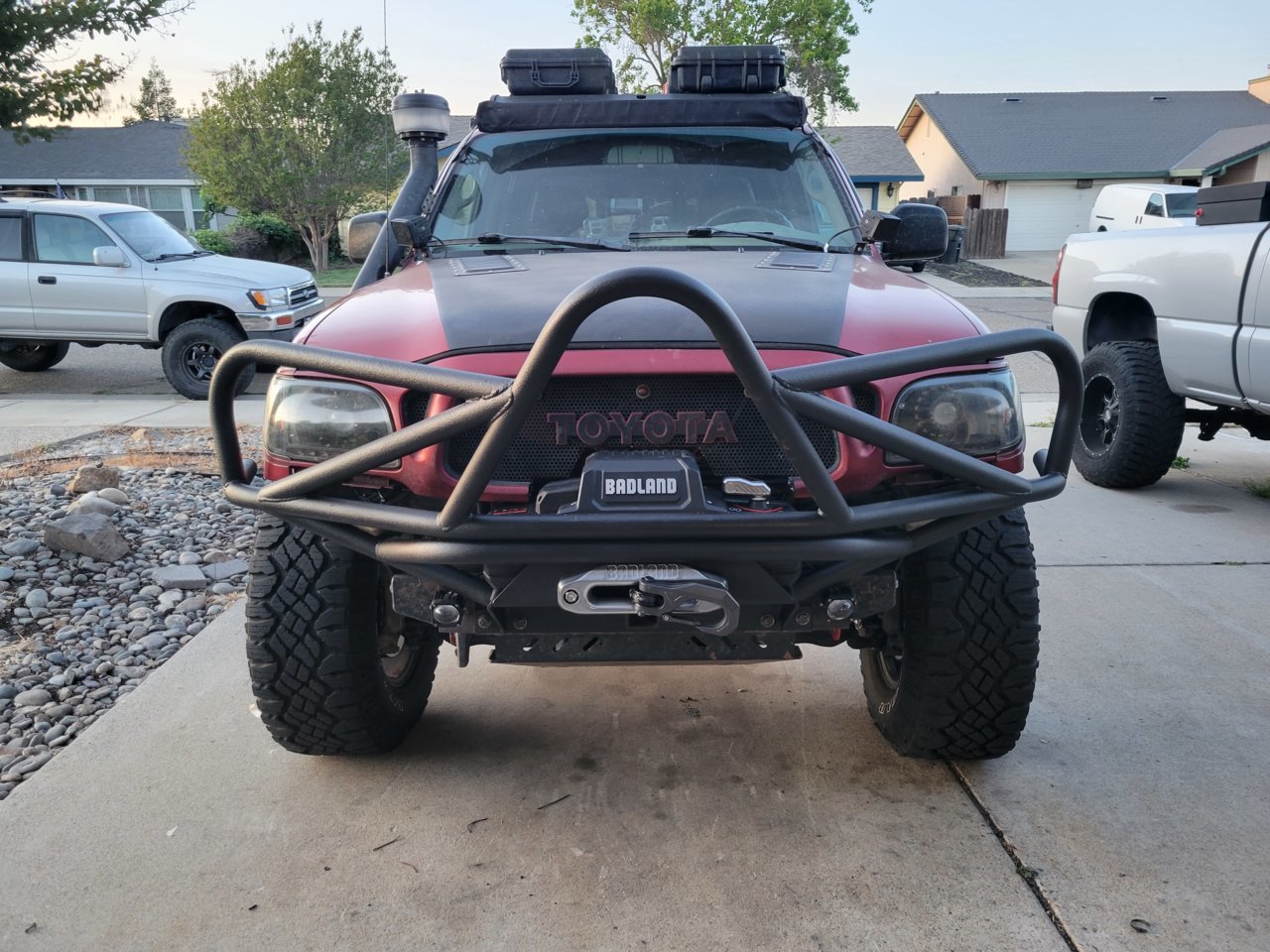

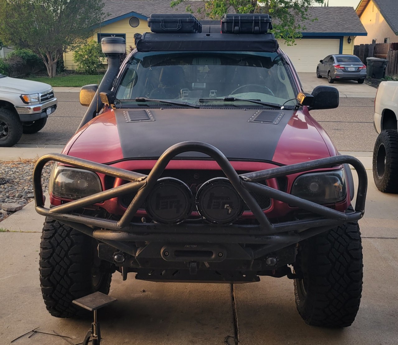

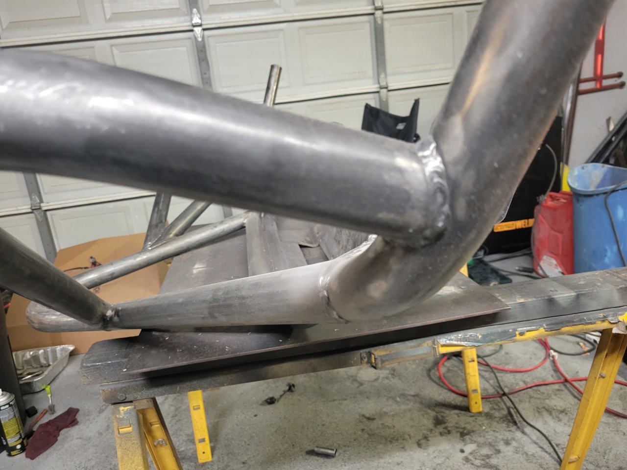

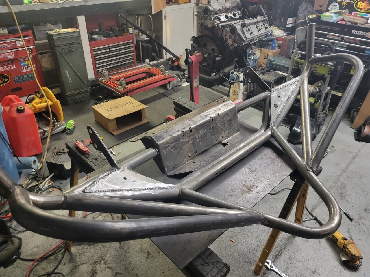

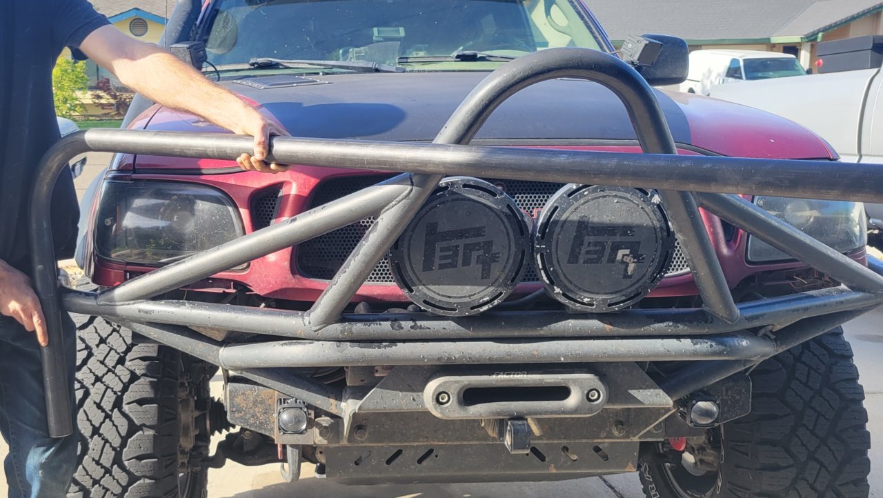

    Bent some tube and fabricated some headlight hoops for the front bumper.
    20220405_165825.jpg 20220407_170402.jpg 20220407_170342.jpg 20220408_191514.jpg 20220409_190809.jpg 20220409_190824.jpg 20220409_190832.jpg

    Finished up the bumper
