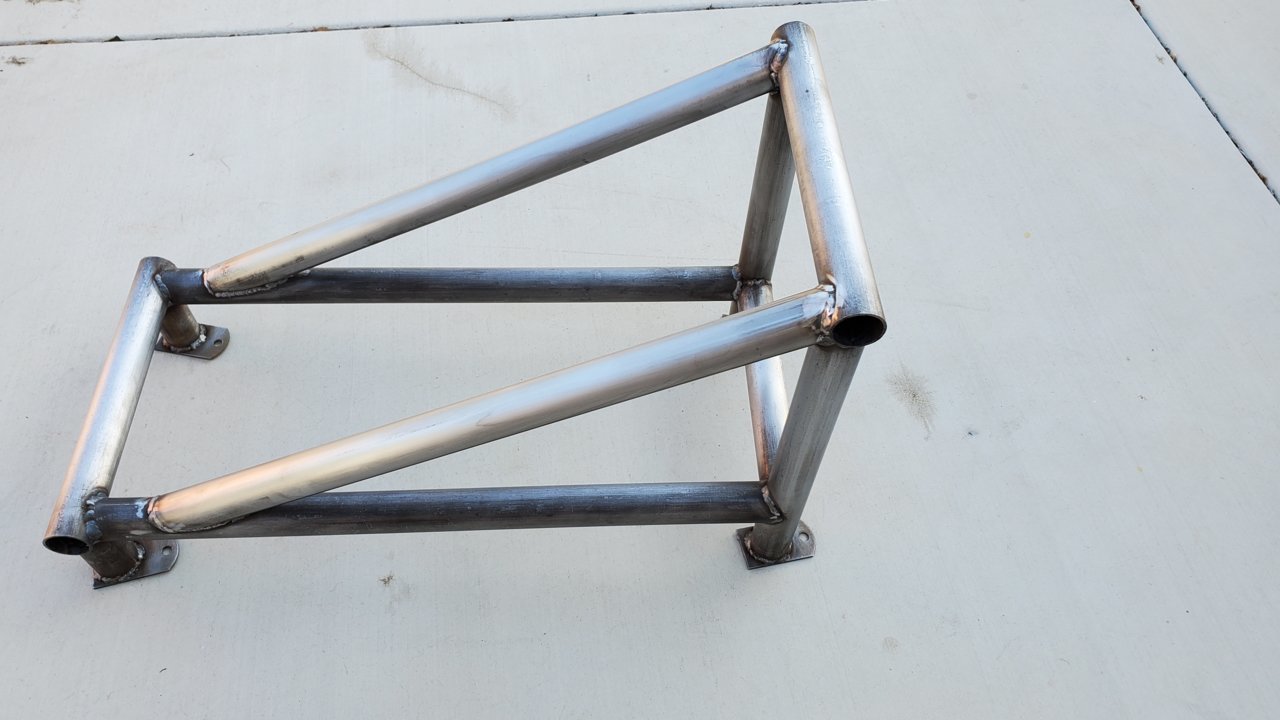

    Made this stool out of some rebar and scrap flat bar

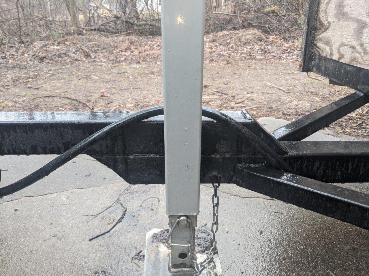

    Drop bracket lift and booger welds

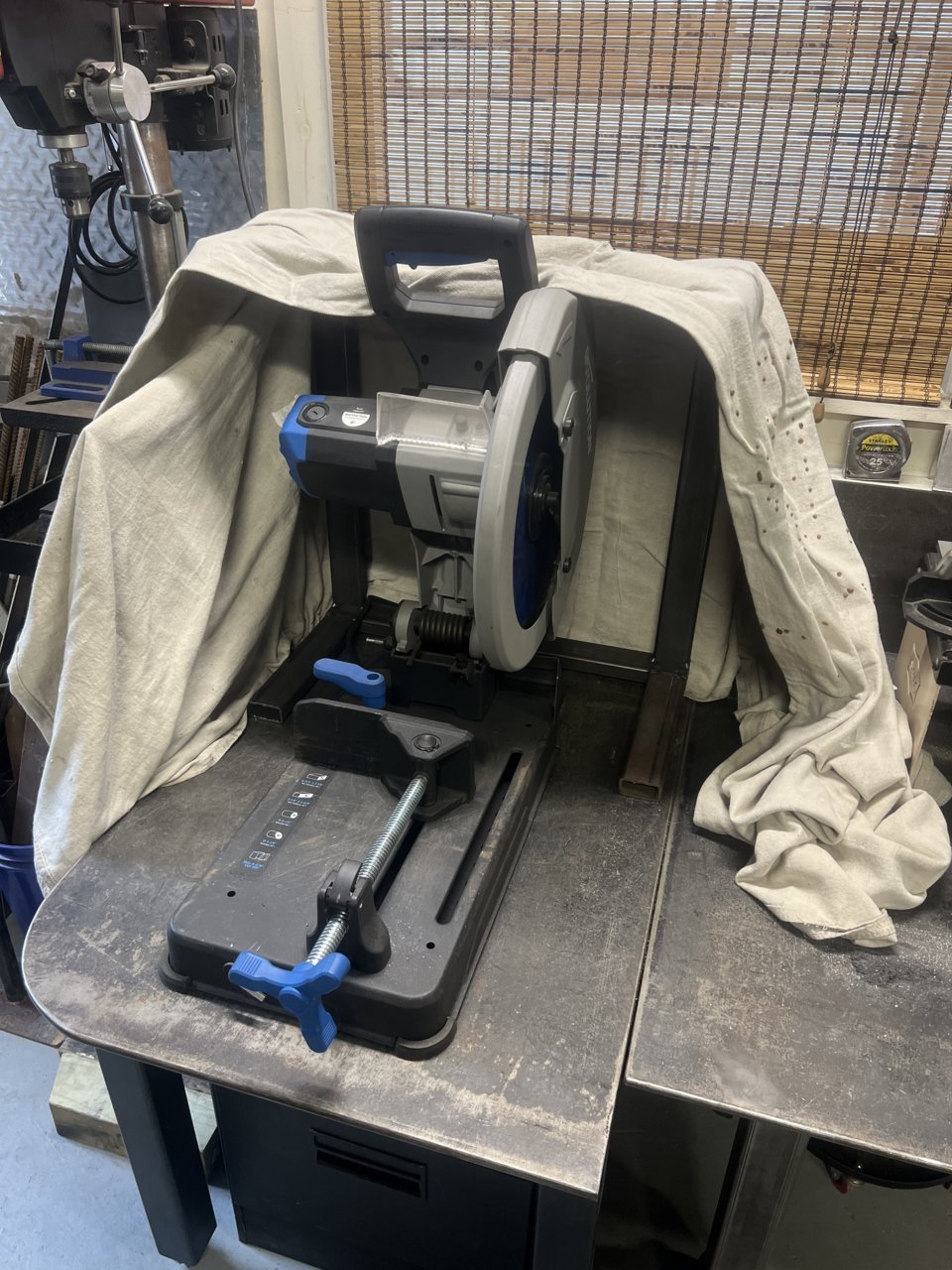

    Big facts cold cut chop saw over abrasive chop saw. I had a dewalt abrasive saw and got the Evo above when I started my trailer build. The cold cut saw makes perfect miter cuts. As mentioned don’t miss sparks, smell, or even the slag. But it’s not without its negatives. From a DIY garage shop perspective I can’t stand the sharp barbed chips the cold cut produces. In my garage they go everywhere, I track them in the house, and even pulled more than a couple out of my 4 year olds foot… I’m slowly coming up with a hood design with magnets to catch most/all the chips. Did it on a whim at first with a quick frame and blanket, worked good enough to try and make something more permanent. Similar to what wood workers have to catch saw dust. I do love the Evo chop saw but I think if I was to do it again I would look for a bandsaw chop saw setup. Same precise cut, less shrapnel to deal with. I try to use the portaband with swag table as much as possible bekuz easy quick cleanup.

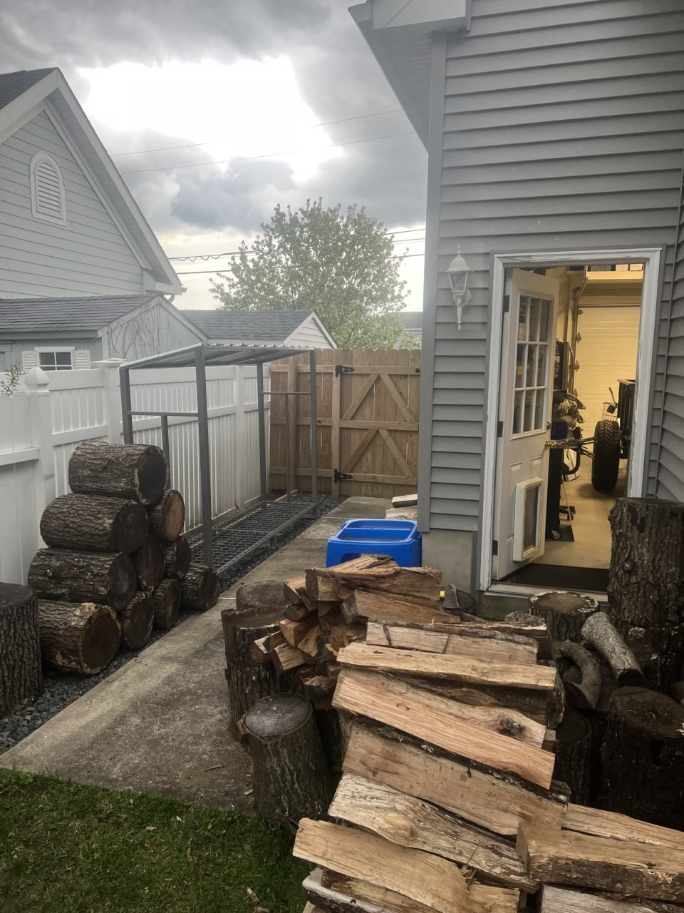

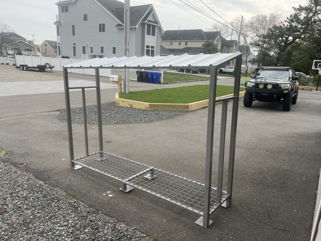

    Finally finished up a firewood rack.
    I painted it black as per all my steel projects and before adding the tin roof I got it in place and started loading it up. Quickly realized the inside measurement between the corners was 26” and the split would was going to roll right out the side unless I stacked it like a pyramid which is pointless. Added another 1x2” in the center on the sides and decided to repaint the whole thing grey with a white tin roof to match the house. It wasn’t my intensions I guess at first but matching the house looks domestic AF for a firewood rack hah8BC68803-1809-4844-9D87-632EEF3EC59D.jpgA7EEC8E1-70D7-45DA-BA77-D5CC1D1D3DC9.jpg 8A79715E-BC6C-4EA2-9705-0A57708353FF.jpg7DB1741F-735A-4962-9844-1B7D1CC050A9.jpg
    Also how good the miters are with the cold cut chop saw.
    No prep after the cuts..
    Zebinator, RustyGreen, Rakso and 11 others like this.

    Nice rack!
    Looks like we had the same priorities recently. Just finished the roof over mine last Sunday. I still need to finish sealing some rubber strips where roof meets wall, but otherwise, ready for wood(TWSS)!
