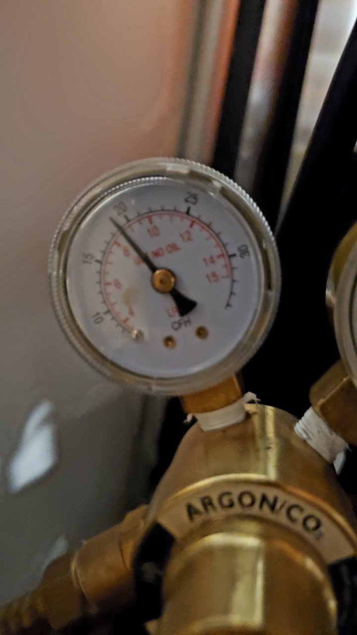

    I was going through 80s of C25 every month or two so I jumped up to a 390 and anchored it to the wall. Sucker hasn’t moved in almost two years, it’s still going strong. :muscleflexing: Costs me $100 a year to lease the tank and $120 per fill.

    I remember a few pages back where we were all talking tank sizes and how long they’d last. I few people figured out they were running higher cfm’s and that accounted for a lot of the shorter cycles. It’s been windy here lately and a pain to weld so I’m running about 18cfm but even then I have to weld between breezes which slows me down on larger jobs.

    Funny story about that, I didn’t realize that CFH and LPM were on the same dial and I was looking at the wrong number. Turns out I was running like 40 CFH :oops:

    I run about 5-8 psi flow welding inside.
    I gave up using the manometer type flow gauge years ago. I just thought they were not useful and wasted gas.
    You know when your weld cover gas is dialed in by the sound.
    I don't need a metal ball to tell me when things are right.
    If your welding for a shop with prints, then the manometer gauge is required.
    Good conversation.

    I'm running about 22 cfm.. Maybe I need to adjust...

    That seems kinda high.
    Too much gas is not gonna mess up the weld. You need to decrease it to the point you see porosity. It's all trial and error.
    We all in this thread have the benefit of buying our own gas, so we know what we can get away with.
    When the boss of your work says you need to run 20 cfm, you run 20 cfm. He buys the gas.
    Us on our own dime are gonna squeeze that buffalo knuckle until it shits!
    If we can dial the gas back and have the same results... We are going to dial it back!
    RustyGreen, Vmax88, Rakso and 2 others like this.

    I normally run 10-12 in ideal conditions, but yeah your sweet spot might be different.

    I haven’t had to refill it since I got it two years ago. I was blowing through gas when I bobbed my bed and built the rear bumper to match so I jumped up in tank size. My projects have slowed down since then which is why it’s lasted so long. I run about 15 CFH

    Speaking of this. Mine is set at 19, when I pull the trigger it goes down to about 16. Is that normal? , I'm not sure I ever noticed it doing that? LOL
    After reading, I'm lowering it to 15 and go from there.
