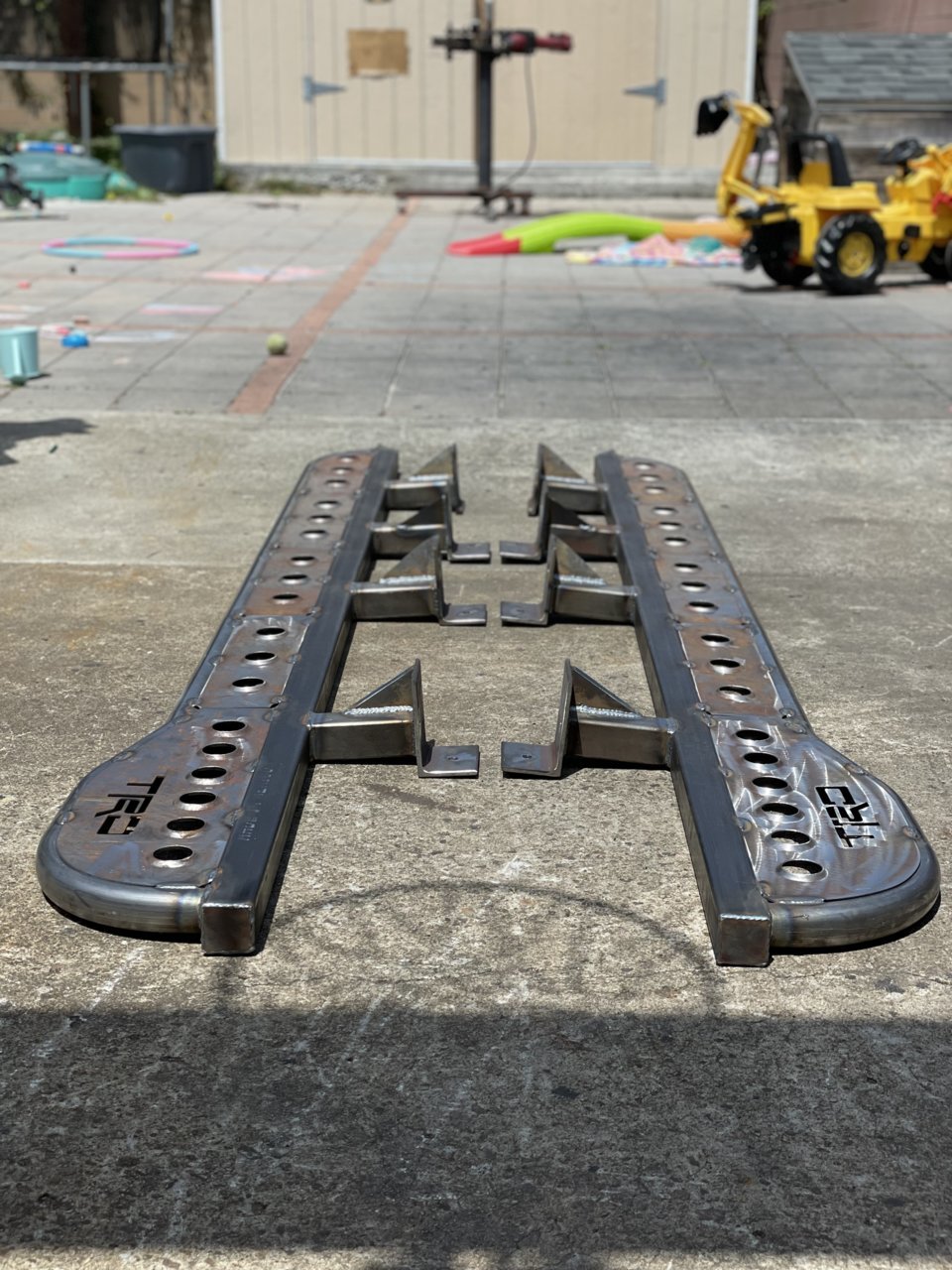

    Another shet of shliders. 21st set of the year so far

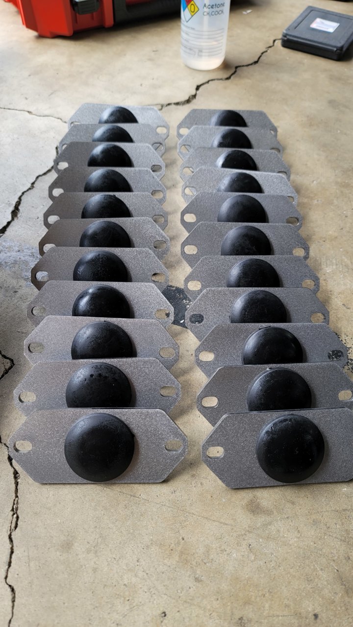

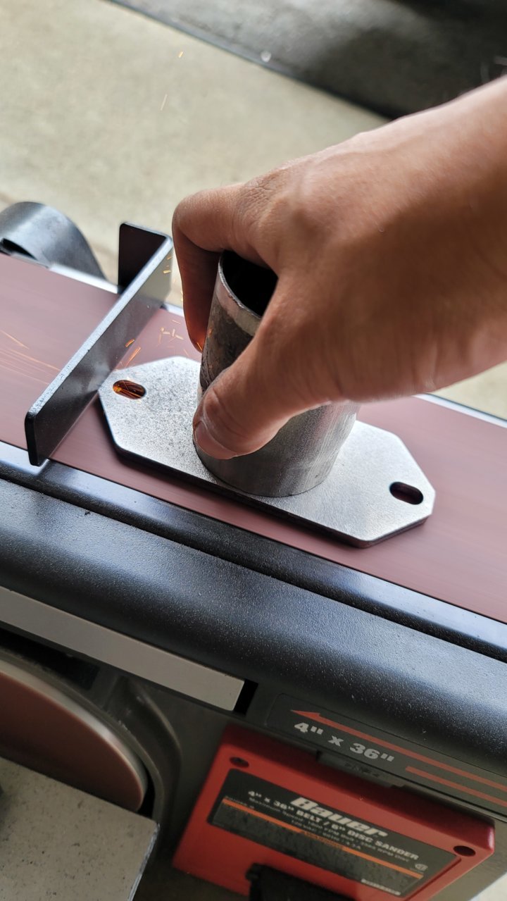

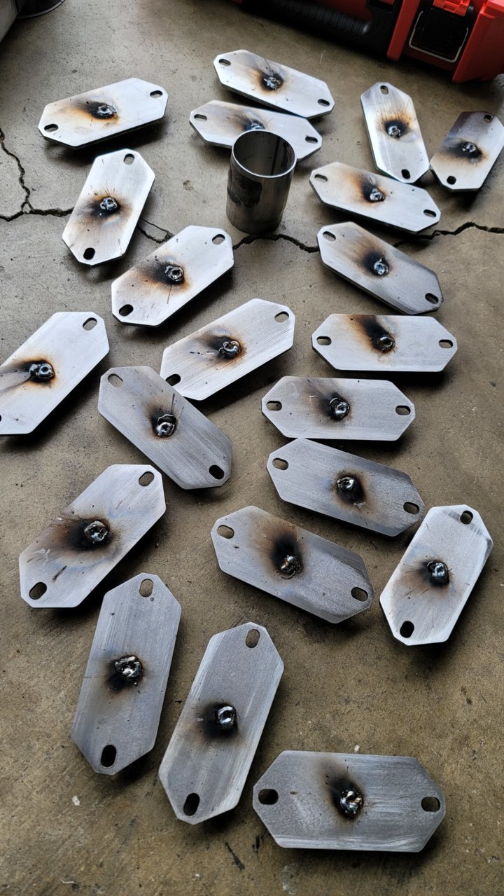

    Small run of low profile bumpstops. Small bead around the bolt on the back side. They're threaded into the plates. Weld is just a safe guard so they don't back out.
    Ground the Weld down so the plates lay flat on the frame.
