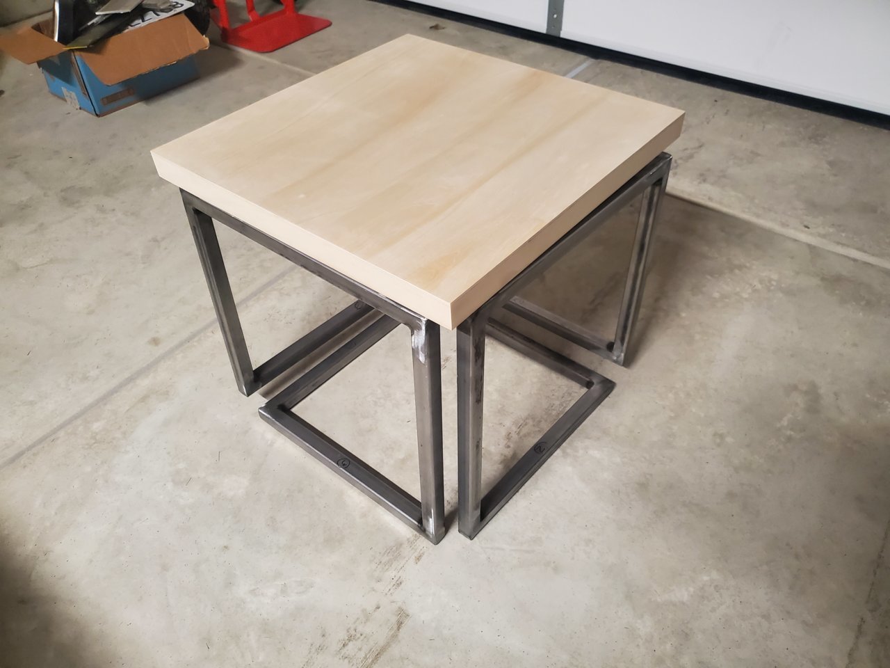

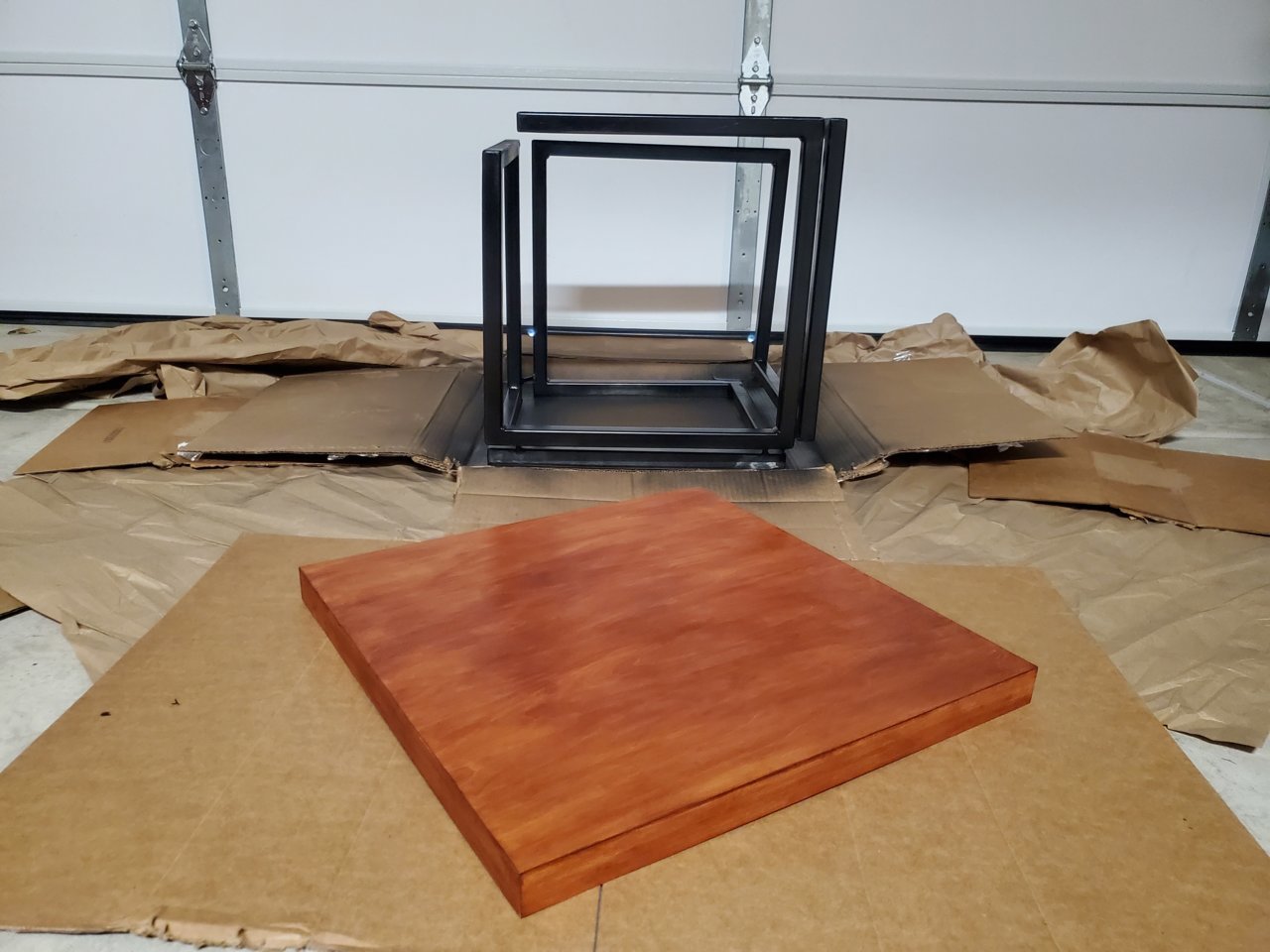

    Only cause I got some positive comments, figured I'd share here.

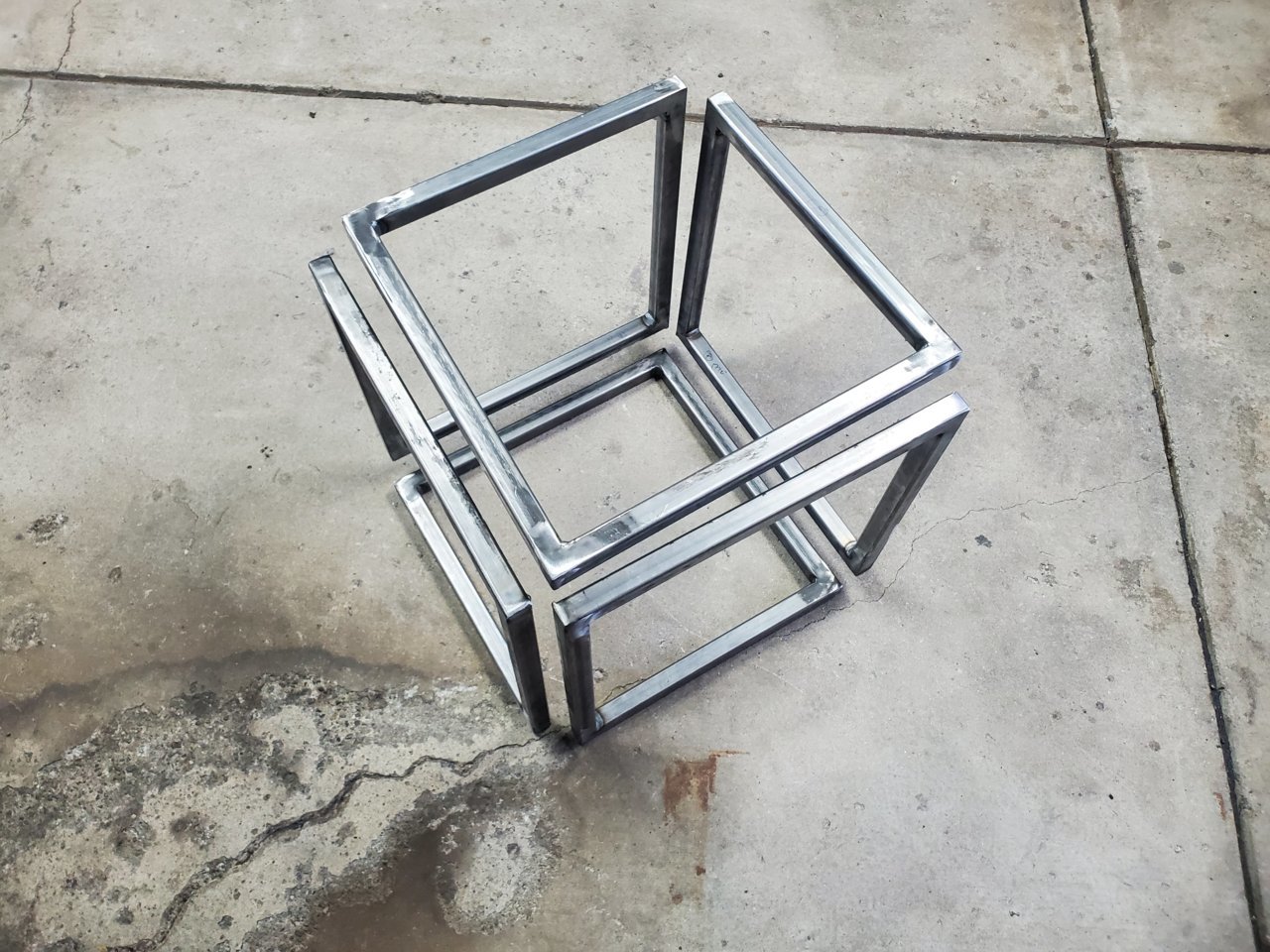

    Little 'Infinity Table' project.

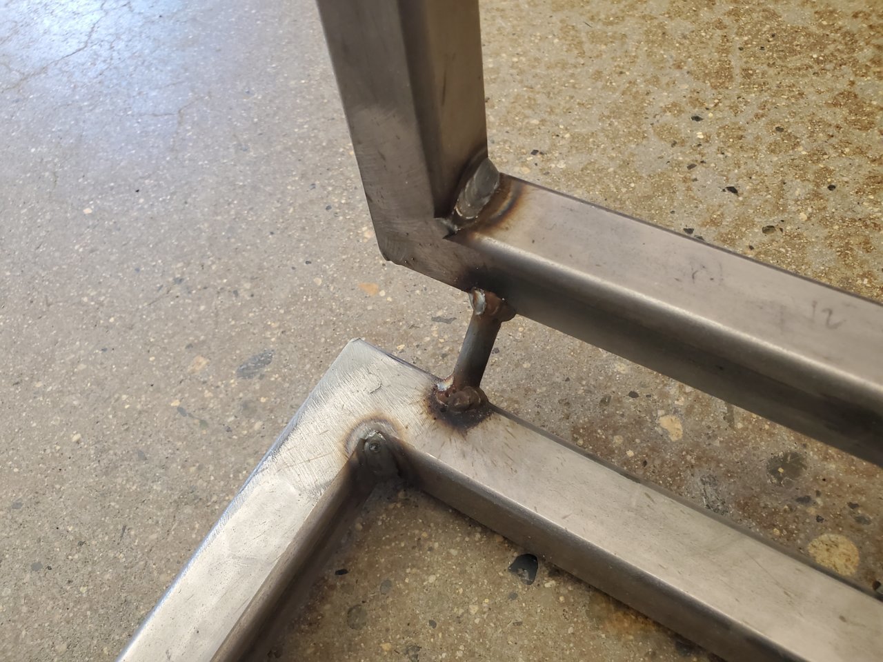

    Here it is once I welded it. Really, I blew through welding it super quick and didn't care that I did get a little distortion. Mainly because I thought I'd just give it away.
    Well, that was easily remedied by making equal length spacers and welding one end together, making it much more square.

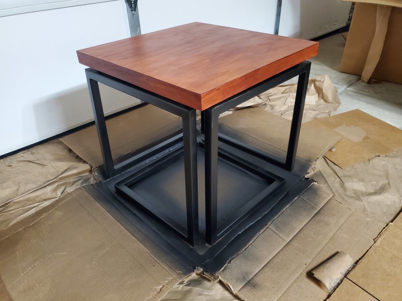

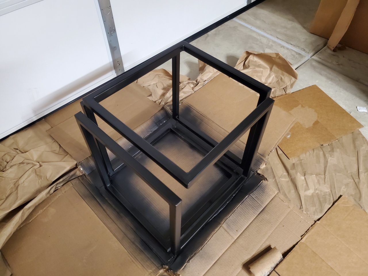

    The idea came to mind to make it a table, focusing on the end with the spacers the 'top' portion as to hide them.
    Can't go wrong with black, but to make it go together, I needed something 'bold' the wood.
    It's not done yet as I need to give the wood top a sanding. Also need to drill and weld some pieces of angle iron to mount the wood on.
    Other than that, doesn't look too bad!

    I can only say that is a very interesting table design!!
    Tacman19 and Kwikvette[QUOTED] like this.

    Next one I make will be done over a few days as to prevent anything coming out of square.
    This was a "week long" project, that I did all in one day :rofl:
    Thinking I'll TIG weld the next one as well.
