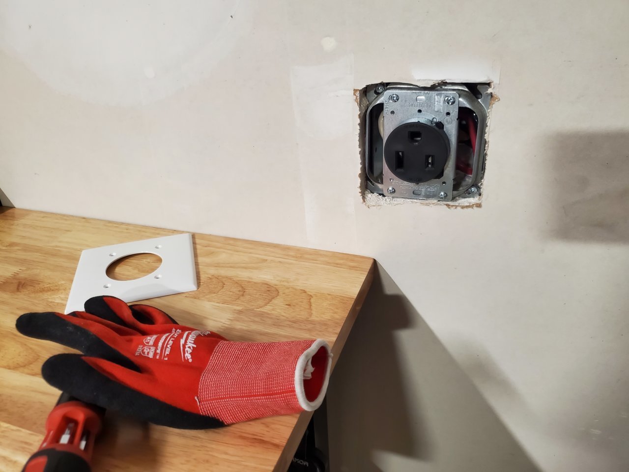

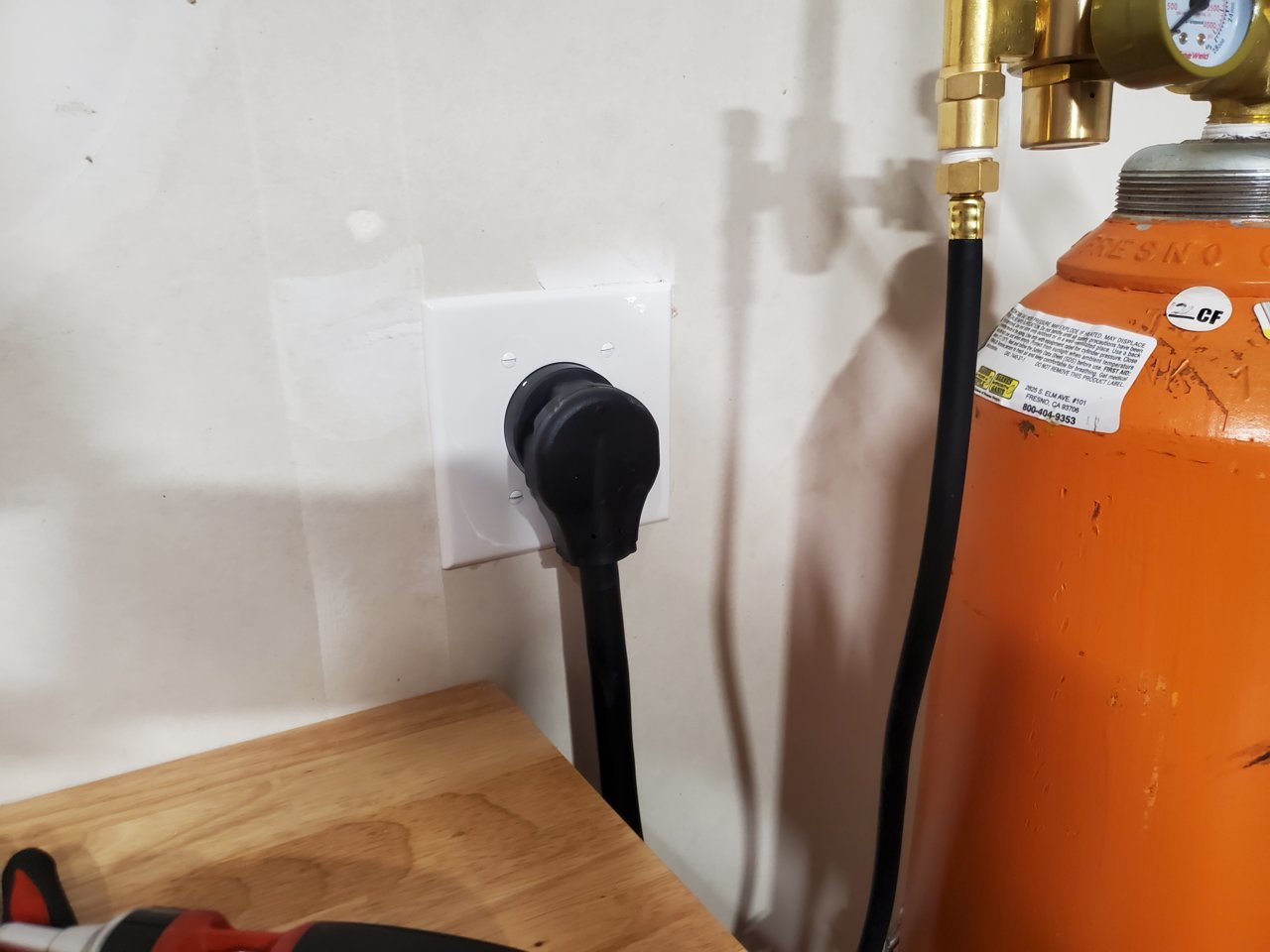

    It happens !! Just turn your plug around.
    Better yet just hard wire and be done!

    I always change my plug and sockets to 30 amp twist locks. I change the cords too . They are always too short .
    I hate those 50 amp plugs and the cords are stiffer than a wedding prick!
    There is nothing in your welder that requires a 50 amp plug and 6 gauge wire.

    50a GFCI! my welder 220 outlet does double duty for beer brewing.....

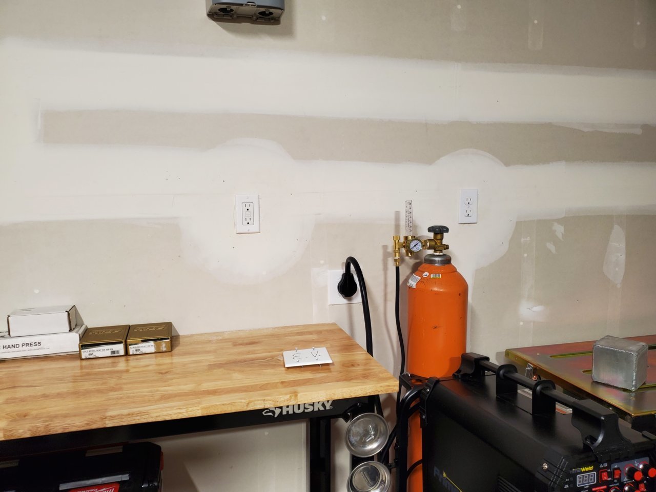

    Read my mind :thumbsup:
    Won't hard wire though as I want to have a second welder to swap with.

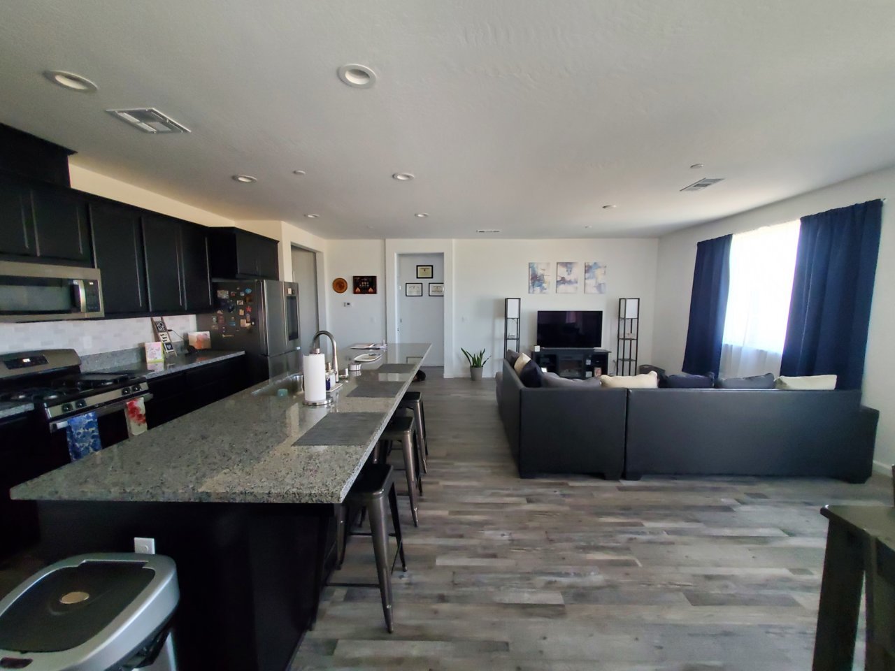

    Freaking love having a garage again. Just dealing with 'settling in' which will come in time. Still need new couches, dining table set, and my stools are still in transit.
    I have this nagging feeling to install track lighting between the dining/living area.
    The kitchen lights very well with 8 recessed lights, and dining area with it's own 2 recessed lights.
    Here's all 10 of them on (excuse the mess)
    However, I do have 2 lamps for the living room area alone
    My complaint is; the kitchen lighting alone is too bright to leave on (when not in the kitchen) and the living room light is enough just for the area itself.
    Track lighting in between might give me enough lighting throughout the living and dining room area, and enough ambient lighting for the kitchen without the need to turn on the kitchen lighting.
    Anyway, all else is great thanks for asking!

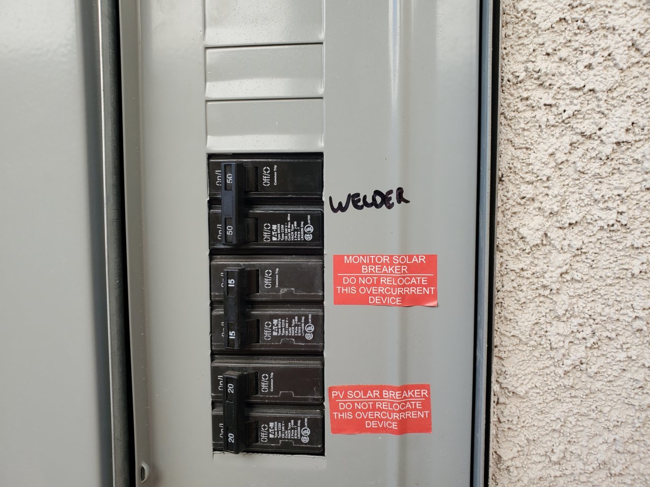

    I just got what Home Depot had :rofl:
    Surprised they had Romex, good stuff.
    Only went 50 amp cause that's what my TIG welder calls for (even though I'll never max it out).
    Guess the good thing is, my welder sits where the receptacle is so cable length is a non-issue.

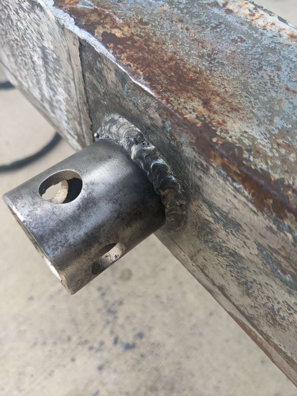

    Trailer that my tractor came with has seen better days. Looks like it's on at least it's 3rd tongue jack.
    Remains of two weld-ons, and the destroyed bolt on that's on there.
    I tried a cutting wheel first and that was going nowhere fast. Plasma cutter made it much easier. Just have to take care not to gouge the frame.
    I have a new ball coupler too but I'm a little nervous about cutting that off. We'll see.

    I do very little welding but it seems easier to weld the thicker stuff.

    There’s certainly a middle size that’s easier than paper thin or mondo thick.
    What’s this project for? :)

    Cleaning up the trailer in the above post. Cutting off old tongue jacks and coupler and replacing.
    Cooked the plasma tip pretty good trying to "flush cut" stuff.

    I want to hate it ... I really do .... but I dont.
    Nicely done.
