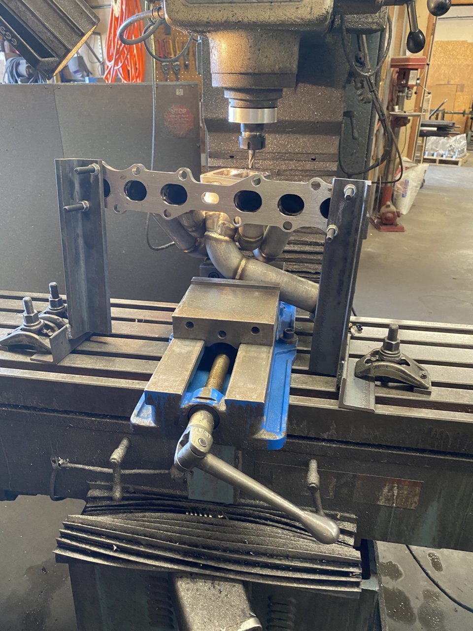

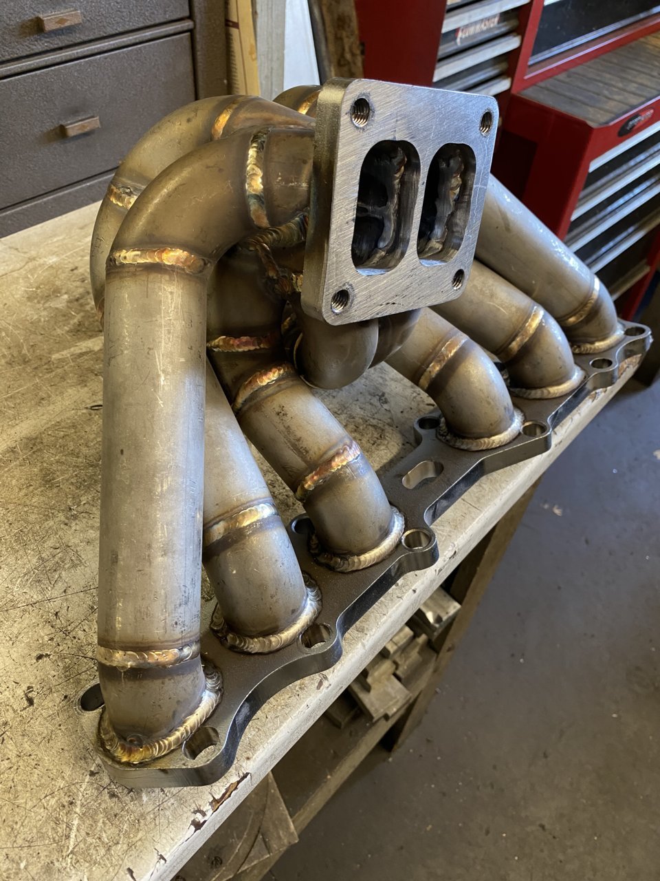

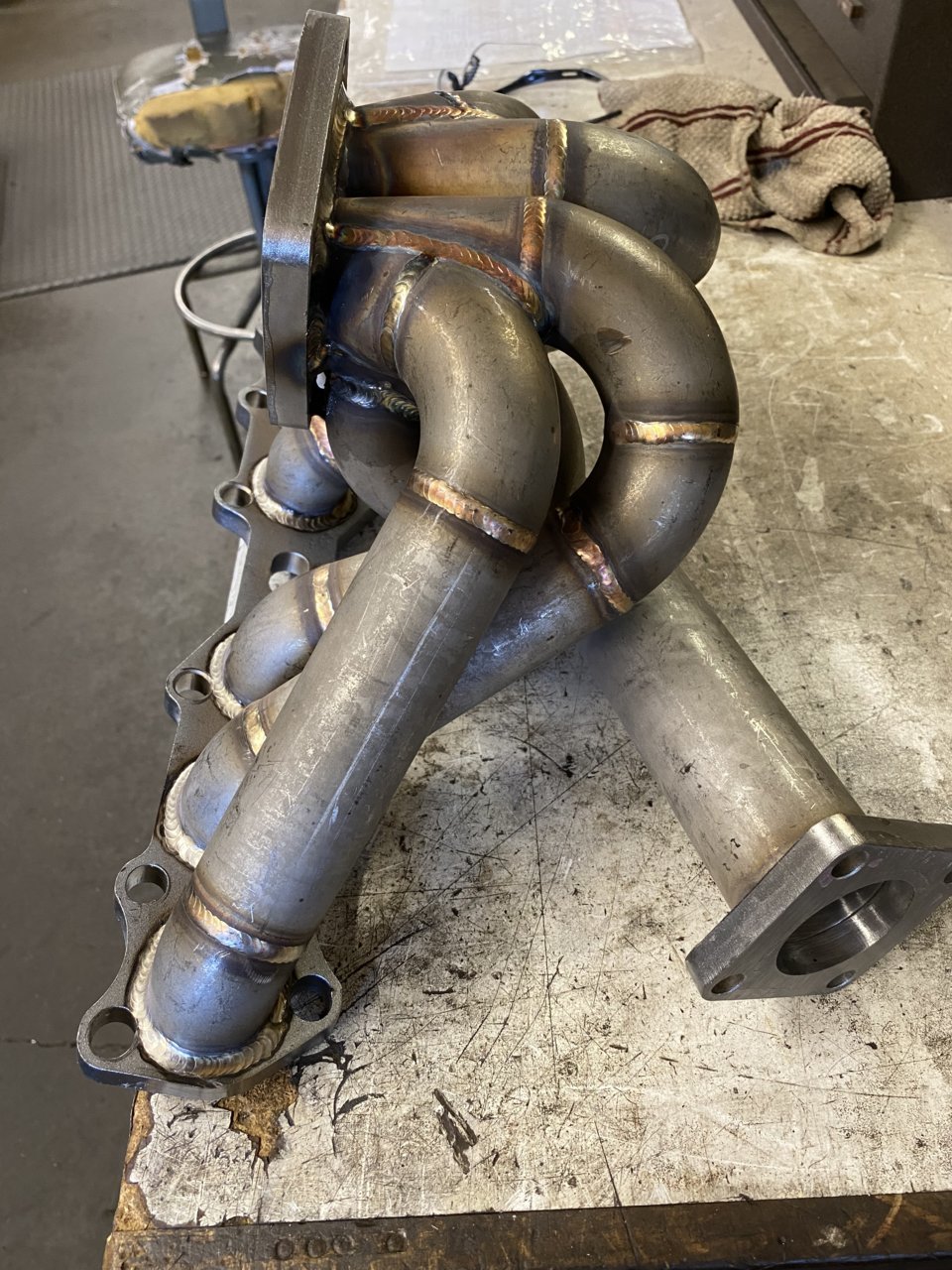

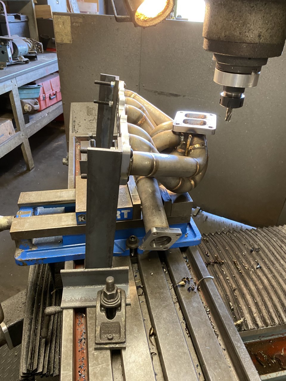

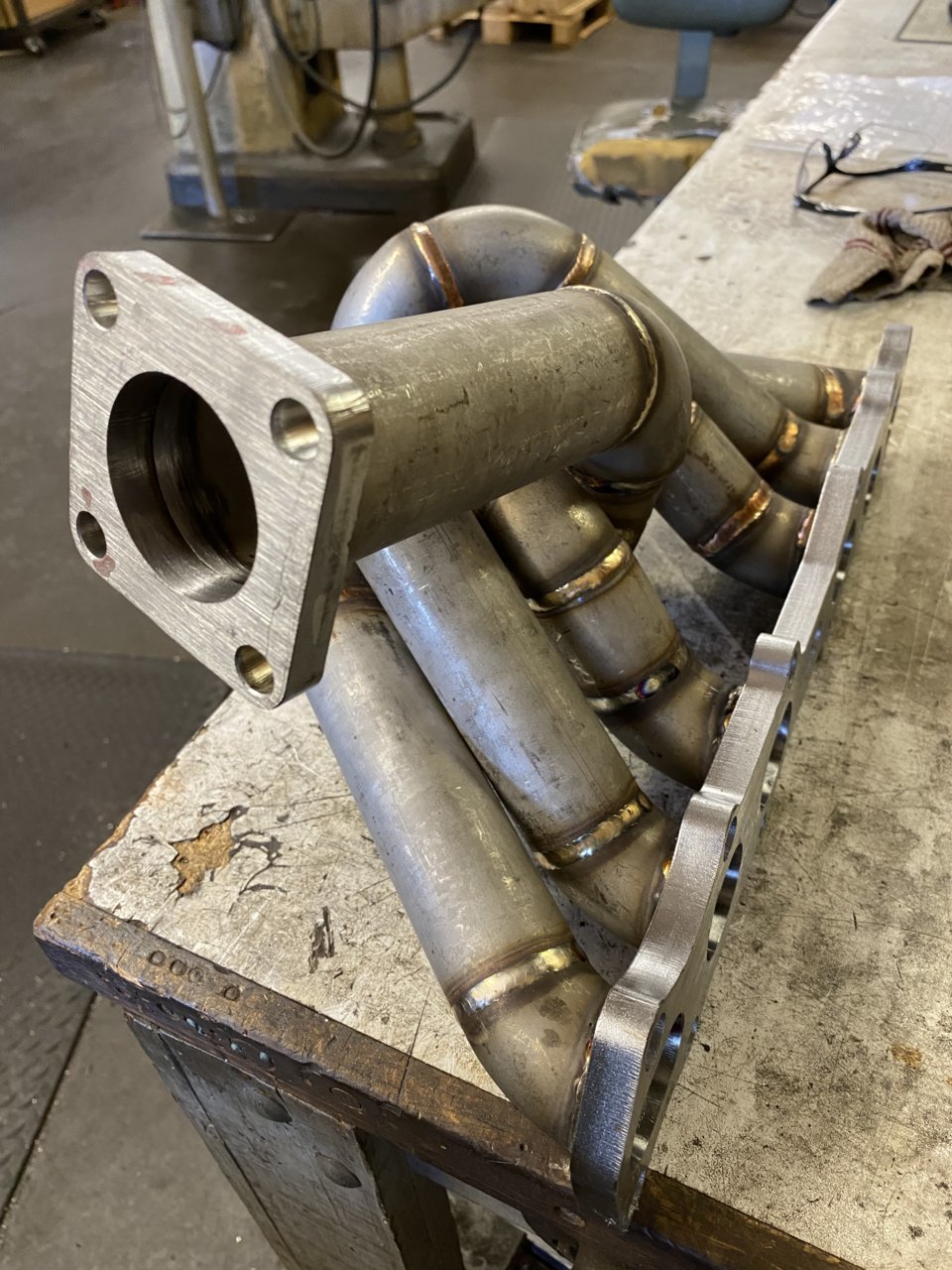

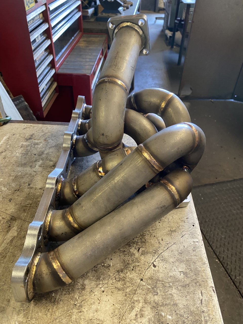

    Some of yawl saw this but thought I’d share it in here. I did not weld it, I just get to make it straight :facepalm:

    Remains to be seen I bought the tires and wheels the rest came along
    Make a custom bracket to allow it to be held on the mill .
    How big of a vice you have will determine how to make the bracket.
    What kind of tolerance do you need to hold when done?
    With all those welds That has to be very expensive custom manifold .
    i hope the boss man bid quite high on this one.

    No drawing, customer just ask for it to be flat. I started on the square pad first. Took .060” off of it, almost there :D

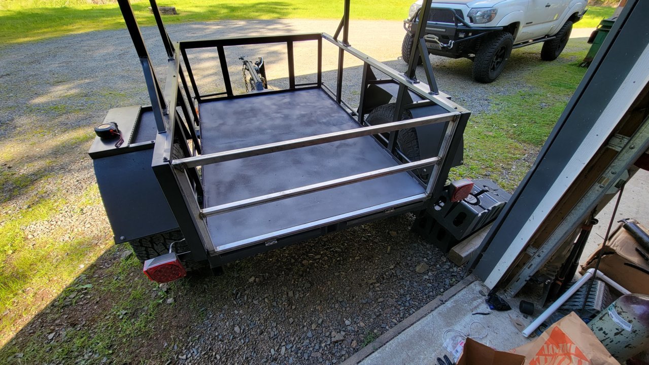

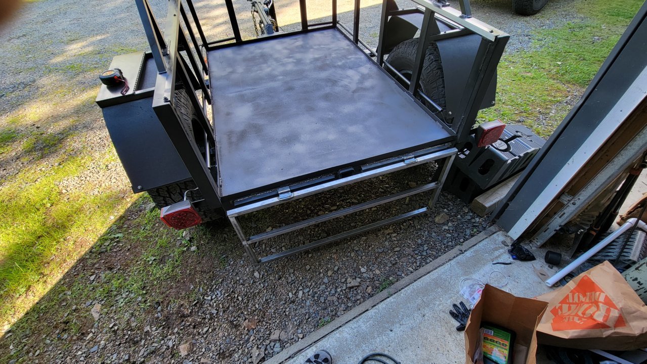

    Almost done with my trailer project. Was starting the tailgate last night and had that "why is it so bright, I can't see shit, oh dammit my helmet battery is dead" moment.
