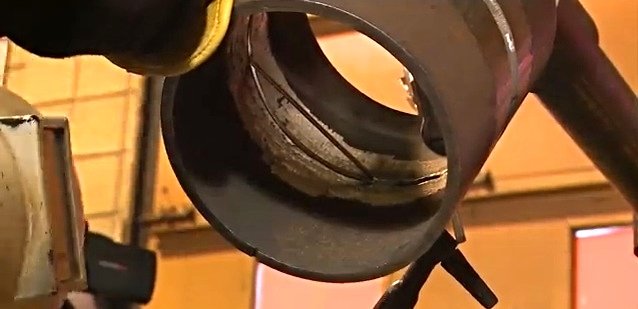

    When I'm doing a carbon tig root, I use a loose 1/8 gap and sometimes a touch wider (if it tightens as you come up, just open it with a grinder). I usually turn the heat up a bit (or you can use a remote/foot pedal) and feed the rod from the backside of the root opening. Always make sure your tungsten is sharp. If you accidentally dip it in the puddle, change it with a sharpened one.
    I prefer to free-hand the root, but some people like to walk the cup on it. If you're not familiar with walking the cup: http://www.youtube.com/watch?v=UKaPIpxIneE Skip to 5:10
    The ceramic cup rests in the groove and you walk it almost like you would with a barrel or drum. There is a lot more movement when walking the cup, but it will also make a very attractive cap if you ever tig all the way out.

    I found that video on youtube pretty quickly when I typed in "walk the cup tig root". There are lots of other video's for different types of joints, but this is a good video for someone learning to tig pipe.
