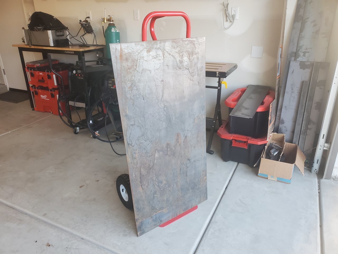

    Free steel?
    24" x 48" x 3/16"?
    FUCK YES!

    You can`t just say Free Steel fess up were it came from!!
    Funny how many things get thrown out when jobs end that followed me home.
    Not in the trade long enough to tell thickness just by looking?

    This was from my wife's family member. He's got a small bench top band saw that he's letting me have for $50 as well which I couldn't pick up yet (space).
    As for thickness? I don't get it?
    3/16" is super easy to tell, as I weld that 1/4" and 3/8" a lot at work.
    Maybe it came off as if I was asking...I meant it in conjuction with "free steel?" As in hell yes!

    With the Question mark behind 3/16" I thought you were not sure of the size .
    So that was just a typo?

    Picked up a nice sheet of 3/16 about 3'x5' it was the cover plate for a piece of equipment we wrecked out.
    Yes free steel is good

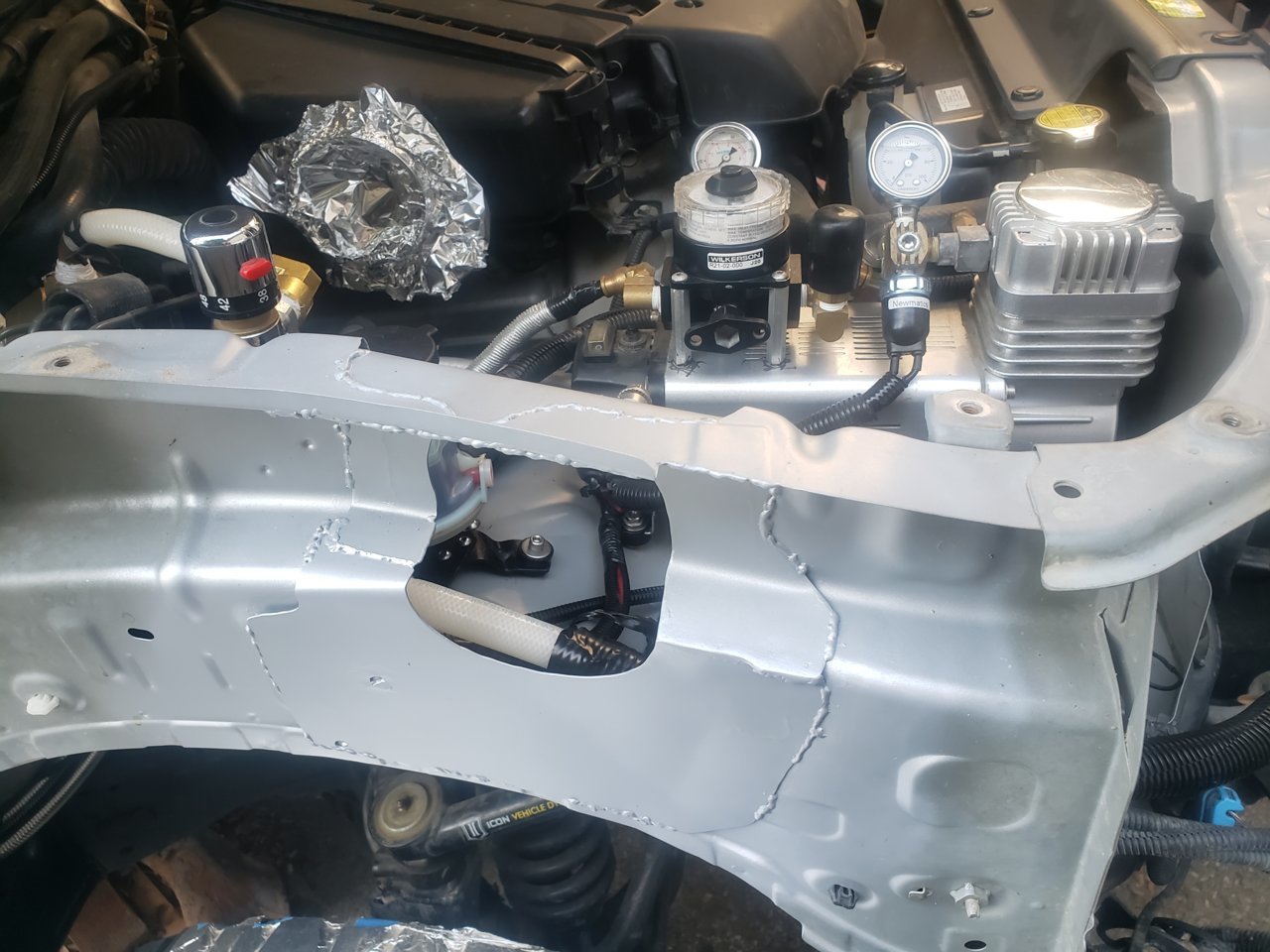

    Howdy folks, got a rust prevention question.
    I made this shitty repair panel to fix a part of my cab that was super fatigue cracked. I was trying to learn tig, so the repair panel is stainless, but all I learned about tig is that I'm thoroughly incapable of ever learning it. I switched back to mig to attach this abomination to the truck, figuring I'd be slightly less incompetent with the simpler technique, but the results don't necessarily support that hypothesis either. Finally I painted it all, but not before managing to permanently destroy the paint on my hood in the process. On top of it all, it took me nearly 6 months to accomplish this, due to my abjectly terrible time management skills at work. So overall... about par for the course!
    Anyway but there's a bunch of bare steel behind all these shitty overlap joints. Should I smear everything over with body panel sealant before I try to put the bodywork back in place?
    The goal is to prolong the onset of rust, but I wanted to ask others, because so far, my intuition has only made things worse.

    You are welding stainless to carbon steel. You will not be able to achieve pretty welds. The nickel in the stainless is gonna give you troubles.
    If you got it to stick, you are doing fine.
    Stainless will weld to carbon steel, but a grinder and paint will always be required after.

    Whenever I've welded mild steel and stainless (MIG) I've only ever used trimix and appropriate solid wire. That or 308L rod if I'm stick welding.
    Could one MIG mild steel and stainless with other gasses?

    I've MIG welded stainless to carbon steel often using CO2/Argon. It's not a big deal.
    The weld will rust as well as the carbon steel.

    Straight Argon and 309L I have done quite a lot of that over the years. I don`t have problems with bad welds when welding stainless to mild steel.
    Wrong shielding Gas?
    The fancy gas blends do come into play most where developed to save on labor finished goods for retail.( clean up time)
    Then charge higher prices.
    Being there seems to be an ever growing number of blends of stainless one needs to figure out what works with each blend.

    Ideally 309 stainless and I have heard over and over you should never use straight argon on stainless mig welding, but I have seen it done rather well on thin material. If you are welding to code, then follow procedures by all means, but I learned long ago to never say never.
    Some cored wires use straight CO2.
