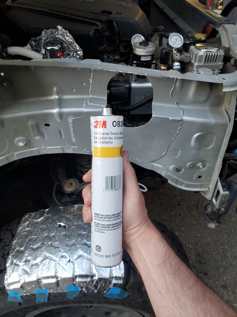

    The repair panel is 316 or 304 (I forget, but whatever is most weldable, maybe there's an 'L'?) .05" thick welded (poorly) with 308 filler and straight argon. I researched it before starting this, many months ago, and picked the right numbers according to the internets. But then go-go-gadget: poor time management skills and suddenly it's 5 months later and I have no idea where I even put the parts I pulled from this truck much less how to reassemble them, and I'm trying to plan a vacation starting Friday. No joke, I might have lost the steering wheel. It's not in the truck or the garage.
    From the receipt on my welding cart, it looks like my original plan was to install the panel with 309 rod, which I bought while picking up my 3rd 120 bottle of argon knowing full well I had never produced a single passable tig joint. But then in a moment of clarity, I gave up on tig and went for 0.023 mig or whatever the common "tiny" size is. I let the sparks fly, then I painted it before consuming myself with work for another month.
    Now I'm wondering if I should smear it over with body sealant or just leave it as is.
    I'll mention I did a handful of tests with the leftover stainless stock from my failed tig-learning attempt, mig-welding it to pieces of the body sheetmetal I cut out of the truck. First to tune in the mig settings, but then to waste additional time without actually repairing the truck. Did I mention i have terrible time management skills?
    I was pretty impressed, the bodywork always failed first, not the actual welds, even on some truly terrible looking joints. The test joints always broke near the seams, in the heat affected zone, but the welds themselves held up. I guess that should be expected because my repair panel is 2x thicker than than the bodywork, and my welds are gigantic piled-up turds of self disappointment, but I was at least bending it with the brake positioned over the thicker material, trying to sever the fused material, but it held.
    Of course all my test material came from regions of the truck that had already been pushed past the onset of fatigue cracking, so the whole test was bogus. But the results gave me reasonable confidence in my shitty welds, and at this point I don't even care.
    Anyway, is it a good or bad idea to smear body panel sealant over this type of repair?

    It's done all the time. Don't sweat it.
    mk5[QUOTED] likes this.

    Sweet guys, ima poop in this goop from all sides but the bottom. Never leave your enemy without an escape route, right?

    Meh.
    When I re built my 04, I just used roofing tar.
    Still going strong.

    I would use seam sealer. Being in the wheel well, those joints would most likely see their fair share of mud/dirt/water/etc. And all that stuff will find it’s way into the tiniest opening that may have been over looked. from what you describe, it took you a long time to complete the repair so imagine the task of having to do it again if there was a failure. Ounce of prevention and all that.
    I started my welding journey with sheet metal long before I made anything structural. If I had attempted that repair myself, I would have lap joined the panels with a flange and rosette or spot welds every inch or two and then just seam sealed the joint rather that try to weld the entire seam shut. Faster and would have most likely disappeared once painted since that’s how a lot of joints are done in the wheel well anyway. I know h

    Exactly!

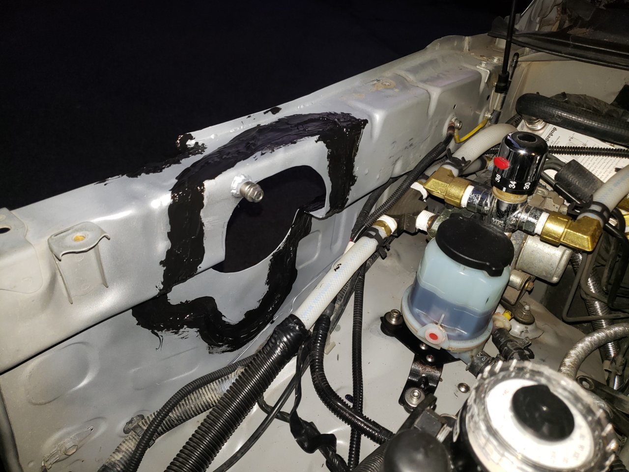

    Thanks guys!
    This thick black caulk totally filled every crevice. Without doubt, this was the way to go.
