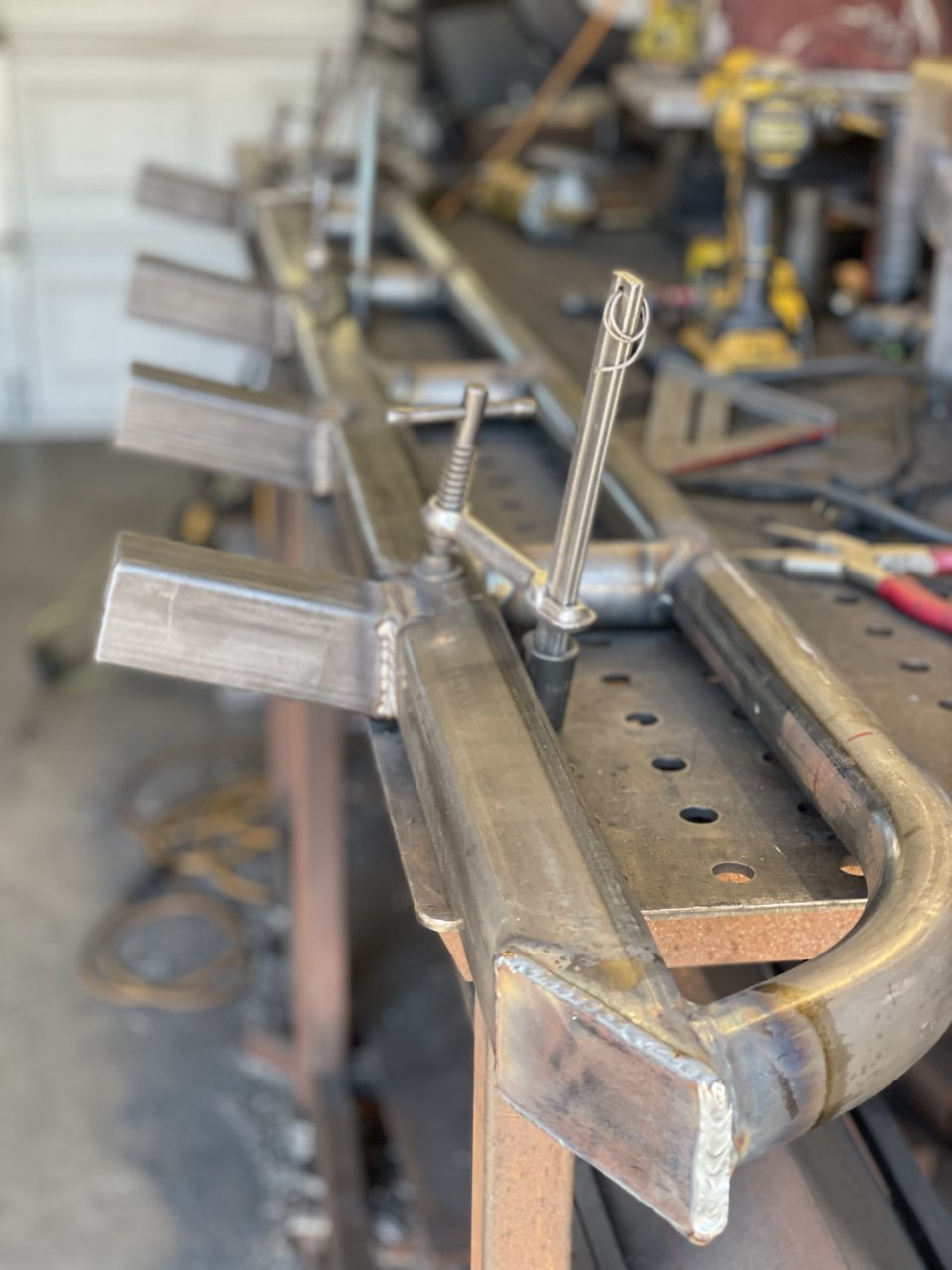

    Another set finished today

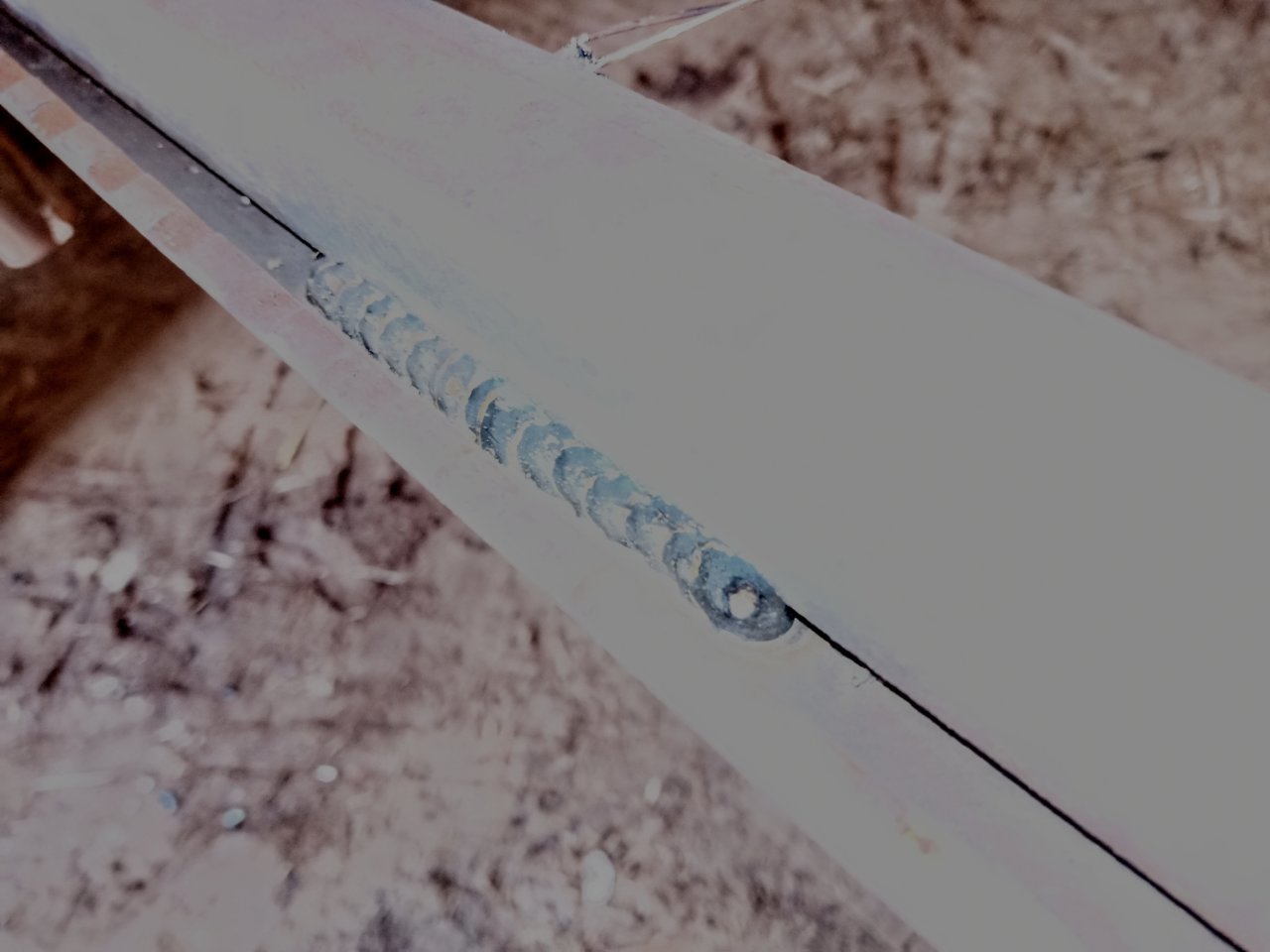

    When you are using farm equipment, you are breaking farm equipment. Dad had broke a boom on his spray rig and we got it braced back up. The pic sucks cuz I had to use my flash cuz it was down in a hole so to speak. But I was pretty happy how that weld came out considering how hard it was to get to. And the other was after I got everything dialed in... And much easier to reach. I did have some much worse looking welds that didn't make the pictures lol.

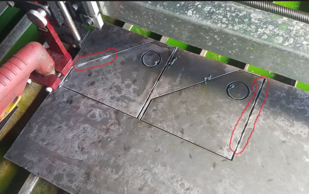

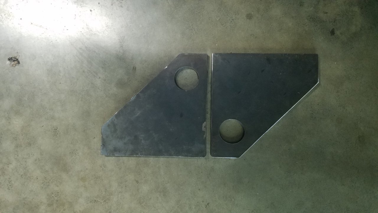

    Just finished a few cuts on some brackets for quick attach pallet fork setup for my tractor.
    Lesson learned: when cutting 3/8" tread plate, set your amperage high enough to account for the bump outs (treads) on the back side. See those boogers? Those are areas where I didn't get cut all the way through. The wavy look on the right is where that caused the arc to be deflected.
    Live and learn. I've got some more to make. I'll try to do better :anonymous:.

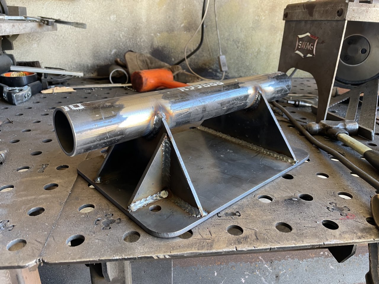

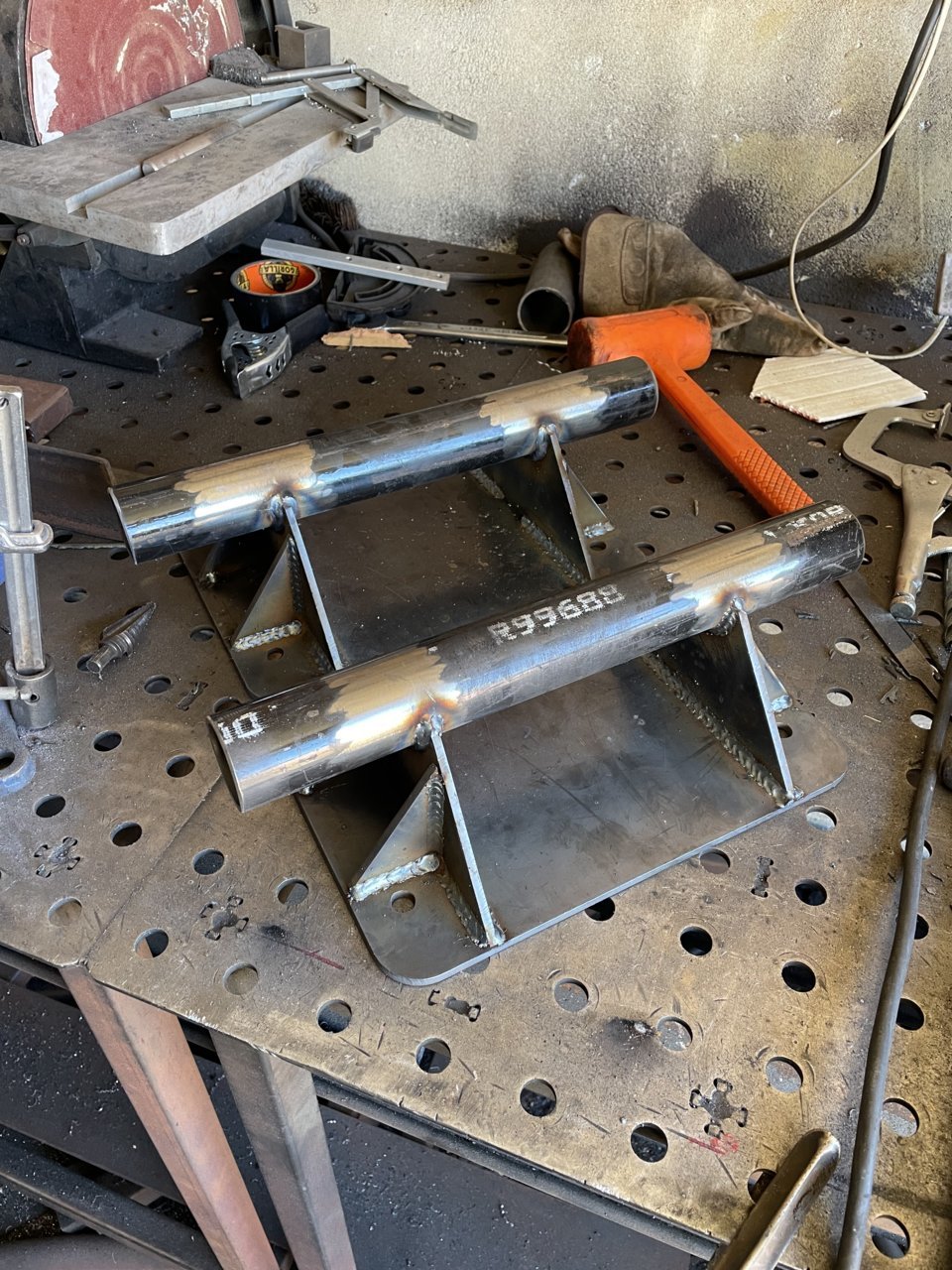

    Made some winch mounts today that need to be able to mount to a pipe. We’re using these winches to wirelessly adjust lighting panels off of the basket of a boom lift. Kinda hard to visualize the rig but I’ll post pictures once we actually rig them. Anywho, my boss asked me to make something that would work so I came up with these.
    Boss also said, after the show is over I get to keep one of the winches :yes:

    Nice...

    Thanks dude. The plasma table and some basic CAD knowledge can make a lot of ideas come to life.
    Yay for metal!
