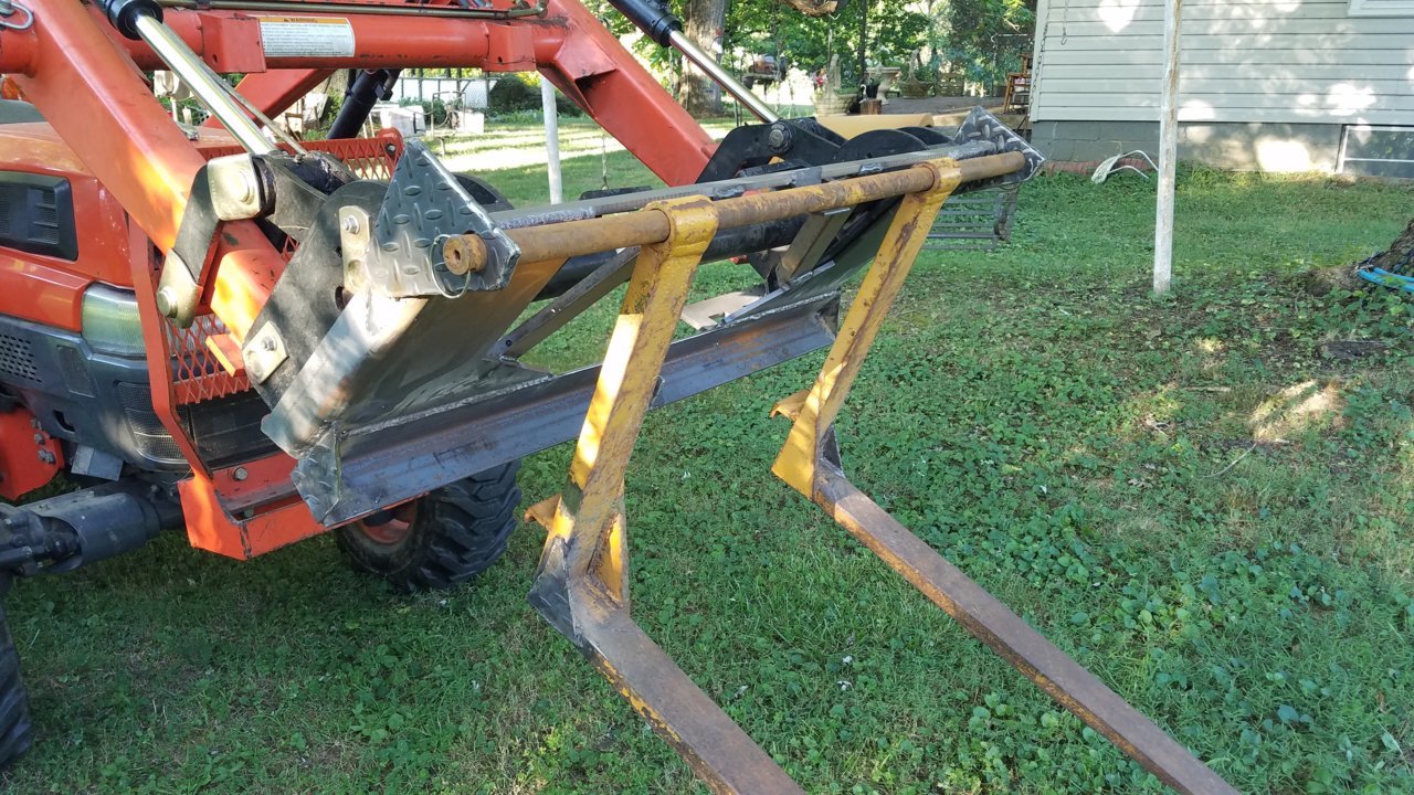

    Bunch of stuff

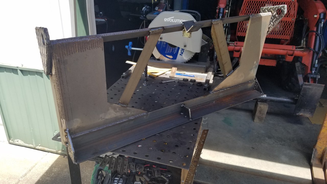

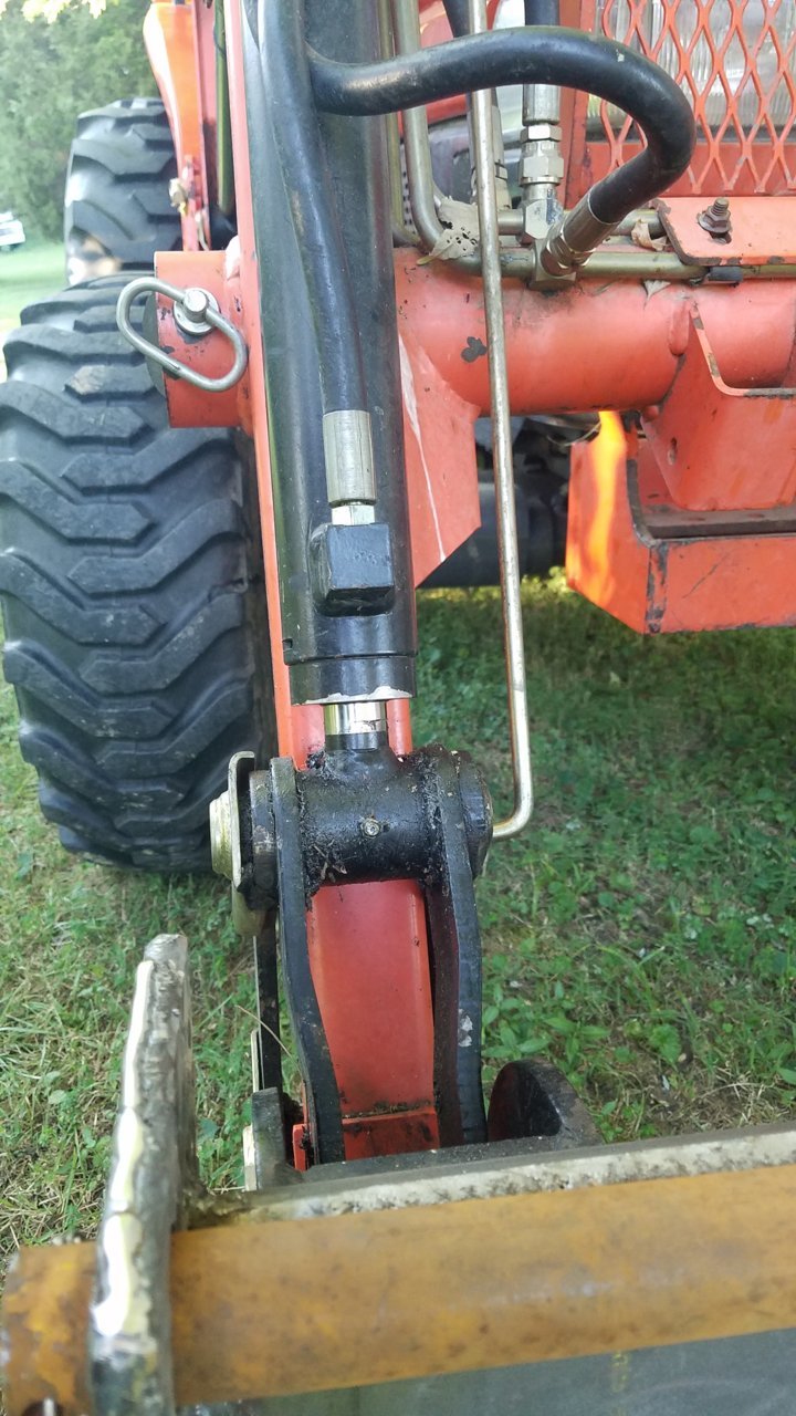

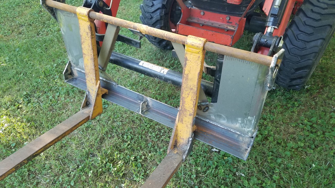

    Made a quick attach pallet fork for my tractor. It turned out okay. No show welds, but they'll hold. My stick welding is not as good as Mig, but decided that was best way to go in this 3/8" stuff. Mig tacks, then 7018 rods.20220713_140516.jpg
    You tilt to adjust the distance between the forks.
    You have to design in some back tilt when your forks are flat on the ground. This helps when pickup up pallets. You can see I still have an inch of cylinder rotation when my forks are flat on the ground.
    Also, if you are making a setup for a tractor with some hours, you need to level the forks and build around that. I mean my loader frame has some twist in it from use/abuse, so if I welded everything on the left side and right side the same, my forks would have been uneven when sitting flat.

    :thumbsup::thumbsup::thumbsup: Good job I feel sorry for people that can not do these things.
    Did your 7018 come out of the oven? It can be difficult trying to use moisture soaked electrodes.

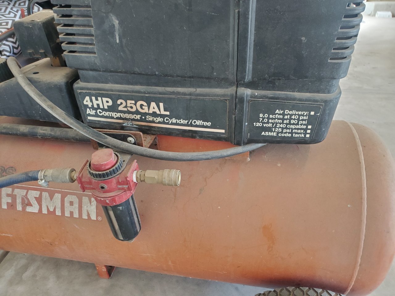

    I got an air compressor for my plasma cutter finally.
    Actually, I didn't expect it (on top of the fact that he trenched my yard as a kind gesture).
    Anyway, it was free! My wife's uncle told me he had an air compressor for some years and he's used it twice, due to the fact that he's got 2 and this 1 is too big to haul around often.
    Requirements to cut 7/8" steel are to have 5CFM@80psi. I remember the general rule of having 1.5x the amount of air needed so it's nice to see that I've got a great buffer here.

    It's plugged in and tucked away; just need to plumb for air so I can have a drop near my plasma cutter. Don't have any hose or anything to run yet.

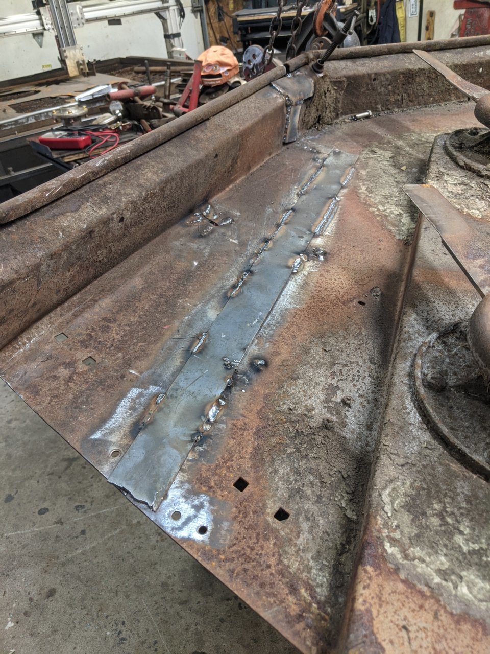

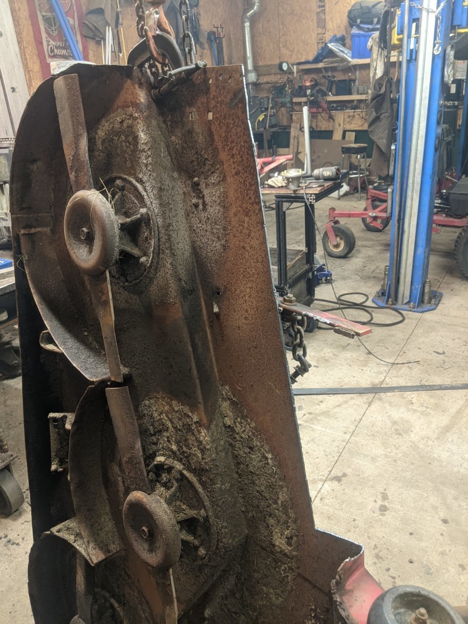

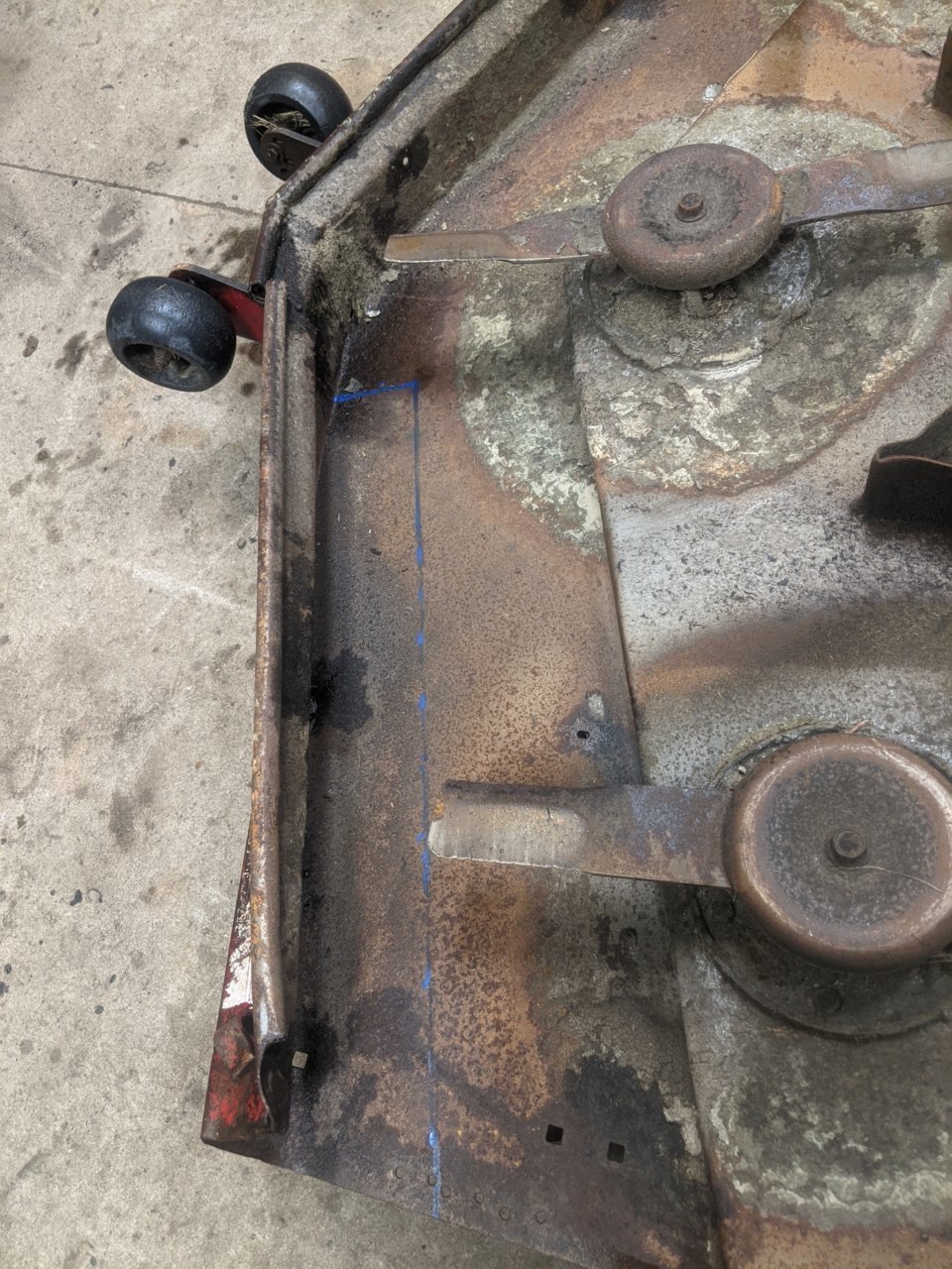

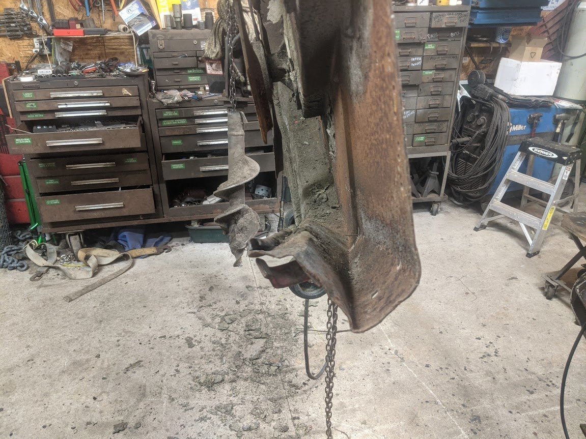

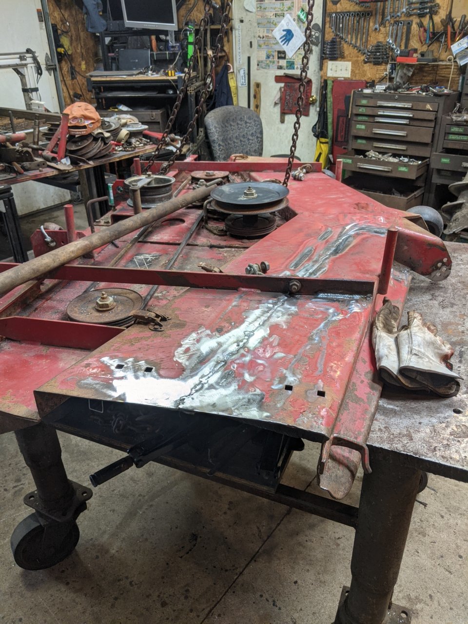

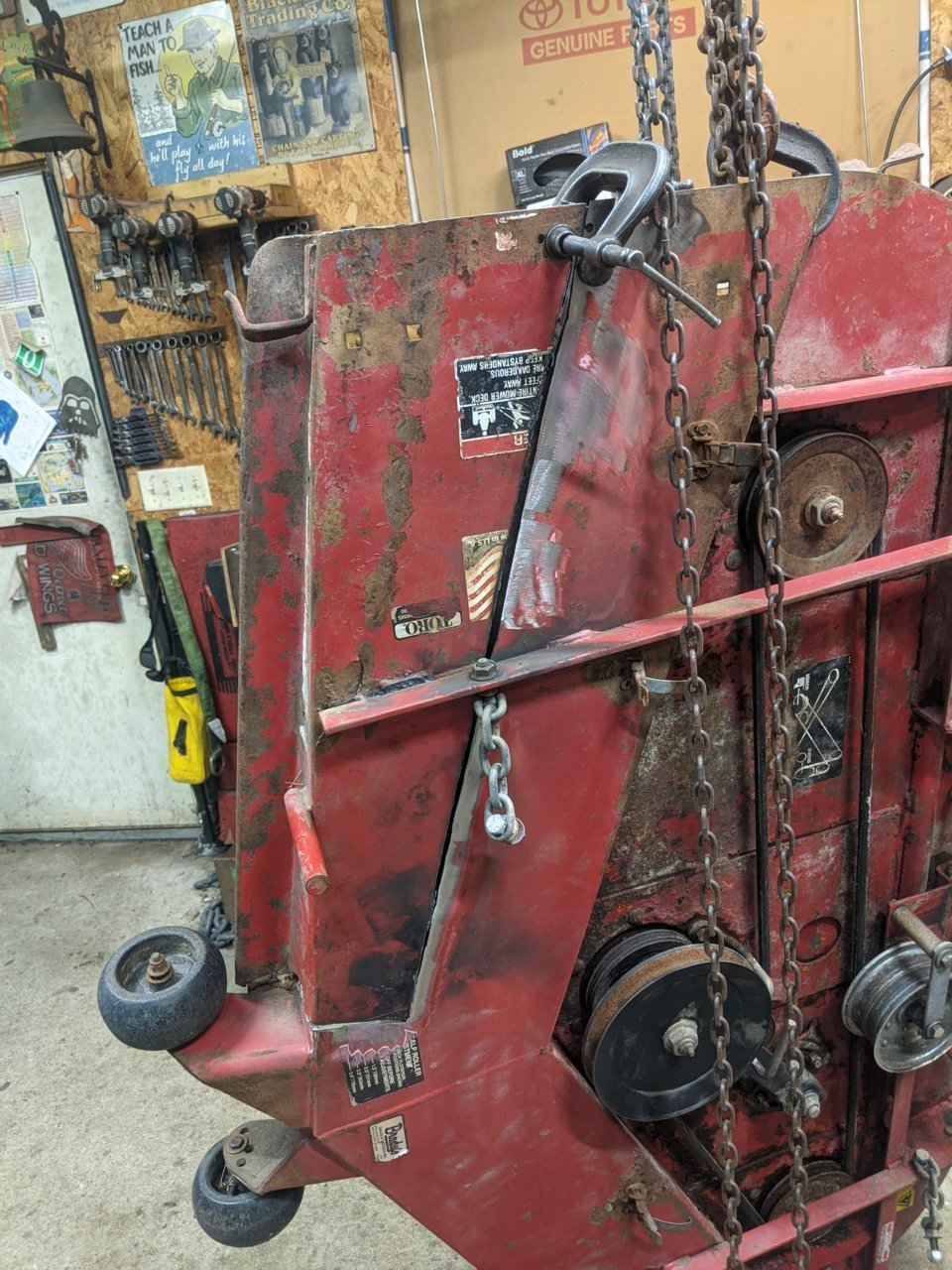

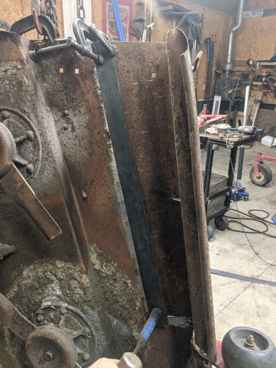

    This mower deck was bent pretty bad.
    Figured it would be easier to cut out the bad section instead of fighting the entire deck.
    It was much easier clamping the bent section to the fabrication table. At that point "C" clamping a lever to the bent parts made it easy to straighten out the damage.

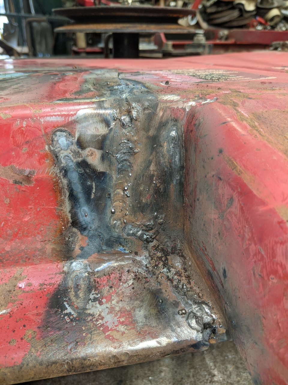

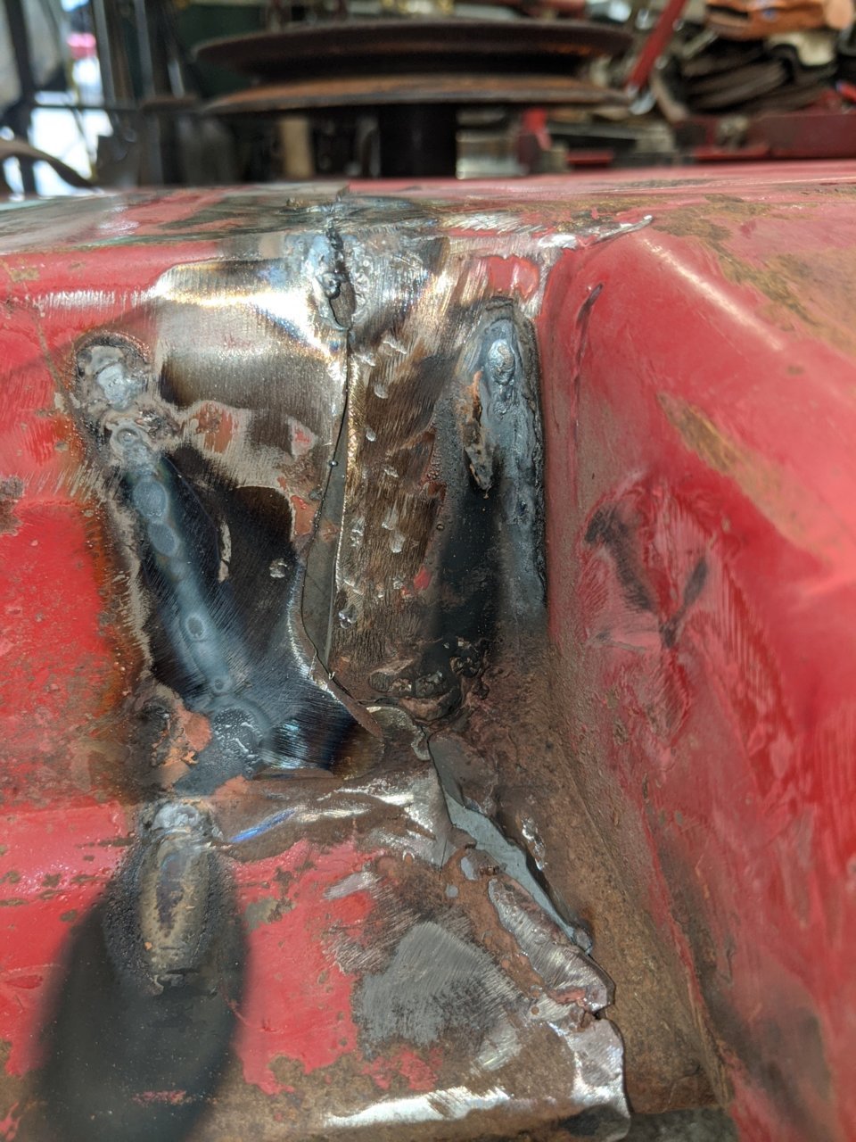

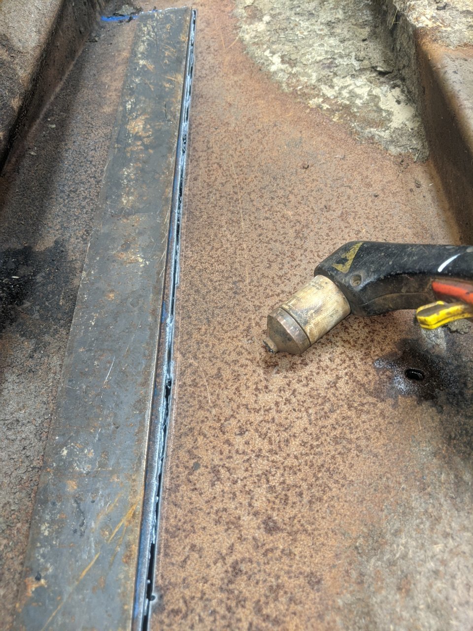

    I'll have to be happy with those corner welds. No way to get a grinder in there to pretty it up.
    Welding on old, painted rusty iron is always gonna make you unhappy with your welds .
    Nothing the coats of paint won't cure.

    This the after pic of the torn iron.

    It's good that you are going up and over, then down. Compressors produce lots of water. Fortunately liquid water has trouble being carried up and over to the P. Cutter.
    Think about installing a second air hose at the low point of the tank. Put an air nozzle on this hose and blow out the water on a regular basis.

    It's cool that there's a separator right near the regulator, but I will add one more at a drop. One of those that has a quick connect/disconnect like we had at work.

    No, they were a mix of some from the original plastic carton I had, and ones my brother-in-law was going to throw away because they had been in his garage for years.:anonymous:
    Thanks for the feedback and I agree. Sometimes I wonder how people who can't do their own vehicle repairs, house upkeep, cut, weld, fix their lawnmowers, ...., how do they afford to live? I think if I paid someone to do all the things I do, I'd be living on the street.
