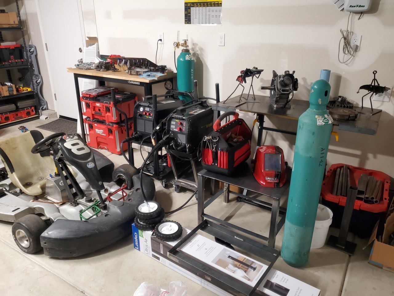

    Stoked, got a second 150CF tank of 75/25!
    Guy said it was full, and though it doesn't have the seal on the valve...it's heavy as hell. Had a fill date of March of '22 and it came from the same local shop I get my gas from so that's a plus. He owns a fabrication shop as he builds low riders and said he prefers the larger 250-300CF tanks instead.
    Traded him my RC car for it because really, I have no time nor the interest to mess with it anymore.

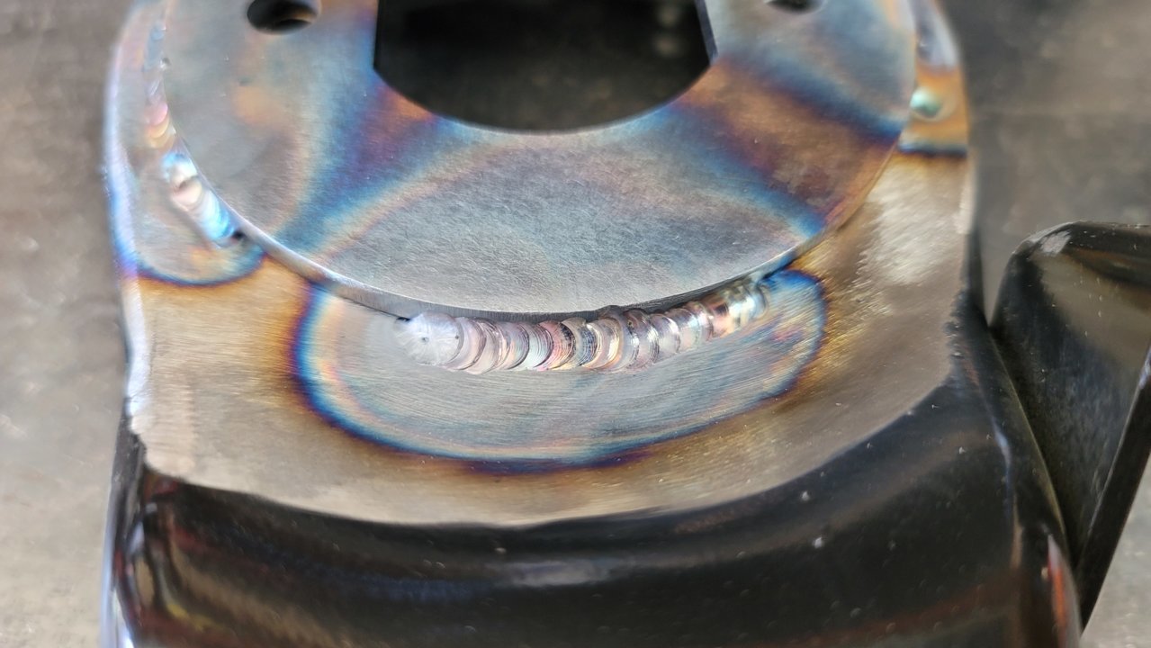

    Only half decent weld from today. I need to do it more consistently.

    Was going to say, it looks good but I'd be worried about the width of that heat affected zone.
    Do you have pulse available on your machine? Otherwise, I'd just weld that with MIG. I use tri-mix whenever I weld stainless steel though others can chime in on the gas they use.

    My machine does, my friend recommended the same thing. I'll try it out next time. As for the gas I only have one bottle so I haven't tried anything other than 100% argon. Not a very big operation in my garage haha.

    more heat, more filler, and more speed. Heat input and HAZ are a product of heat and time, if you can bump up the heat 20%, and increase speed 50%, while adding more filler (100%) you can lower the overall heat input to the work piece drastically.
    and that does not look like stainless, so unless my eyes are lying to me (quite possible) stick with 100% Argon

    It's what happens when I post quickly from my phone :rofl:
    Thought it was based on the lack of mil-scale and the rainbow colored beads.
    Definitely mild steel.

    Yeah its mild steel with stainless filler lol
