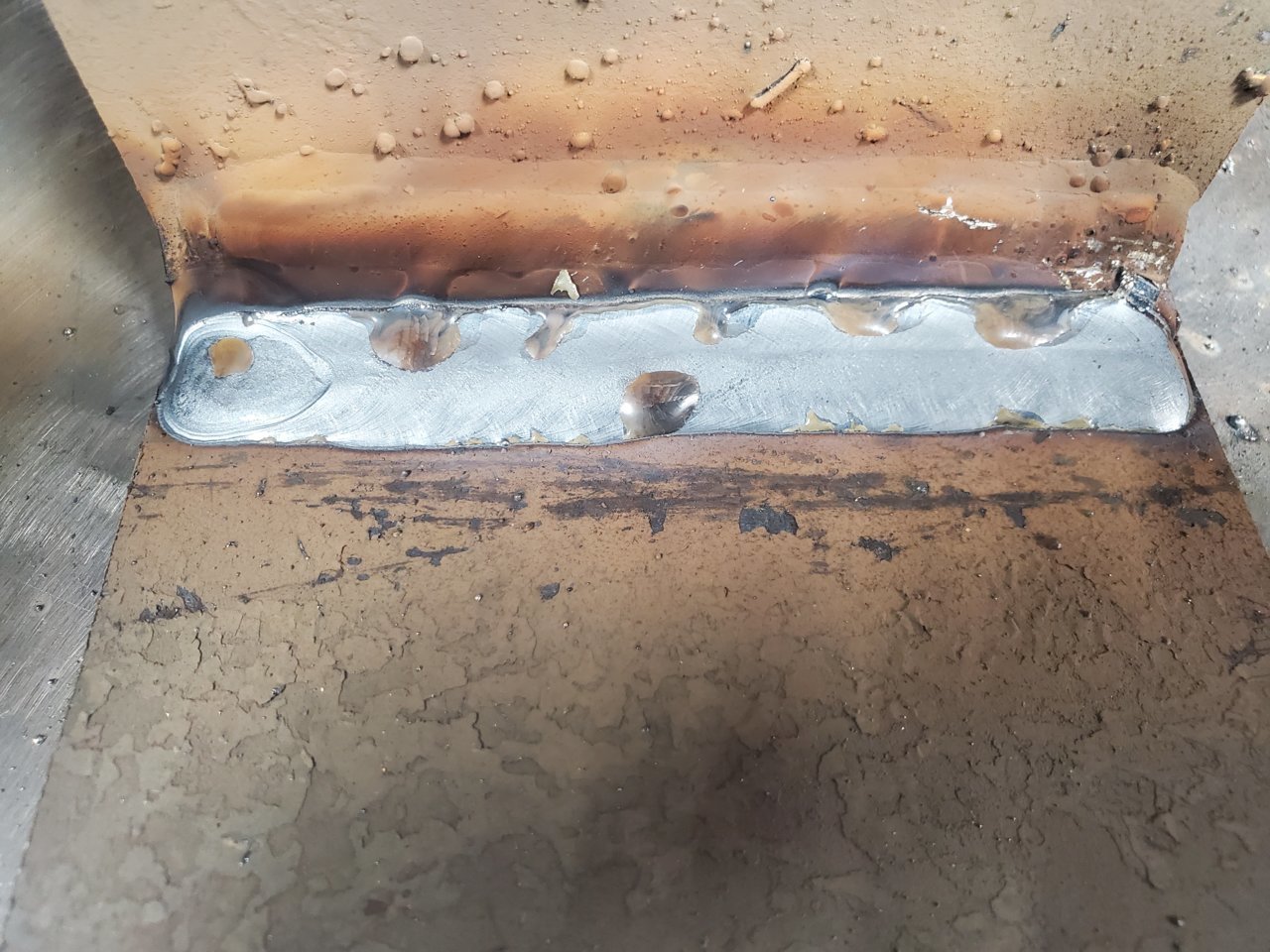

    Sucks when it’s an easy joint and you do one really good weld and the second one the welder acts up.. I get these intermittent times on welds when it’ll jus pop and create tons of splatter. Not sure if it’s a dirty joint or what.. D036FED3-484A-40ED-855D-197AB10EBC0D.jpg33CE6D84-5684-4391-9742-C0A00AB9D39F.jpg3EAA3EB2-5529-4096-8A38-E5B649E7DD7B.jpg5C4F15E6-C594-4142-BAFE-5A68DAA95ADD.jpg

    Liner dirty?
    Feeding issue?
    What kind of machine you running?
    I'm just curiously asking, not knowing how I can be of any help :rofl:

    Does the wire feed change??
    Looks like the output increased this time of year the input power can due to demand fluctuate quite a lot.
    It even effects my microwave.

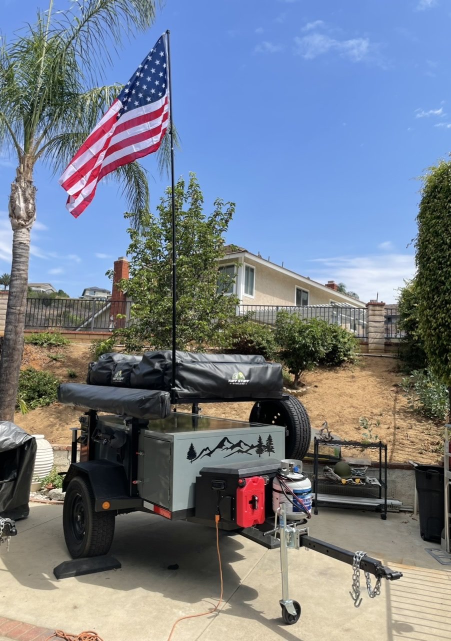

    Small thing but I welded up a flag bracket to my camping trailer. :oldglory:

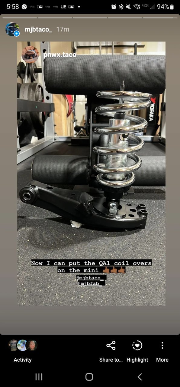

    PERFORMANCE Custom Turbo Setup FRONT SUSPENSION Drop Spindles by Aaron Carswell 01-04 Swaybar Endlinks Energy Suspension Endlink Bushings Cando Upper Control arms QA1 coilovers with 8" spring Custom 4 pot Brembo BBK Modified lower control arms with mjbfab qa1 mounting plates and Poly bushing sleeves REAR SUSPENSION Chasis Tech drop leafs QA1 adjustable shocks weld in drop notch Gas tank cross member bridge 3" angled blocks 2013 Double Cab Short Bed TRD Sport Eibach Pro Truck Shocks front and rear Lifted to the 3rd setting on the front shocks
    For fun
    Customer liked the arms

    Exactly 97.3% of "intermittent popping" issues can be solved with adjustments to technique, specifically travel speed (either speed across the joint, speed of your pattern, or both) or with an adjustment to CTWD (Contact Tip to Work Distance, or Electrical Stickout).
    From what I see, your pattern is spaced out too far laterally which tells me you are running at the bleeding edge of travel speed, so even a slight increase in pattern or travel speed outruns the arc and causes popping, which is easy to do with short circuit GMAW.
    Slow down on your travel speed, both overall and the speed of your pattern, and I am willing to bet your issues resolve.

    feels like a feeding issue. I’ve talked to my local air gas and they say it could need a new gun and cable but that’s some serious money and it rarely does it.
    Could be dirty wire. Spool is pretty old.
    Millermatic 215. I don’t use the auto set though. Can’t stand it and seems to always pop on auto set.
    wire feed is constant. I turn off the auto set. I can’t stand it and feel the wire speed is to fast.
    power is coming from a 40 amp diesel generator (house is off grid so only solar, batteries and generator for power) so power is constant and the same.

    Thanks I’ll try slow down some. I’m betting it was dirty material though. That was the first weld on the bracket and after that one it welded fine with no issues and lauded down beads I’m used to seeing without any issue.

    Yep that’s been my guess for a while now after talking to air gas. Maybe I’ll rider it and change it when I finish this spool. It’s so intermittent and only does it every couple times I use the welder it’s hard to dive into.
