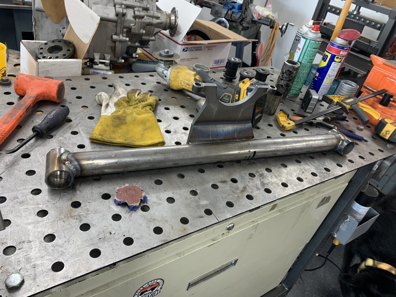

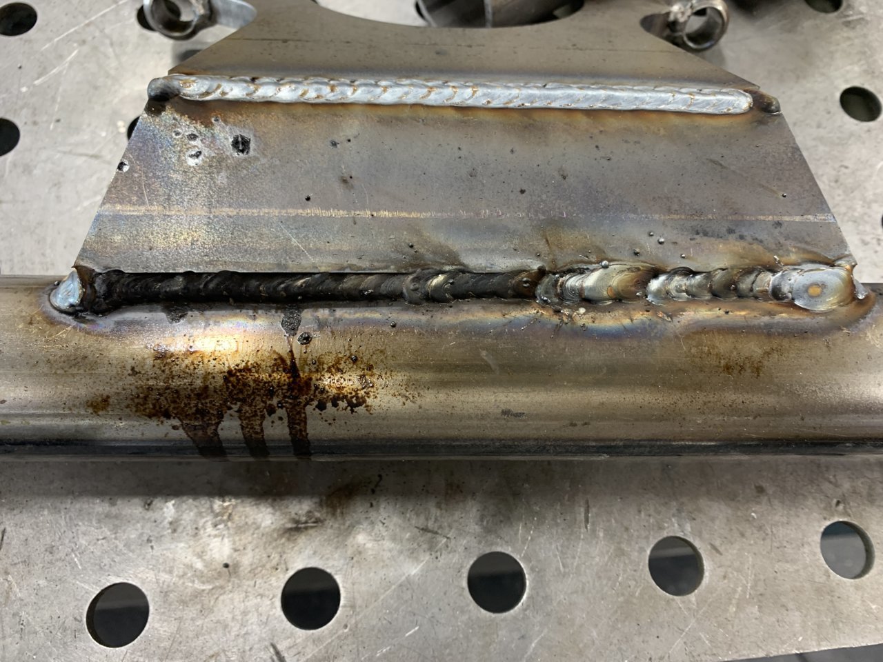

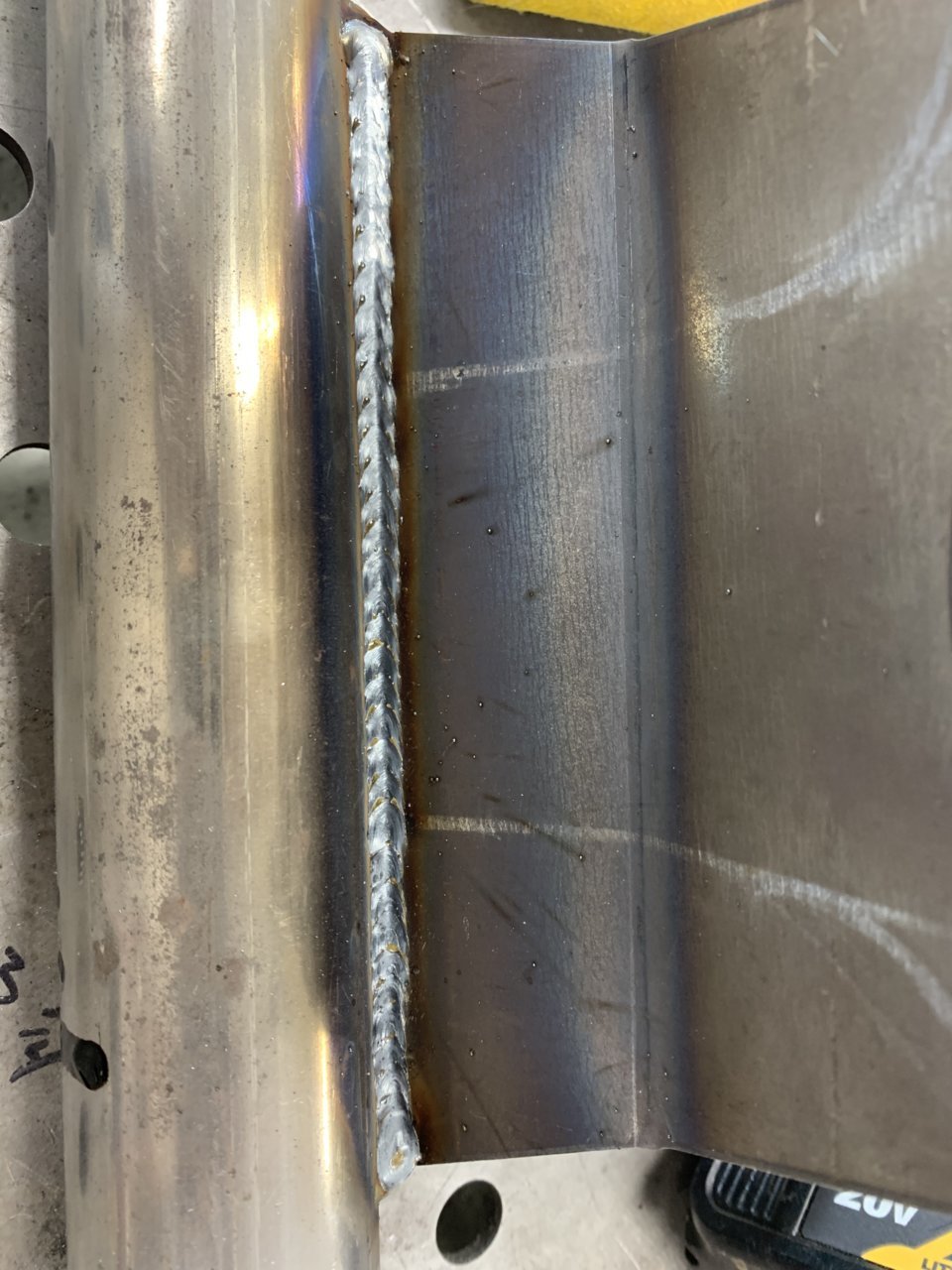

    I’m talking the actual material. The tube and plate make a deep joint there, ie the weld not filling entire void and think from all the grinding etc there was dirt or grinding dust in the joint contaminating the weld. 9/10 when it does it, I see rust or dirt or paint next to the weld.
    Air gas was saying more than likely the liner than the gun but that they see if you coil the liner and gun when storing or pull on it to much, it causes issues and number one issue is popping while welding.
    I feel the other welds I showed came out close to perfect with a good heat ring considering the plate is 3/8 and tube is 1/8.
    not knocking your experience was just showing that mot all welds come out Instagram perfect.
