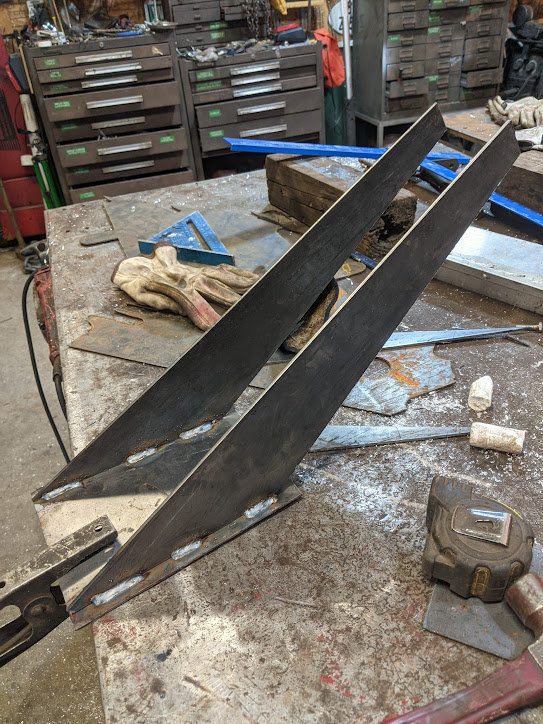

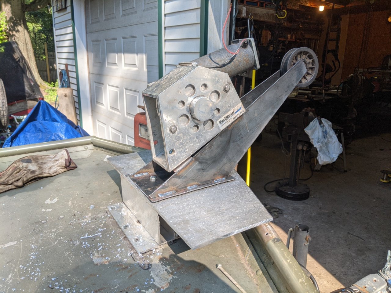

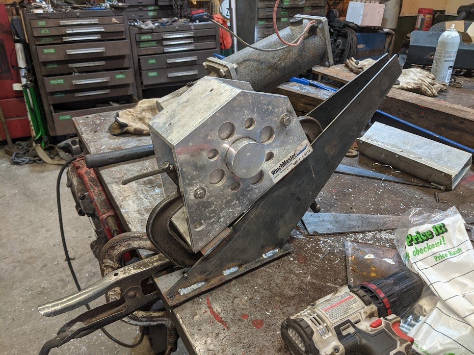

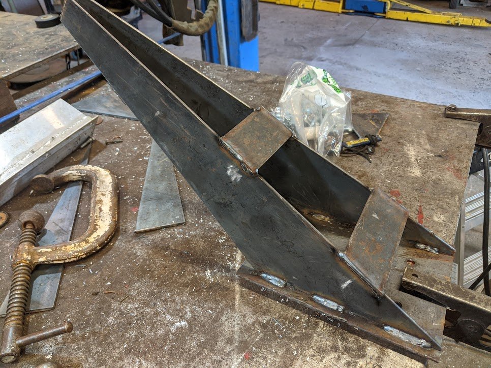

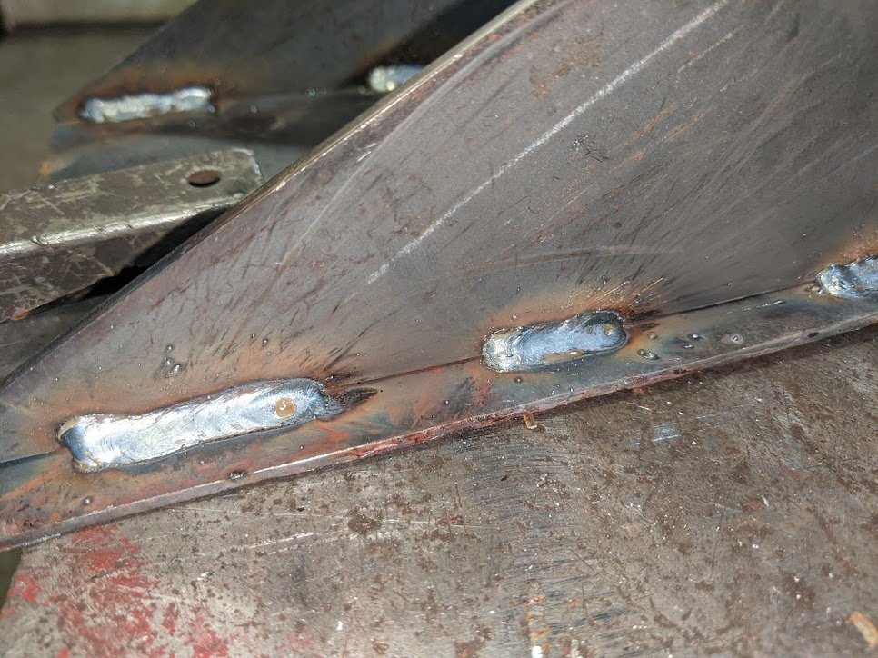

    Reserected from the dead.
    Decided to revamp the anchor winch for my boat.
    Previously I had a Minnkota unit for pulling the anchor. They are rally only good for 25 pounds of anchor.
    Here in Michigan, we need an anchor winch that can handle 50-100 pounds of weight. Most electric winches don't have the nuts to do this.
    The power pack is a semi truck tarp retractor motor and worm gear. Very heavy duty.
    This style of anchor winch is custom made here in the state, and they start out at around $900 adding the custom built gantry adds another 5 bills.
    31xZheOKrgKsPE1J1yqc3TmWtCxHaVjrv6_yLT_u_f972bf603df9641e8ed49e53d42a0efaa968890a.jpg
    zBu2kOz3jBOSdBclJyOsdW0q18zhdB3RrfglVAuk_6e158d1db3cca4528067e2a98cabd42acfea3d31.jpg
    mm9xtybQxMCdagl-D_dA4NhThHFh-Lcoe34EONEv_aef97270f714f69b357eac4b78030a0b7698aacc.jpg
    5S4Gg8rO6k-RUhxNUbTFjJME5BV2VOEpIwafq3aM_01ce3db171845a05871fecf09b30496e81a6be0f.jpg
    I still need to source a pulley. I just stuck an old lawn mower deck pulley on for demonstration.

    Looks good. Is your boat deck strong enough to handle the forces that'll be applied with that long arm with heavy pitching of a wave/wake?

    Heh. Now I see the scale of the boat and that it's already attached to a heavy platform. : ) Need more coffee I guess as I didn't see the 3rd pic before.

    In addition there is a 1/4" plate under the deck being used as a backer. The force is really spread out.

    Nice job ! Where do you find the Winch?
    The good old days when you pulled the tarp by hand then the hand cranks now electric winch.
    I could see it would save wear and tear on your body .

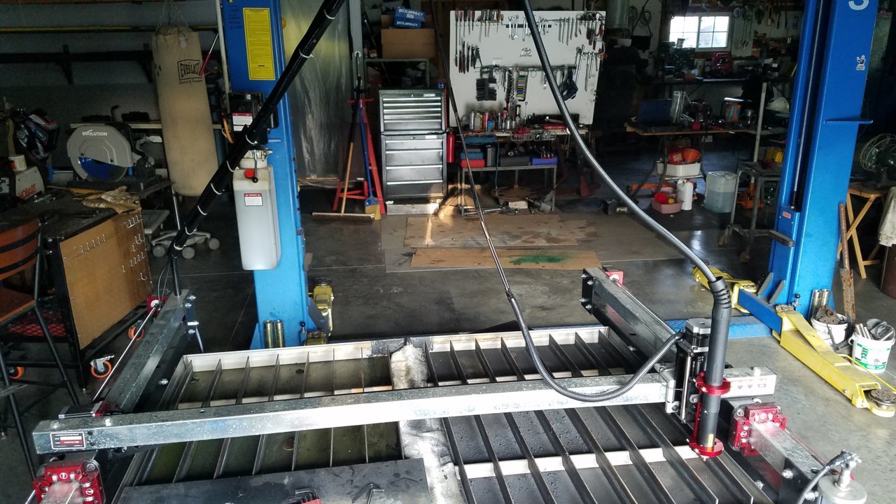

    @koditten
    FINALLY!, Primeweld got the TECMO PTM60 machine torch back in stock. It's the Italian version, versus the Chinese. $299.
    I haven't had a chance to fire it yet. Wednesday (day off) will be first trial.
    Gonna be nice to not worry about having a 90 degree angle to cutting surface, and also having my hand torch free for non-CNC related cuts.

    Awesome!
    I had to take a second look! I thought I was looking at a pic of my own shop!
    I have a similar lift. My table gets a new location every time I use it.

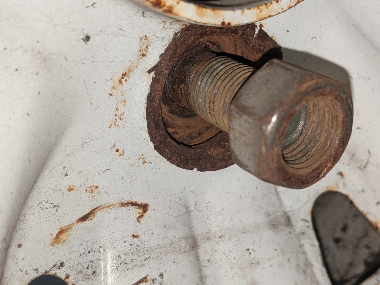

    One of my project zero turn mowers showed up with holes wallered out.
    $165 and no guarantee it was the correct wheel.
    No saving this wheel, but...
    TBC...
