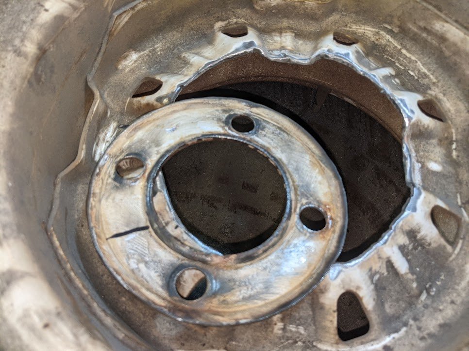

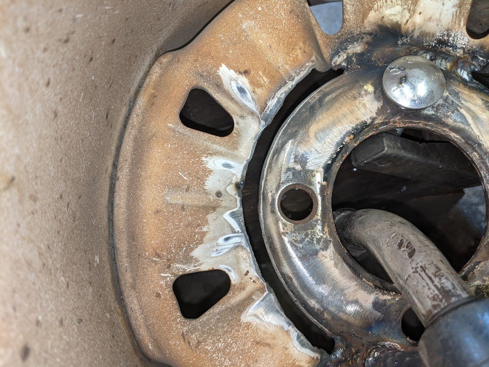

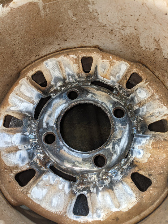

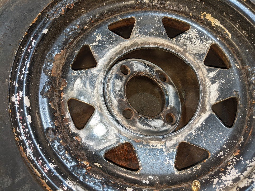

    I had this old Harbor Freight wheel laying around. Oddly enough it is the same bolt pattern.
    JEfQig0rb4J_Rc8nucx4lGgCMzImxNfWidQb2tAR_a1ff5b5fe705727670c000af15f906ffb1677c80.jpg
    I cut out the center, using the existing weld valley as a guide for the plasma cutter.
    nAw1b4kKzui5DF_divH2wLzQMfdP0R3z6yQaK8pB_21bf42699a7959d5a3382cb11c4fdcd7d16c809c.jpg
    I cleaned up the new wheel center and bolted it to the bad wheel center. I just eyeballed it the best I could. Using the new wheel center as a circle template.
    Turned out fairly decent.
    l4oI9uudkUL_FyUVDtEuDfbSCT3U4Z13WFd7vprm_009326b56d0e397cfa82614eb9fe4877356466f5.jpg
    I did have some fairy large gaps. As the old timers say "If I can step across it, I can bridge it!"
    9pdCuCMXo0ifevpve-gzBGnVZxIQGi8Zd3aJwDLX_50ea59116695ef96d941acec28aa0058cab5130f.jpg
    She ain't the prettiest, but it's solid.
    vP8qfOGk96bnM7yOZHK1jBSZg7T2HPvbJc2h_fe3_c575e4897c833ba2e0ede9020f5ff8a5926c5603.jpg

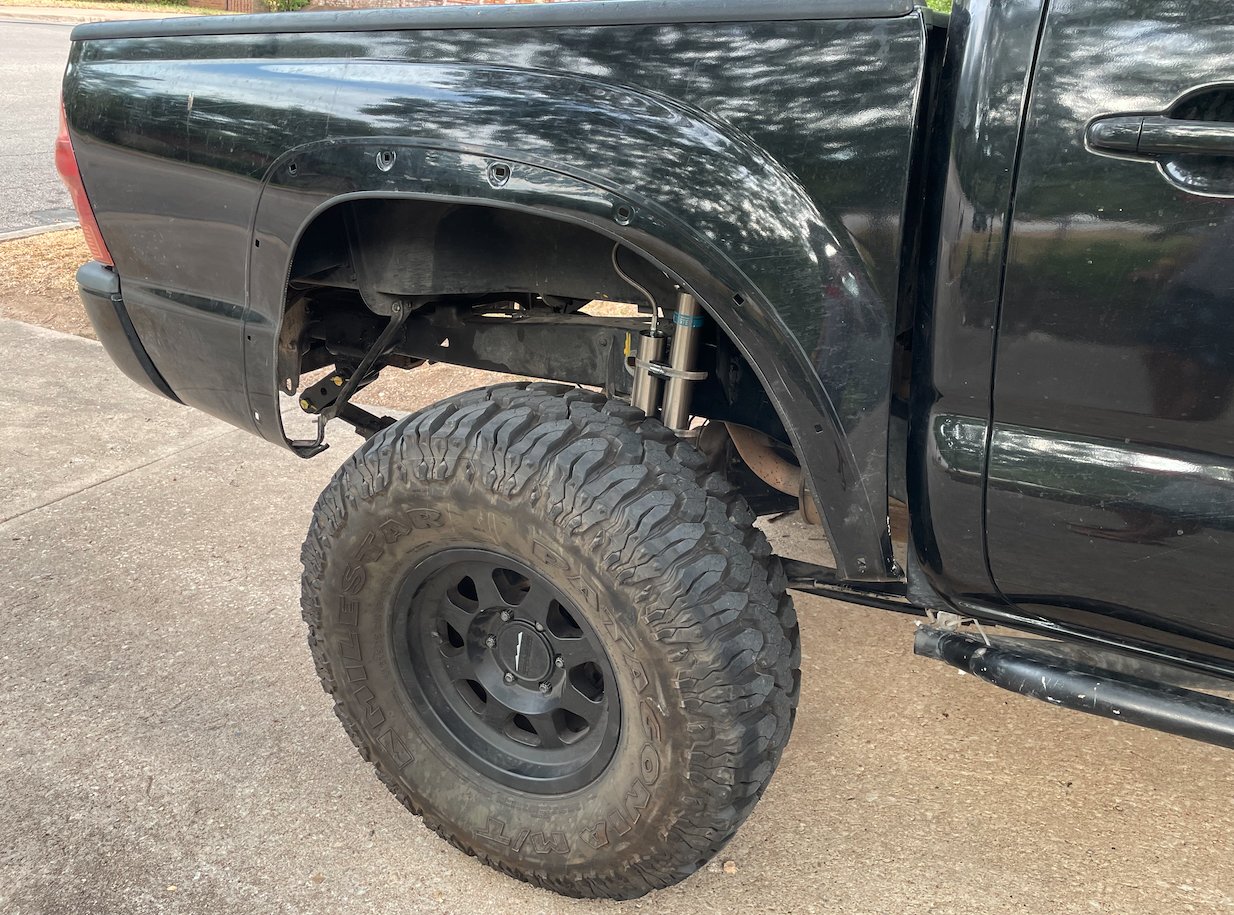

    I finally finished the 63 swap with the shock relocation with new shock towers (thanks BAMF) and axle tabs. I'd have paid a good amount for a plasma cutter getting the old mounts and tabs off. it's not going anywhere and rides great.
    I can't wait to flex it on some rocks.

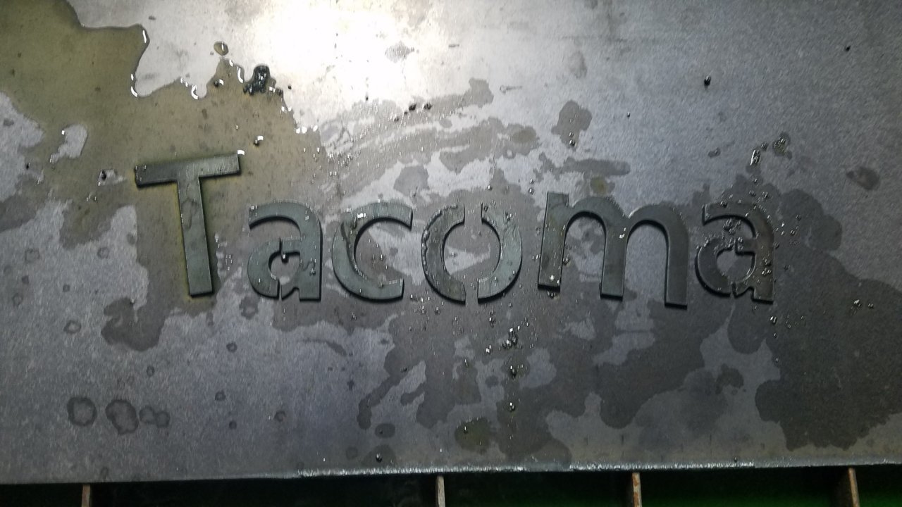

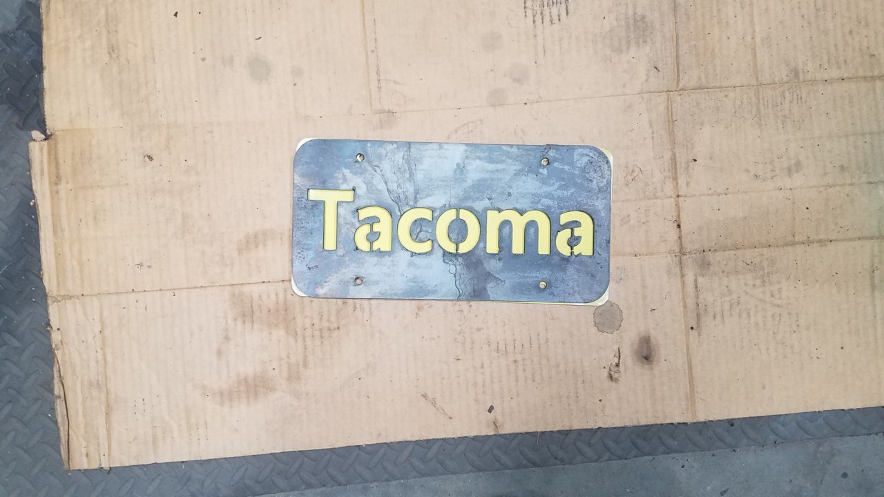

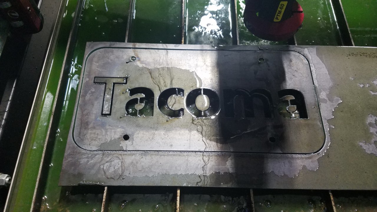

    Friend of mine bought his wife a Taco recently. He asked if I could make her a front plate. It has a few flaws I need to correct, and I may add her name, but looks pretty good.
    16 gauge, 30 amps, 2800mm/sec, 50psi.
    The cutouts attached to an old license plate would be cool too:

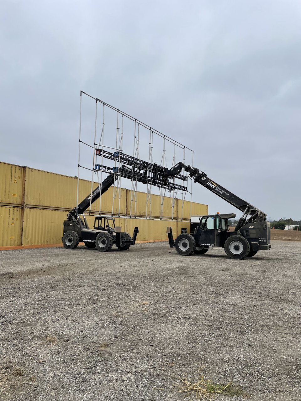

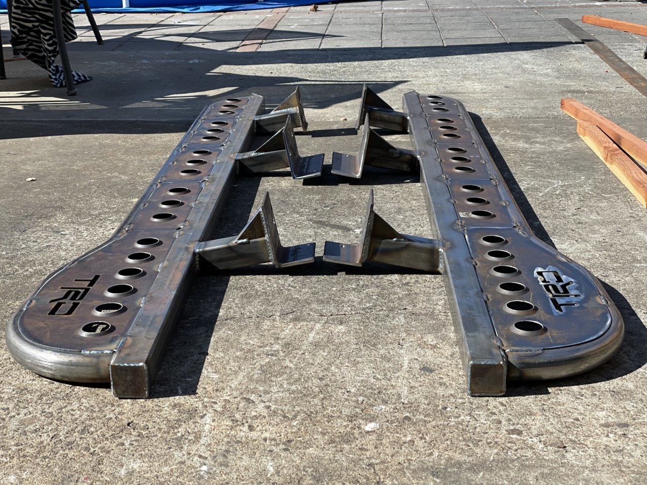

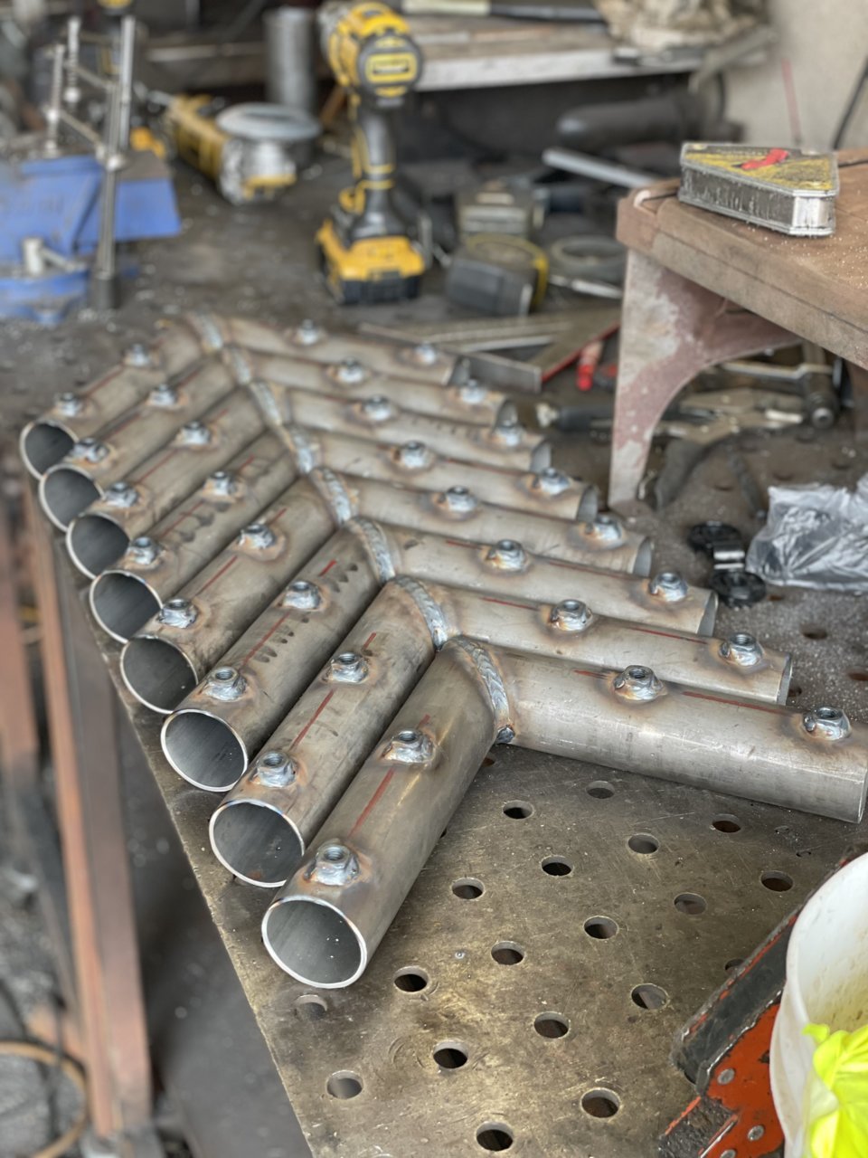

    90 degree Corner pipe fittings, another bracket to build a large frame off of a Gradall, and some more sliders. Last 2 pictures are what the bracket allows us to build off of a Gradall

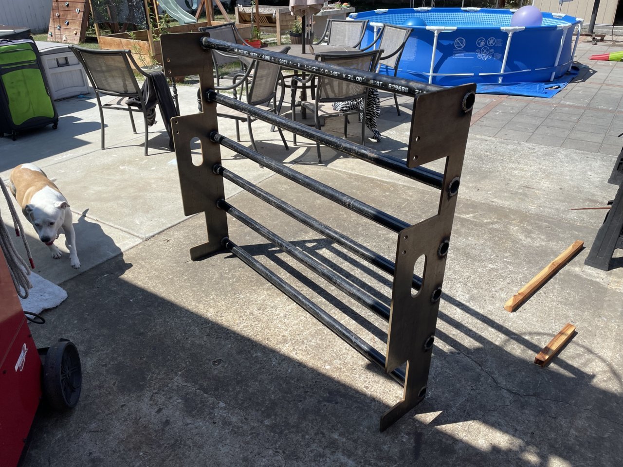

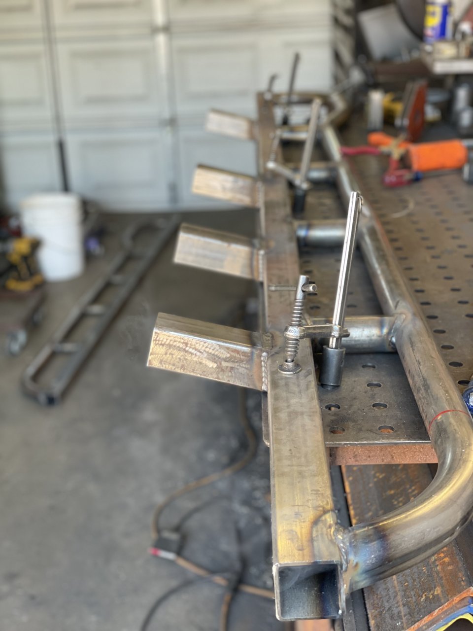

    Some of the stuff I made today -
