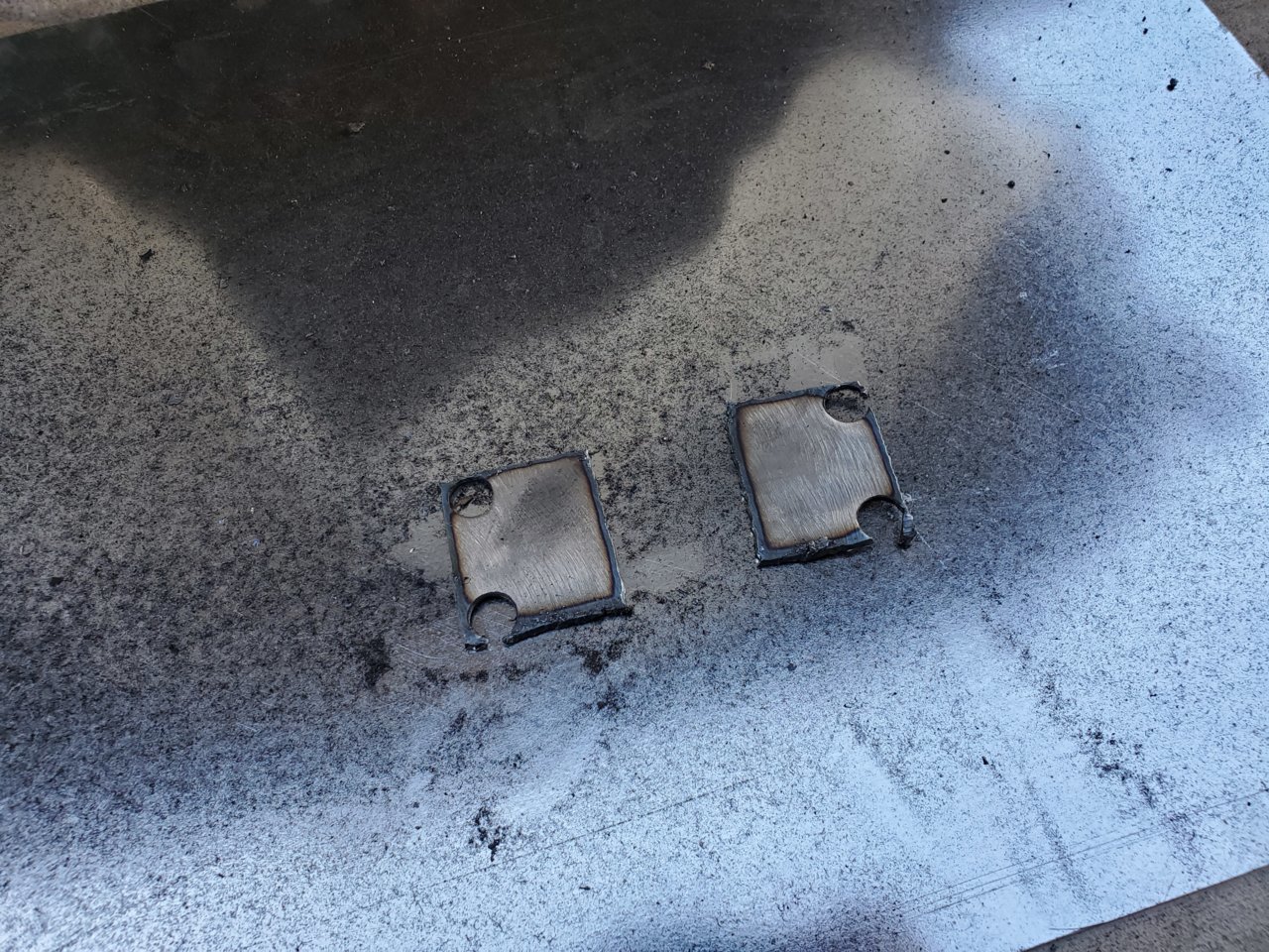

    I was wondering "why didn't this piece just fall out?"
    It's double stacked

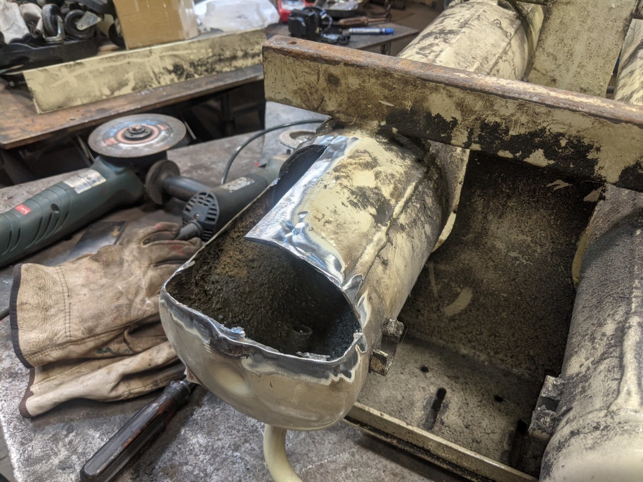

    I know what you're talking about as I had to do that on the shield of a catalytic converter and it was thin as hell; was on my transformer-based machine running .035 wire at work. Sheet metal for sure.

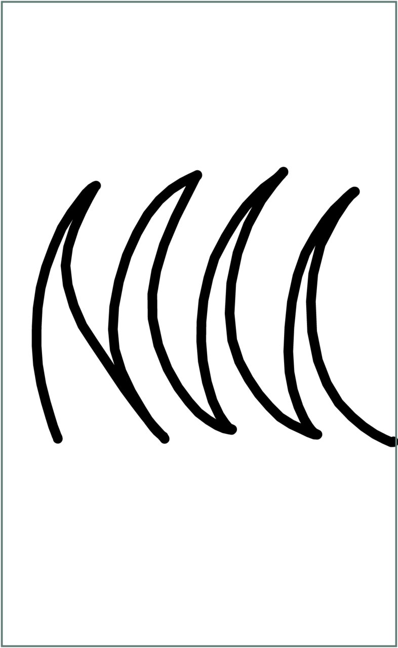

    paint_and_drawing_fun_file_2022-08-28-052837.jpgthis is how im most proficient

    Every welder is different.
    Only time I used a weave like that is when I've had to fill a gap going uphill, basically a root weld between beveled edges.
    Going in such a motion allows weld to fill as you move up the metal.

    Things change since I was in school in the early seventies.
    Weave beads like that were discouraged .
    One instructor loved his triangle pattern in vertical up .
    Some many things come into play depending on the job big difference between 16 gauge and 1/2"

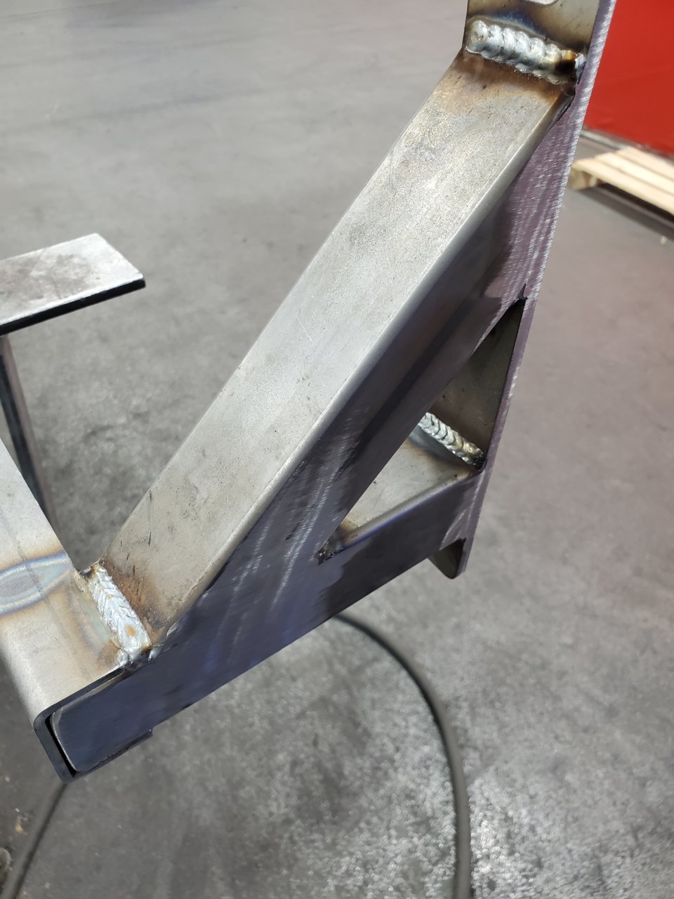

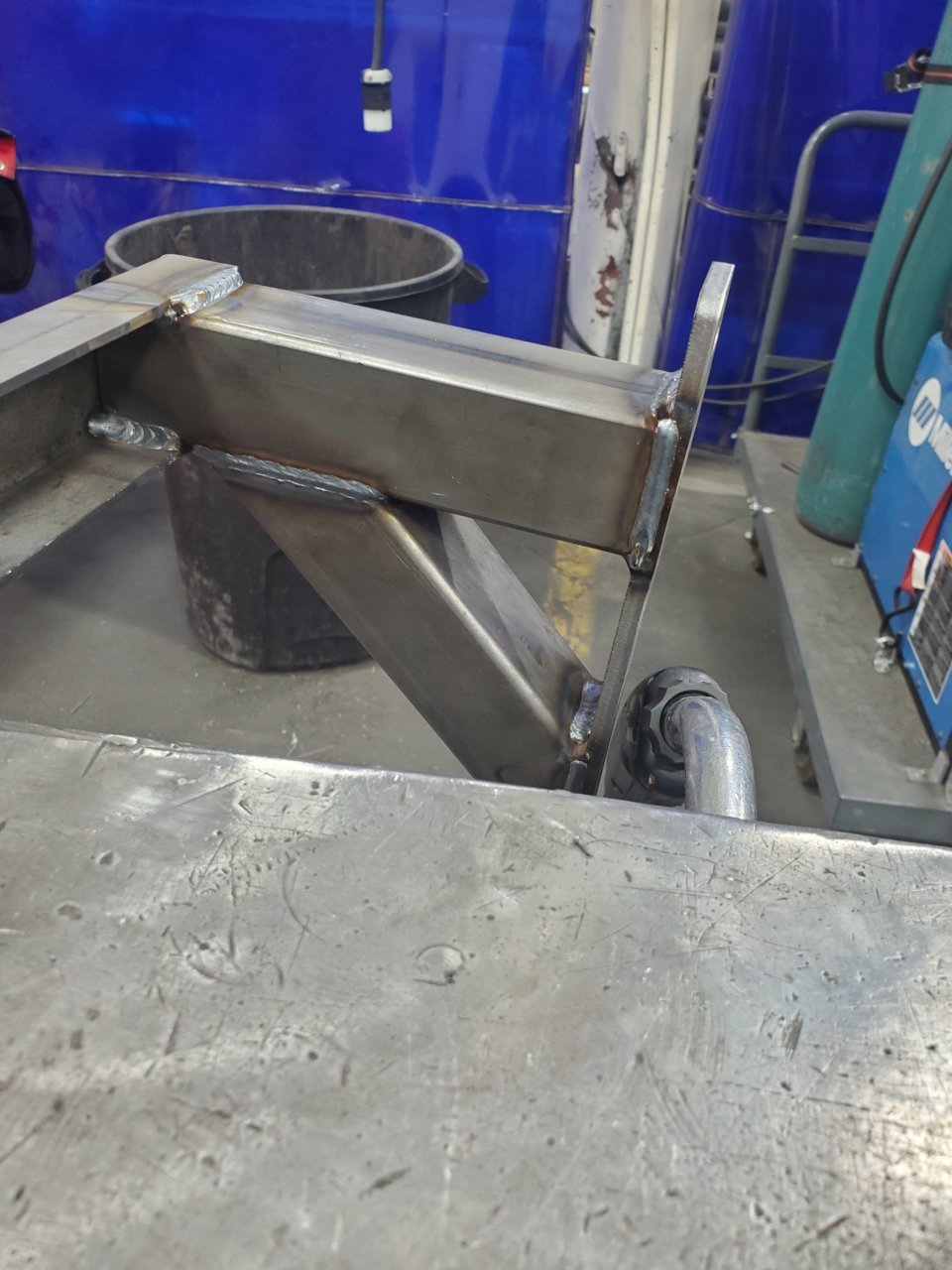

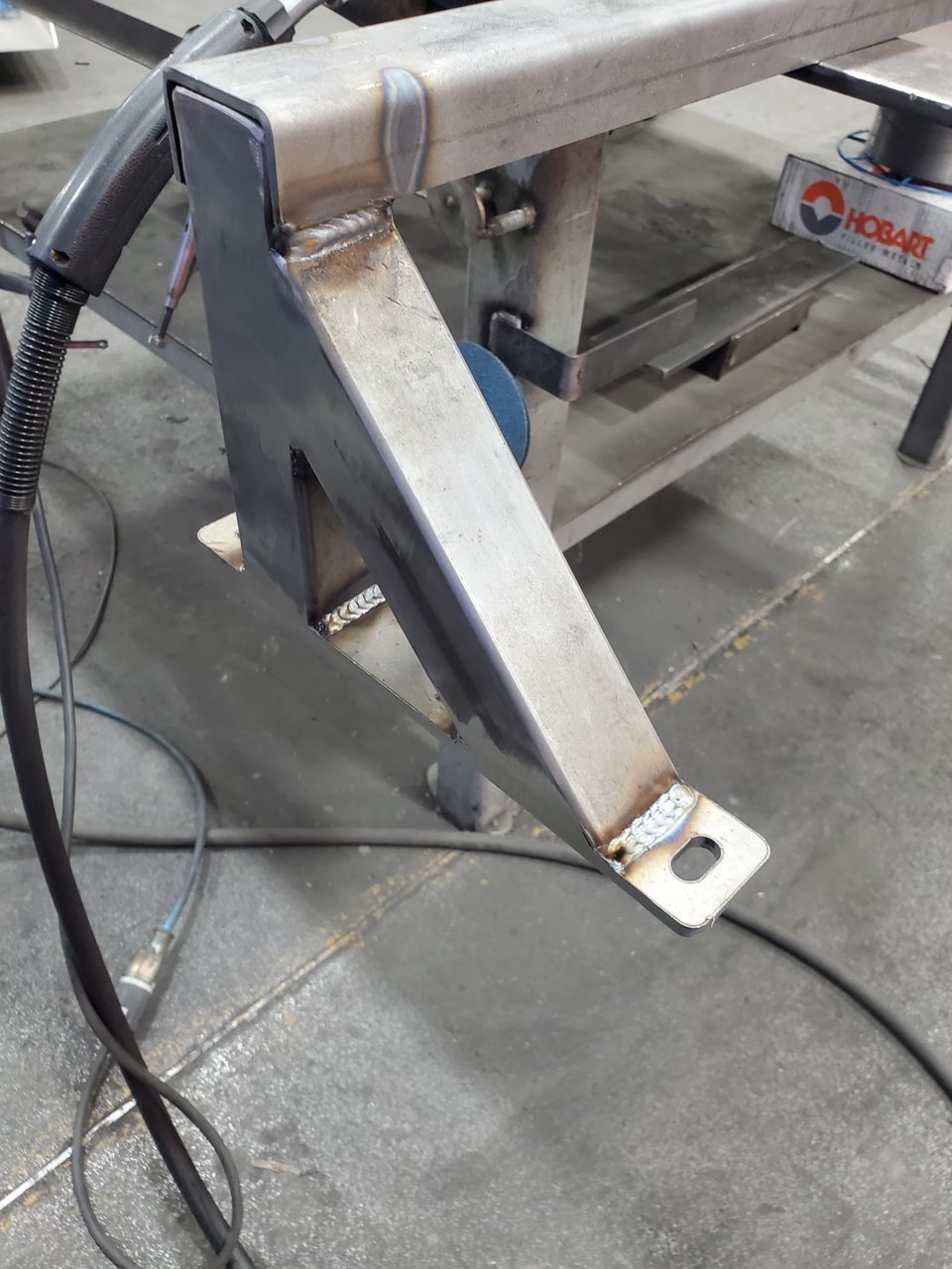

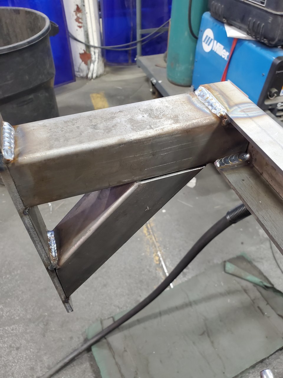

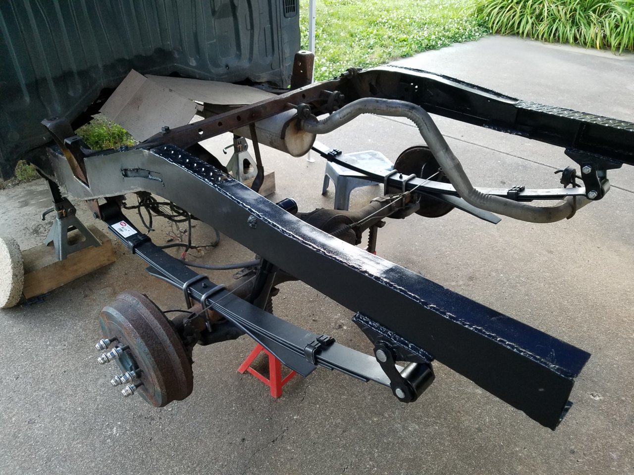

    Just got done welding these supports up about half hour ago.
    You'll see that I ran some stringers cause the square tubing is thinner than the bracket or c channel it's welded to.
    Vmax88, koditten, 308savage and 2 others like this.
