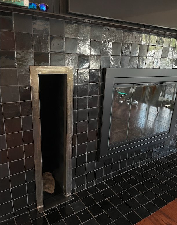

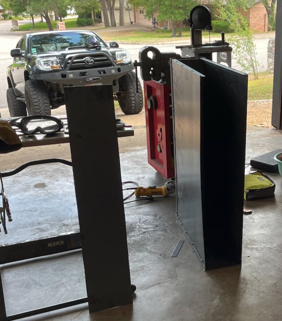

    Test fitting a fireplace nook I put together over the weekend. It goes back about 20" into the wall to hold a few logs. I created a box for the inner shell lined with 22g sheet metal framed with some angle iron welded into a cube with an open front. Definitely overkill but a great way to practice.
    The outer casing is 2" angle iron with cut flat bar casing the top and bottom. Test fit below. I'm going to put some blue on it to match the mantle (4.5" angle iron 3/8" thick) and tack the casing to the inner frame.
    ... tacking the box together before sealing with welds ...

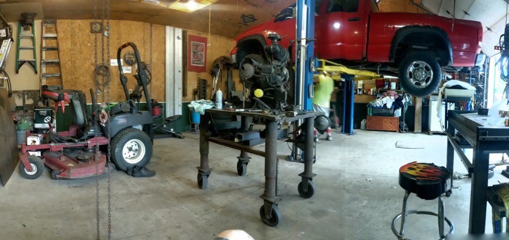

    Here you go.

    Oh man, look at all that freaking room AND LIFT :drool:

    My 4 x 8 lift table is in the drive in this pic. It's inside now, so there is another 32 sq ft eaten up.

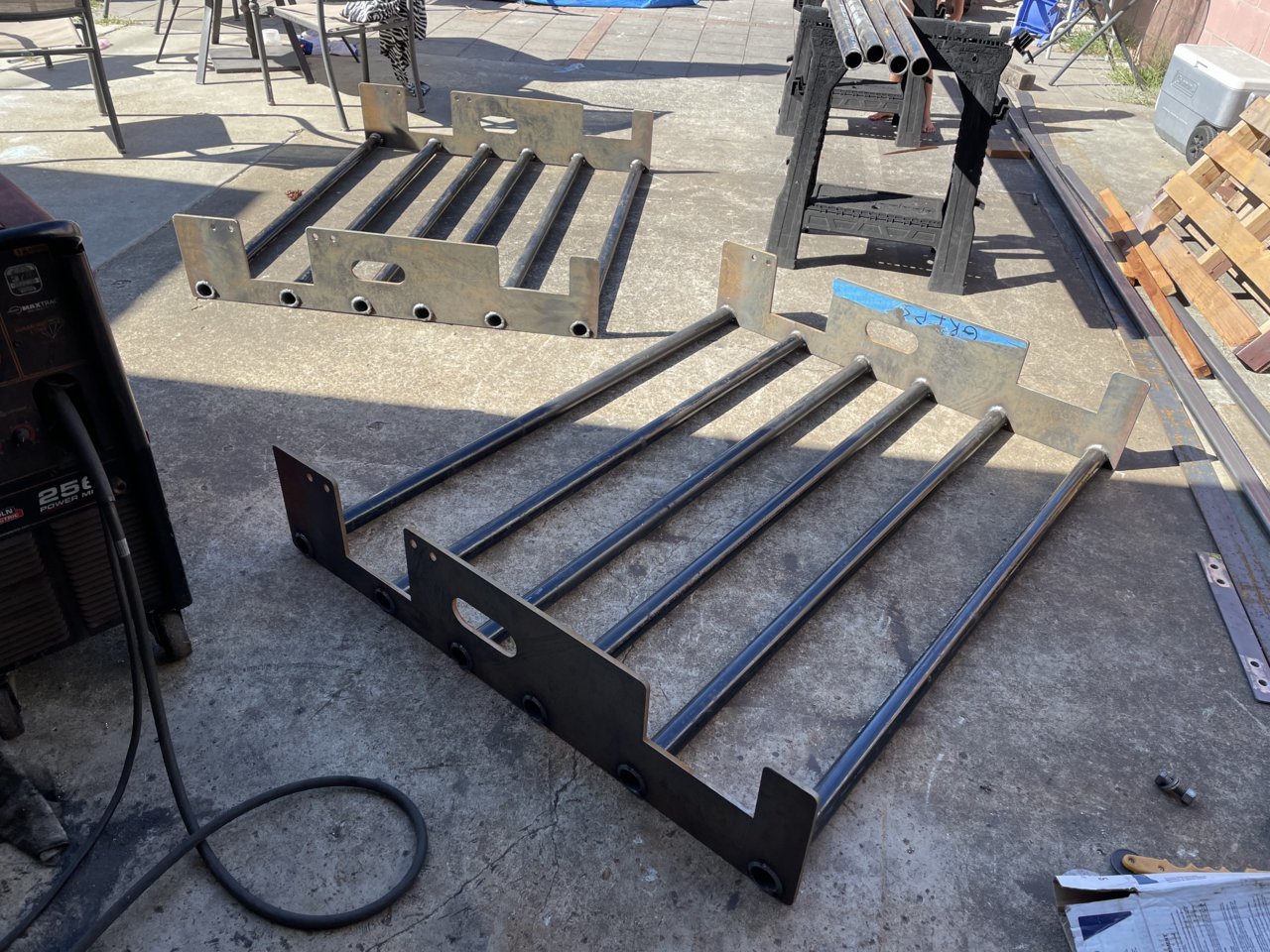

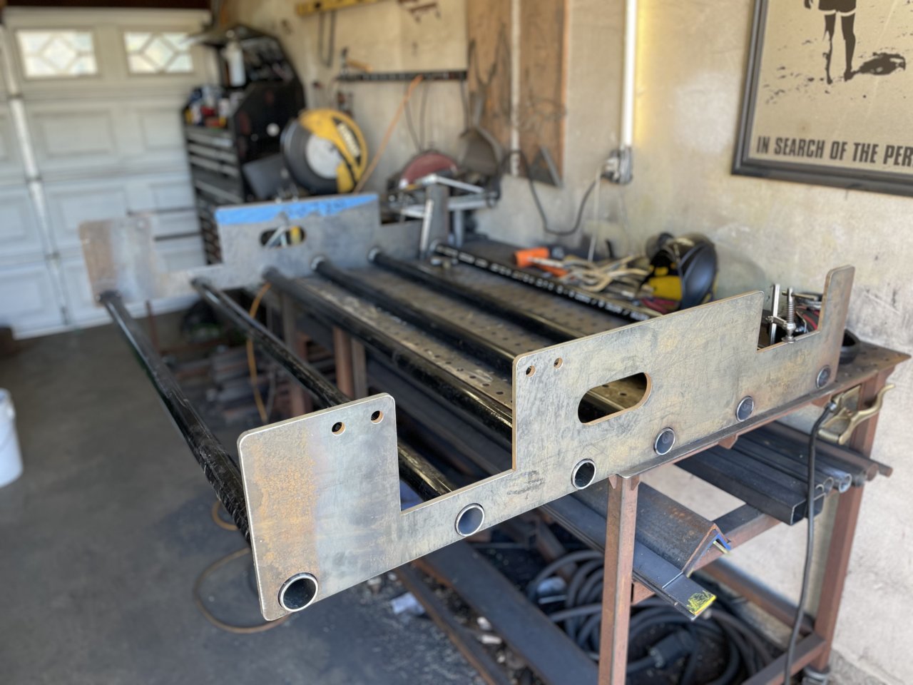

    Made 3 more of these Gradall frame brackets

    When you say GradeAll, I think road graders.
    These are for telescoping boom fork lifts, yes?
    Some call them Reach Fork lifts.
    Are we on the same page?

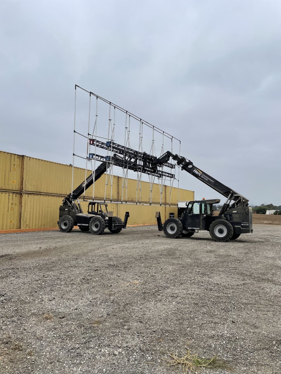

    Gradall is a brand in the construction industry known for their reach fork lifts. Kinda like Ziplock for zip close bags. So that’s why I was calling it a Gradall on here.
    Here in our industry we call them Petty Bones (don’t ask me why lol). So we call these brackets “Petty Bone brackets”
    We use mostly JLG lifts. These brackets allow us to build these frames off of the mast where the forks usually go

    Pettibone is or was another manufacture of the same type lifting equipment
