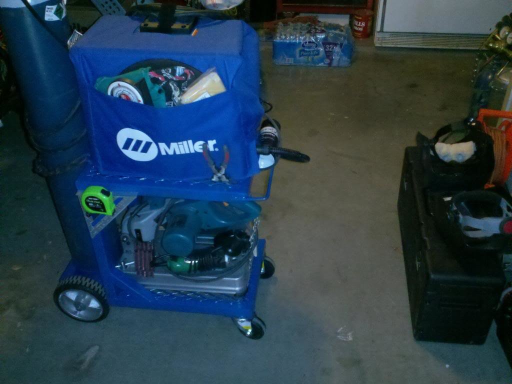

    #74688
    8,305
    Your Mom
    Tempe, Arizona
    05 5 lug minitrucker
    4.5/5.5 drop, DJM arms, QA1 coilovers, 6lug leafs, QA1 18-way, rear swaybar, Batwing Big brakes, high flow cat, indy/hurst shifter, memphis amps, focal 3-ways, Eclipse AV unit, SunDown 10" custom box, TRD bucket swap.
    yeah, maybe, nooooo maybe yeah
  3. Jan 20, 2014 at 10:16 PM
    #2323
    Yotamac
    Yotamac Well-Known Member Vendor
    Mar 30, 2013
    #100909
    1,338
    Ze
    562- Cerritos, CA
    07 PreRunner
    Stuff, stuff and more stuff
    Its a good little cart. Does the job and keeps things in order. Only one thing... since the top shelf and welder are tipped back, it comes close to the bottle behind it. Other than that you cant go wrong for $40.00
  4. Jan 21, 2014 at 5:23 AM
    #2324
    4banger4x4
    4banger4x4 Probably should'nt have done that.
    Apr 24, 2012
    #77528
    2,540
    Eric
    Whorelando, Fl

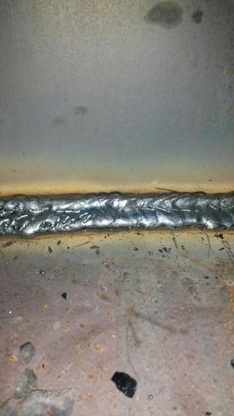

    Need some help guys. I was welding up some steel at work today using dual shield and 100% co2 and kept getting these lines in the puddle which sometimes turned into porosity. Any clue on what they are or why they happen? uploadfromtaptalk1390310612001.jpg
  5. Jan 21, 2014 at 5:48 AM
    #2325
    Phil Dammit
    Phil Dammit Well-Known Member
    Mar 11, 2012
    #74688
    8,305
    Your Mom
    Tempe, Arizona
    I was told it was crap I'm the tank. I would get porosity like that occasionally as well. What is your gas set at?
  6. Jan 21, 2014 at 7:31 AM
    #2326
    4banger4x4
    Apr 24, 2012
    #77528
    2,540
    Eric
    Whorelando, Fl
    30 cfm. I was doing some over head also thats why it was that high. But I was looking online and it was saying they are called gas marks from having to much hydrogen in the weld. Im not sure how old this spool is but im in florida and if the spools old enough im sure that its got plenty of moister in it causing the excess hydrogen
  7. Jan 21, 2014 at 7:32 AM
    #2327
    Phil Dammit
    Mar 11, 2012
    #74688
    8,305
    Your Mom
    Tempe, Arizona
    Yes, that can cause it as well. Especially in that state.
  8. Jan 21, 2014 at 9:40 AM
    #2328
    ian408
    ian408 Well-Known Member
    Nov 8, 2009
    #25619
    19,654
    Ian
    Santa Clara, CA
    09 Tacoma
    Could be a few things. As you mentioned, moisture-humidity is a likely cause but condensate in the tank (not likely) or maybe rust on the weld surface, or moisture in the wire (I would think this is unlikely after a few feet of wire feed). High voltage can cause the introduction of nitrogen through the arc too. Or short stick-out.
    I would guess that a combination of things are causing your problem. Maybe the weld position and rust on the weld surface.
  9. Jan 21, 2014 at 2:31 PM
    #2329
    4banger4x4
    Apr 24, 2012
    #77528
    2,540
    Eric
    Whorelando, Fl
    i cleaned the surface, it was rusty prior to cleaning tough. i dont think it has anything to do with the tank because if i use solid wire it runs fine. I was up at 29v and 400ipm but when i was doing some welding a month or so ago i was getting the same issue and that was on perfectly clean steel and running about 23-24v. granted it wasnt nearly as bad as this time but it was still an issue. and i asked about the wire today and apparently its been around for over a year.
  10. Jan 21, 2014 at 7:22 PM
    #2330
    4banger4x4
    Apr 24, 2012
    #77528
    2,540
    Eric
    Whorelando, Fl
    Welding symbols are super fun. Expecially when you get to a company that doesnt even know what the AWS is
  11. Jan 21, 2014 at 7:37 PM
    #2331
    Welder
    Welder Active Member
    Dec 15, 2013
    #118638
    25
    Cape Breton
    2010 Tacoma TRD Sport
    SRI
    I am doing welding inspection modules too. If you get stuck on something, let me know and i'll try to help you out. Sometimes symbols can be a real pain in the d*ck
  12. Jan 22, 2014 at 6:25 AM
    #2332
    Phil Dammit
    Mar 11, 2012
    #74688
    8,305
    Your Mom
    Tempe, Arizona
    WELCOME TO MY LIFE. From the field to behind the computer doing shop drawings, I couldn ask my owner one symbol question as he would fail :facepalm:
    Once you grasp an understanding of the weld types it will be cake
    There you go, team work
  13. Jan 22, 2014 at 8:30 AM
    #2333
    SMKYTXN
    SMKYTXN If it can't be overdone it's not worth doing Vendor
    Mar 11, 2011
    #52810
    14,040
    Nathan
    Houston
    11, 4dr, TRD Sport, 6sp
    DCFB
    What's the question Kase?
  14. Jan 22, 2014 at 8:48 AM
    #2334
    achirdo
    achirdo I Weld!
    Apr 7, 2010
    #34819
    10,264
    Adam
    North DFW
    06 dodge ram 3500 5.9 cummins
    Where did you say you were going to school? Lincoln Tech right?
  15. Jan 22, 2014 at 11:03 AM
    #2335
    Wishbone Runner
    Wishbone Runner Because 4R
    Sep 9, 2012
    #86546
    6,345
    James
    CO
    04 SR5 4Runner
    King/Dirt King
    Just picked up an extension of 220V 8/3 cord, and planned to hook up to the dryer, but brilliantly did not look at the dryer plug first. It is this one, and says 30A 125/250V:
    I have this head on the welder and cord:
    Is swapping the heads like this safe? I found many counts of people doing this, like this guy, and my setup is near identical, only drawing less current on the Miller 180, ~21A, and the outlet is rated to 30A.
    http://collierwelding.com/tech/weldercord/index.html
  16. Jan 22, 2014 at 11:05 AM
    #2336
    Phil Dammit
    Mar 11, 2012
    #74688
    8,305
    Your Mom
    Tempe, Arizona
    Shouldn be an issue. Your max draw is lower then the plug.
  17. Jan 22, 2014 at 11:11 AM
    #2337
    Wishbone Runner
    Sep 9, 2012
    #86546
    6,345
    James
    CO
    04 SR5 4Runner
    King/Dirt King
    Thanks, that's what I figured, just wanted to make sure I wasn't missing something. For the two hots does it matter which goes on which side, or are they interchangeable?
  18. Jan 22, 2014 at 11:19 AM
    #2338
    Phil Dammit
    Mar 11, 2012
    #74688
    8,305
    Your Mom
    Tempe, Arizona
    I do not believe so, but I am not a licensed electrician. That article you linked says it does not matter either, again I do not know if he is a electrician or not.
  19. Jan 22, 2014 at 11:23 AM
    #2339
    Wishbone Runner
    Sep 9, 2012
    #86546
    6,345
    James
    CO
    04 SR5 4Runner
    King/Dirt King
    Did some more research, and they are both hot at 120V, so they are interchangeable.
  20. Jan 22, 2014 at 12:43 PM
    #2340
    cdk
    cdk Well-Known Member
    May 22, 2012
    #79309
    347
    san angelo,tx
    2012 PreRunner TSS
    BruteForceFab rear bumper, Ranch Hand front grille guard w/ led lights, leds here and there, seat covers, dash cover, console and handle covers, weathertechs, upgraded audio system, bed mat
    a couple of my projects so far.

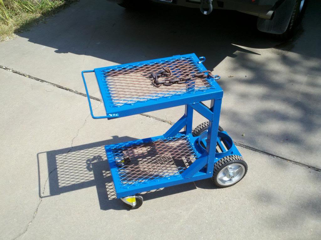

    welder cart. holds: welder, bottle, chop saw, speed square, tape measure, grinder, and some misc stuff in the cover.

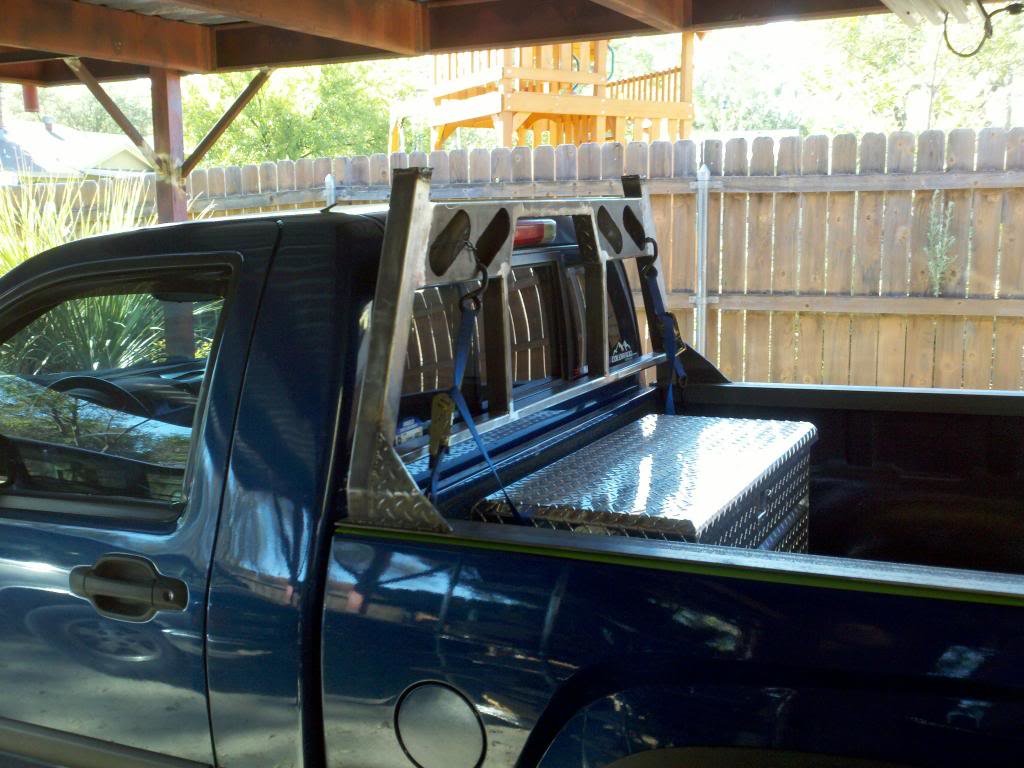

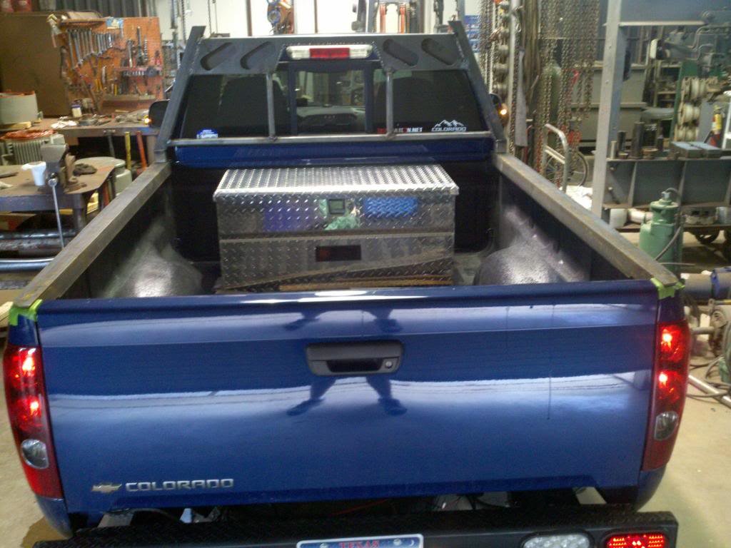

    headache rack for my colorado. did the bumper too, but don't have any pics on this pc.

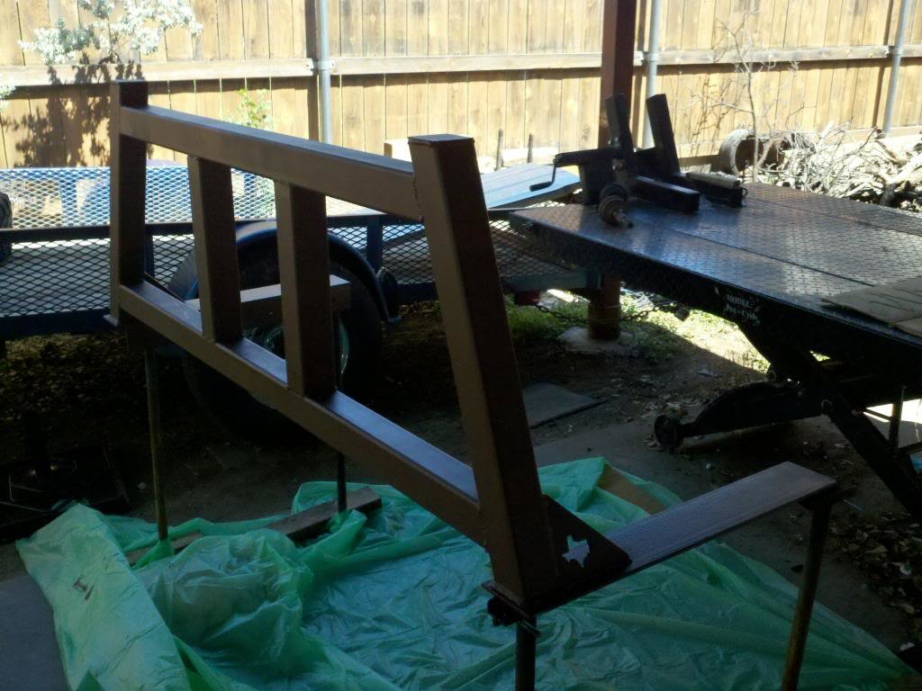

    headache rack for my tacoma. currently modifying it to add lights.
    texas gussets from relentless fabrication.
    cut the bottom of the top tube off, added 3'' strap and cut a piece of 2.5'' sq tube in 1/2 then assembled.
    haven't decided on 2 lights or 3 yet, but 3 will be a tight fit w/ the grommets.

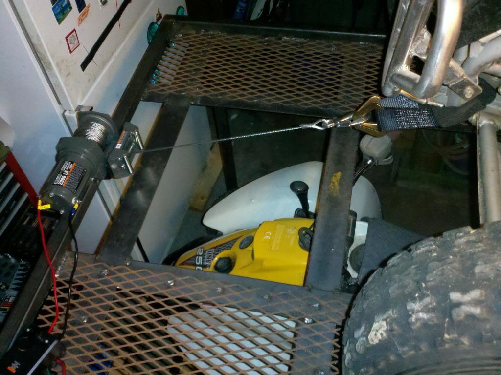

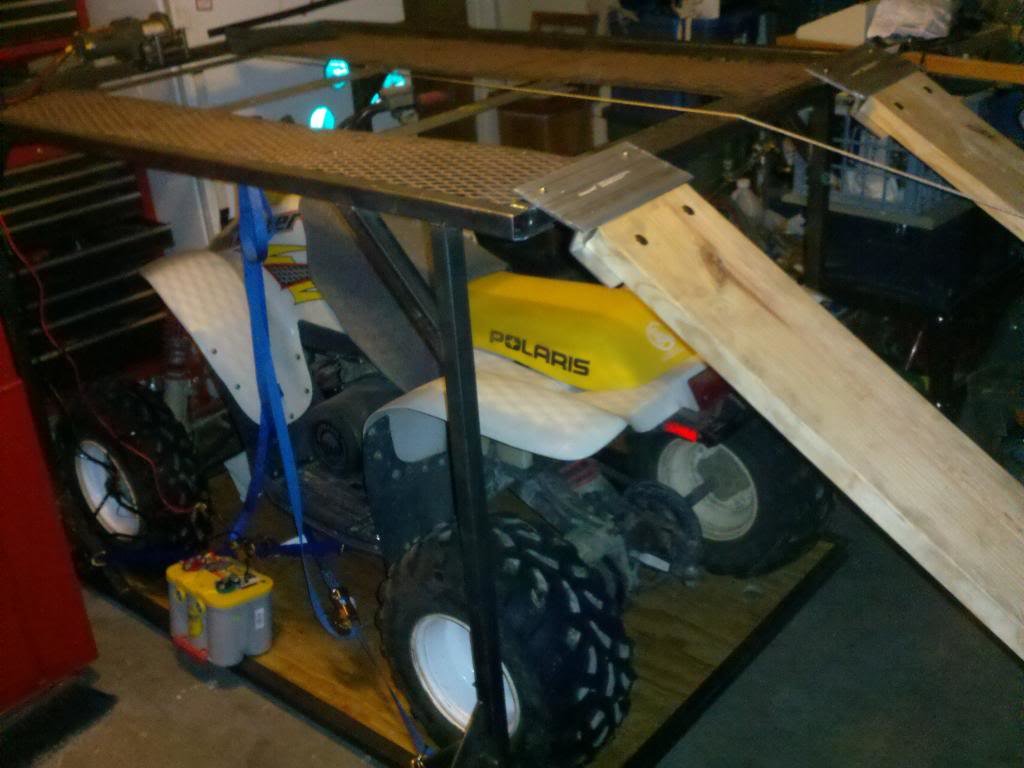

    movable storage rack for 2 atvs for garage w/ 8' ceiling.
    still need to weld on a roller for the winch line, and tidy up the wiring for the winch.
    top atv has the bars loosened and leaned back. ~3/4'' off the ground and ~3'' from the ceiling.
    used leftovers rather than go buy material for the wheel mounts. (gussets added after pic.)
