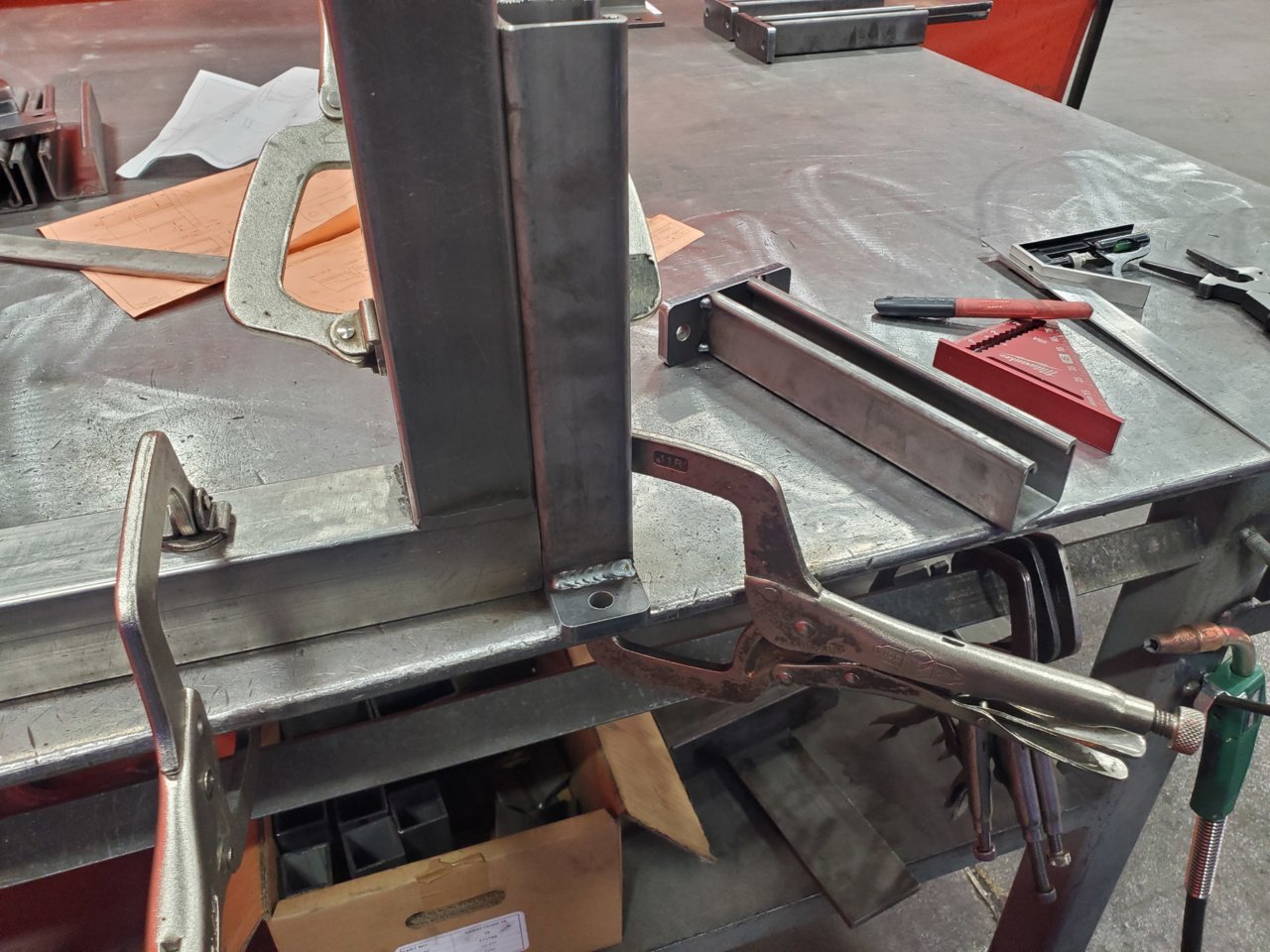

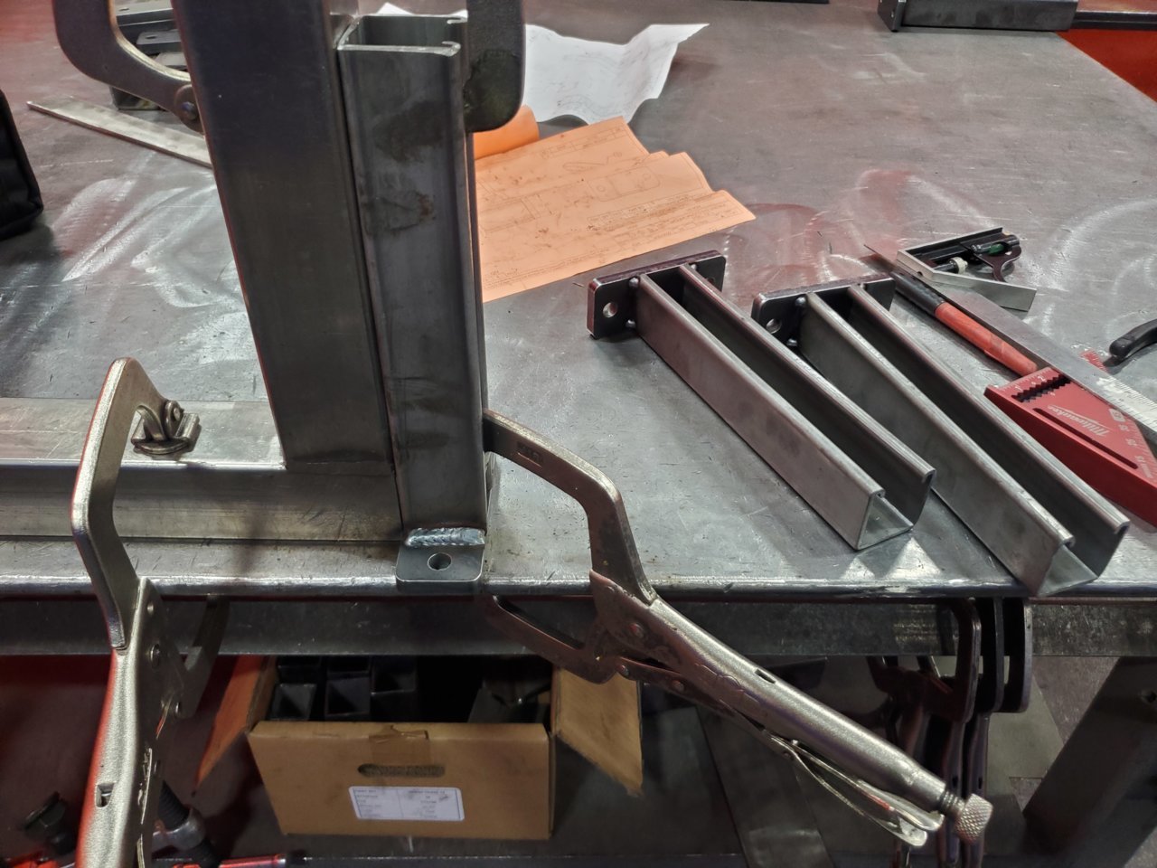

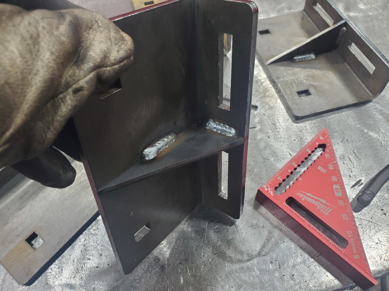

    When you tack something together, are you able to successfully run a bead over it making the tack unnoticeable?
    That could make your tie-in much less noticeable.
    Example, these get 4 tacks to keep it square before burning it in. Can't even see where it was tacked.

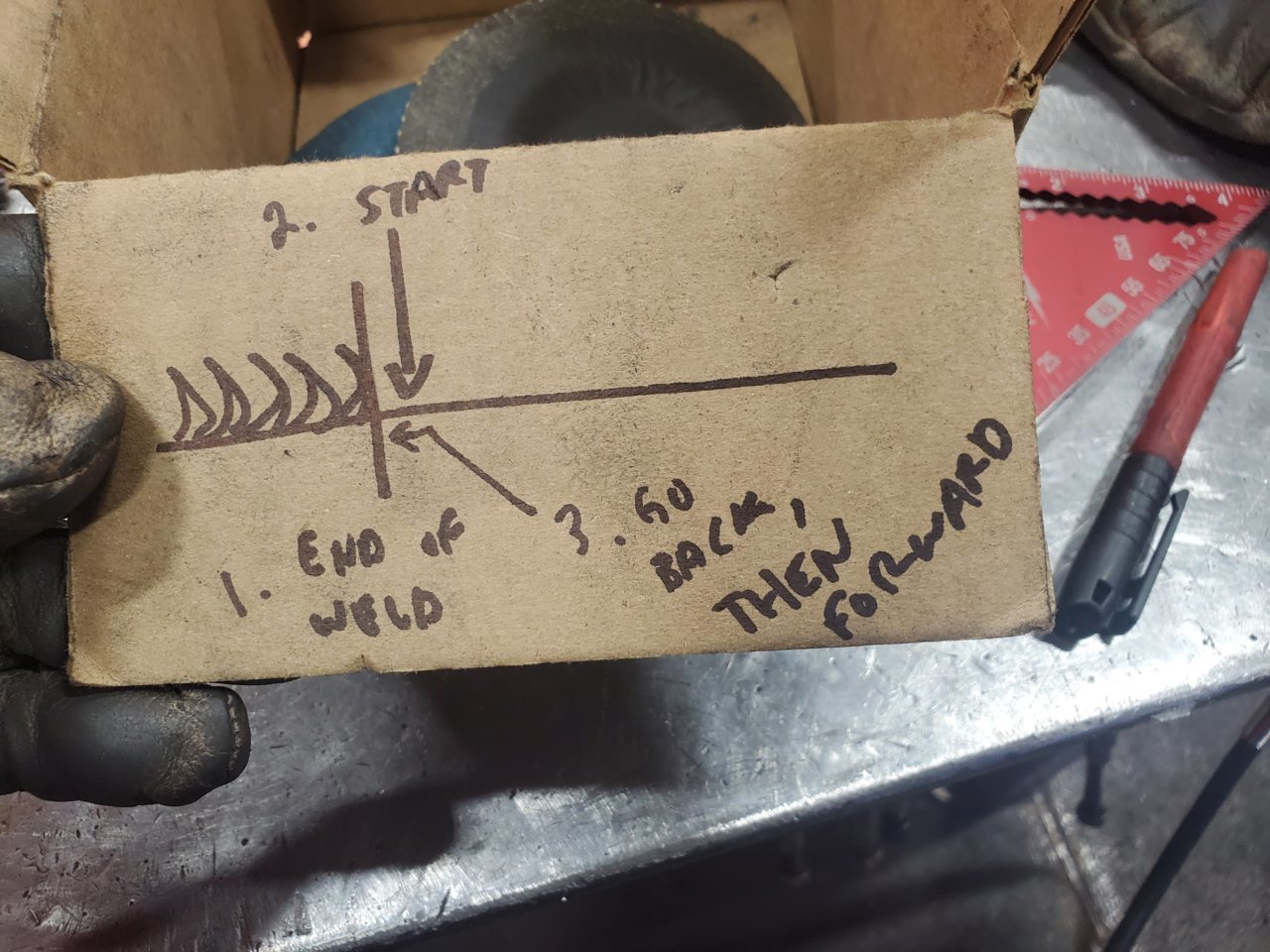

    1. Is where you finished your bead
    2. Is where you start welding again, ahead of the bead
    3. Is the first direction you go after you've started welding, tying into your initial weld and continuing with your second one
    As for distance, that kind of changes depending on heat and travel speed as everyone is different. But looking at my ruler, I personally start a little closer than 1/4" as it'll be too easy to build up a weld when you start up the second time.

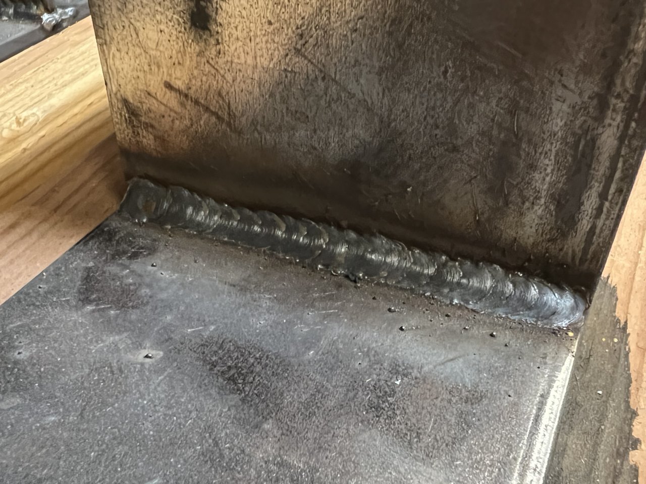

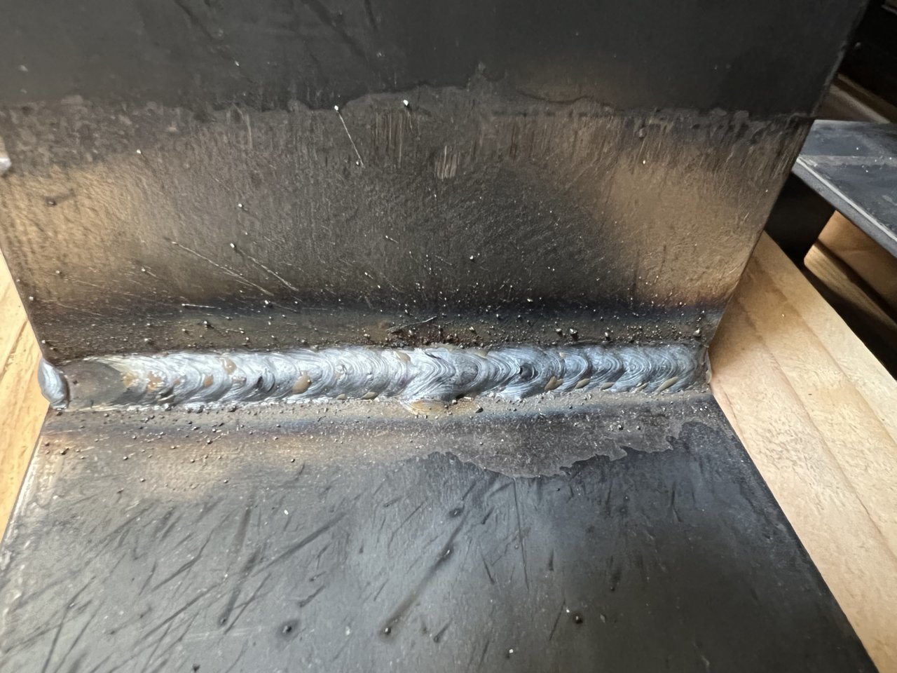

    I think my welds are strong enough, and look ok when I'm in position and doing repetitive stuff, its just odd angles and unfamiliar stuff that is a bit iffy looking. It's mostly just practice but tie ins are one of my weaker areas

    You can see in the second photo the lump towards the middle where I had a tack. But otherwise not too bad right?

    This looks like way too much wire speed or not enough heat to me.
