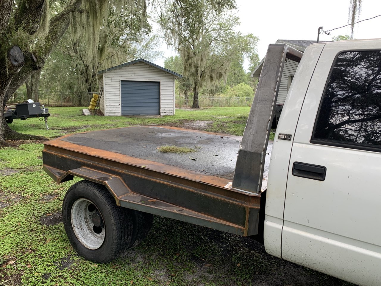

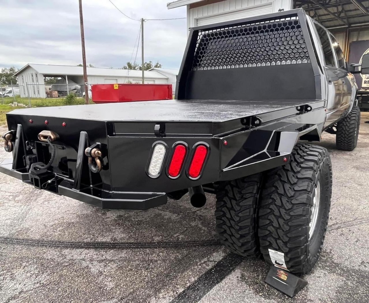

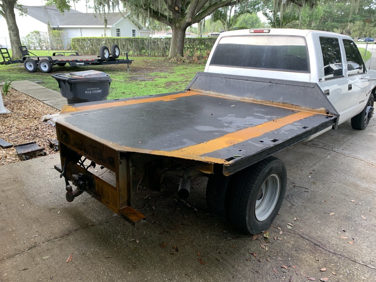

    Finished up this side job a couple of months ago, buddy of mine that I did it for just got it painted and the entire truck done (close to it at least). He brought me this truck with a surprisingly sturdy existing flatbed on it and a couple of ideas. He got some plates cut how he wanted them and I welded it all together. Pics progress to how it started

    Any more pictures of the finished truck? Looks awesome from that one shot.

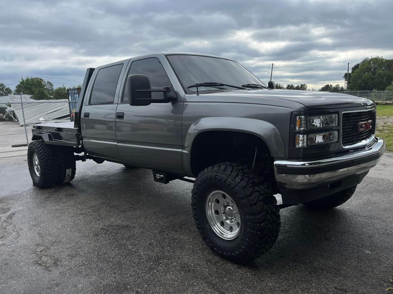

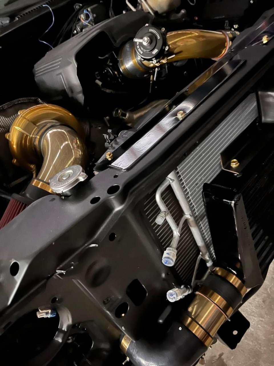

    Only other pics I have of it right now. Boosted 6.0 LS under the hood

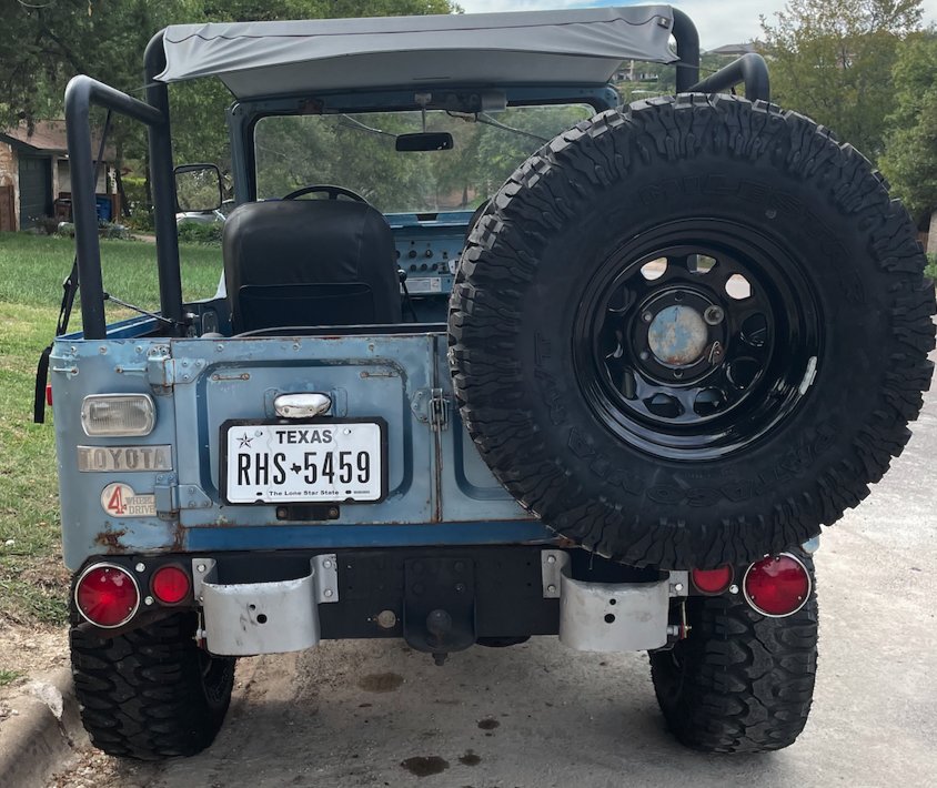

    I had to extend the tire mount 2" to clear the 33x12.5 from hitting the rear of the truck.
    ... tire fits. swing out handle is unobstructed. success.
    Outside of generally better welds (hood time), I really need to figure out how to connect the welds when I work in short sections.

    It's really hard to judge (or know the construction) based on one pic but, did you consider adding a bit of reinforcement such as gusseting or the sort?
    You've pushed the tire out a bit (2") but considering you've also put a much larger than stock tire, the weight of that plus the added leverage is easily more than the tailgate was meant to carry.

    I've secured the left side of the tire carrier to the actual tailgate to try to distribute the weight whereas before it was 100% on the hinges on the left side. I'll be keeping an eye on it as I add some miles and strengthen where necessary. My goal is to build a rear bumper (with tire carrier) over the winter after I knock down the electrical gremlins so hopefully this is temporary.
