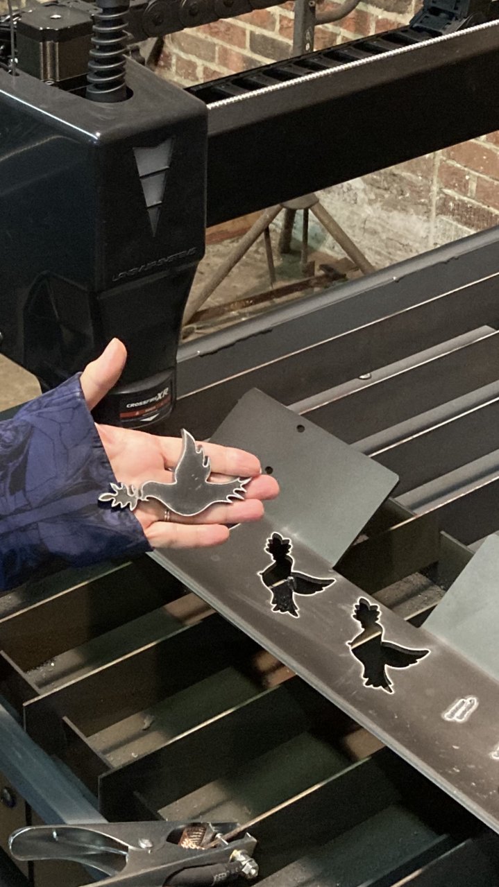

    Dialing in the plasma CNC and Titanium 45 (along with the Fusion 360 CAM processing.)

    I have a couple of questions. Why is there no water in your table? And what made the silver looking outlines around the cutouts and the piece in your hand?

    I was genuinely wondering that as well (the white outline that is). I've only seen white like that when welding on aluminum.
    As for no water, not everyone uses it. It's super messy.

    The silver looking outlines? It's the slightest bit of slag.. this particular piece of scrap may have been treated or sealed.. it was a stand of some sort. I haven't ordered any flat plate yet and my options were this piece or a nice 3' square of 1/2" AR 400. I may have "office worker looking hands" but not that dainty... that's the wife. :D
