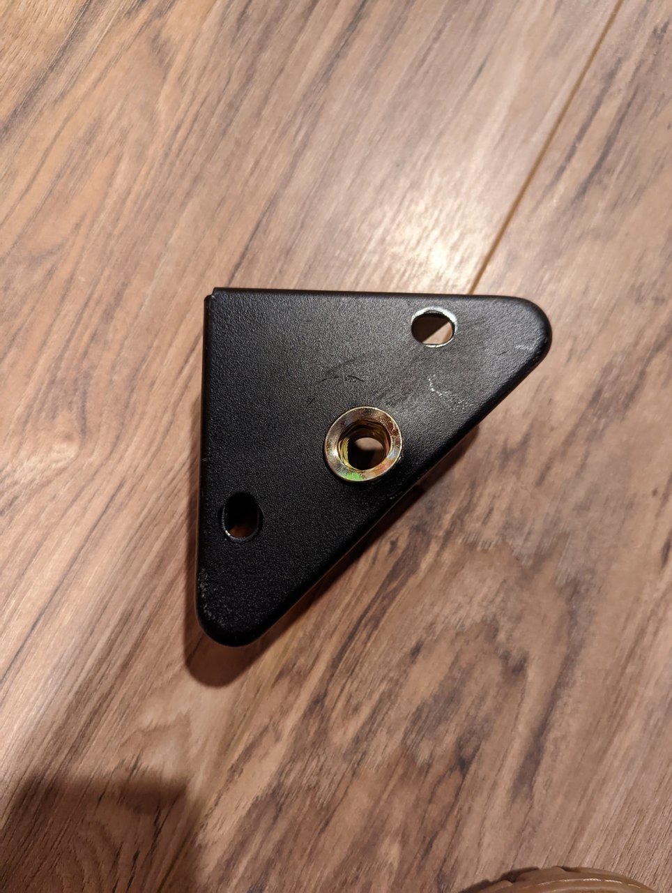

    @koditten has a cnc plasma cutter
    Anyone else would just be using hand cut methods, whether it's with a plasma cutter handheld torch, angle grinder with cut off wheel, bandsaw, etc.
    The slots there are looking more like drilled holes. Though if you need an actual slot, again cnc plasma table would be best.
    Cnc milling could take care of slots (and cutting if needed).

    I'm not seeing the slots, just what looks like 3 holes.
    Granted, it's not a big job, but I need a better pic with some hole/slot demensions.

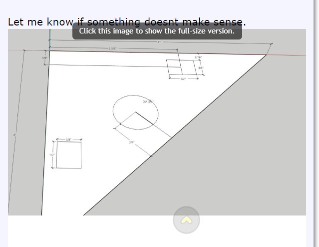

    Was more just giving and idea and seeing if anyone was even interested.
    I'll get you actual dimensions and all that in a bit (might be a day or two). Luckily pretty much all but the slots locations are up to me and you to decide on

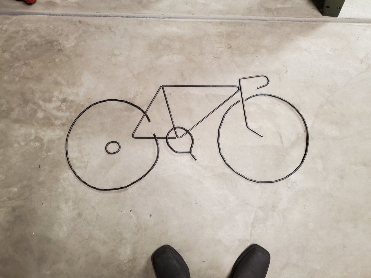

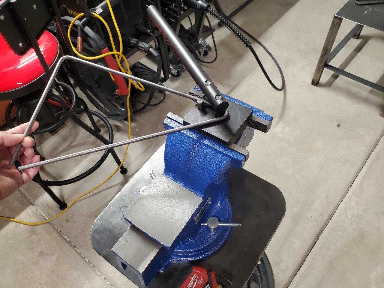

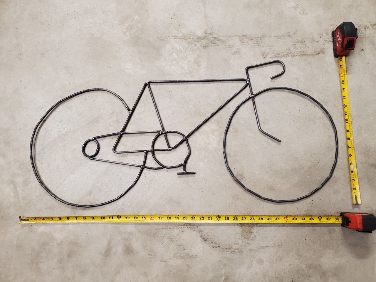

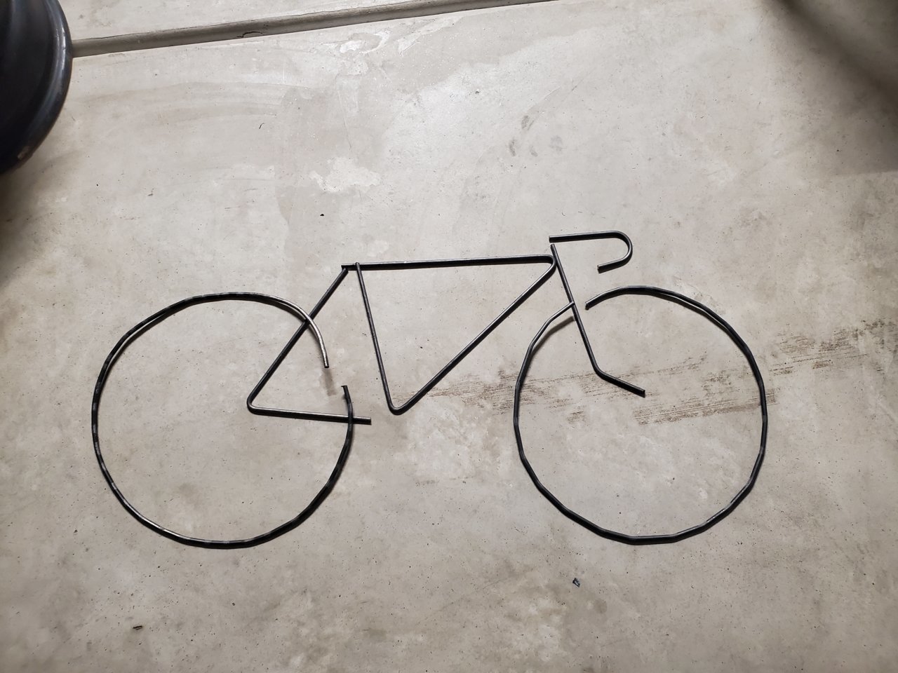

    Went to the yard today, and nope...no rectangular tubing
    Said fuck it and bought more steel rod; I'm at just over 50' total in 1/4" steel rod

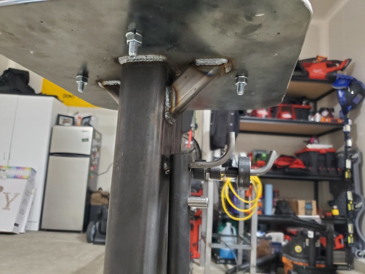

    Anyway, put the bender to use
    First, I just welded these to hold my dies and handle
    Next up, some practice bends
    As long as you're not too critical, you can easily bend short pieces to make it look like something else
    The large circles were definitely a test as you need to figure out how much to feed and how far to bend with each little bit

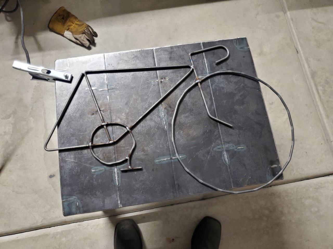

    Few more to better complete the look
    Weld, measure, and cut since the intent here is for e everything to be flat. You'll notice that in the crankshaft as I notched it several times
    With the exception of the seat, it's all done
    Came out much larger than I expected. Measures at 38" wide and 18" tall
    Easy little project, but lots of fun for using cheap rod and just bending the shit out of it

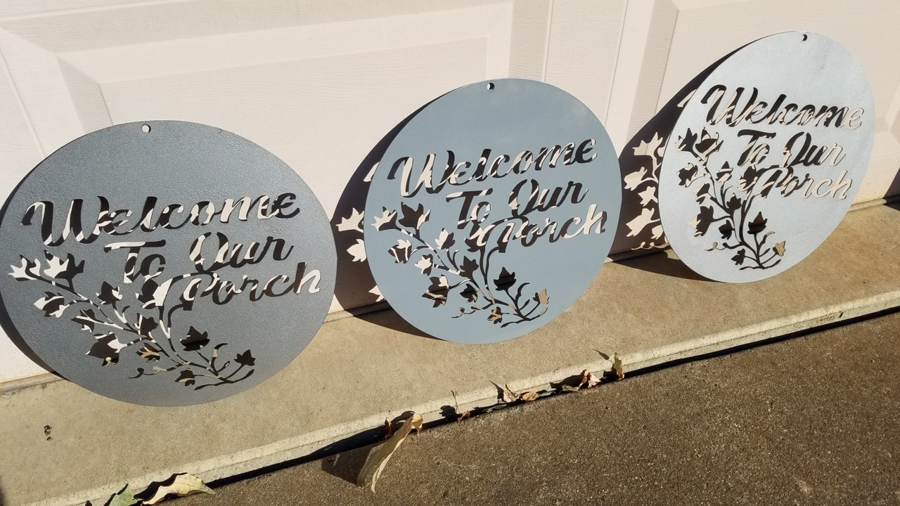

    Hey @koditten I've been making this "Welcome To Our Porch" sign for a lot of my friends, and the wives love it. So far, I've been giving them away just to prime the pump. I've asked if they thought they would pay $25 for it, and most say yes. I have about $6.00 in 18 gauge (9 signs from 48" x 48"), plus $2-3 in paint, and estimate 25-30 units on an electrode. Roughly, $10-11/sign in materials.
    If you want a copy of the .NC file, PM me an email address. I could also export from F360 in ".f3d" format if that works better. TW says the .NC file extension is not allowed.

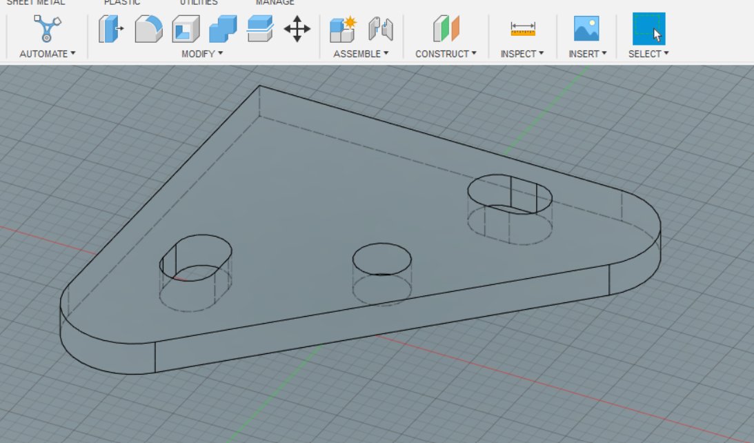

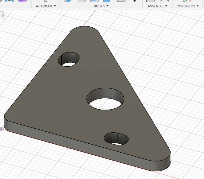

    Here is the part drawn to specifics that @velillen forwarded to me. I've created the Gcode, now I just need to do a test cut. I'm hoping for tomorrow evening.
    This has been fun. I actually found that F360 has a "slot" function that works great!

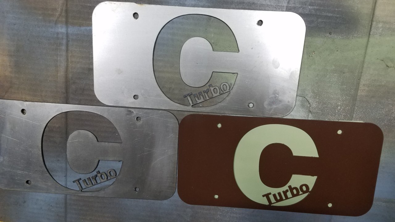

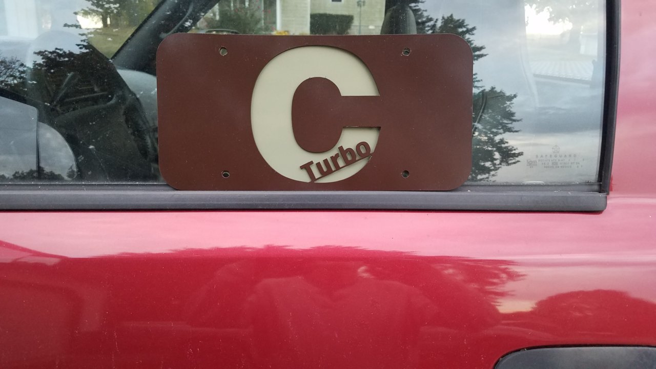

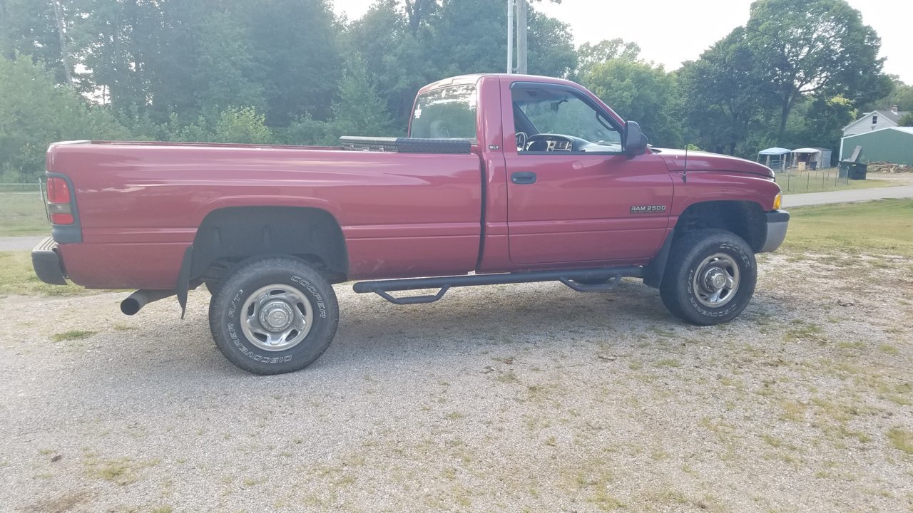

    I got one of my To Do sign projects done today: made me a front plate for my Dodge truck. Thinking about going with the brown since my truck is maroon colored. Still may go black. I also need to make a Pittsburgh Steelers sign for a guy.
    I know, it needs some larger wheels and tires. 98 4x4, 12 valve, with ATS trans, and mildly upgraded injectors. It's a powerhouse.
    Cut a few extra for friends at work who also have Dodge diesels.
