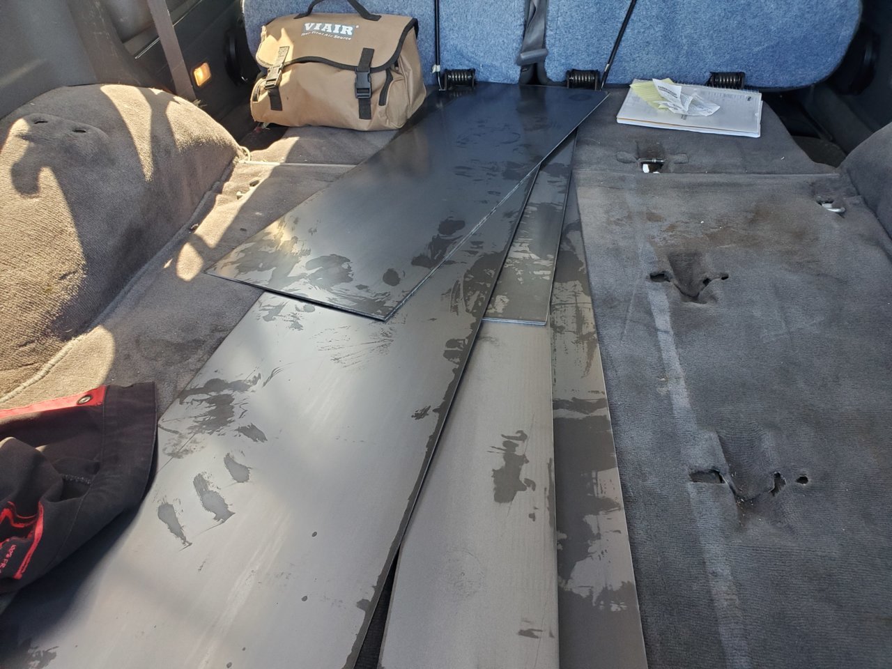

    It might fit, diagnoally since the rear seats do fold up.
    I mean I have put in 6' sheets of 3/16" steel in there
    The weight thing (loading and unloading) is the biggest issue though. With the few models that peaked my interest, they all had a large flat base.

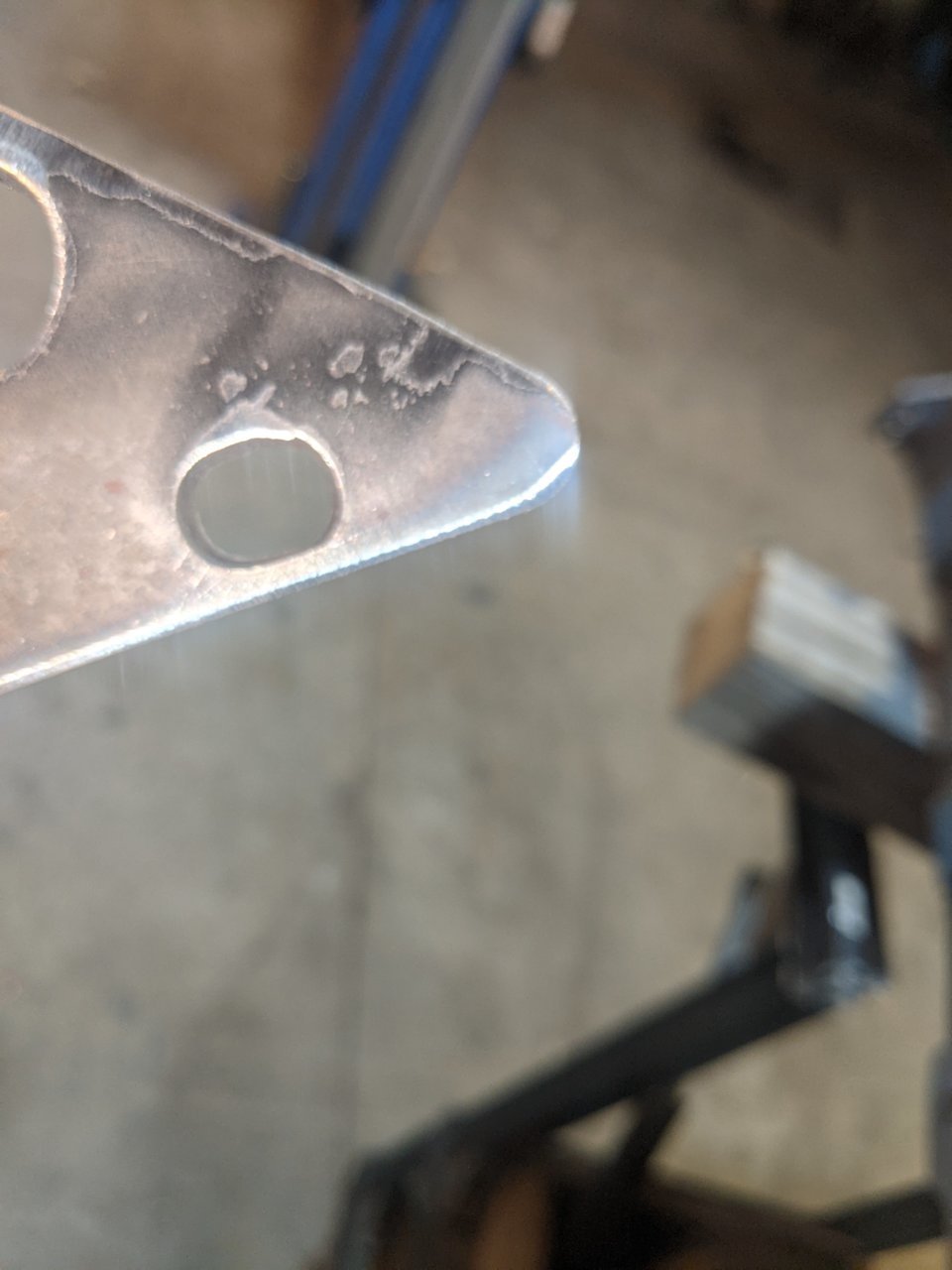

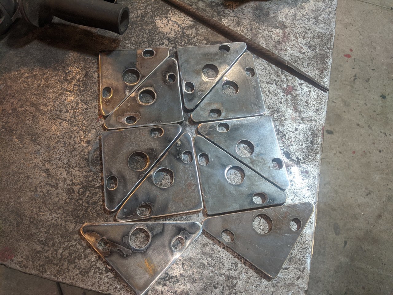

    Here are the cut parts for @velillen they turned out pretty decent.
    Having a bit of trouble with angularity. My cutter doesn't seem to like thicker iron.
    I'm maybe 80% happy with the way they turned out.
    I did learn a lot pushing my machine on thicker iron and asking to keep tight tolirances.PXL_20221024_133459977.jpg PXL_20221024_133601281.jpg

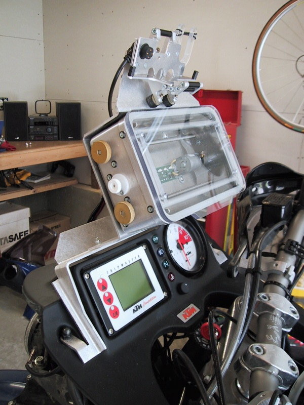

    I'm mostly looking and bending brackets and enclosures out of lighter gage material, and maybe bending <12" of 1/4" plate from time to time. So a 33 ton press would be about right for me. The killer part of this is the tooling. All the cnc benders use a standard type of tooling consisting of goosenecks, straight punches, etc etc, that can enable making deep u-channels and all kinds of stuff you can't do on a box/pan brake or a finger punch with straight punches.
    Swag offroad sells a couple punch options (hemming and gooseneck) and this may be where I end up. it just looks like the press doesn't open far enough to accommodate deeper tools (and I can't tell if the swag would take standard tools or not... looks close)
    I have looked at the iron workers and - unless I'm missing something - it doesn't look like they're really made for doing sheet metal work.

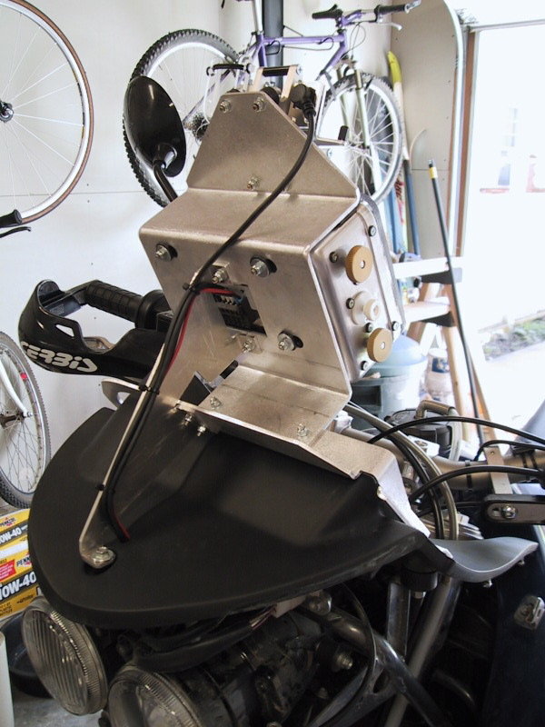

    I remember the first time I saw a big press brake in action - I was a very green engineer and had designed a custom bracket for my KTM to hold GPS, roll chart, etc... and a guy that had done lots of prototyping for our firm invited me down to his shop to bend this thing for me. It was sort of an accordion of folds and little tabs at odd angles. I made him flat patterns and a side views showing all the relative bend angles. He had a few different length stations with shallow gooseneck dies on a HUGE (10'?) press brake and he bent up my brackets in about 3 minutes. (and put a kink in his cigarette that he set on the die while bending. LOL)
    I found a couple pics! Yes it broke on my first big trip. LOL:
    spencermarkd, Bentrodder and Bivouac like this.
