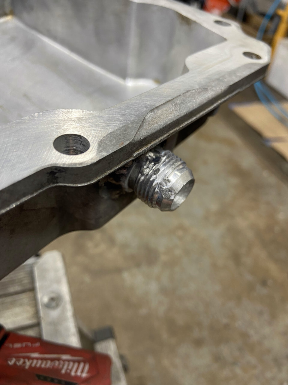

    Ooooh. That's a good one! I could see me doing that. You gotta test the lines man! :rolleyes::rolleyes:

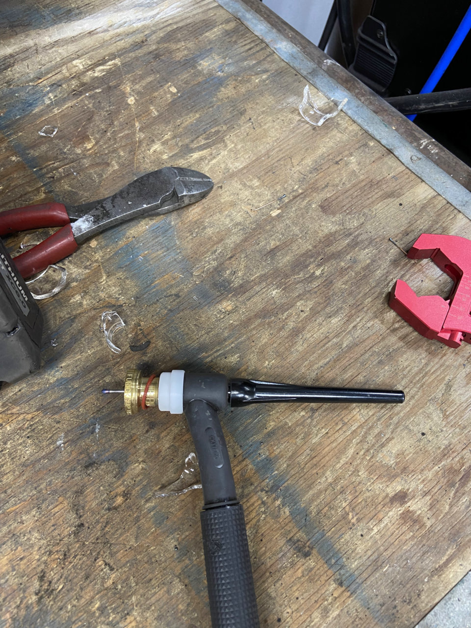

    I was tig'n a AN drain bung to some shit pot aluminum and went lefty to get this little itty bitty spot at the very end and burned my finger and want UZI with the torch. Actually a big issue and inconvenience. :cool:

    What is that wrench?

    Its for AN fuel fittings. Well, any AN fittings cause I have them for basically everything on motor.

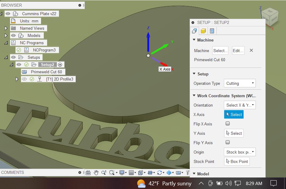

    Go to the 5 minute mark in this video. Tyler Beck has a neat trick for finding lines that are not connected/closed.
    Fusion 360 Mistakes I Make Sketching (10 Things To Avoid) - YouTube
    As for the change the axis/orientation, I just learned an easy way yesterday.
    Right click on Setup, select the Orientation, and notice how the axis arrows are actually two seperate line segments. Look at the X axis arrow in pic. I am hovering over the first part of the arrow and it is gray.
    Play with those and you'll see you can change orientation.

    Holy shit! That line sneak/hack is a game changer!
    That is definitely gonna get heavy use!
    Thank you!

    in that example in the video, the other clue that the profile is not closed is the little bubbles at the end of the line segments. When he joins them, they go away and you are left with just the lines making a corner.
    A constraint is a dimension or a rule (like parallel, or midpoint) and when the sketch is fully constrained it turns black. That means every feature of your sketch and it’s location relative to the origin is fully defined. Nothing can “float.”
    It took me a while to learn fusion’s constraint system to be efficient but the cool thing about it is you can make sketches that are very easy to change if you know sort of in advance how you might want to change them.

    Those little bubbles were not visible until I zoomed waaaay in!
    Took me a while to find places that were not defined.
    Thanks to you guys and the vid, I was confusing constraint and defined, You all helped me keep them separated. Thanks!
