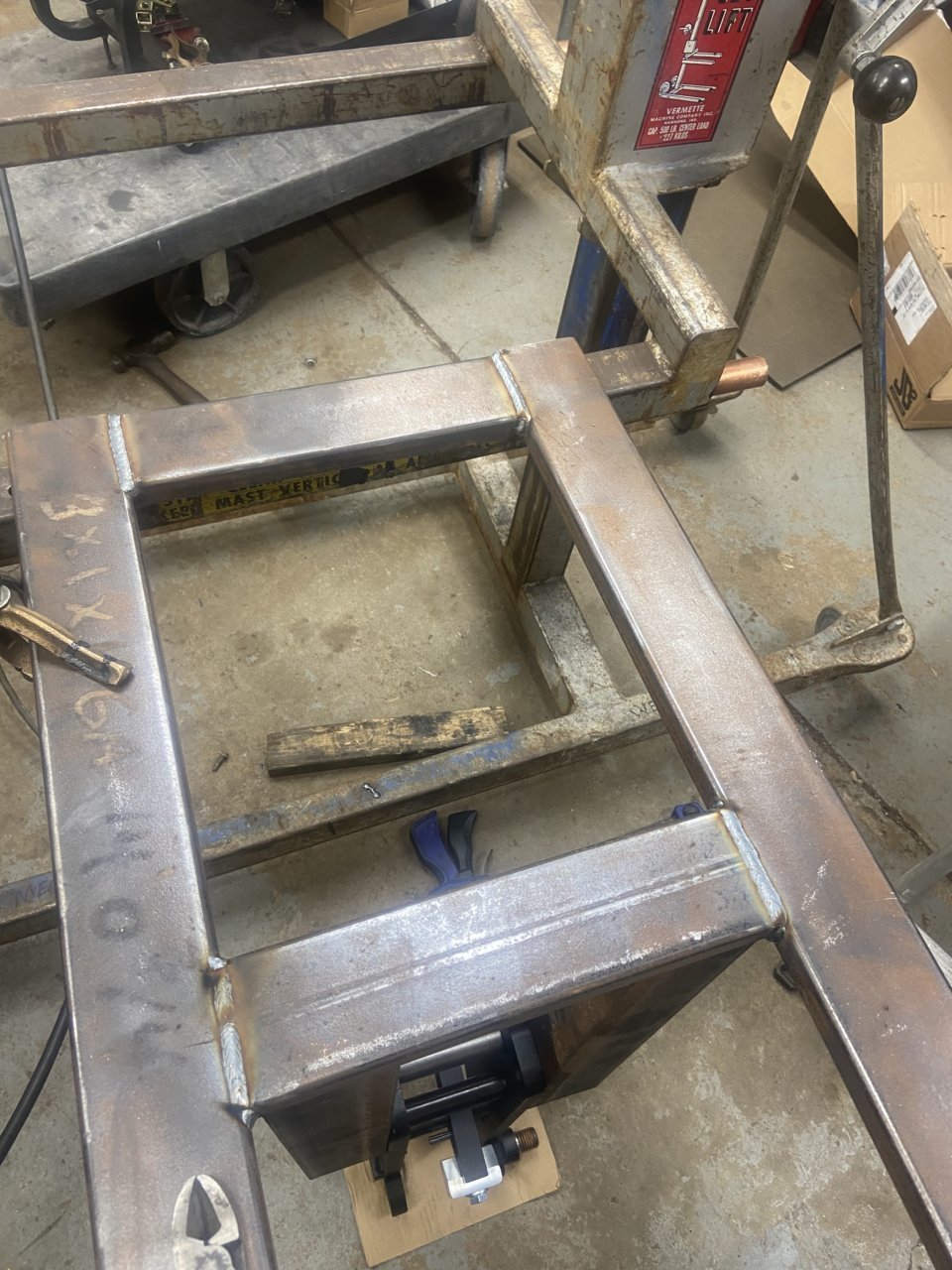

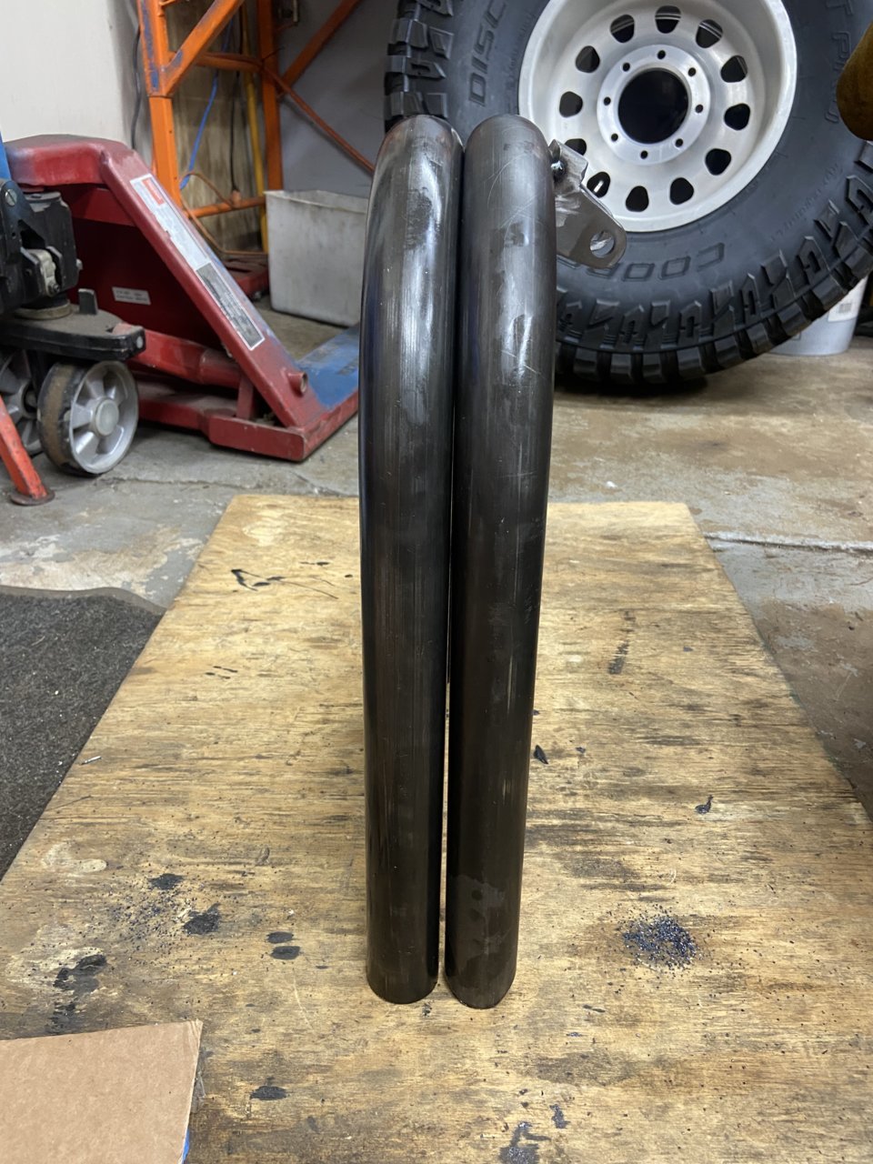

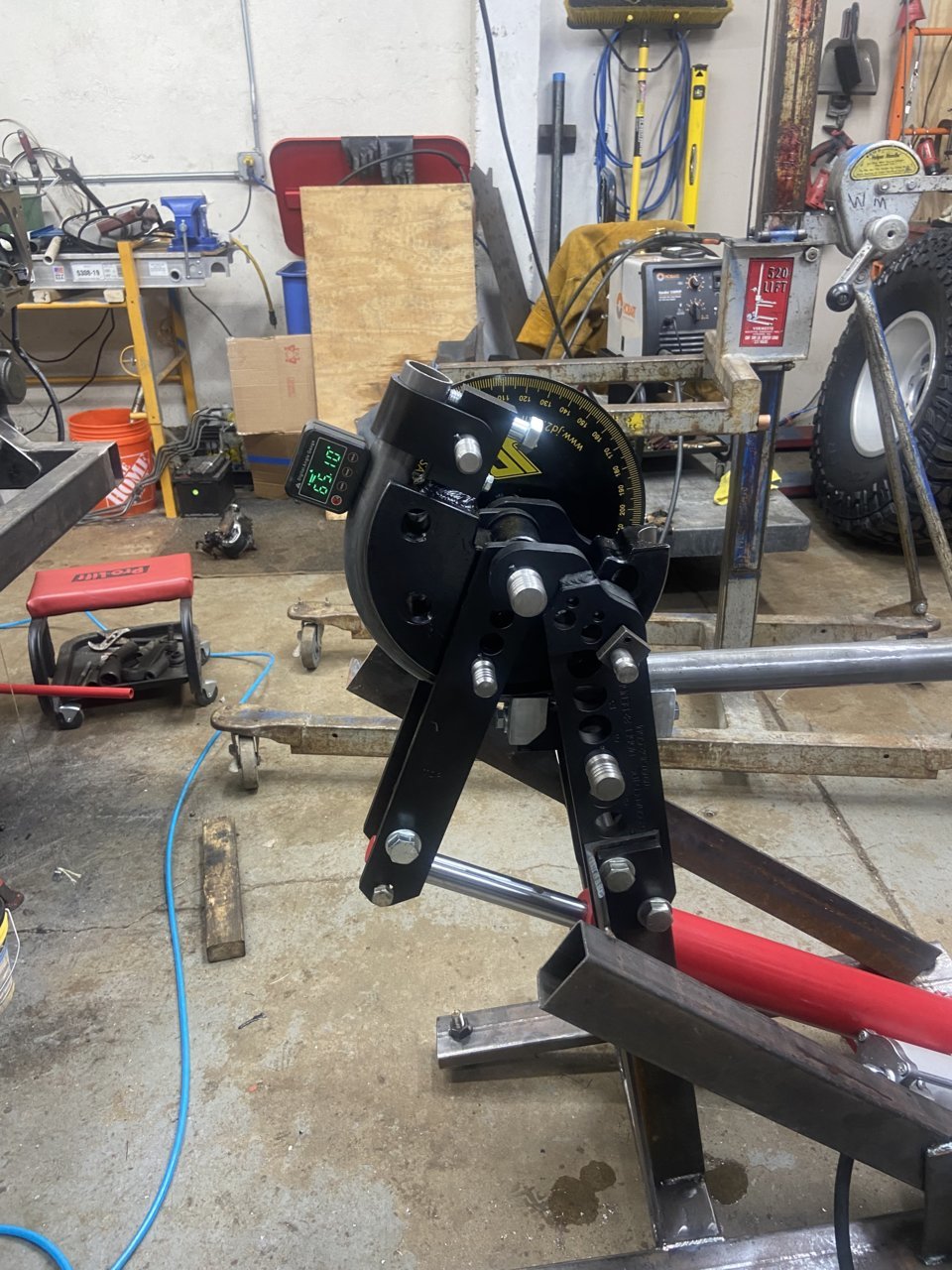

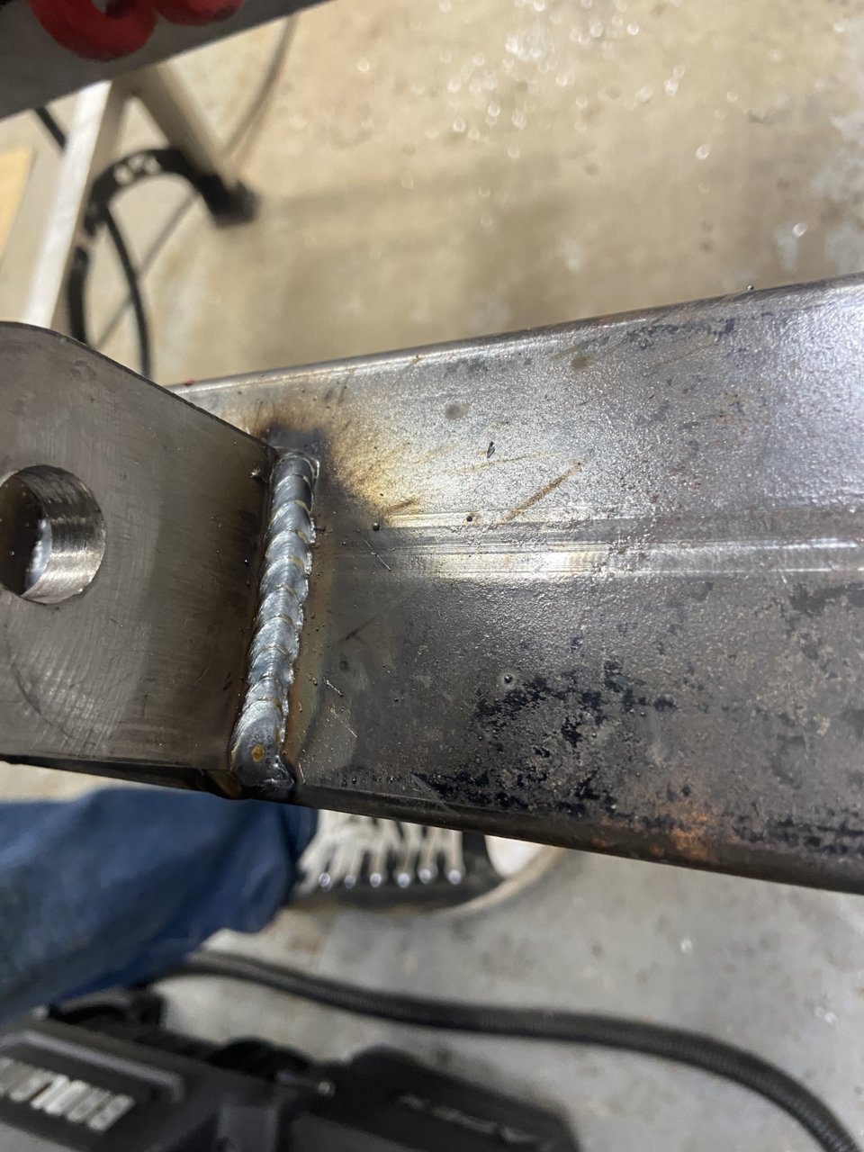

    This is old shit but @Kwikvette is leading an anything welding charge. :transformer: So, thought this may be helpful to someone.
    This is how you take a bunch of bullshit scrap and a harbor freight long ram and save $800 ish minus the 100 ram on a hydraulic bender stand. It’s so backyard it’s cool. To me at least. :cool:

    That bender :drool:

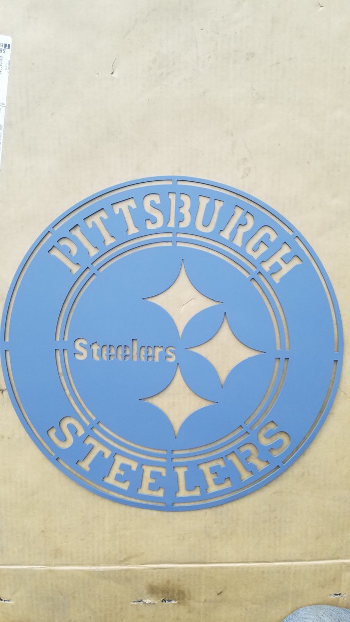

    I mentioned recently I was working on a Pittsburgh Steelers sign for a friend at work. I cut my 2nd revision this evening and it was the winner. I had some letters that didn't cut all the way and drop out, but that has nothing to do with the drawing. I just need to tweak my CAM settings.
    Just gray primer. 15" diameter. He wanted a wall hanger. I assume he will paint it black, and put a yellow (gold?, I'm not an big NFL fan) background for the cutouts.

    Looks great!
    Have you played around with "tabs"?
    I was tired of tip ups and fishing drop outs out if the fluid.
    With adding tabs, I just break out the drop outs after I'm done cutting. I don't think it takes any longer than normal once you figure out the size of tabs that work best.

    No, I guess I should check that out. I have been setting the cutting order/path to make sure I don't get tip-up interference, but it does complicate the G-code and make the cut time longer. Since I am hobby only, time is no problem.

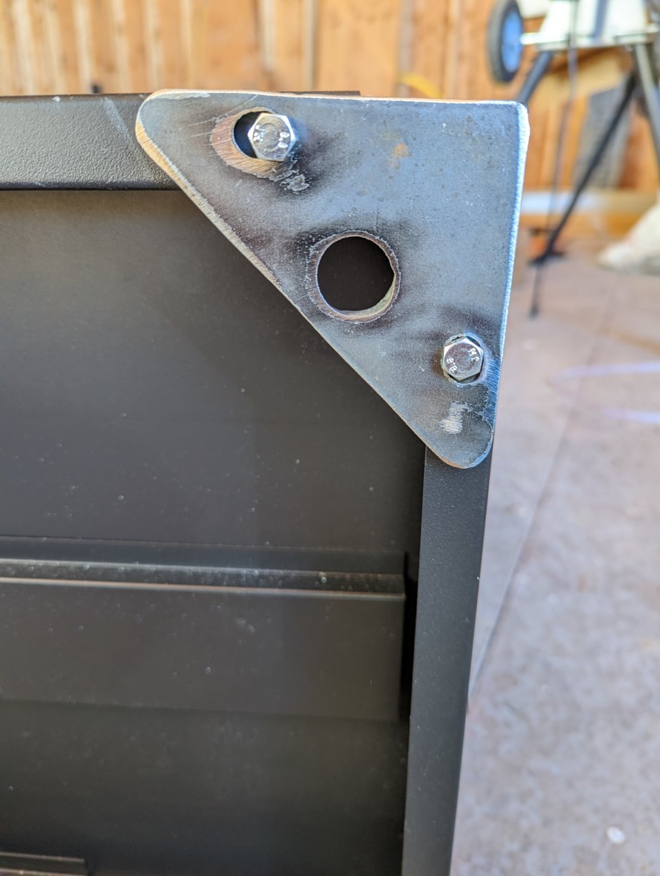

    Not late but big thanks to @koditten for the plasma cutting. Not only did he take my super simple drawing and make it into....fusion3d? But part turned out just fine for me. And prices were also great! So if you have a project needing plasma cutting and it doesn't need super tight tolerances (or discuss with him) then I highly recommend him.
    Parts he cut fit great and the slots work great for the tolerances from the manufacturer.
    Was a great leaning expert for him and I both
