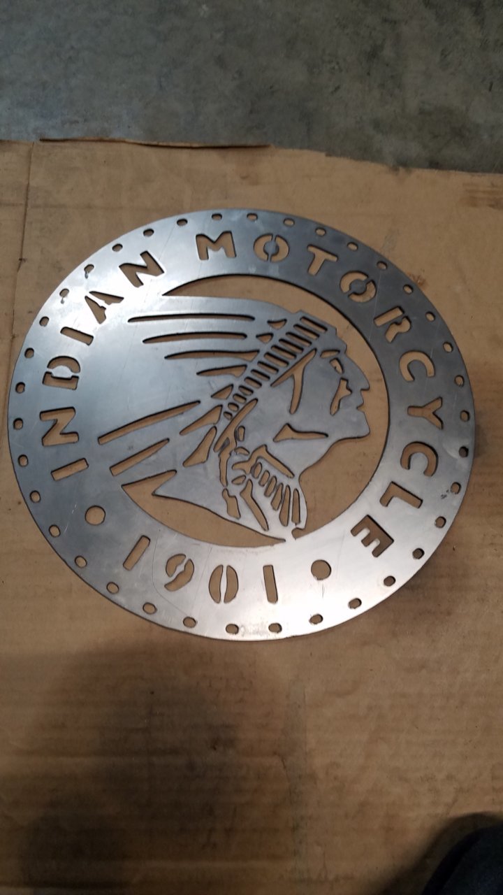

    @koditten My Dad is 87 and still brags about the Indian Motorcycle he had when he was 18. Indian was as big/popular as Harley at that time.
    I made him a wall hanger for his garage. Cut it Sunday with only one wasted run. Dummy me put my ground clamp in the wrong spot and it got caught on the X-axis cross member and shoved the sheet of metal out of position during the cut.
    He has a pic of himself (at 18) and his little brother on the bike. He is going to hang them together in his garage. He still hangs out there every day.

    Absolutely beautiful! Hang that with pride!

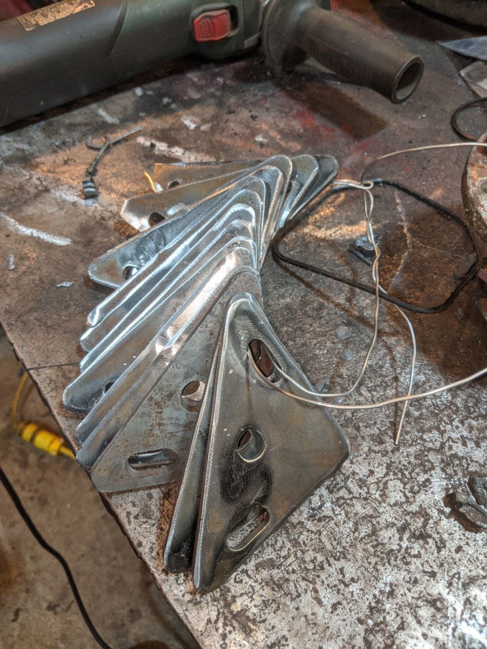

    Brackets for a member here.
    Getting the table dialed in for cutting heavier iron.
    I still need to work on my lead ins and lead outs. I have a very small imperfection that I think I can get rid of with some tweaking.

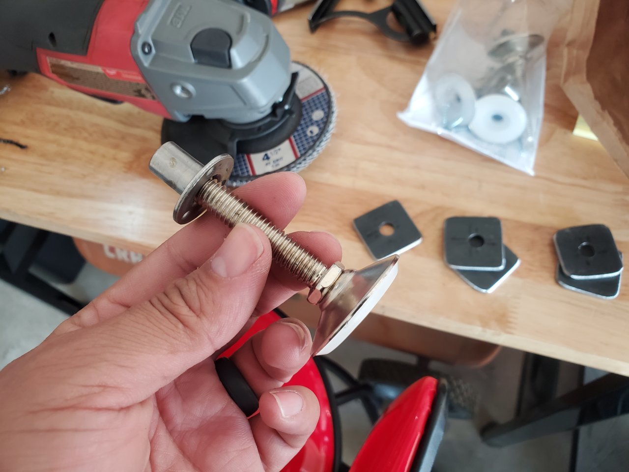

    I use 1/2” carriage bolts as leveling feet for some of my “smaller” projects. Super cheap and easy to replace if I need to. I have a few outdoors and they’ve held up great with a little anti seize on the threads.

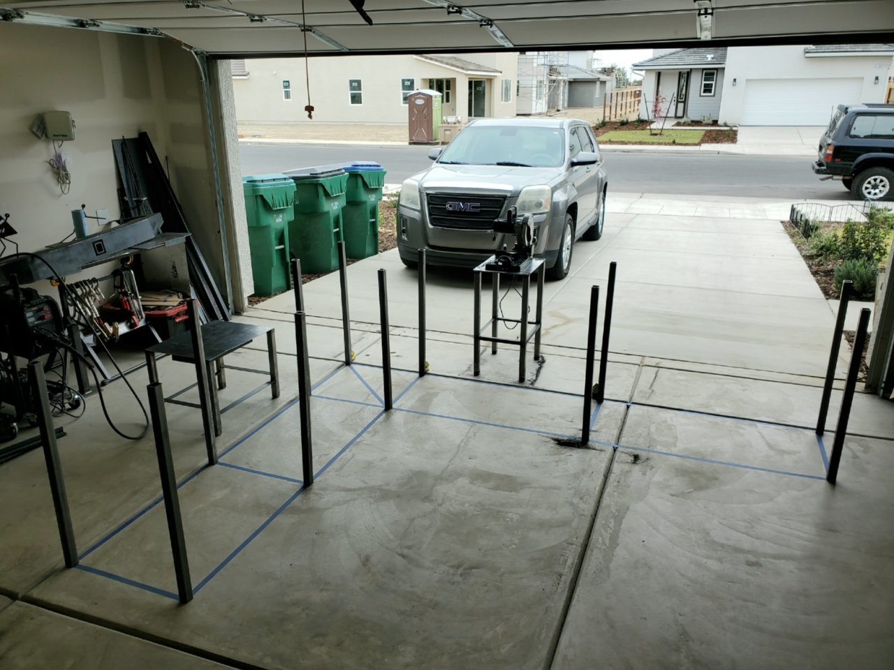

    These legs are for a large, L-shaped shelf setup that'll receive a light countertop.
    I'll be cutting angle iron and running that along the top between the legs. Angle will get holes drilled along the top flat side before getting burned in of course. Those holes will be used to run self-tapping screws for attaching said counter top to the angle iron.
    Here are the dimensions I measured and brought to my garage for planning and layout.
    Shelf will be in a small room in my neighbor's business and it'll sit on laminate flooring hence the soft feet used.

    You can always weld larger plates to the carriage bolts if you want to spread the load out on more delicate flooring like vinyl and laminate. While it may seem like more work, the cost is pennies compared to buying prefabbed leveling feet. And isn’t making stuff really why we got into welding in the first place?

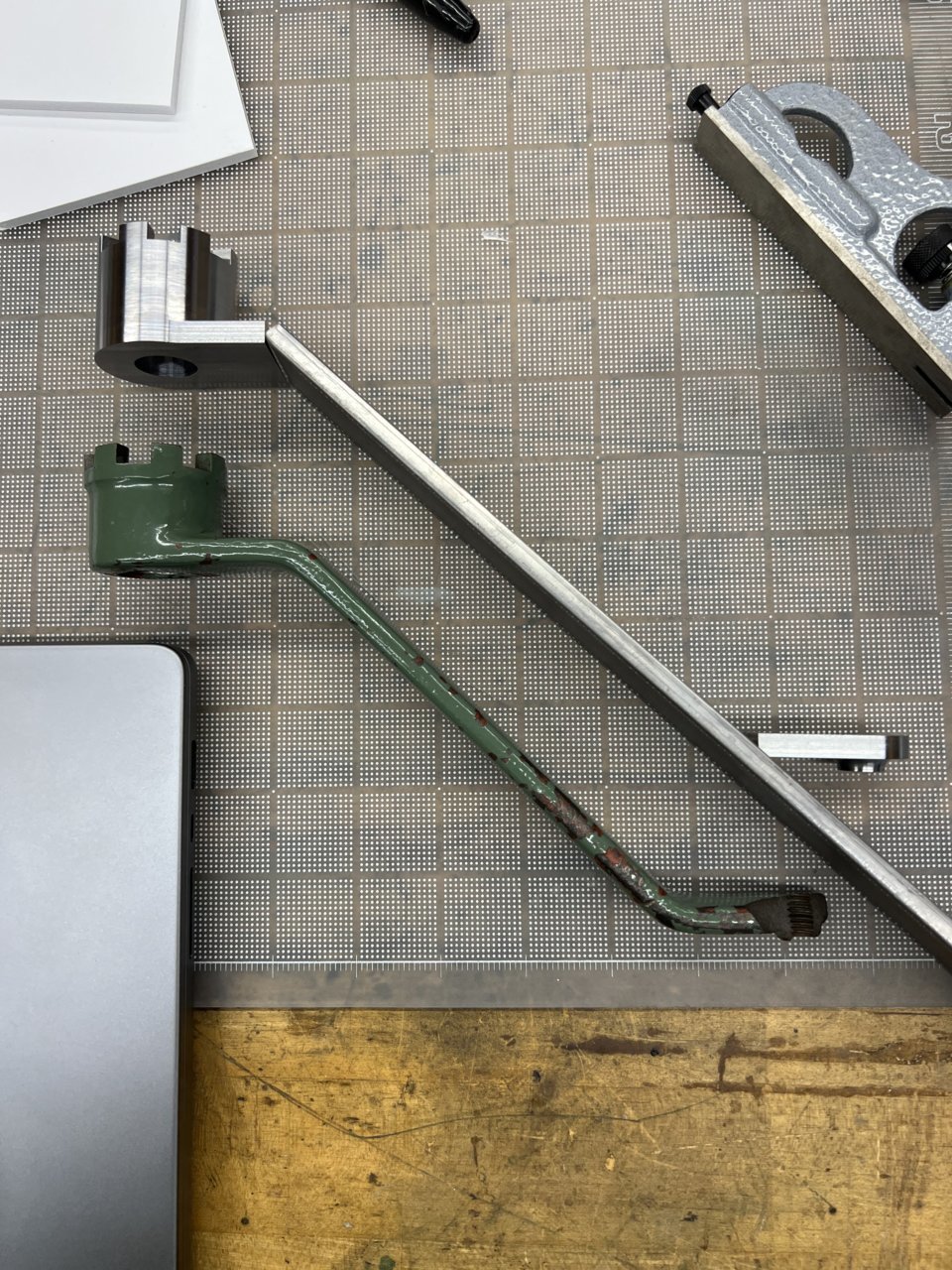

    In that spirit… I’m definitely going to practice before I weld up the real parts but any thoughts on this? My knee crank broke eons ago and I am finally getting around to making a new one. Plan is to tig the two ends to some 1/4” bar kind of as shown. Will tack together, check alignment, clamp like crazy and then weld front and back. Depending on what my welds look like, I may blend it all together. Ha ha. This is 1018.

    Color me stupid.
    Can I ask what a knee crank is?
