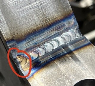

    so - another question - when you get to a corner (as I did down below) do you roll your torch around so it's aiming back the way you came? I always get oxidation at the end where I break over the edge. Here my torch was probably aimed right at the root and tilted back about 30-45° from the direction I was going. Those damn corners.

    How long is your post flow timer set for??
    I start at the end of the joint and weld toward the center.
    having the tack welds about 1/2" from the end allowing a good burn through.
    In everything but Vertical

    It's on 'auto' and goes for DAYS. lol. But that makes sense to weld in to the middle, though I feel like I see guys making beautiful continuous welds corner to corner on tanks and such. I'm going to have to start paying more attention.

    You need to practice your tie ins.
    Besides that is why you have many grinders

    I move torch to vertical/90 deg and dab filler at the end on a corner like that. Makes a nice puddle that caps the weld off.

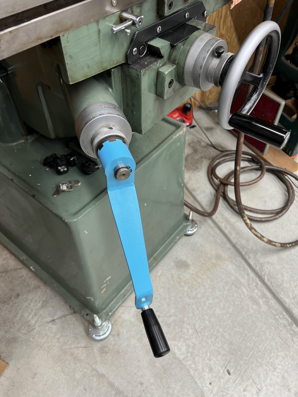

    Thank you! I've got some more weld/assemblies in mind so am going to get some material to do some practicing. Meanwhile... Finished item...

    np. Is that a lathe?

    '73 Jet mill. Lathe is right next to it.
