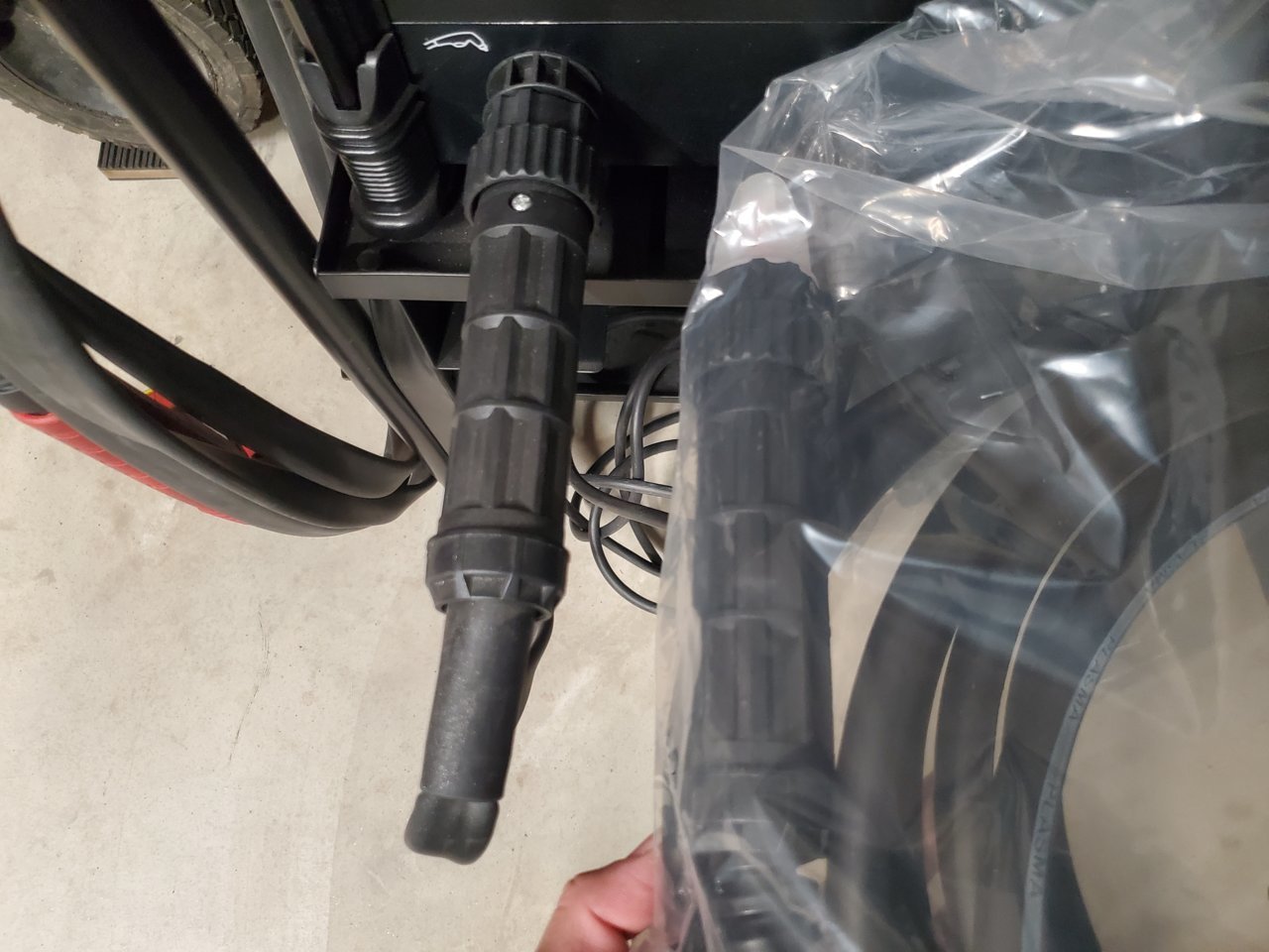

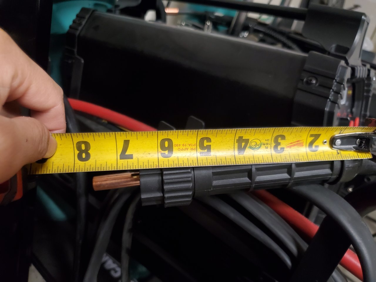

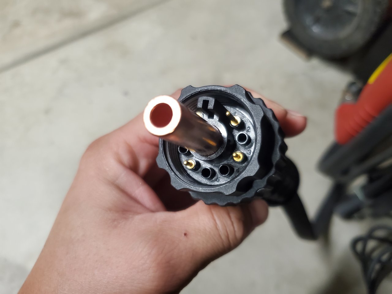

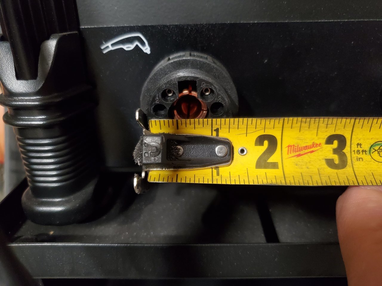

    @koditten
    The connector is a Euro Central connector which seems to be used on a variety of other machines -
    The diameter of the port is 1 5/16" at the machine -
    The center connector's length is 1 1/4" extending past the assembly; it's slightly longer but my tape won't fit inside -
    The connector housing itself is 6 1/2" long.
    And the pins that are used are 1 3 6 9 -
    These measurements are all from my handtorch but it's the same brand (italian-made, Tecmo) as the machine torch -
    Hope this helps!

    Thanks! I'm sure it will! I will be referring to these pics in March.
    Thanks, again!

    I have the older version of 675. It actually looks more like your Hypertherm than like the version of 675 that is now made.
    That torch is not what I have either.
    Wish I was home, I'd dive in and put the collective brains here to work.

    Funny he said that cause when I was looking up various connectors, a connector with a pigtail at the end popped up.
    Seems it's common for people to switch connector styles on old machines for current torches, etc.

    I was thinking this, too.
    I would think If a person can put together a plasma table, swapping the connectors would be cake.
