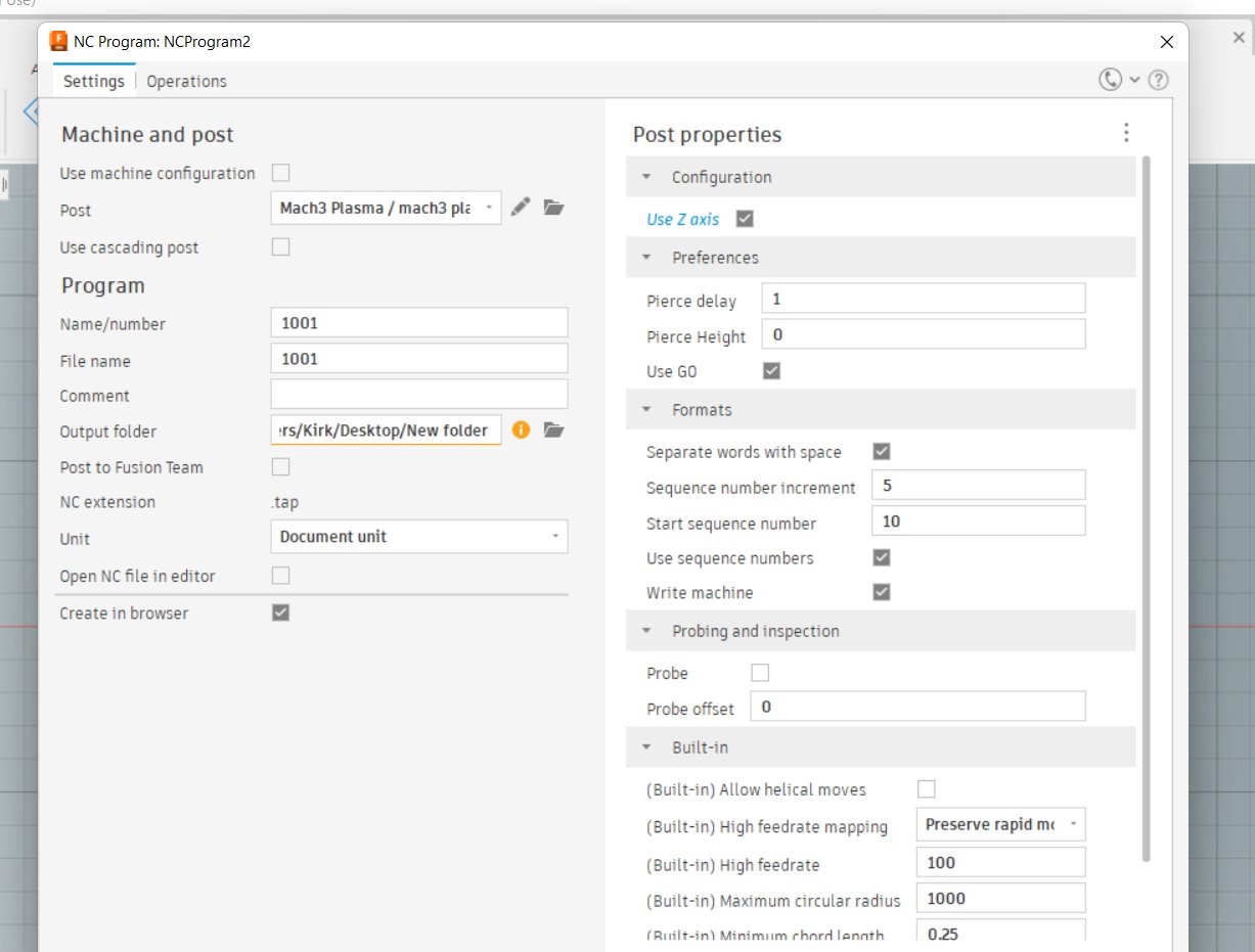

    Those running Fusion 360 and setting up Fire Control for post configuration for the first time, how did you import it?
    I've got my sketch/dxf file.
    I set it up, I got my machine added, I'm just at the point where I'm trying to generate my G Code.
    I know the exact file path to Fire Control and even copied the directory but the initial setup doesn't show it at all

    Have you edited your cutter (tool) in F360? This way F360 knows what tool you want use to cut with.
    I'll see if I can find a vid that helped me the most.

    You will have to find a post processor that matches your cnc software. F360 I'm sure has it already.

    So to help me, F360 finds a post processor for Fire Control, but you can't get it to load to F360?
    Is there a place you can store it in whatever file you are keeping Fire Control on your computer?
    Going by memory, I have my post processor loaded to my computer. Once it's there on your PC, you only have to hit the icon "post process" to generate the Gcode.

    Again, thinking about this, I think I found my PProcessor, then drag it to a file on my PC.
    Is F360 asking for a directory location? I think that is where you put the FC PP.
    I wish I was near my PC, I could help you better. I'm sorry if I'm adding confusion.

    Got it!
    Apparently had a separate file I needed to download.

    Are you able to get this when you hit post process? This where you need to tell F360 what PP to use.

    Where it says POST and you click the folder icon to import, I had nothing and couldn't find it even though I was in the right directory.
    Had to save versus open cause I don't have files saved when downloaded, only opened.
