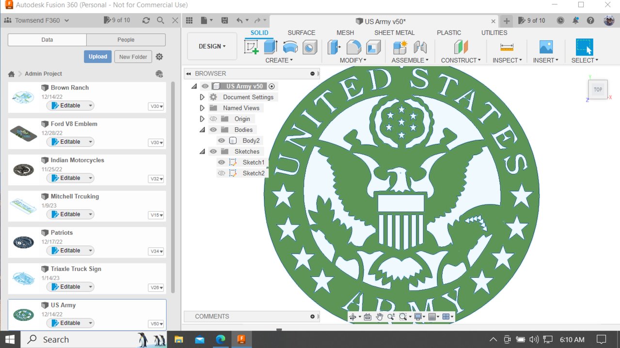

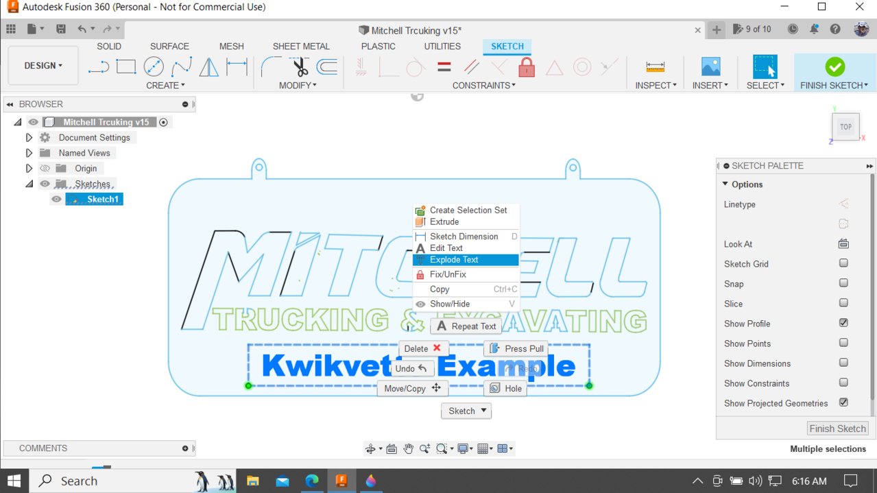

    Is it single line or closed loop text? Reason is likely different for each type.
    If its closed loop, in the Design mode did you use the "Explode Text" feature so it extrudes just like the rest of the sign? If not, it won't cut. Go back to design, Edit Sketch, select the text, right click and select Explode text. Just to be sure t's gonna work, me personally I would delete the previous Extrude (Body) and extrude again. This time the text will become part of the body.
    See how after I Explode, then Extrude, they are part of the Body of the piece.

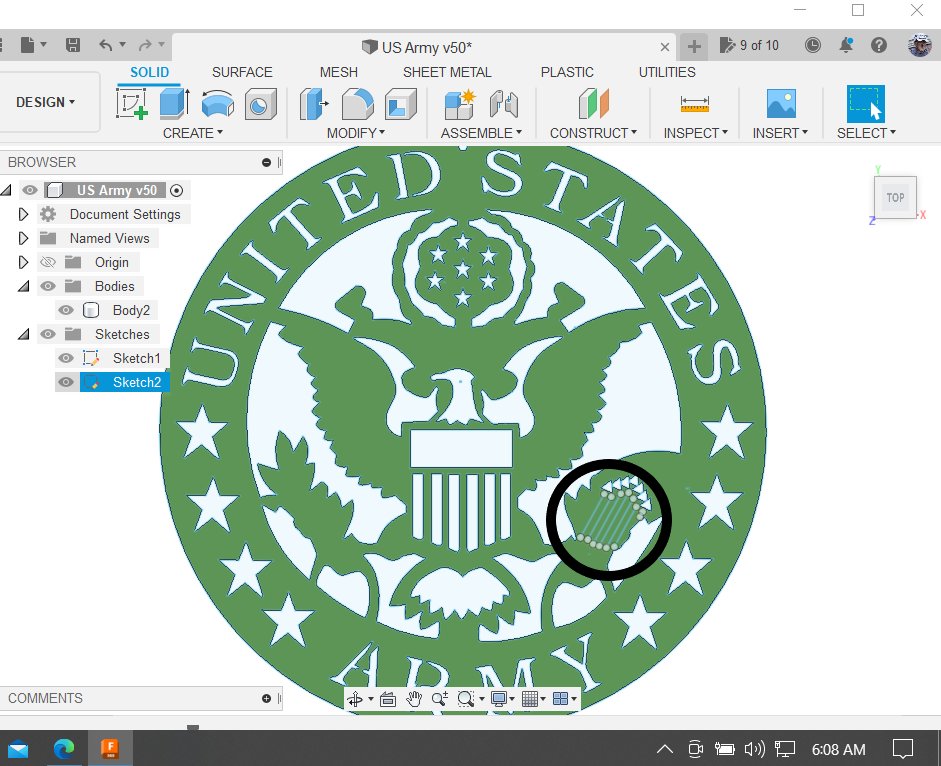

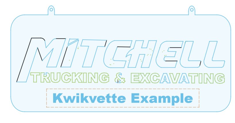

    If it's single line text, you just have to make sure it's visible as the last step before you switch from Design to Manufacture. The last thing most people do in Design is Extrude. That hides any single line features. Just after you Extrude, go to the panel on the left and make sure the "Eye" is black, not gray. If gray, click on it.
    I usually put single line text on a separate sketch as suggested above. See how they are not visible in pic two. Just have to click on the little Eye before going to Manufacture and they can be cut as a separate cutting setup.
